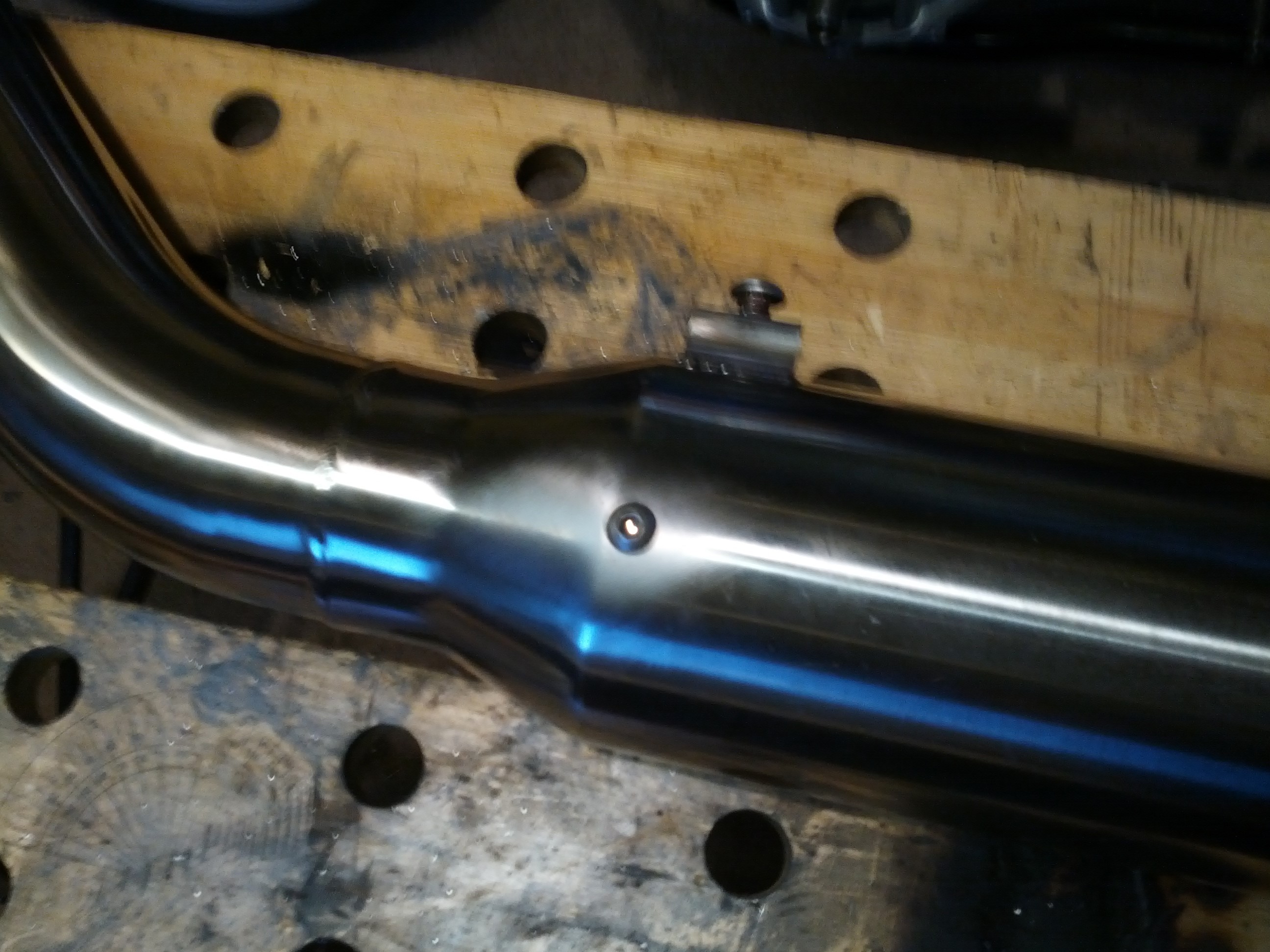

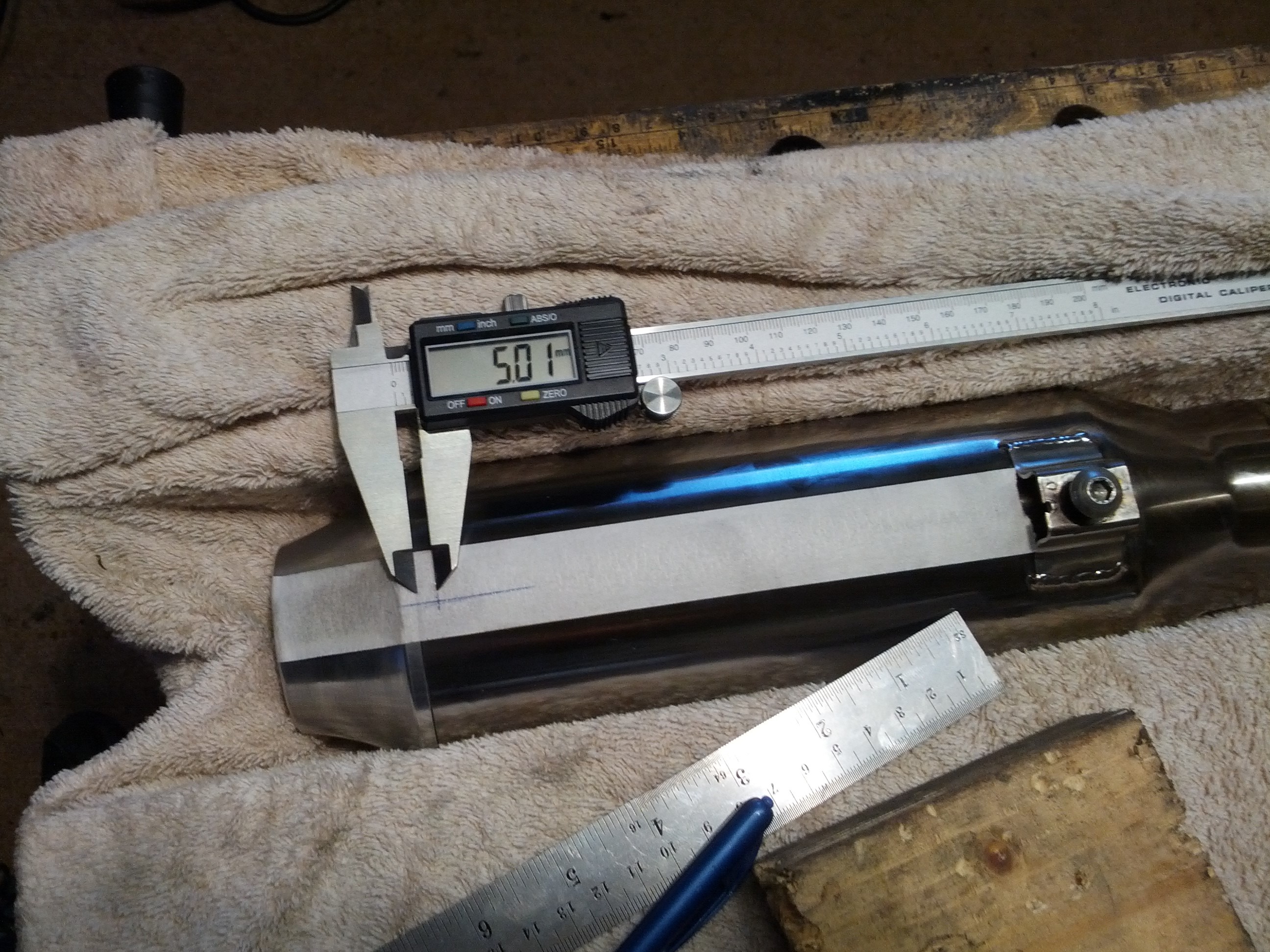

Whilst putting a few miles on the bike i noticed that there was a gap appearing between the end cap and the can of the exhaust. The baffle is a sliding fit in the outer tube with a pressed plate welded to the inlet side and the gas pressure is forcing the baffle and hence cap, so it needs to be held in a bit more securely.
First was to try and locate the baffle by drilling through the outer tube and into the flange of the pressed plate, then cut a thread in the hole in the baffle. This should stop the baffle creeping rearward :shock:
Held in by an M6 button head:
Then measure up for a second screw to hold the cap to the outer tube:

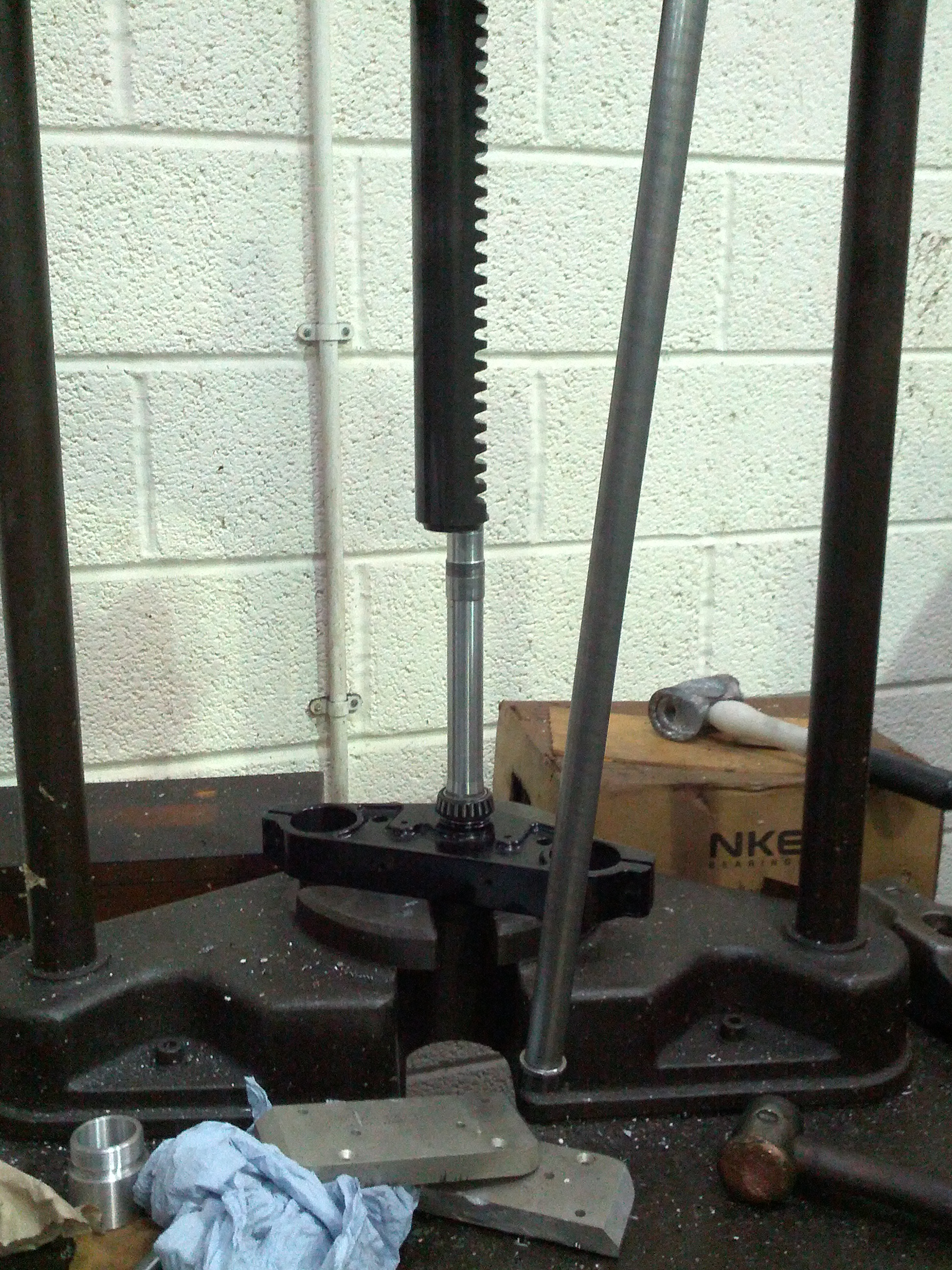

#170 PostAuthor: Zomerset Zed » Wed Dec 20, 2017 7:32 pm
Picked up some anodised parts from Mikey:
Bottom yoke, headlight brackets and rear brake torque arm:
Gotta say he does a perfect job. This is one service supplier i am very happy with :D
Spent an hour or so pressing the stem out of the R6 yoke and into the new one with the bearing and spacer:
Needed to turn down the stem slightly for thicker than anticipated anodising, but she went in with a bit of juggling :tooled

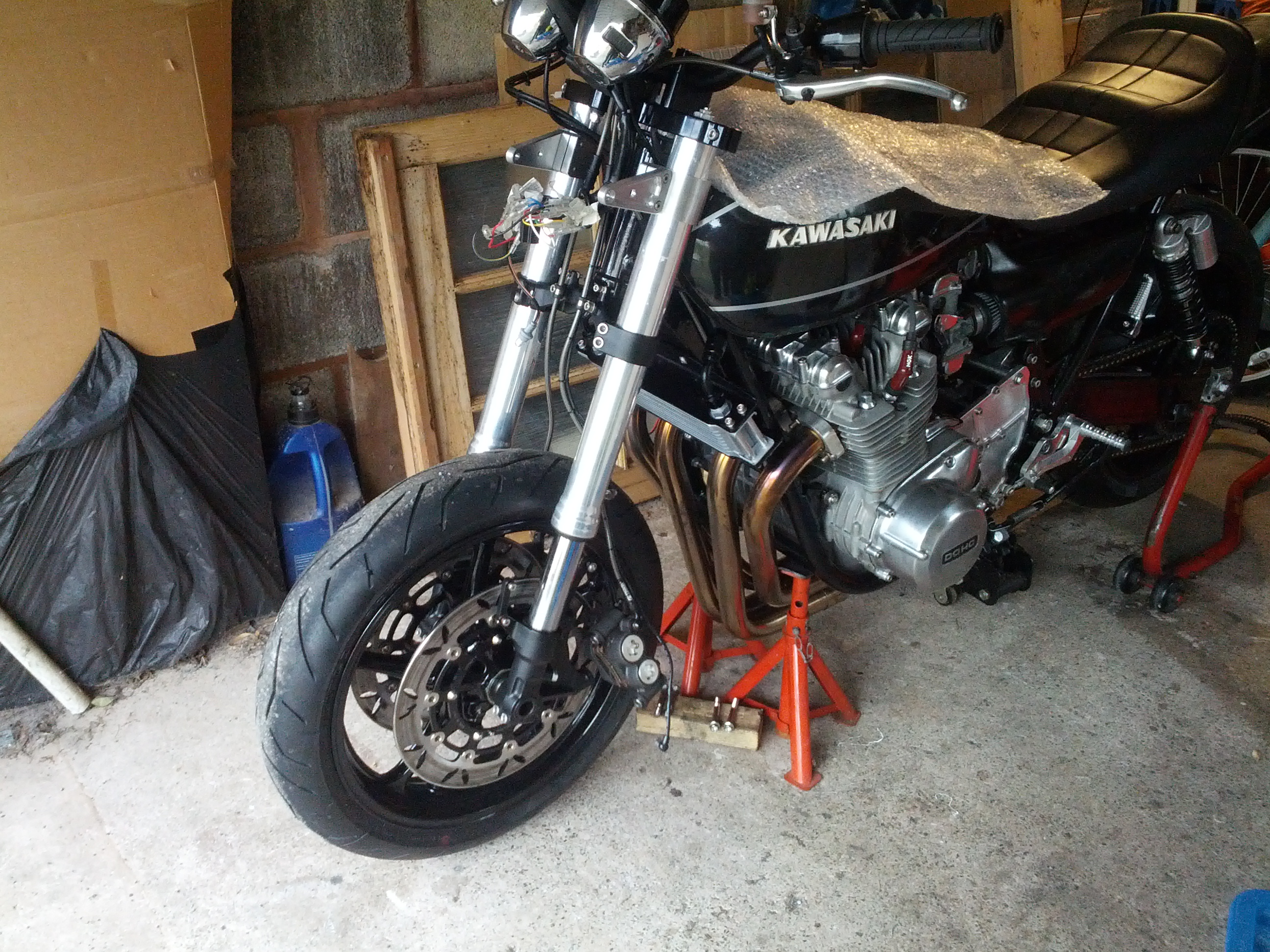

#173 PostAuthor: Zomerset Zed » Sat Jan 13, 2018 6:41 pm
Got me fork extensions back from the machinist:
Internal extension fitted with copper washer to stop any bypass:
Top extender fitted with new o-ring:
Screwed in as tight as i could get it, but its not going anywhere once all clamped:
This now gives me 30mm more fork length to play with.
All finished with new seals and 26ml additional fluid to each fork.

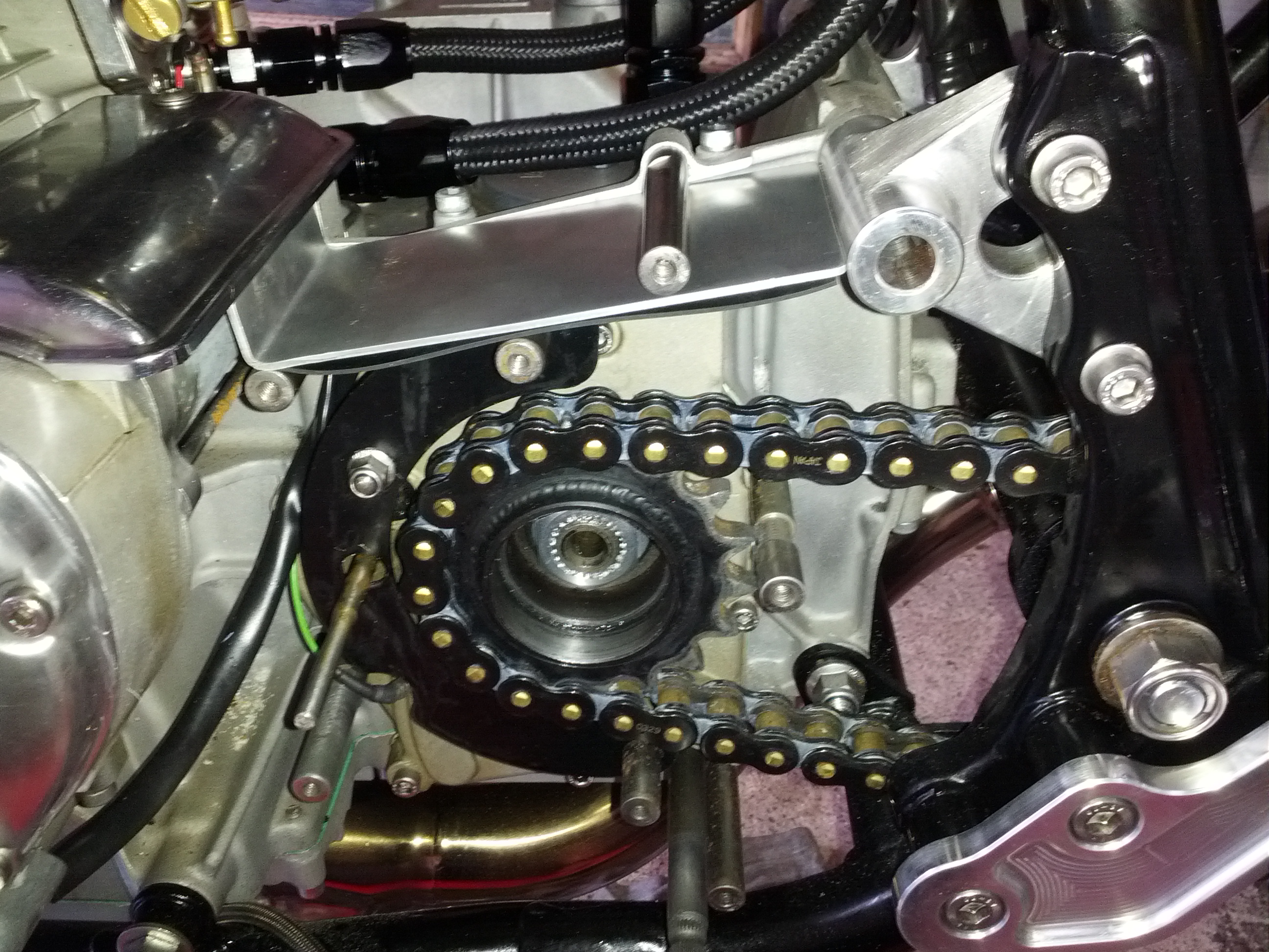

#179 PostAuthor: Zomerset Zed » Fri Feb 23, 2018 7:07 pm
Decided to make a cover over the sprocket to stop splashing up the hole, so to speak :P
Made up from a piece of 2mm ally plate and backed with 1mm rubber sheet
Fits between the outrigger plate posts neatly and is in there pretty tight once the plate bolts are done up
Glued, and done :P
