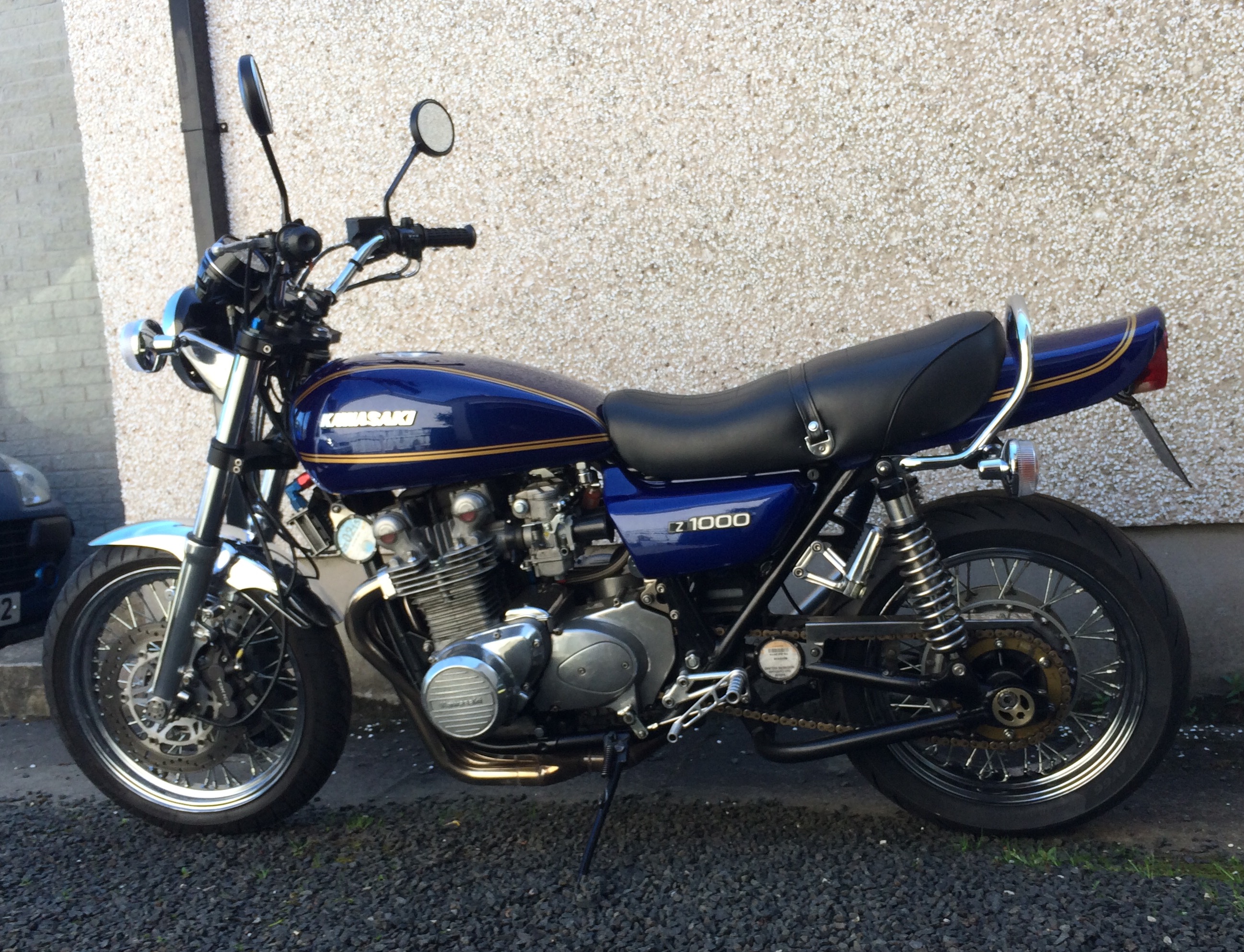

Kawasaki only list Diamond Sky Blue and Diamond Wine red as colours for the A1.
My old Thou in her blue outfit which I believe was painted by Hutch of this forum. The guy I use for paint also colour matched another blue A1 from one of my panels. The paint is a very close match to a BMW blue.... apparently.
Re: Z1000a1 - not sure what I have or where to start
Lovely colour Chris, very nice bike too

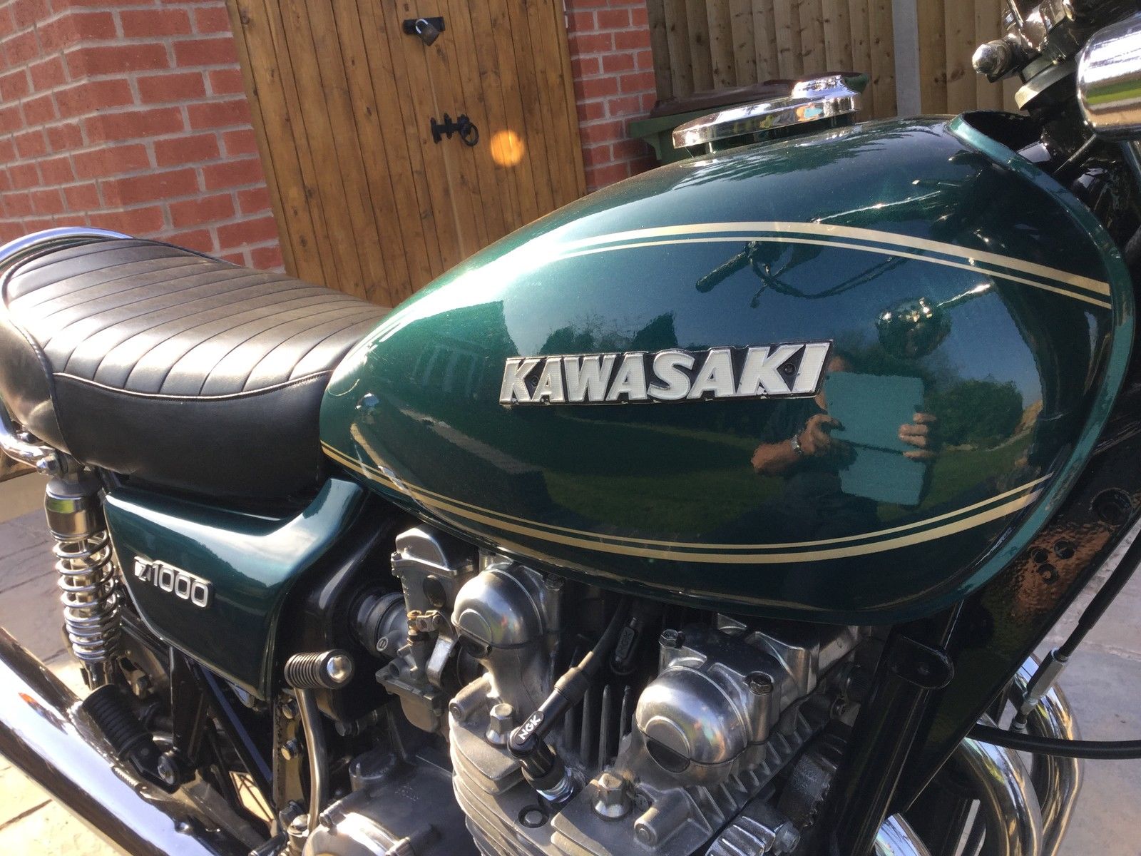

Hiya as people have said, A1in the UK only red or blue, Diamond sky blue is a two coat Jobbie , the base coat being terracotta of all things,company called Lerchler make it and their code is kaw27 I believe... my side panel is a mile out compared to the rest of the bike so looking for a repaint myself ...quite a few people on here have used a chap called Hutch who apparently does a cracking job...
My diamond sky blue which often looks green
