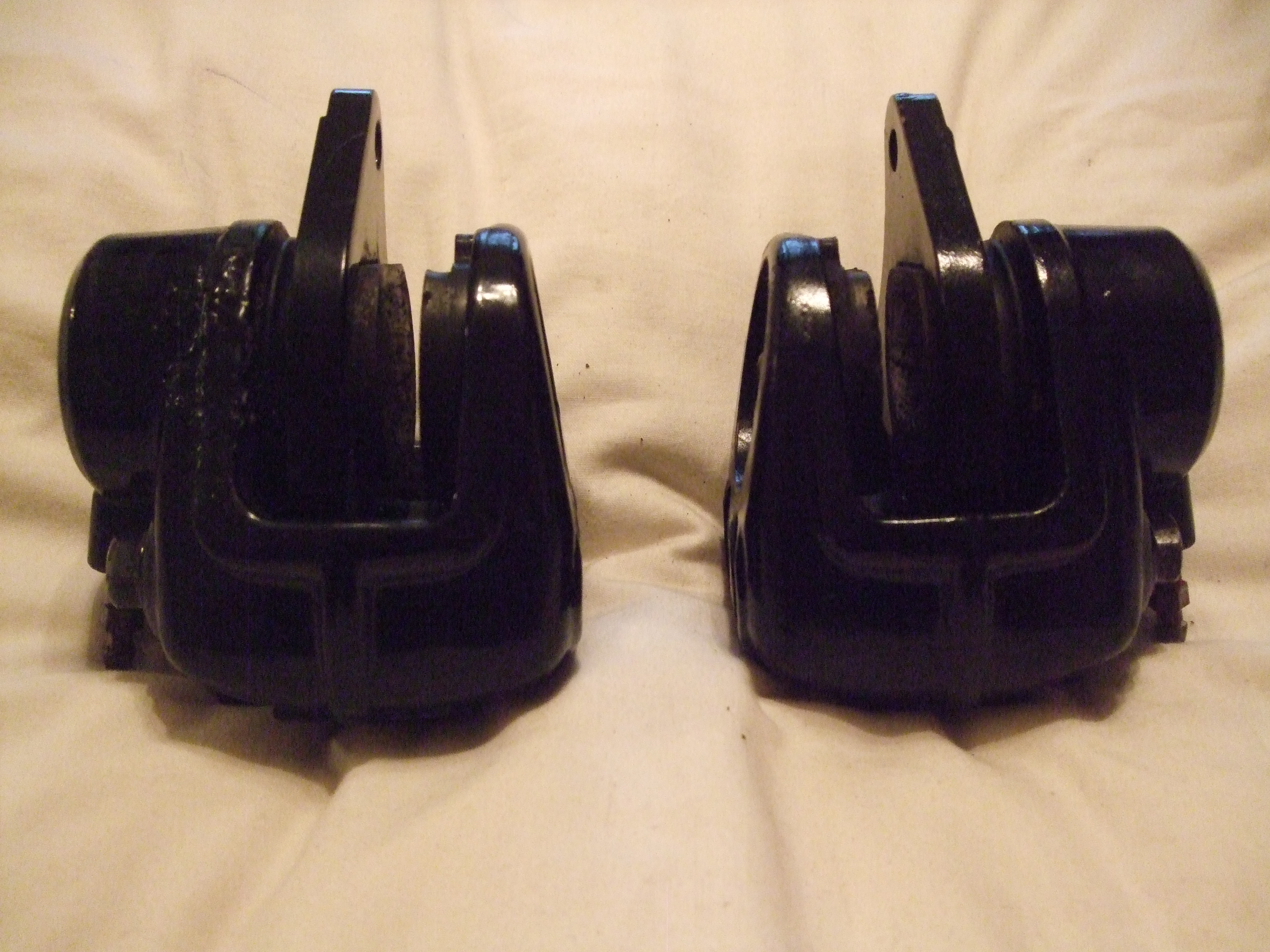

Hi Guys Just trying to find out what these calipers fit had them a long while but carnt remember what the came off any idea welcome ???? :oops: :oops:

900A4 and KH triples.

With a pair of em more likely Z650c models unless one of the above has been converted.

Hi Guys thanks for the info I just brought them as you see them so dont know if they have been messed with so still not sure what they are off

Measure the distance of the mounting holes as they would determine if they are early z or z900a. As they changed after that time

Charlie wrote:With a pair of em more likely Z650c models unless one of the above has been converted.
+1

They are Z or Kh callipers from 1976 onwards. Totally different to Z1 calipers. What they are off depends on piston size.

Hi Guys The hole mounting centers are aprox 72 mm
