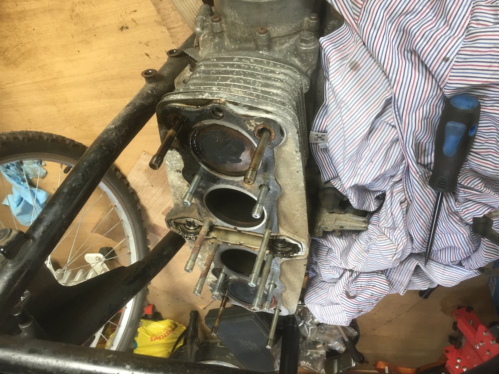

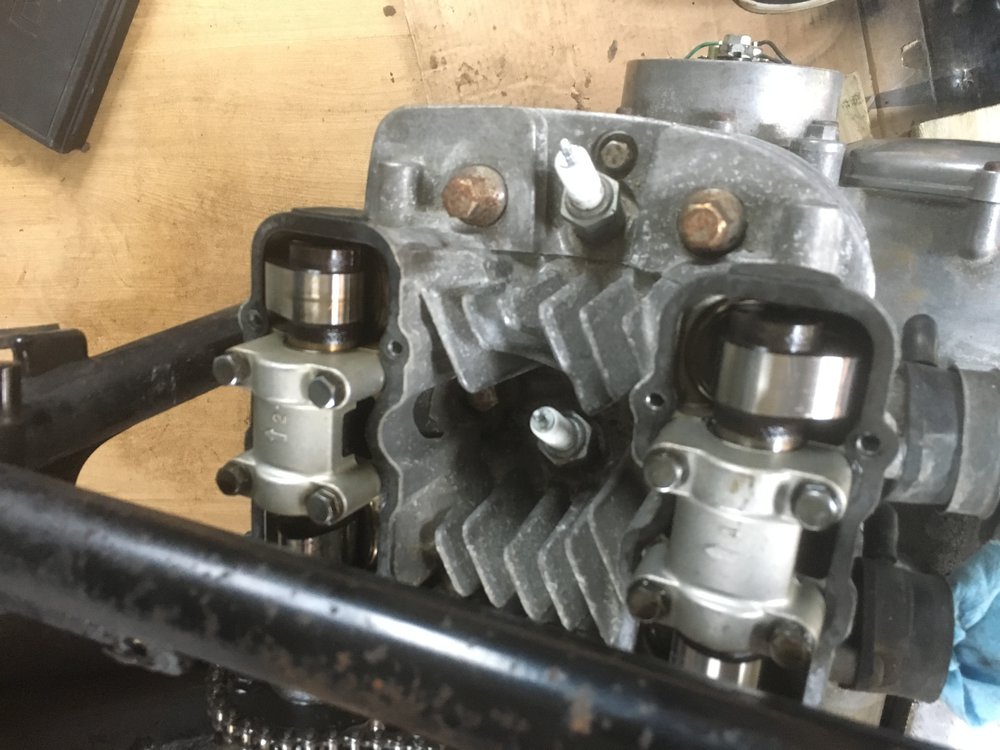

Well I had some time in the shed over the weekend and took off the cam cover and top cam jockey wheel.... all seemed in good condition inside. I have had this engine running briefly after buying the bike and it sounded quiet enough - so I didn’t expect a problem.
Looking at what was left to do, I decided to go for it and take the head off too. Was a little seized in place - but working around it with a rubber mallet - careful not to break any fins - it all came apart and lifted off the studs without any fuss.
Typically I ran out of free time and had to pack away there. So engine not out, but a damn sight lighter and ready to lift out next time I’ve got a few minutes
