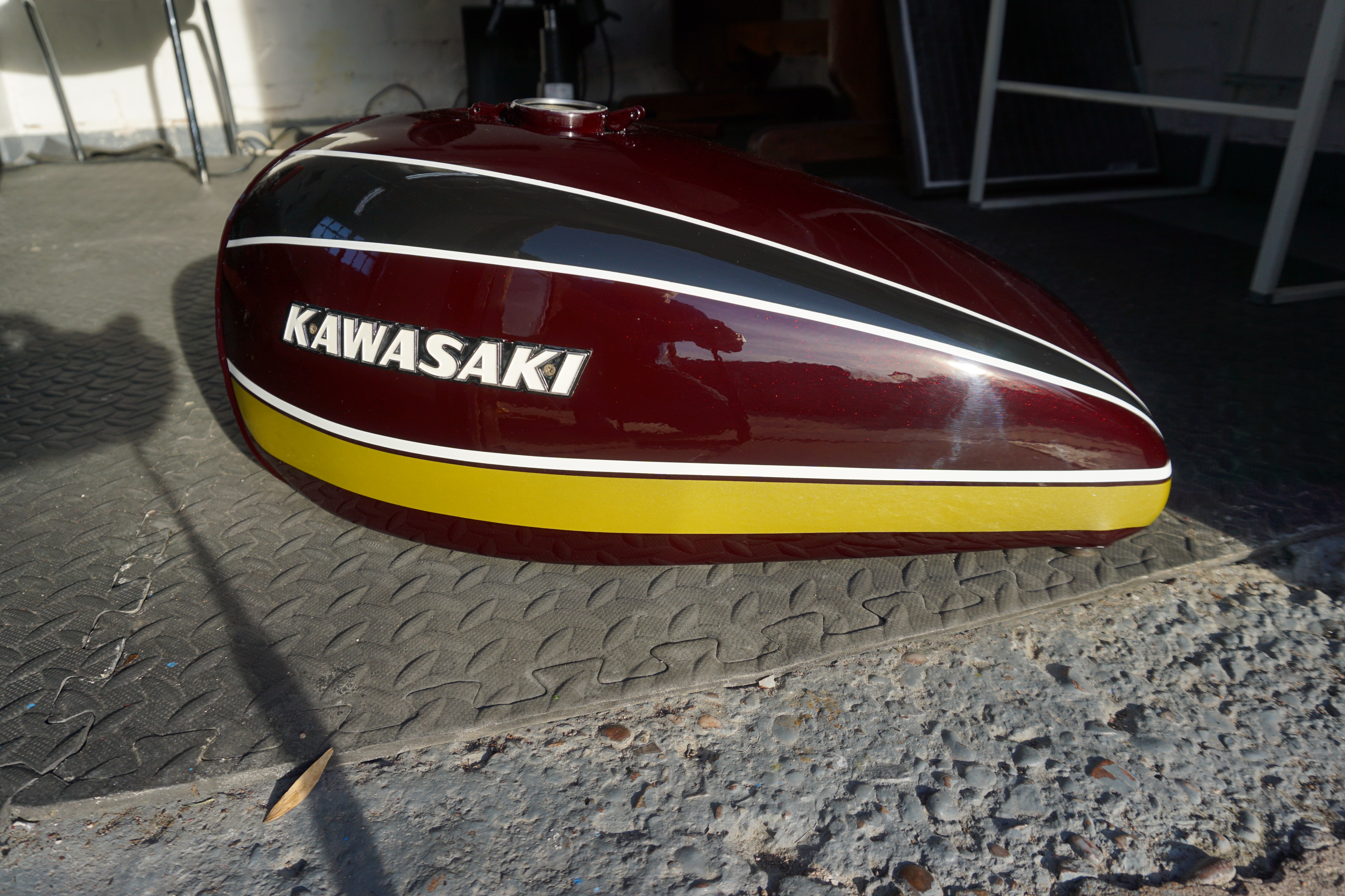

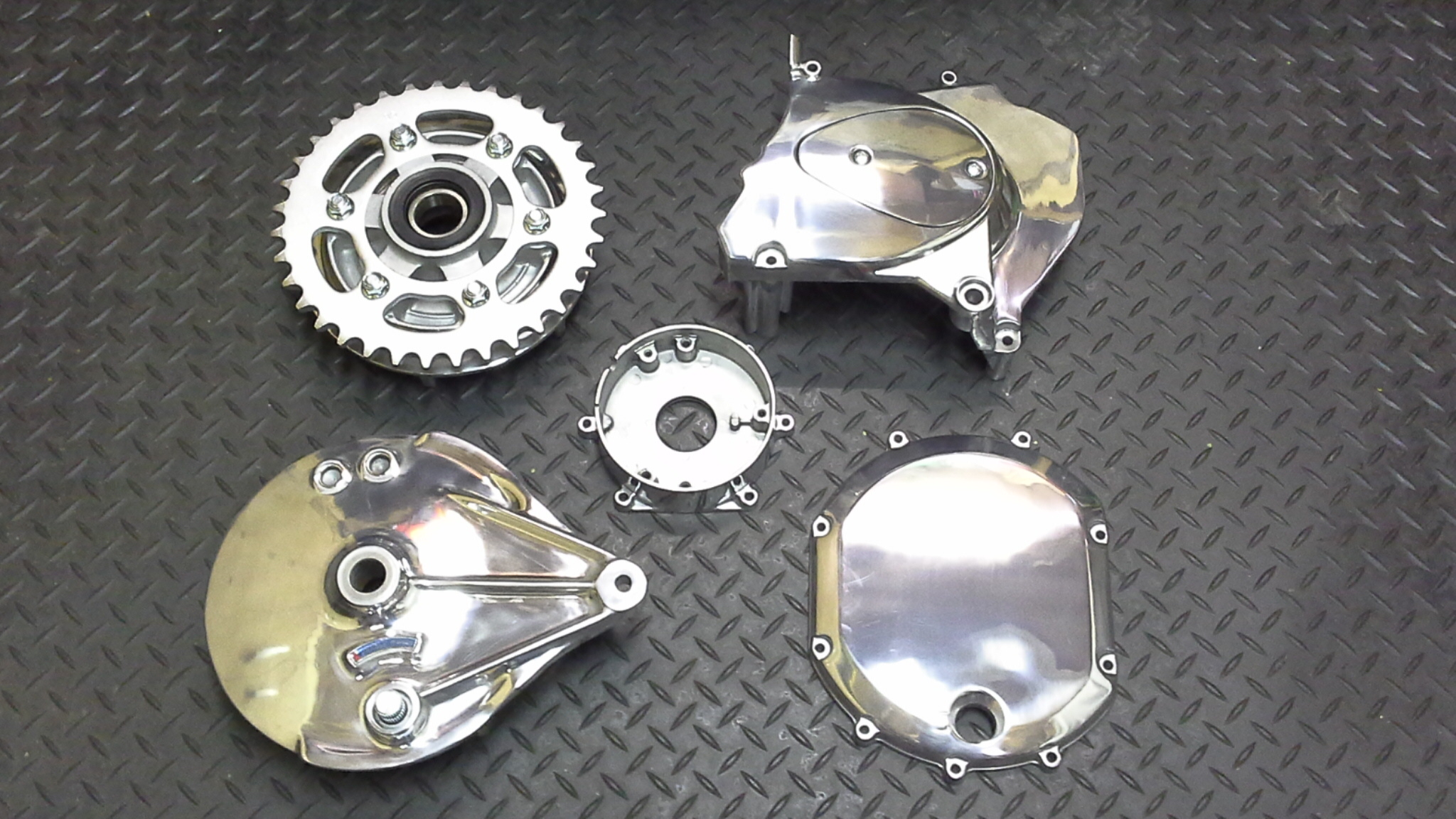

Just thought I'd post a few pic's of the Z1b project i have had ongoing since last year.
It's coming together slowly but surely, I've tried to keep in as original as possible, re chromed a lot of the stuff, refurbed the switches and clocks etc.
Paintwork just back and a sterling job it is,no decals used it was all hand painted to the original colour.
Bit of fun, but spot the deliberate mistake with the bottom cranckcase, just noticed it prior to putting the two halves together. Bit of a senior moment there....
Thanks to Tony at Pit Stop bikes for welding the fork leg.
