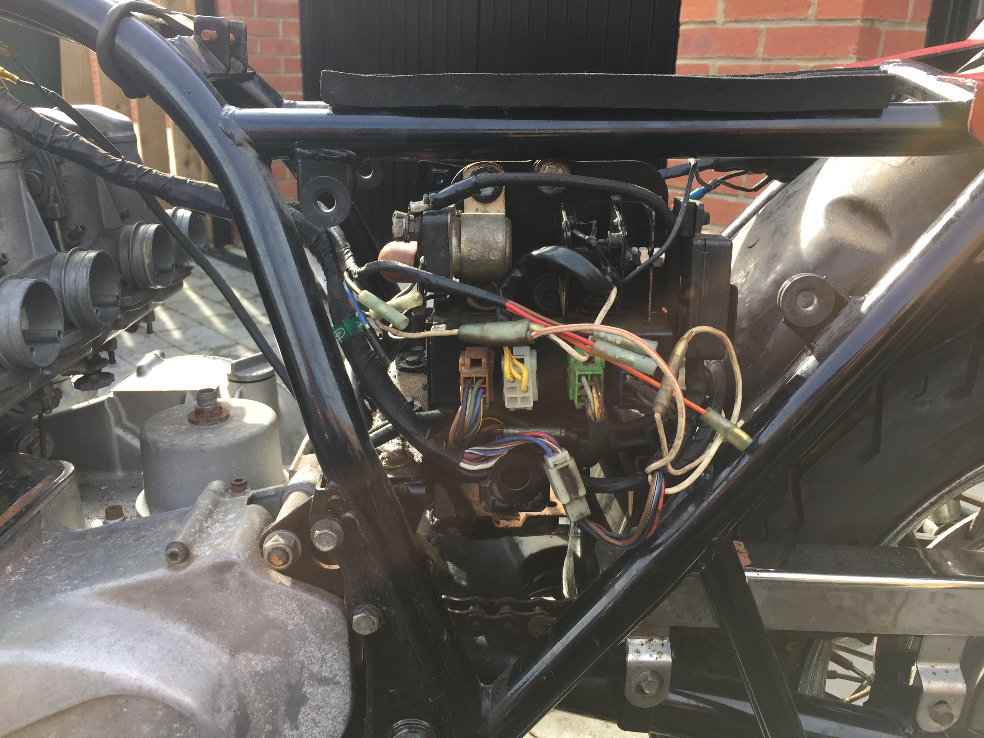

This the current state of play as the stripping continues.
backend off .jpg (143.43 KiB) Viewed 10675 times
These are the new seat brackets all marked and ready to be welded on when I find someone who can do this for me, I also have a side stand bracket ready to be welded on at some point also. This is because the original came with footboards and sidestand attached to those and the seat did not have lift up bracket
I never expected it to be a quick fix (just as well) and I know some of the purists would not be happy that I am taking this to be a a4 but what the hey.
I don’t know what has been complete on the bike before I got it, I have had it running and the carbs are spotless inside no rattles from the engine and the frame has been painted but could do with a refresh. Now its replacing the missing bits and looking for nearby platers I was dropped note on here but those guys have closed down unfortunately so I may have to look further afield.
