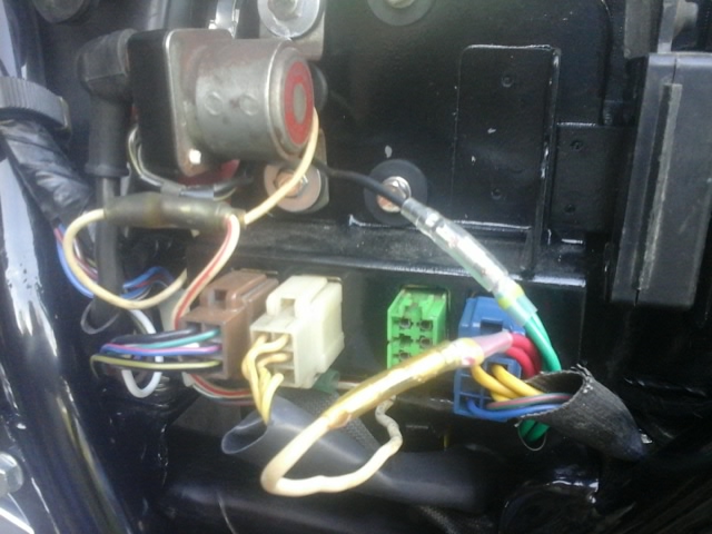

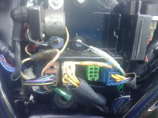

Just finished wiring the Z900a4 restoration and I have a problem, when I switch the ignition on the idiot lights are dull before fading off due to the 20amp fuse blowing.
There has been a conversion as the white plug is missing.
When i took photo's as I stripped the bike, this area was taped up so just cant see how the shinny new white wire and the old white + red/white went together ?? :??
I think this is where the problem is as all other is the same as it came off...
I did not want to guess as I might cause some damage.
Can anyone help out please :??

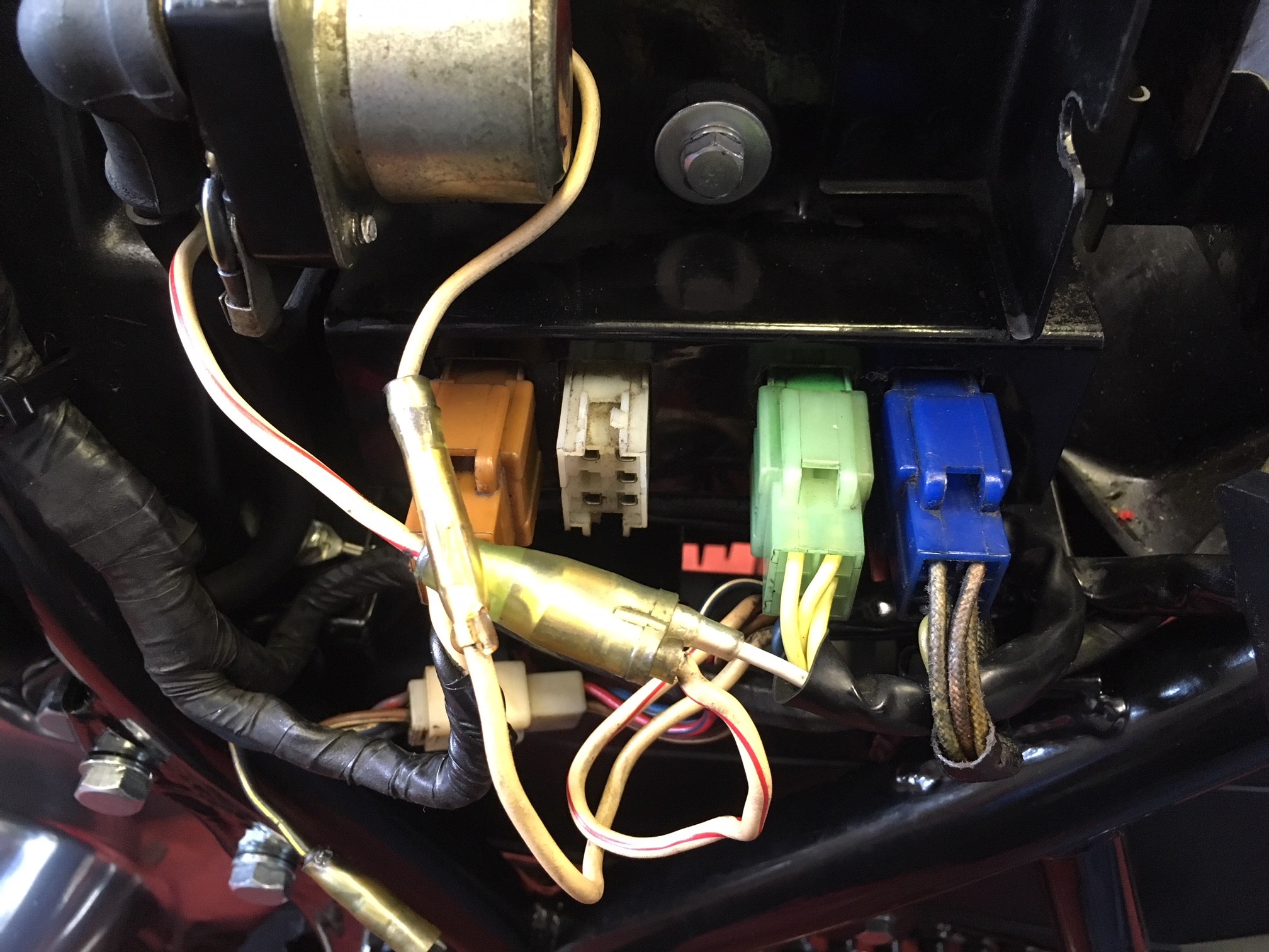

Should the white wire coming from behind the solonoid not fit into the double joint and that white wire connect to the other free one, I have done a rec reg conversion on my z1000a1, the wire schematics show the same, my conversion is on the white plug
DavidZ1R
Posts: 1513
Location: Bolton Lancs
Re: KZ900A4 Blowing Fuses
#7 PostAuthor: DavidZ1R » Thu Aug 23, 2018 8:05 pm
Ignore the yellow wiring on the white plug, I reused the plug and jointed the wires.

DavidZ1R wrote:Should the white wire coming from behind the solonoid not fit into the double joint and that white wire connect to the other free one, I have done a rec reg conversion on my z1000a1, the wire schematics show the same, my conversion is on the white plug
looking at this photo what does the green wire with a red trace go to? as it looks like it is plugged into the black wire going to the solenoid ?

I bought a rec reg off eBay as was suggested by Pauljauque, it was cheaper than a bona fide replacement so I thought I would give it a go, the old reg had failed so tried it. The two greens if I remember where earth's, two reds live feed, I have done about 500 miles with it, it produces 14.5 v at the battery. If it fails I will just have to buy a genuine one, but hey Ho for now :D

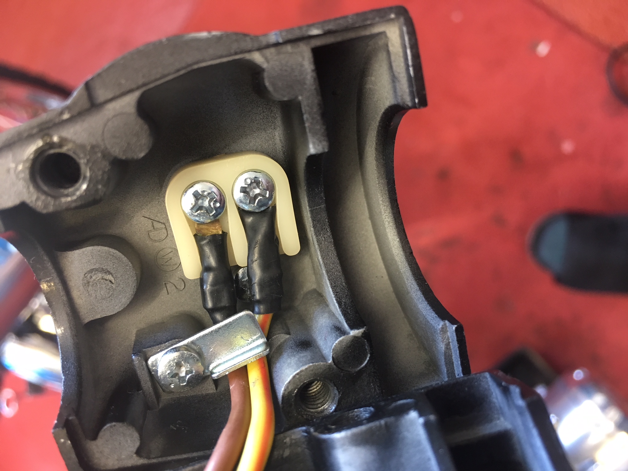

The fact that everything works when you remove the switch from the handlebars would suggest the switch is shorting to the bars, possibly through the switch housing. If it was the solenoid removing the switch would make no difference.

Looking at the picture, I would say the screw mounting the red/yellow wire is shorting to the switch body. Which, is shorting to earth through the handlebars when the switch is mounted to the bike. This is why it works ok when the switch is removed from the bars.

Think you have the white wires wrong, you should have the white feed from the battery with the double joint, into that goes white/red wire from the fuse box, and the white wire from behind the solonoid into the double joint, the other goes to the white feed wire from the reg / rec, that's how mine goes, no problems
