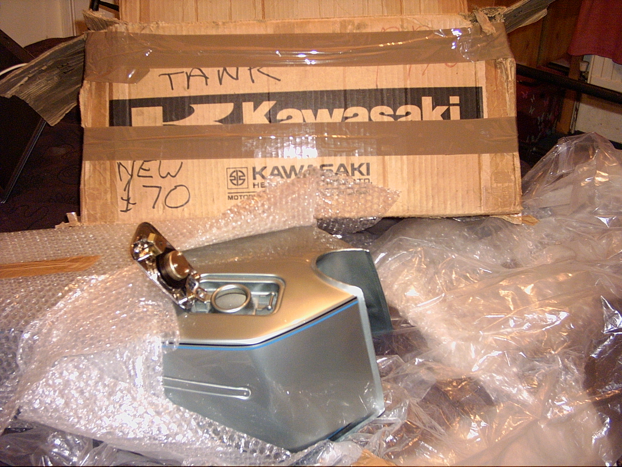

you can stick the codes where the sun don't shine its in the mixing
had a batch done by rs paints too much fleck in it ? done from a nos tank not seen the light of day bike body work done by andrew parnaby good painter ? all was N O S PARTS every thing when put to bike all the shades were diffo ?
1000s body work done by hutchy less fleck in it ?

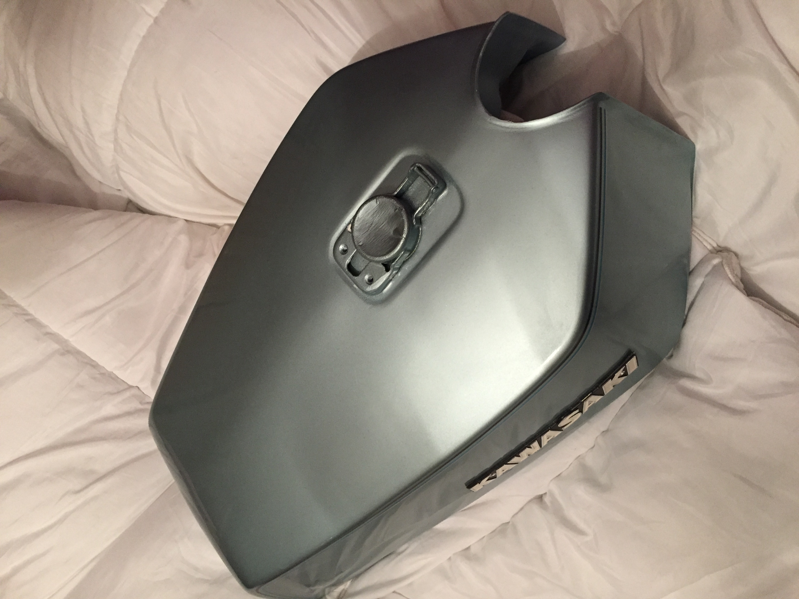

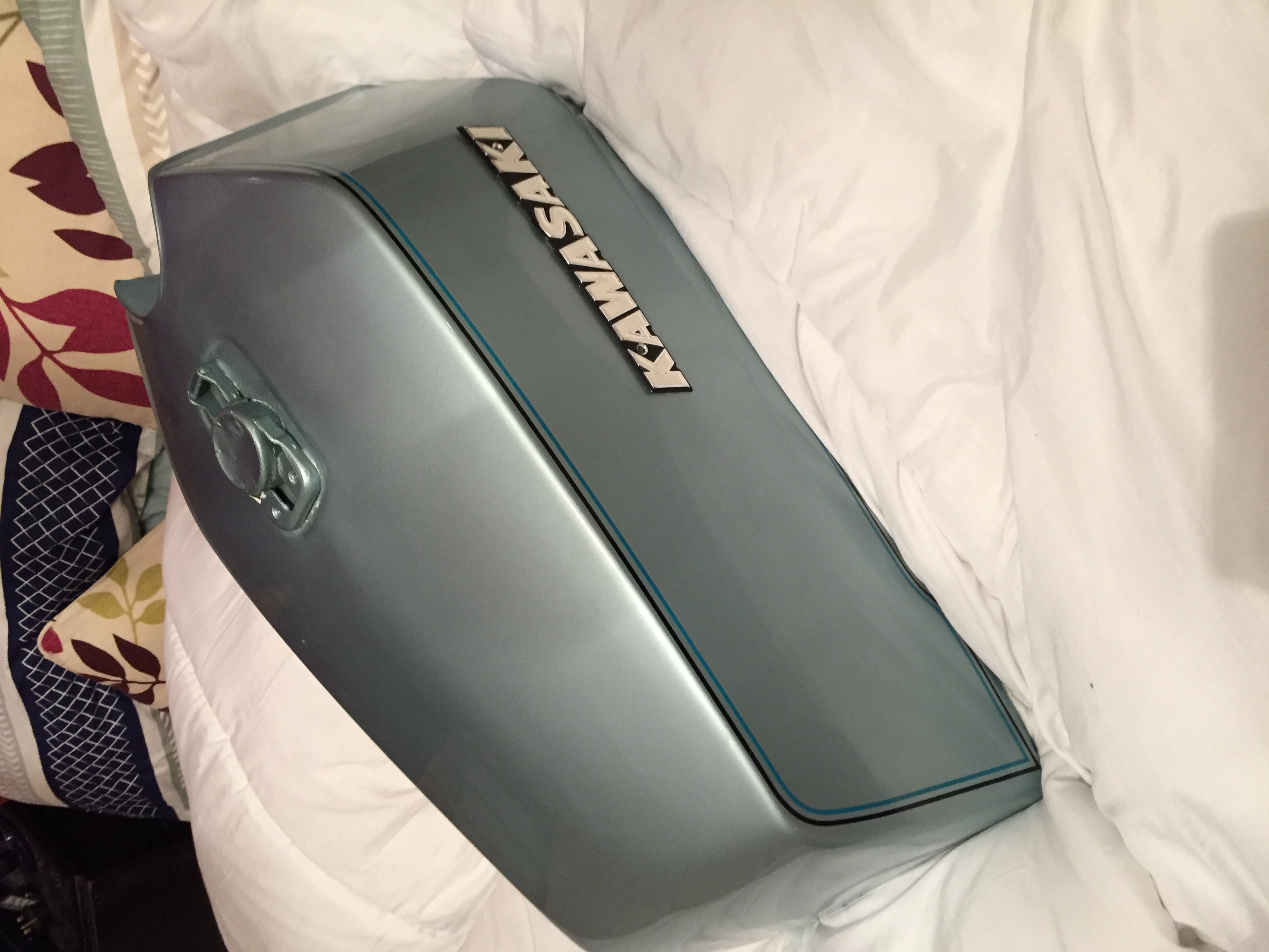

heres my log range tank just back from painters perfectly matched
to my original paint Z1r what a painter
