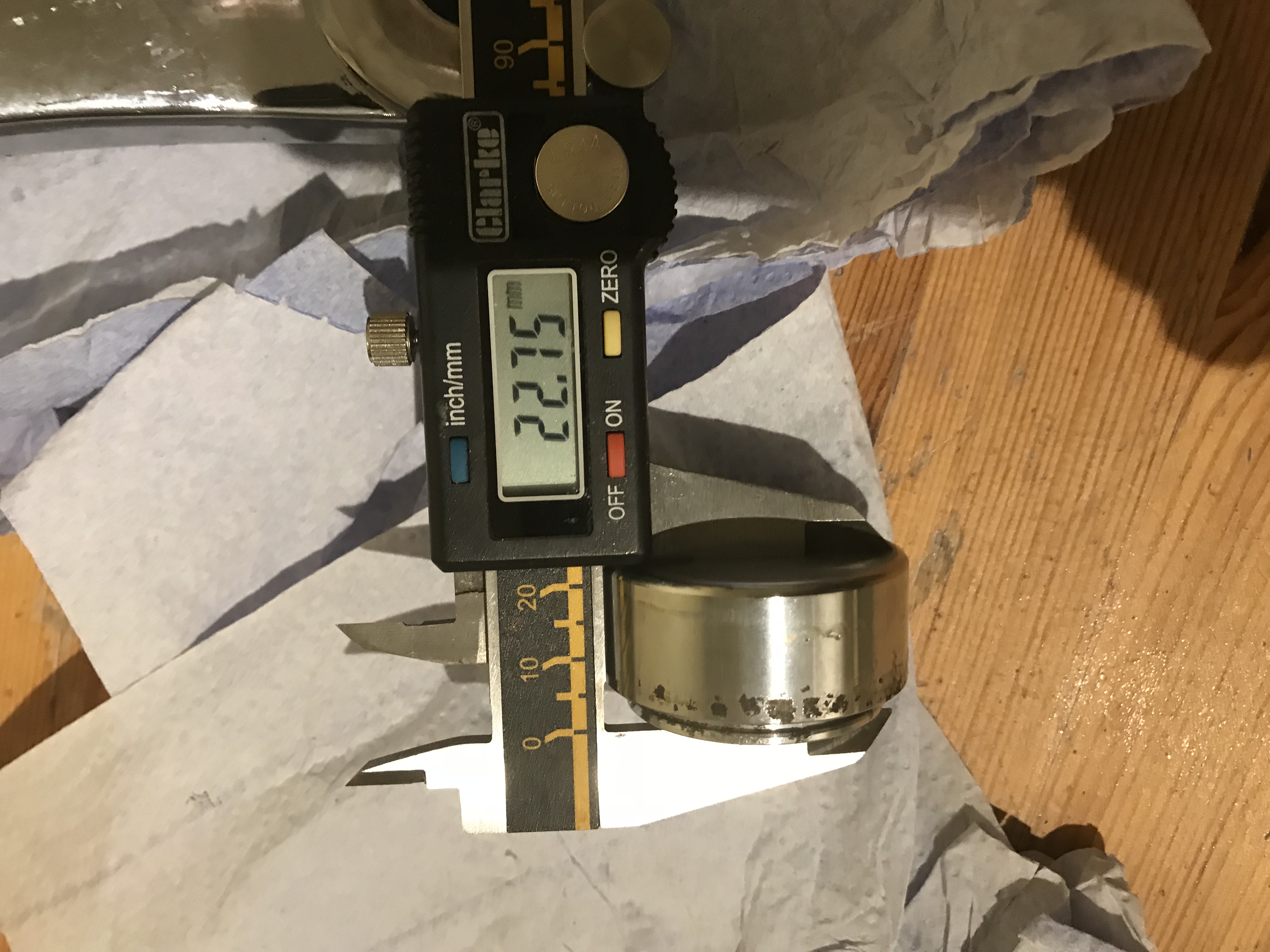

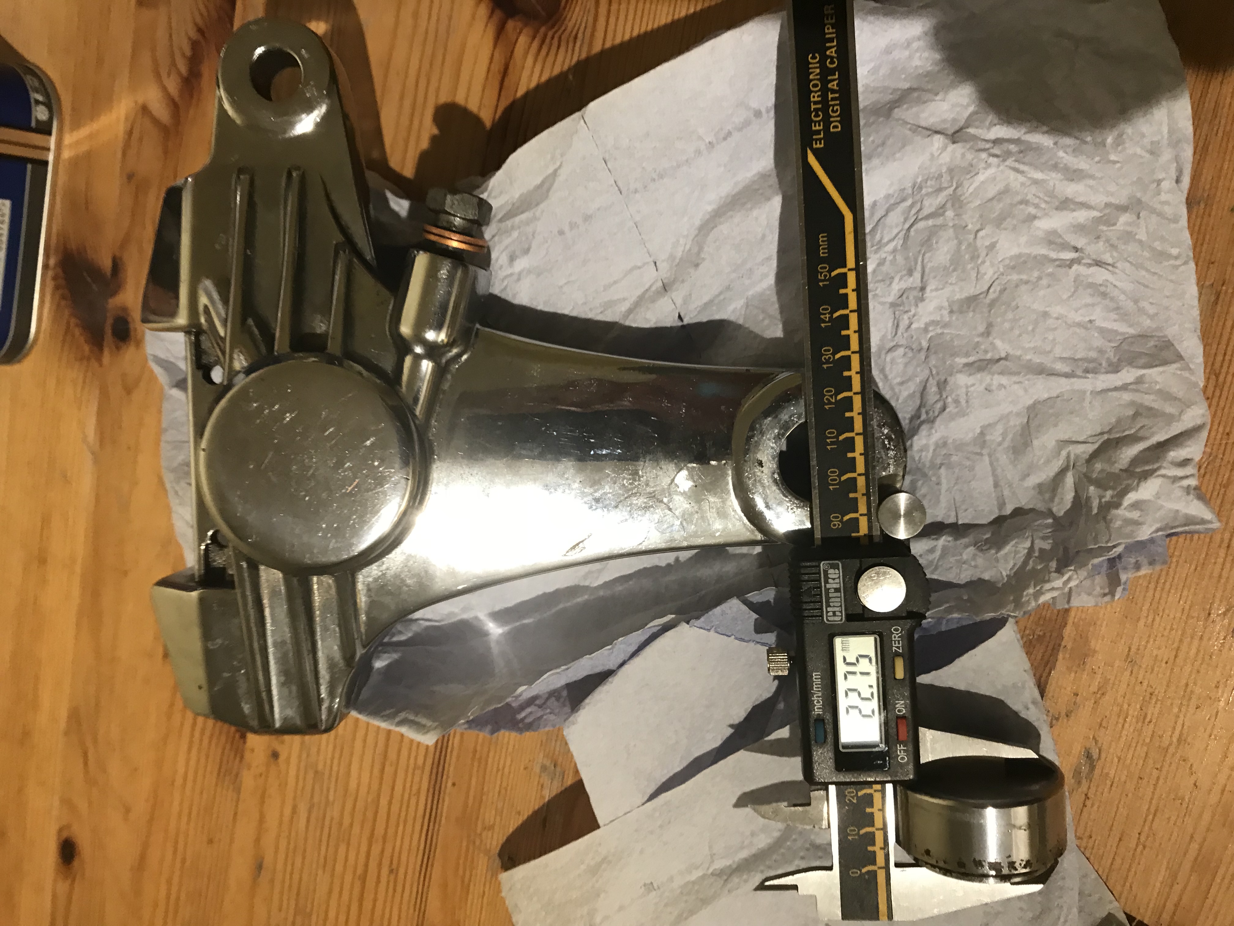

Guyz ,Looking for some dimensions if anyone has a z thou a1 or a2 caliper in bits,need piston dimensions diameter and length,gap between piston bores when pistons fully back,.....got a rotor here 7mm,new pads are 9mm apiece,disc rotor is dead central,thinking may have mismatch of bits,reckon would need to lose 3mm at the mo so brakes wouldnt bind..Ta Paul J

#4 PostAuthor: ADRIAN H » Mon Oct 15, 2018 6:09 pm
Diameter 42.74mm
Depth 22.75mm
Distance between retracted pistons 22.6mm

#6 PostAuthor: ADRIAN H » Mon Oct 15, 2018 7:52 pm
The disc is 7mm will check the pads pretty sure I couldn’t use the anti rattle shims and had to file down the pads to get them to fit.
Will check pad thickness tomorrow.
