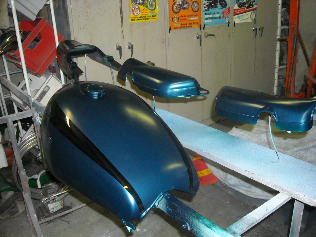

Hi men
a quick update!
The blue paint isn't water based after all. My paint supplier was able to get it on thinner base. Good for me as I have no experience in spraying water based paints.
This was the result after the first attempt, the fuel tank with the black paint recieved a coat of clear coat. After it dried, the black stripe was mesured, a little sanding with wet ot dry n° 1000, taped off and the blue paint was sprayed.
Immediately after the paint had set I removed the tape and... oooohhhh I made a mistake in measuring the thickness of the black paint stripe. S**T happens.
I waited a few days untill the blue paint hardened completely and started the measurements all over. A thin tape was added, the blue paint was sanded off so that the black paint underneath appeared again.
I decided to give the whole fuel tank and the tail piece an extra coat of varnish...
Something went wrong...the clear coat became white!!! S**T happened again. I know nothing about chemistry so I had to sand the fuel tank and the tail piece again.
The results were a disaster...I had to respray a part of the fuel tank with the blue paint and the tail piece completely. A major setback. But that's life.

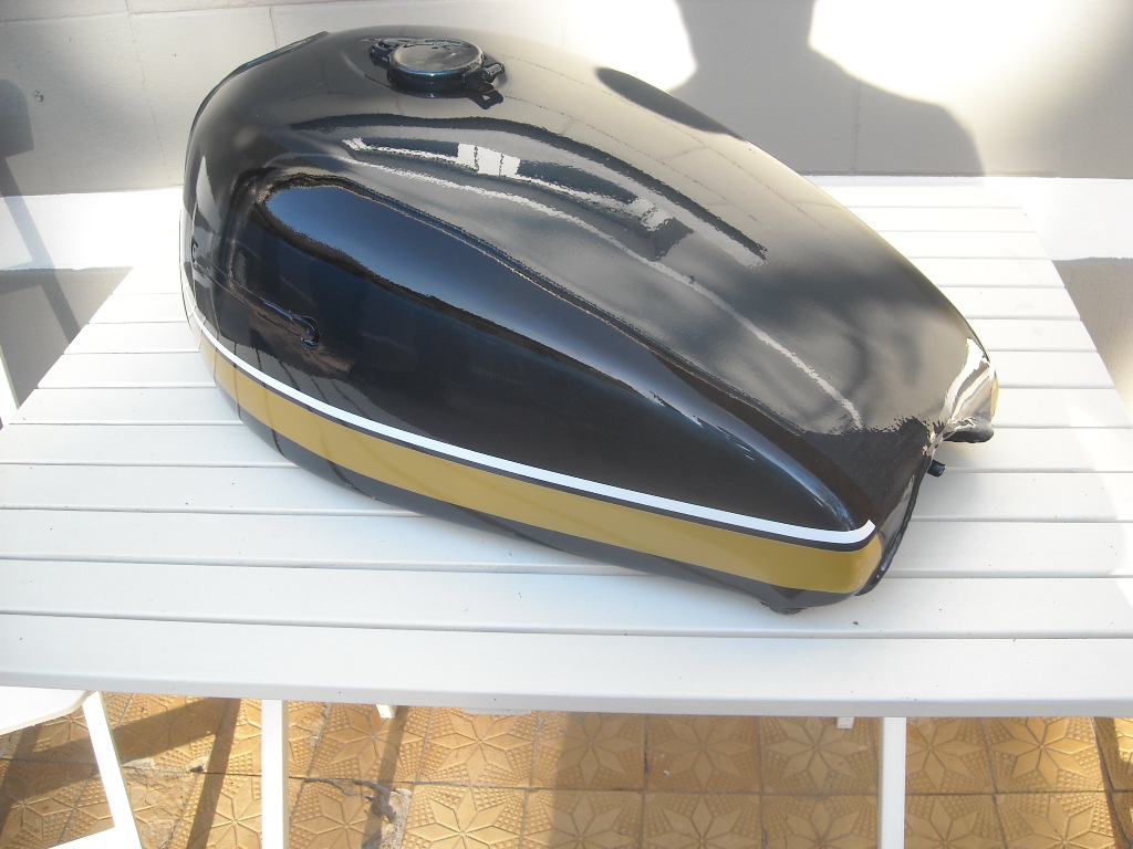

Yesterday I decided to use a different clearcoat...
There was a good temperature but there was a bit too much wind. Anyway a clear coat was applied...
Bad idea, very bad idea. Due to the wind there must have been dust and silicones in the air .
And yes, all over the freshly sprayed clear coat there were "little silicon eyes" OMG I was pissed off.
This morning: sanding with sandpaper n° 1500, n° 2000 , degreasing, cleaning with a tack cloth and a respray with clear coat.
Finally success! Haleluya!
Just see for yourself, I'm rather satisfied about the result.

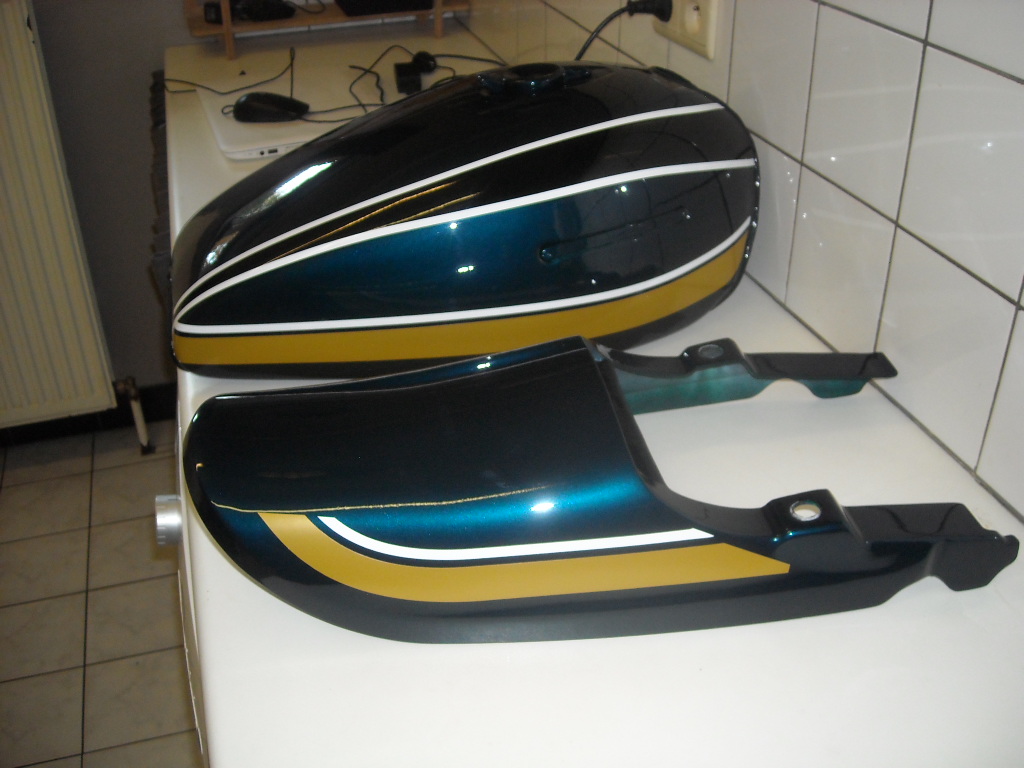

Hello men
I'm back and this time with good news!
The decals are on the bodywork and I'm satisfied with the results.
It was the most difficult task I did in applying decals on fuel tanks ever. If you have no experience in applying decals, don't start with the Z1B decals!
When applying decals you need some simple tools:
a pair of scisors, a measuring instrument, fine adhesive tape, a piece of rubber, paper towels, a spray bottle with water and a drop of dishwashing soap, a hobby knife with a rasorsharp blade and a lot of luck!
Start with determining where which decal must come and cut out the decal from the sheet.
Remove the protection paper from the underside of the decal so that the glued side is free. Don't remove the protective film!
Moisture the body part and apply the decal. If it's not in the correct position don't panic, the water allows you to remove the decal and reposition it.
When it's at the correct place, start putting pressure on it by hand at one side. Slowly work to the other side. Push the water away from underneath the decal to the sides of it. When it starts to adhere, take the piece of rubber and put some more pressure on the decal, again work from the centre to the sides.
Start removing the protective film, do it slowly and follow with one hand to prevent the decal to lift.
Finally take a paper towel and dry the decal.
It takes a lot of practice, time and effort but in the end you'll be pleased with the results.
Remember that you have to put a 2 dimensional decal on a 3 dimensional surface.
See for yourself:

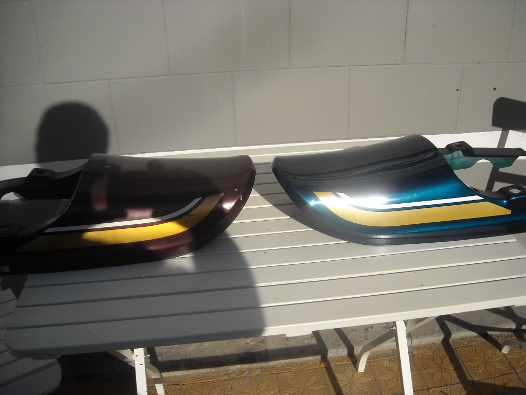

I'm a lucky bastard because I could use original Z1B parts from a friend in France to compare.
The original tail piece I could use is a red one but the colours of the decals are the same.
You have to start somewhere, I decided to start at the bottom...
and to work my way up.
The most difficult part for me is to get a more or less symmetrical result.
Measuring doesn't work for me, remember the black stripe in the previous post...I have to do it "on sight".
Compared with the original fuel tank, I'm satisfied with the result.
The parts are waiting now, they must dry completely and that could take a few days.
The final step is to put a protective clear coat on it.
Hope and pray with me that it will turn out correctly in the end.

And did the inside of the tank need prep?
Re: Z1B Restoration
Hi Damien
in a garage they have to think commercially, it's their way to make a living.
I did a full restoration of a '73 Z1 once for a gargekeeper as I would have done it for myself and it left a bitter taste. I had to wait for my money and afterwards I heard nothing from him anymore... So I decided to do only restorations for myself.
As you say, it's done with love!
And no, the inside of the fuel tank didn't need any preparation, lucky me! If it needed to be prepared it would have been done before the painting in order to avoid damage to the paintwork.
