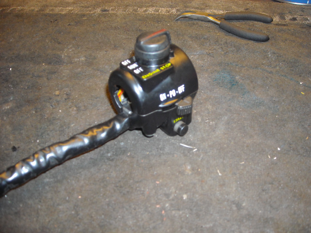

Hi men
did some more "work" on the bike last week.

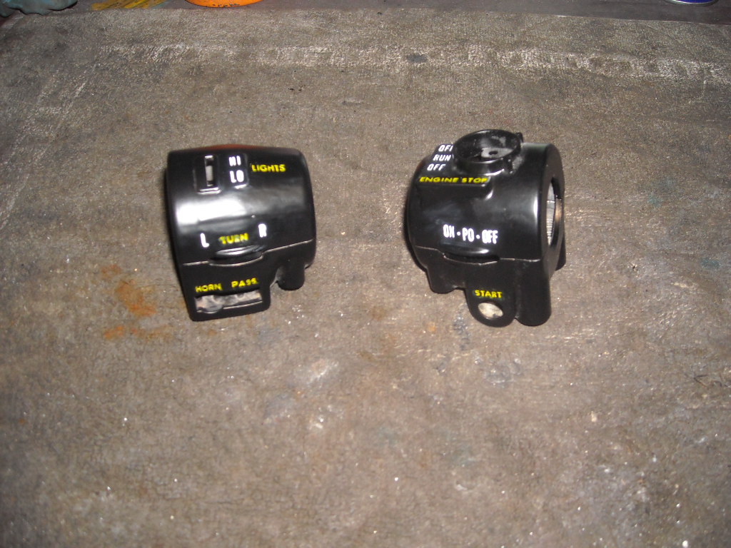

I assembled the handlebar switches.
They were painted satin black a few months ago and yesterday I painted the lettering on them.
White and yellow as they were originally.

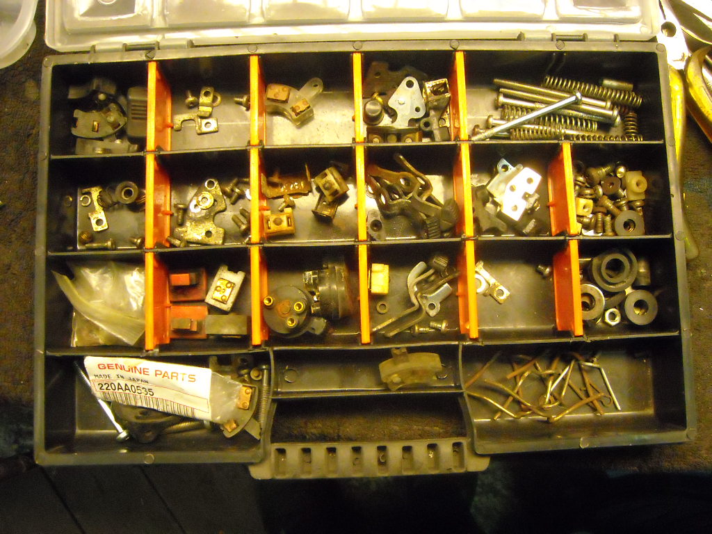

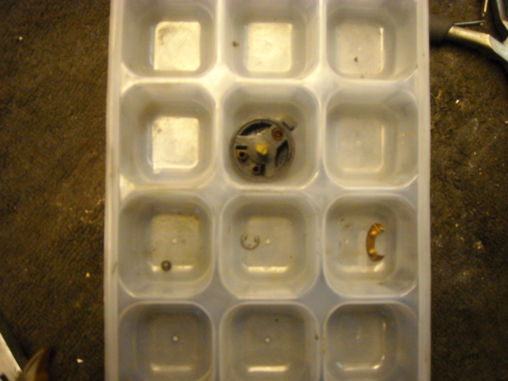

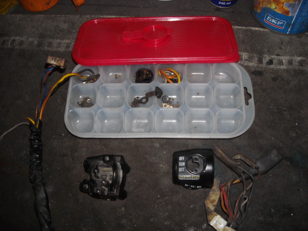

I keep the little parts from inside the switches in a little container for making ice cubes, it's small, it has a lot of seperate boxes and a lid to close in order to keep the parts where they must stay.

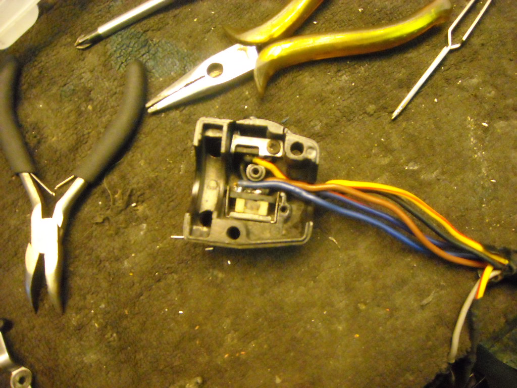

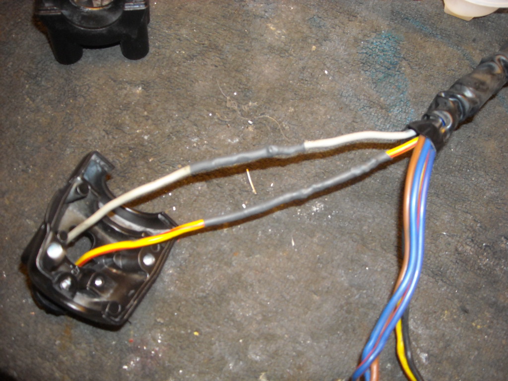

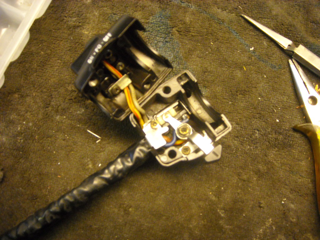

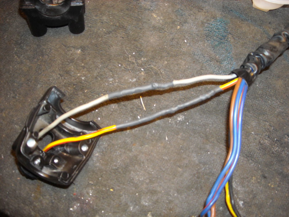

As you can see the two wires that run from the killswitch were cut in order to free the kill switch from the casing.
Those older switches have the wires soldered on the switch, the newer switches have two little screws.
I soldered them together and insulated the wires with shrinking tube.
Don't forget to run the wires through the holes in the upper casing before reconnecting them!
After that it was time to reassemble the killswitch.

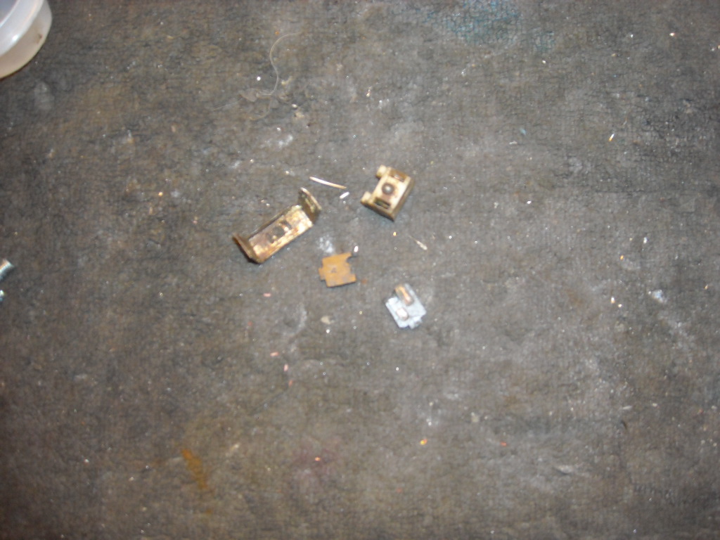

There are some little parts in the switch: 3 springs, a V shaped copper plate and a tiny steel ball.
Don't loose them! Put everything at the correct position and close the switch with a C shaped circlip.
Try to do this when you're calm and when your hands don't shake!
The upper casing is reassembled, now it's time for the lower casing.
There are 2 switches in the lower casing, the starter button and the light switch.
Start with the starter button. Put the black button in place, take the spring and the insulator plate with the wires and put those in the correct place (mind the place of the wires!) There are raised lines inside the casing where these parts must come.
After they're in the correct position, put the little metal plate above them in order to keep them in place and secure it with a little screw.
Then it's time to install the light switch. Hopefully the little brown plate didn't crack on your switch. I had to replace it, a precision job! The three wires may not touch eachother.
I have a lot of spare parts from older switches, if you have old switches, don't throw them away! Disassemble them and keep the parts for spares.
Again make sure that the switch is in the correct position
After that it's time to install the little handle.
You've noticed that there are a lot of little metal plates with different shapes and sizes. They all have a specific place inside the casing and a specific purpose. You allso have to put them in the correct way. These plates hold the switches and the wires in place.
When the interior switches are in place, it's time to secure the loom in the casing.
If the black plastic hose is undamaged, I use it, if it's damaged I replace it but that's another story!
Make sure that the black hose is inside the casing and secure the loom with the metal plate and screw.
Last but not least the black plastic hose is cleaned, there's allways a lot of dirt and grease on it. Clean it and "feed" it with some tire spray. It becomes shiny like new.
That' all for the right hand switch.

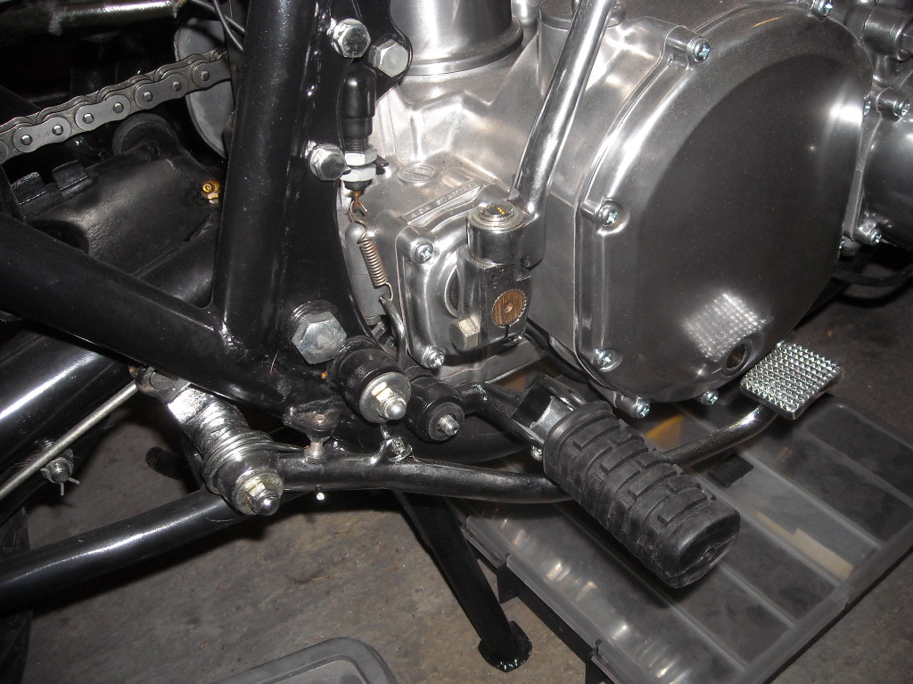

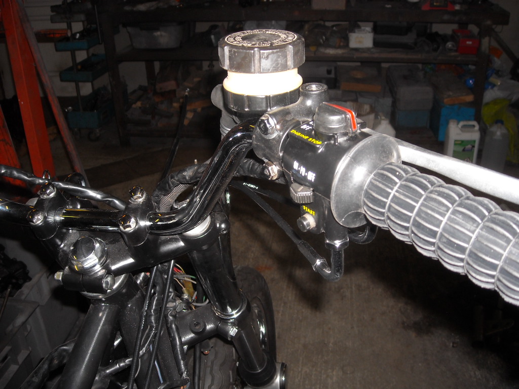

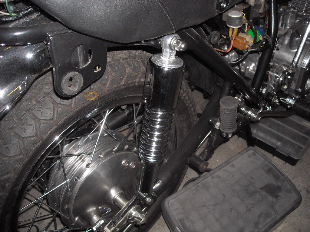

Hello men
a bit of an update since my last posting.
The seat recieved an opholstery and is placed on the bike. On december 10 th a big box arrived from Germany with a few parts.
The rear shocks are mounted
I was allso able to mount the handle bar and a few other bits.
The head light mounts arrived and are installed
And the footrest rubbers arrived and so I could mount the footrests
Nothing spectacular, I know but it's another few steps towards completion.
This weekend I'm going to central classics in Houten, Holland, who knows what I can find there...
More to come in the next few weeks.

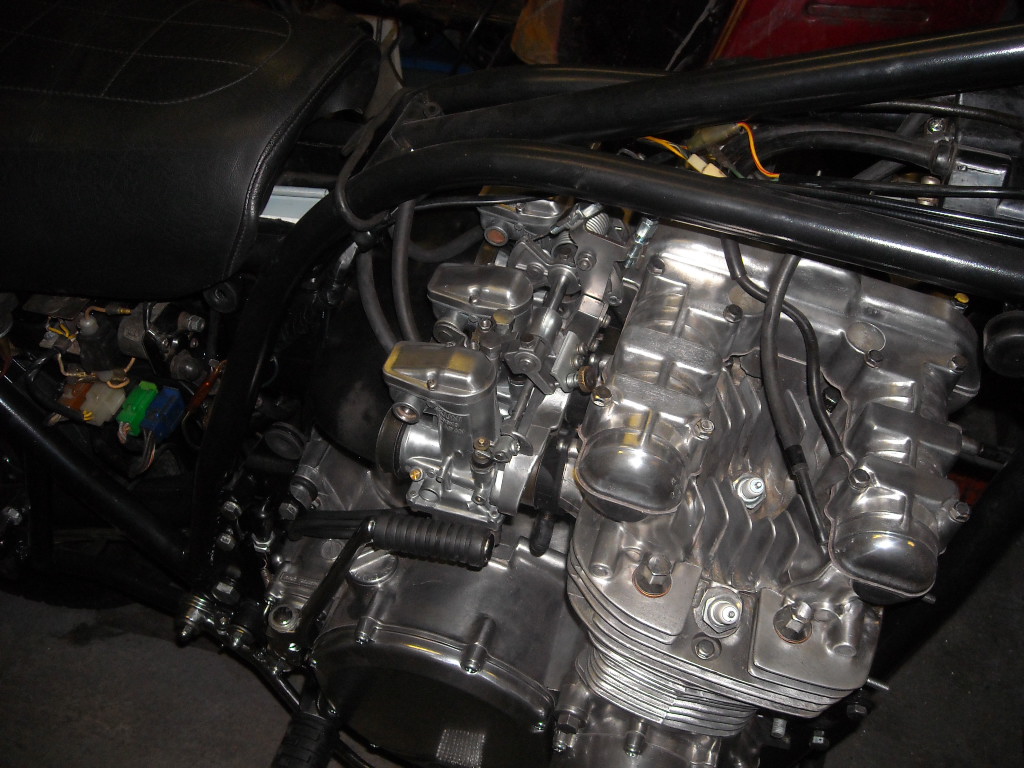

Hi men
a little update:
In Holland I bought the carb rubbers so I was able to mount the carbs. The throttle cables were installed and adjusted.
As you can see there's still a lot of work to do but she's taking shape. Within a week I'll make another order and then the restoration can continue. I hope I can mount the fuel tank and the other bits.
More news within a few weeks.

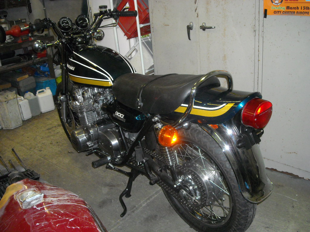

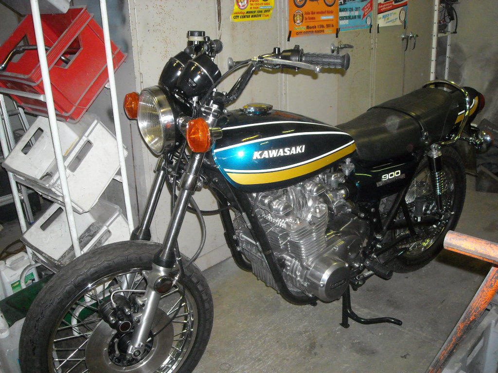

Hello I'm back
the restoration goes on, slowly but surely.
A box arrived last friday so I did a bit of construction during few spare hours in the weekend.
The box contained indicator stems, a grab rail, the seat lock mechanism, a cockpit idiot light cover and some more bits.
As you can see she's looking very much like a Z1B, I know there are parts missing but compared to what I started from...
She still needs a chain guard, a front mudguard and a 4 in 4 exhaust. Nothing difficult, just a bit of money and time. I hope to finish her by the end of march.

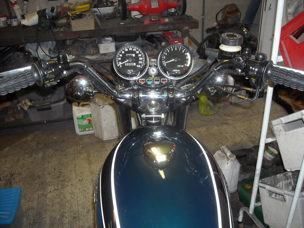

As you can see the clocks are in place and the wiring is done. Just a couple of mirors and a clutch lever bolt to attach. Notice the key holder rubber instead of the "black hole".
More news to come next month.
