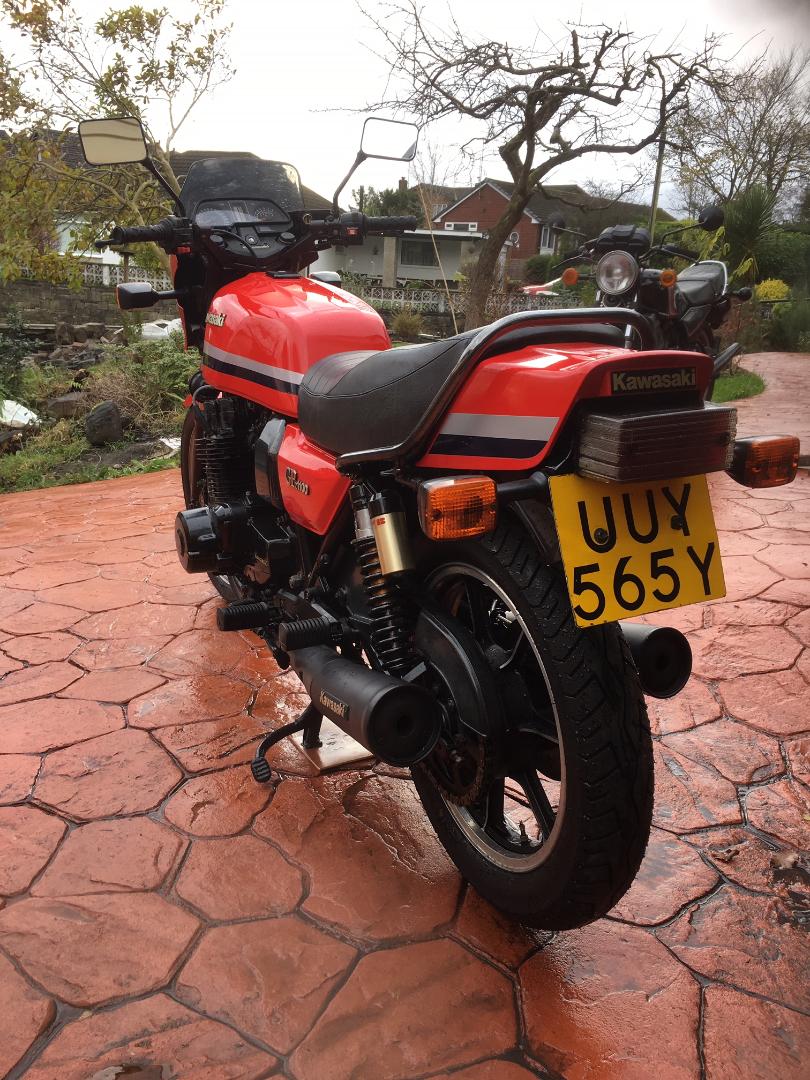

here you go scott zrx shocks on my b2 but i had to alter chain guard a smidge.
scott
Junior Section leader
Posts: 1395
Joined: 19th Sep 2007
Location: PORTSMOUTH
Re: Rear shocks
#12 PostAuthor: scott » Fri Nov 30, 2018 3:23 pm
Very nice bike mate
