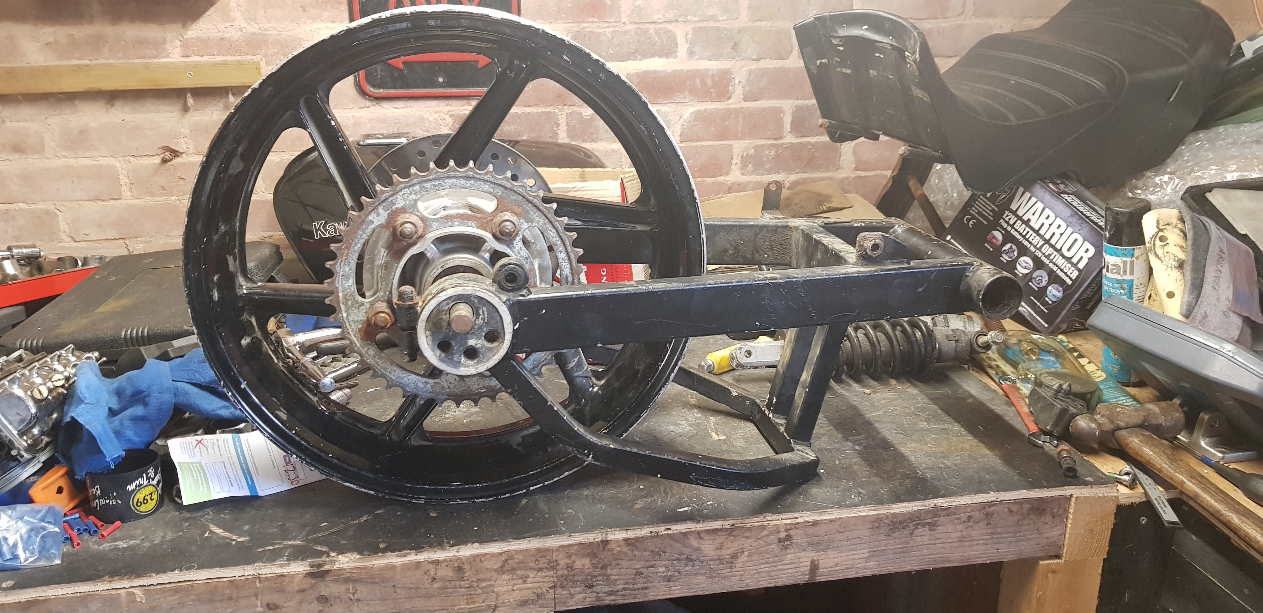

#22 PostAuthor: Swirl » Tue Mar 12, 2019 4:47 pm
Bit of playing today, happy days, chain run looks like it will fit inside the frame to. :D

Re: Mk2 twinshock swingarm options
#23 PostAuthor: needaz1100r » Tue Mar 12, 2019 5:22 pm
Swirl wrote:Bit of playing today, happy days, chain run looks like it will fit inside the frame to. :D
But it probably won't be easy to line up with the gearbox sprocket like that!

#24 PostAuthor: Swirl » Tue Mar 12, 2019 7:52 pm
Your right it definitely won't :lol:

#25 PostAuthor: zed1015 » Tue Mar 12, 2019 8:17 pm
Is that wheel a 5.5 inch rim ?
If it is you want and 5/8th offset front sprocket and with the rear wheel true central you want the sprocket carrier face 101mm from the centerline.
That will get the sprocket alignment millimeter perfect and the chain will just slip past the tyre and frame with a few mill clearance.

#26 PostAuthor: Swirl » Tue Mar 12, 2019 9:37 pm
zed1015 wrote:Is that wheel a 5.5 inch rim ?
It's only the 4.5" I may source a 5.5" fireblade wheel is the same but I've got this complete so going with this for now, with a 160 tyre, I've also got a offset sprocket from my spare zed engine, somehow I've ended up with 3 engines and one bike :lol:
Thanks for the Info will come In handy :)
