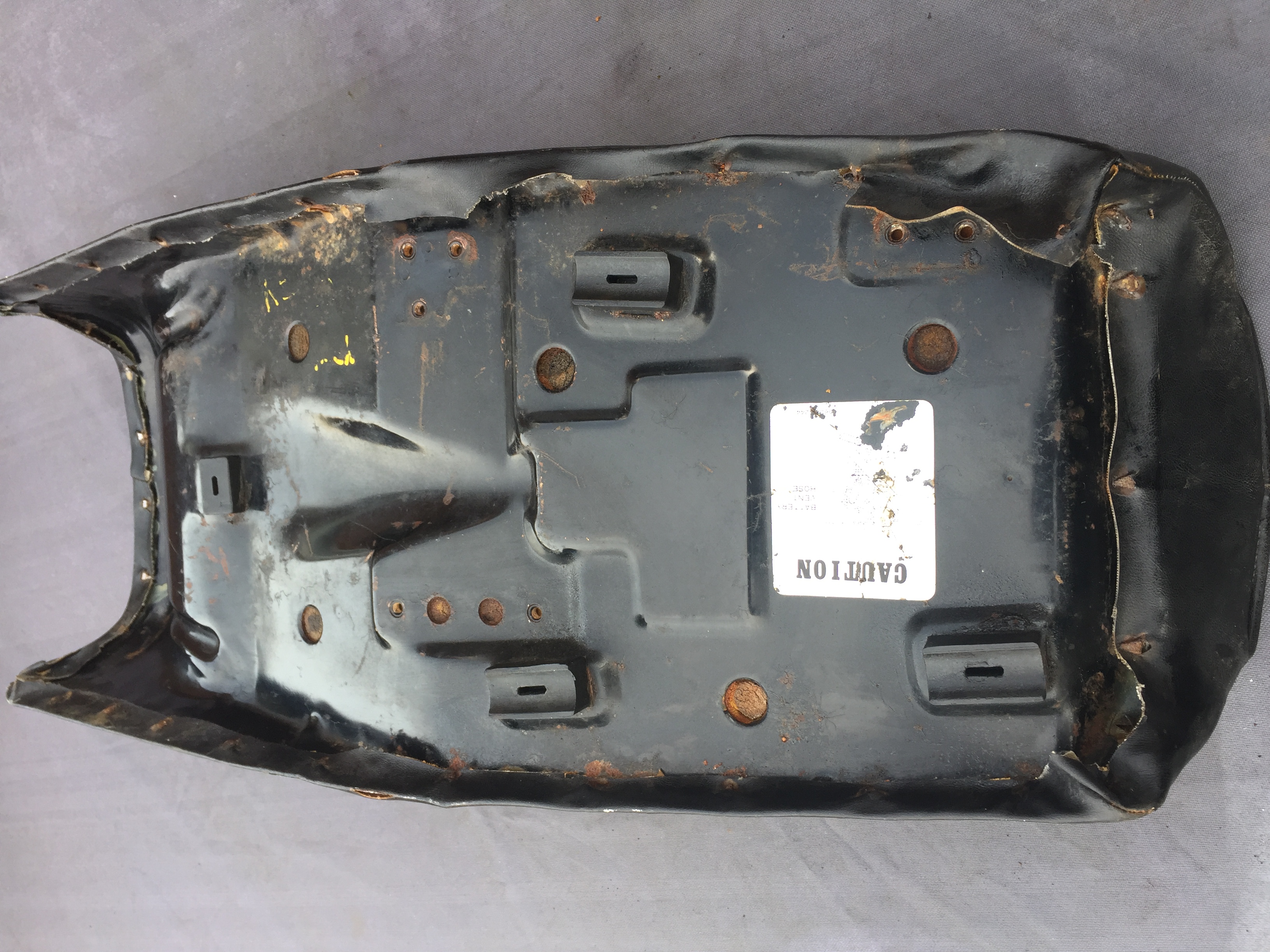

Does anyone know the location of the part no. on the mk2 seat pan, I was told awhile ago by the previous owner that he had bought a Z1000ST seat by mistake, this seat came with the bike when I brought it home.
Today I thought give it a clean up and put it on eBay, while cleaning the pan I noticed the info sticker and although the part that states the model type has some damage still visible are the letters A3A and apart from the emission info part number everything is the same

#4 PostAuthor: Gavin » Fri Feb 22, 2019 10:50 am
Morning Phillippe
I hope these pics are enough to identify the seat. As can be seen it has no brackets so has not been put on to see if it fits

#5 PostAuthor: Gavin » Fri Feb 22, 2019 11:04 am
Phillippe
I have just seen the pics you posted on the differences between the ST and the MK2 (wish I had looked earlier ), and the seat I have has the 3 holes for the rear seat hinge,

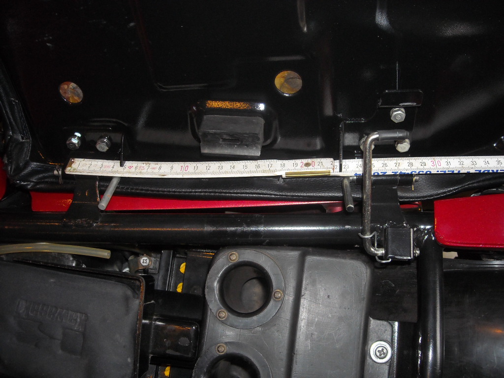

Posts: 2052
Re: Mk2 seat part number location
#6 PostAuthor: Philippe » Fri Feb 22, 2019 2:31 pm
Hi Gavin
the one you have is a MK2 seat pan.
The distance between the centre of the first bolt hole of the front hinge and the centre of the last bolt of the rear seat hinge is approx 275 mm.
approx 275 mm
The distance between the centre of two seat rubbers on either side (from left to right hand side) of the seat pan is 185 mm. If you have the seat hinges and the lock bracket it's complete.
A hard to find object, are you sure you're going to put it on ebay?
