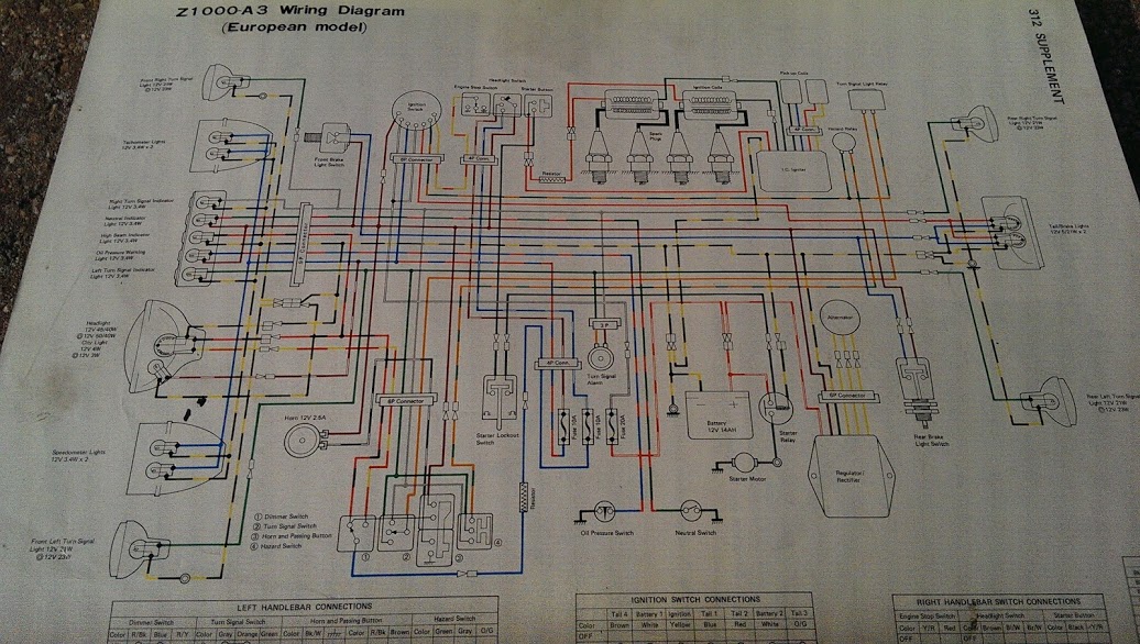

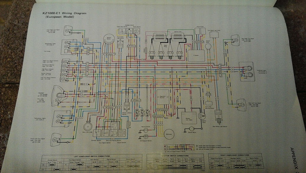

the ST will have a wires for a Fuel Gage and they both have Hazard lights looking at the wiring diagrams the MK2 mite have a turn signal alarm

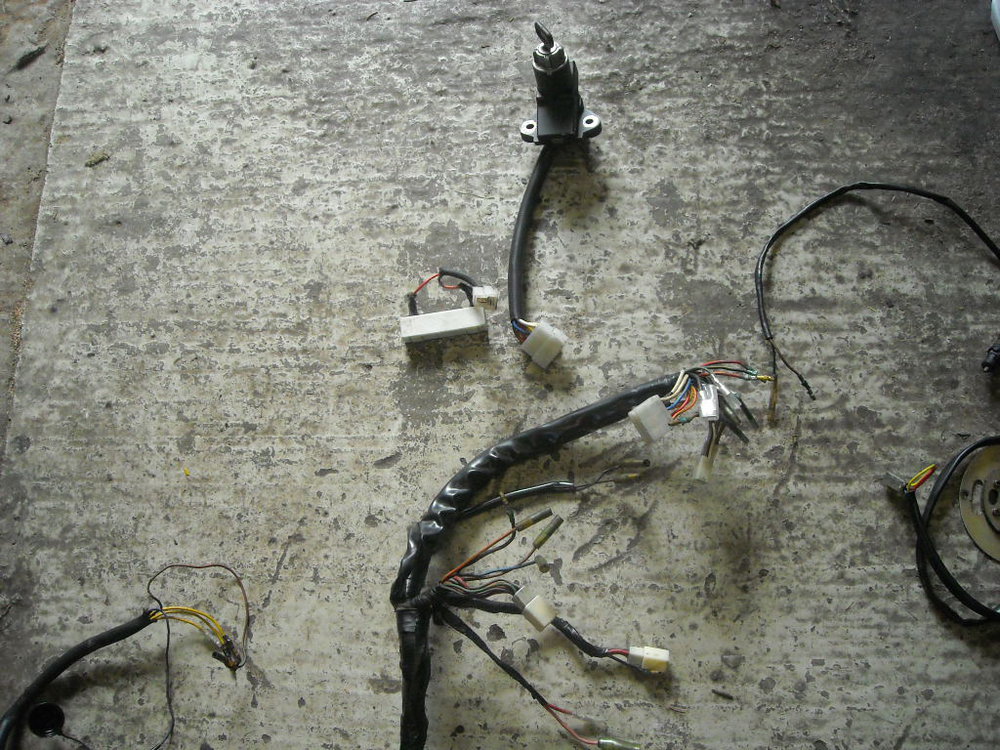

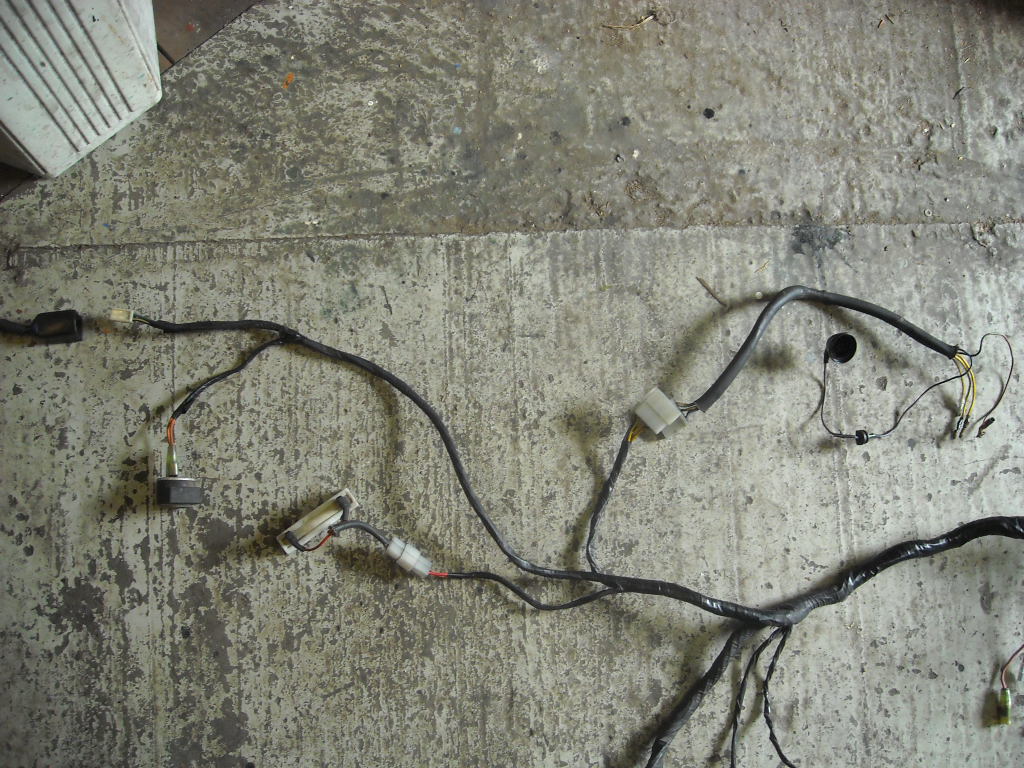

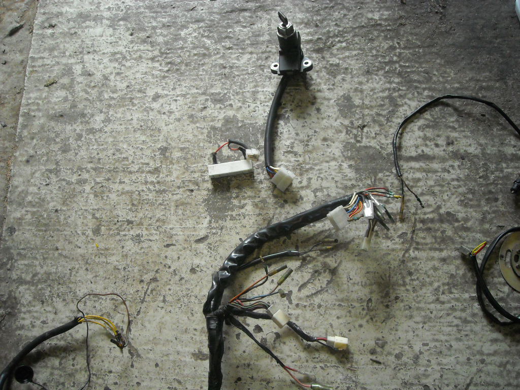

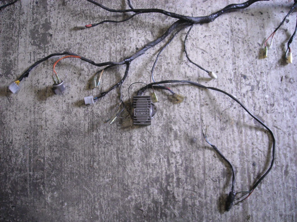

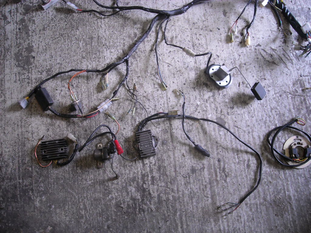

Hi Dave
as promised, a few pictures.
It might seem a bit of a mess but I'll try to give you some explanation with the pictures.
We'll start with the right hand side of the bike, the first picture is the layout of the ST
You have the fuel gauge in the fuel tank.
We move backwards: under the battery box: the electronic ignition
on the right hand side of the battery box: the hazard warning relay and the regulator/rectifier on a triangular plate
at the back of the battery box: the starter solenoid and the fuse box
Now the left hand side of the bike:
you have the resistor for the ignition coils and the flasher relay
further to the back you have the small loom for the rear light and the indicators.
Now for the MK2
on the right hand side of the battery box you have the electronic ignition and the hazard relay
on the left hand side of the battery box on a big plate you have: the flasher relay, the fuse box and the regulator/rectifier
On the battery box, at the front, you have the starter solenoid.
The coils resistor is situated at the front of the chassis, under the fuel tank
There's no fuel gauge.
As you can see a lot of parts have a different place. I used an ST loom to take the pictures, I have no spare MK2 loom.
I would go for a repair of the old ST loom. Less work than adapting a MK2 loom!
Good luck
Now for the MK2
Good luck

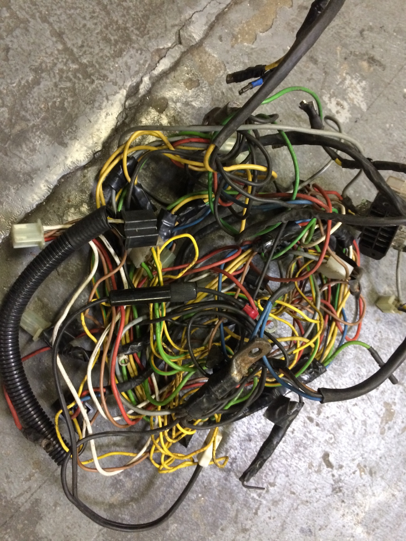

Re: ST Wiring loom

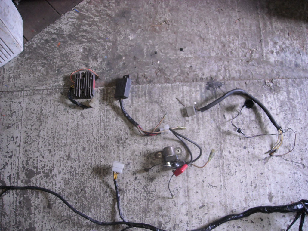

Using your old harness sounds plausible Philippe, except when it looks like the one I found on my bike hahahaha ....
Re: ST Wiring loom
Mathh wrote:Using your old harness sounds plausible Philippe, except when it looks like the one I found on my bike hahahaha ....
Easy peasy with a wiring diagram!
Re: ST Wiring loom
Hi Dave
I agree completely. That's not an original ST wiring loom, the previous owner constructed something himself that looks more like a birds nest...
Try to find a second hand ST wiring loom, they're out there somewhere. Restore it and you'll ride your bike without a problem.
Good luck!
Good luck!
