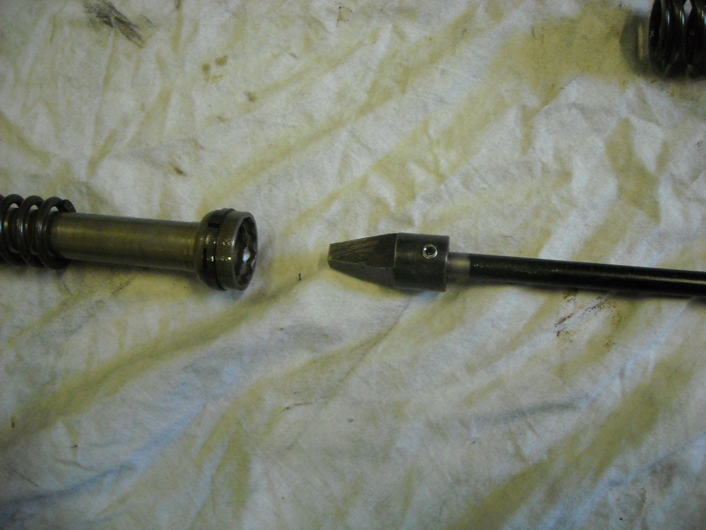

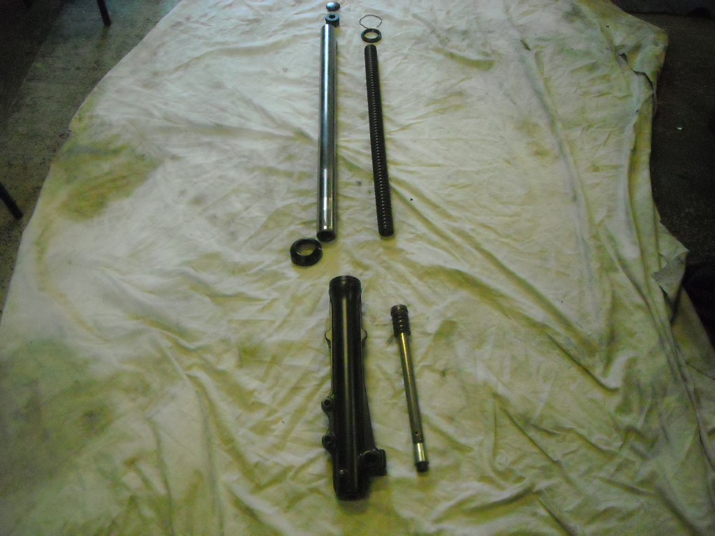

as promised, the pictures
As you can see there's no bronze sleeve.
This is how the upper part of the inner damper looks like
You have to stop it from turning around when you're removing the allen bolt at the underside of the fork leg.
This is how the tool should be in order to stop the inner damper from rotating
I have a special tool but a pointed broomstick will do the job.
The allen bolt at the underside needs 4 kgm of torcque , a new copper washer, a bit of liquid sealer and loctite at the thread.
The cap needs a torcque of 2.8 kgm
You have to put 350 cc of oil in each fork leg. SAE 10 fork leg oil is recommanded in the shopmanual but I use SAE 15 fork oil. It gives a better damping.
If you have any questions, just ask them.

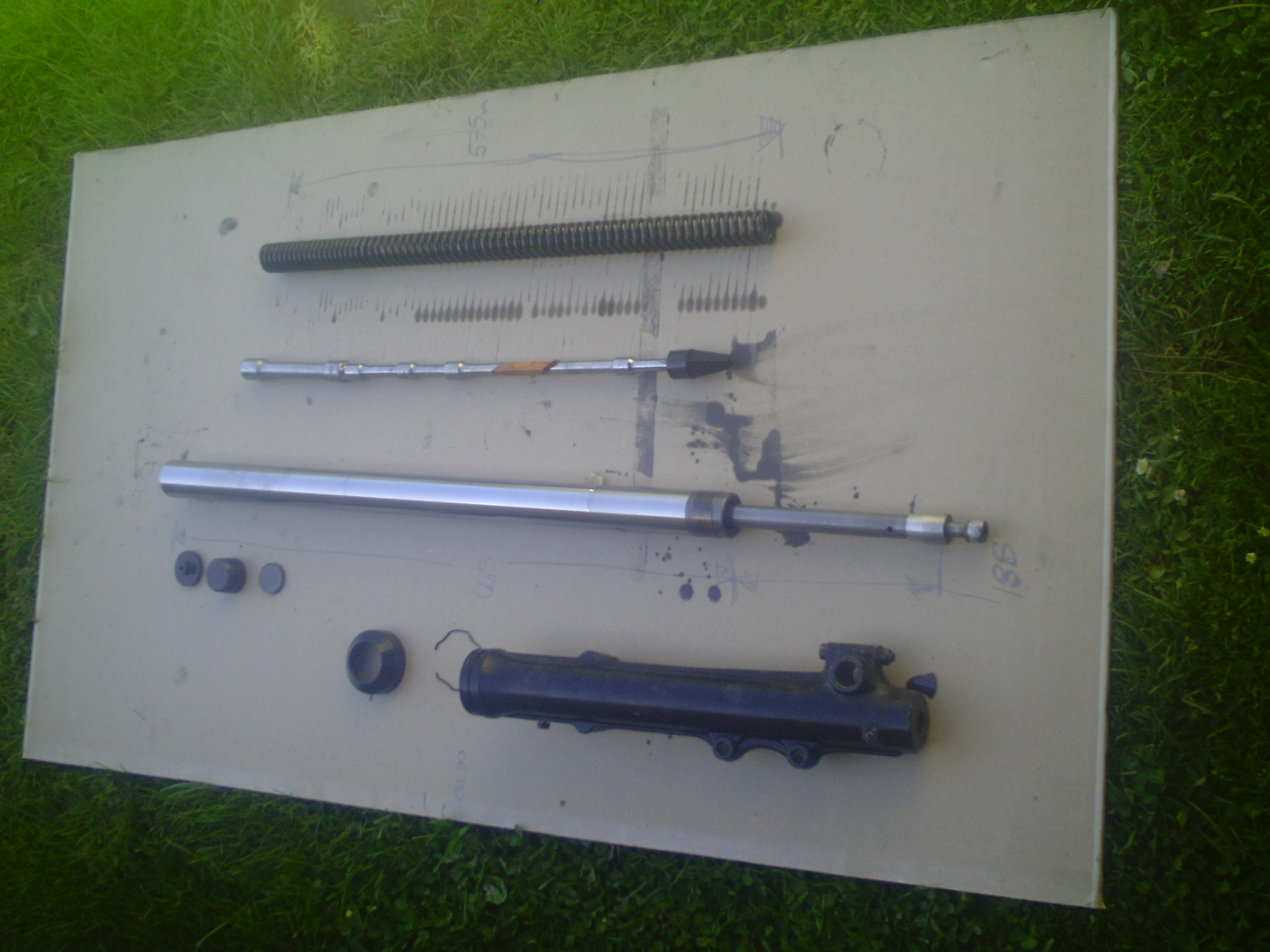

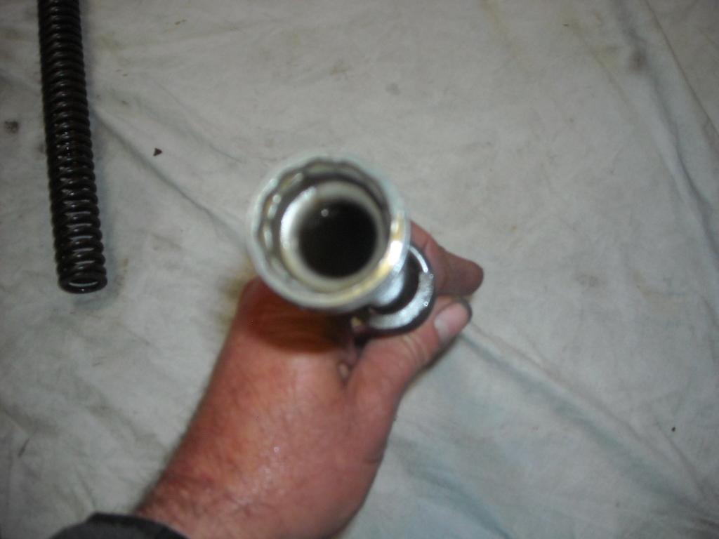

This is what I've got....
The bottom piston is held within the fork inner. There is a bronze sleeve / clip at the base which I presume holds the two together. There is , what feels like a spring inside working in the same fashion as the original.
It also states there should be a washer between the fork seal and retaining clip, not present, which is why the fork seal wasn't completely seated against the shoulder, again presumably forced up by the spring until it hits the clip??
There was no way these were coming apart without the special tool, luckily I still had mine from my Zeph days. If i'd have used a dowel it would have come out looking like it had been on a wood turning lathe!

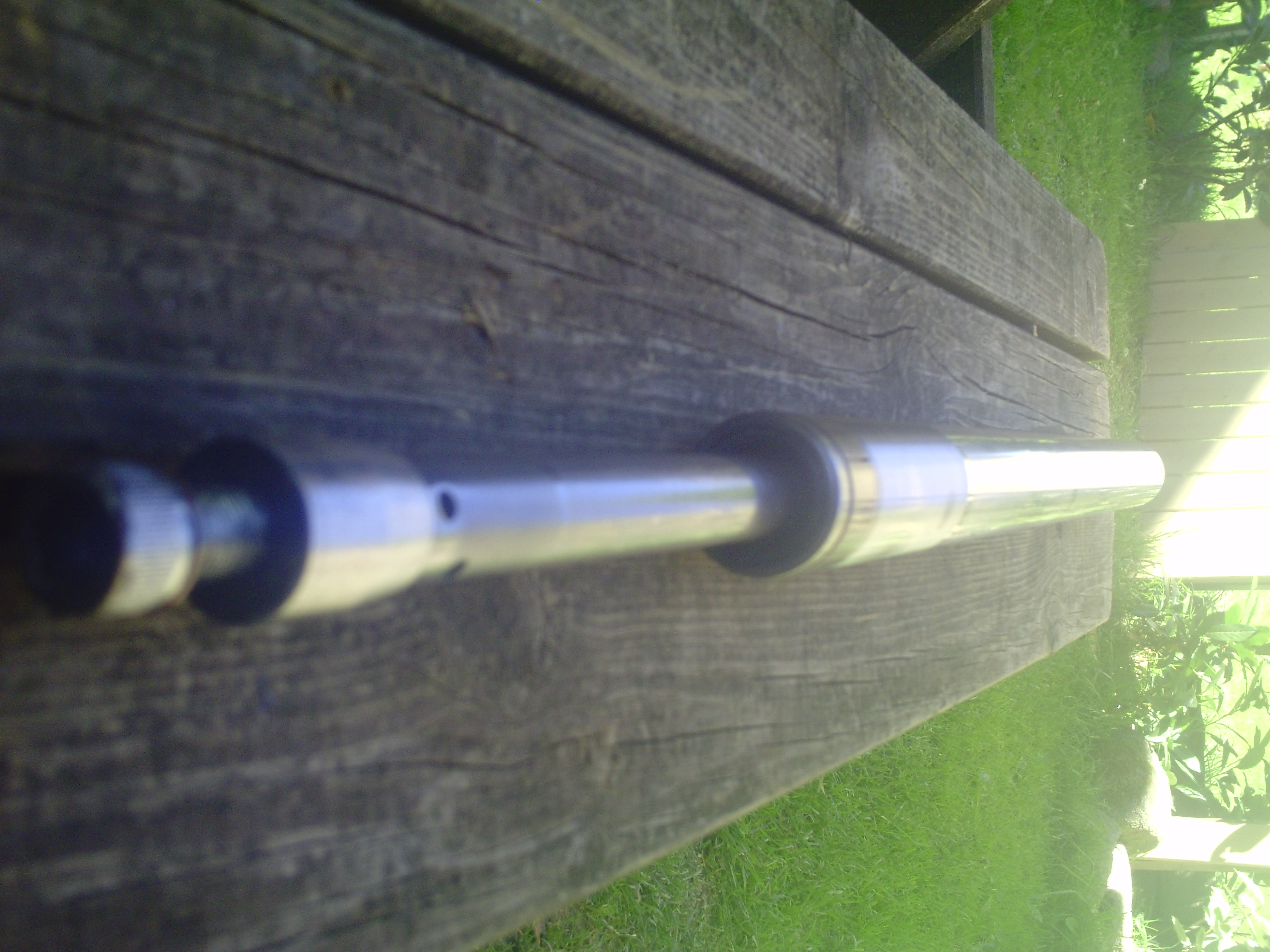

Anyone recognise this odd part. I'm not fussed too much as it's in good condition and does the job. I'm hoping the length is the same as standard? (Included in the photo (665/6mm+188mm)
Re: ST recommission
Hi Pete
I've done already a lot of ST fork disassembly but I never stumbled upon that. But then again, you're in France and your ST originates from France...nice country, nice people but when it comes to finding solutions for a technical problem...I have my doubts about it.
Is the other fork leg the same? Or didn't you opened it yet?
The only thing I can see is that an inner part of the outer forkleg came loose and is stuck on the inner fork tube.
Take a look inside the outer forktube. If there's an indentation near the top, the part could originate from there.
You definitely have an E2 (1980) fork leg (one bolt at the bottom where the axle goes through).

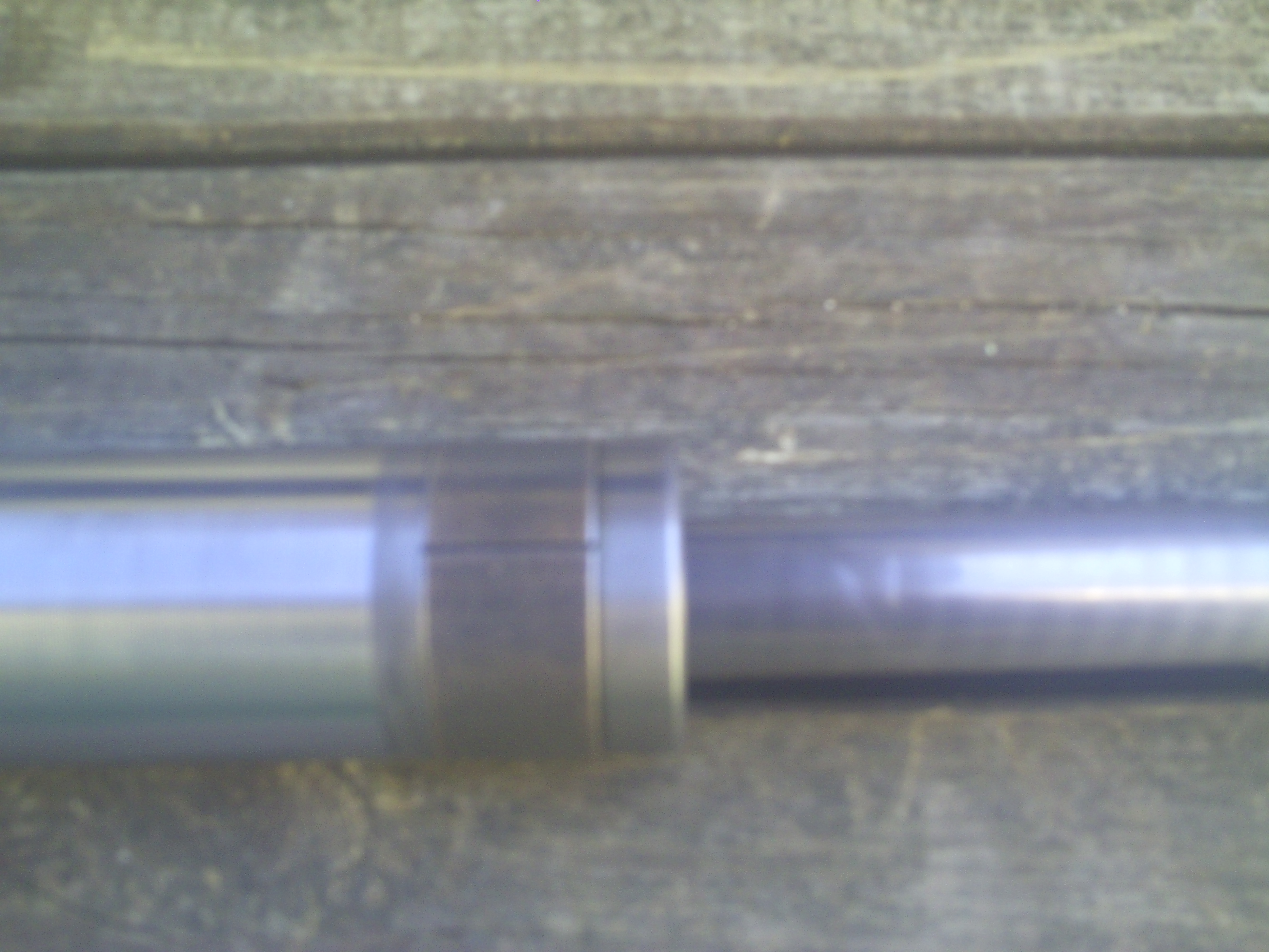

Thanks Philippe, both legs are identical. Here's a close up. The bronze sleeve is almost flush with the inner
How long is the inner fork normally?

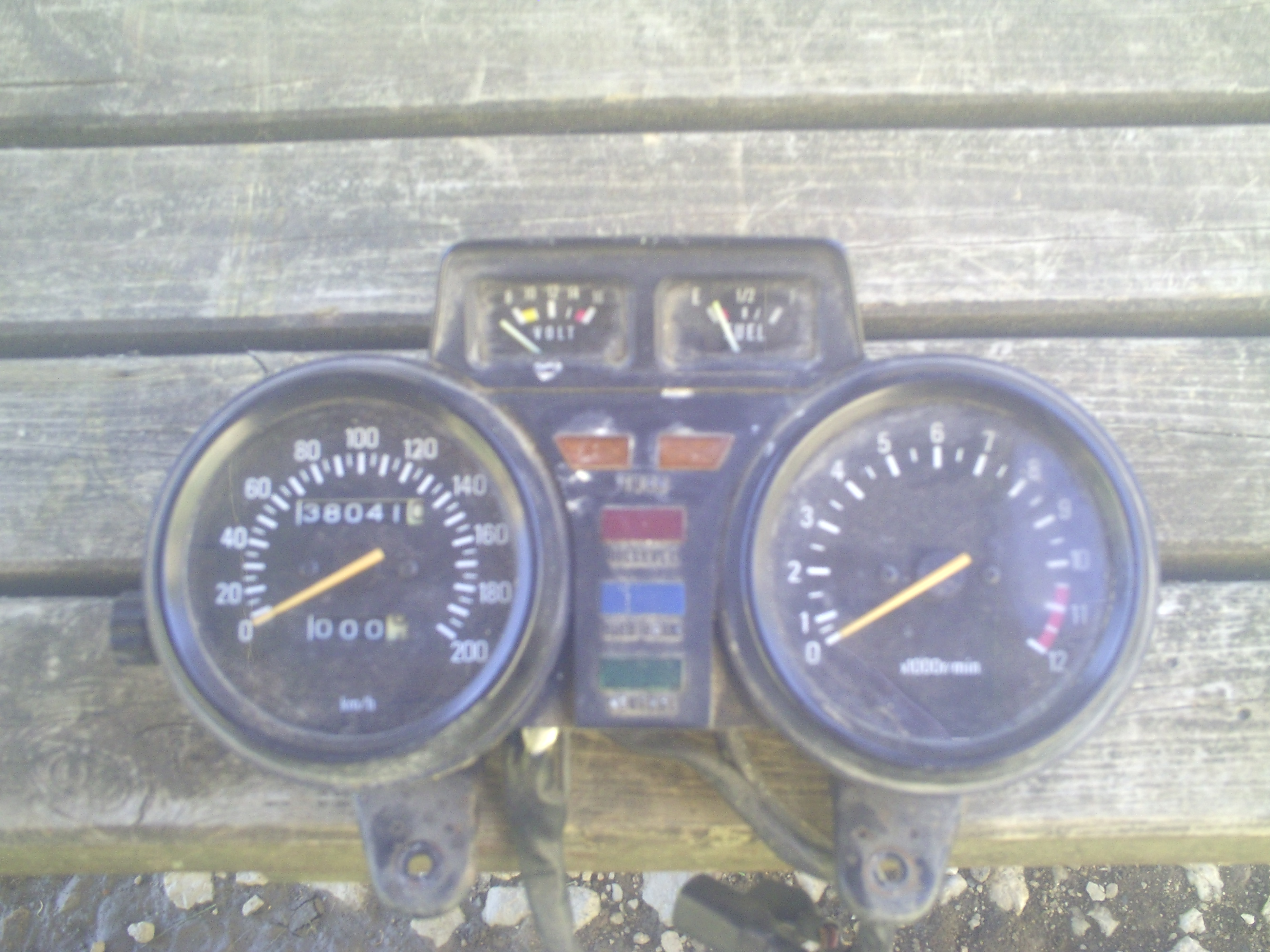

I know it's been on it's side because I have a spare metal clock mount, the chrome ears for the headlight have been straightened, it didn't have a LHS engine protection bar and the handlebars are 10mm closer to the tank on LH lock ( yes the steering stop is slightly mis-formed). The handlebars have FXR750 written on them (not vivsible until they were removed) and the clocks although to me seem very similar the redline on the rev counter is wrong.
At the moment if the strange parts work and enable me to get it roadworthy, safe and mechanically sound to a condition I can enjoy then fair enough. I would just like to work out the puzzle?
Oh, and I just checked the engine number, it's an E1, the frame is E2.

Yamaha clocks ?

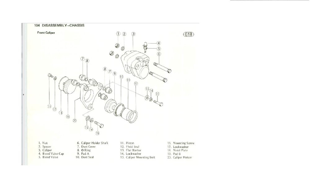

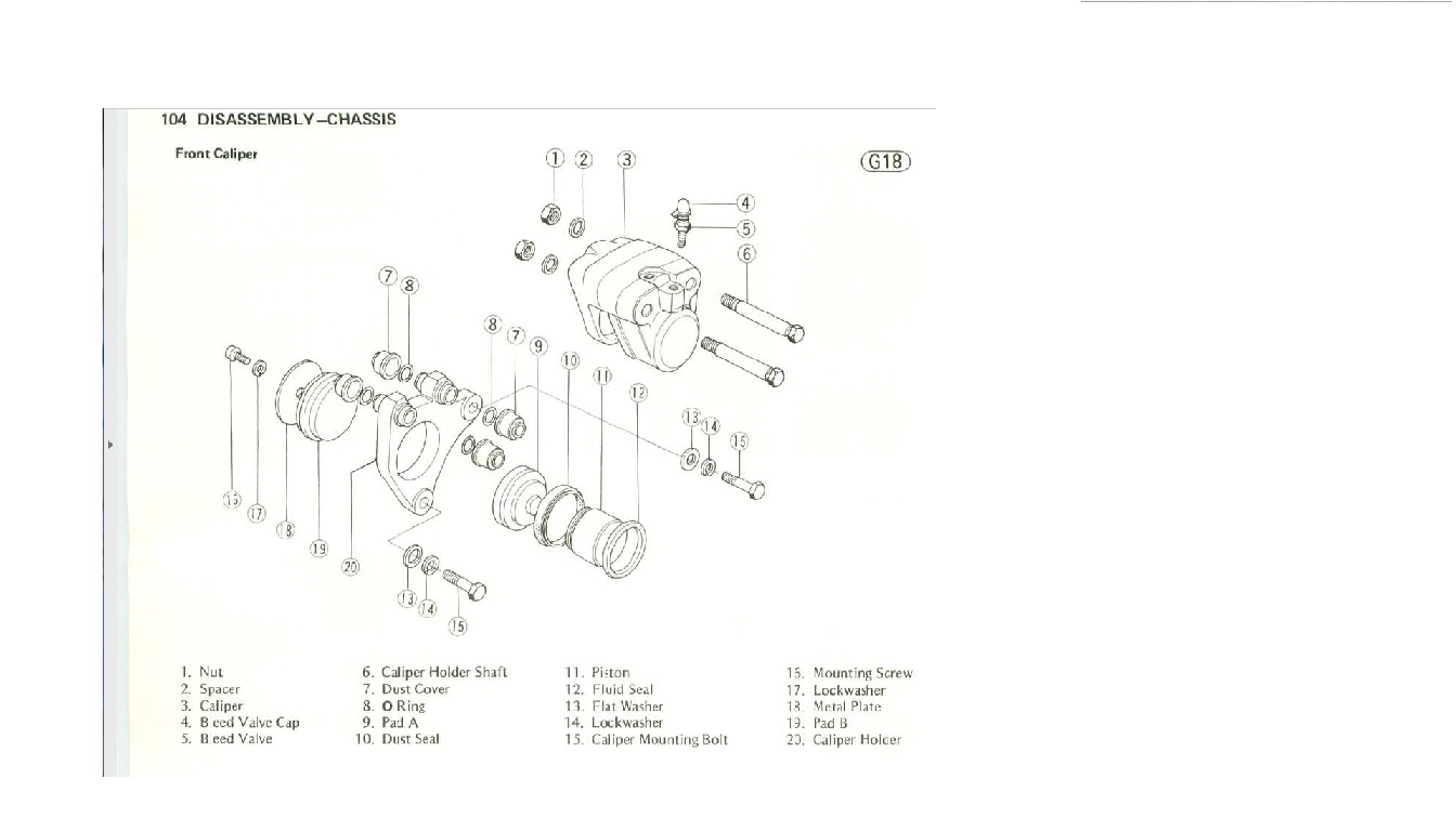

Two more questions if I may?
What are the 4 slide rod bushes in the linked ad?
https://www.ebay.co.uk/itm/Kawasaki-Z-1 ... 23587c21fc
2nd question, I don't seem to have the 'spacers' shown in the parts diagram (No. 2), unless they are stuck in the caliper.
I realise ( if I'm correct?) the ST hasn't got the o rings due to the different shafts, but it's the only picture I have.
A+
