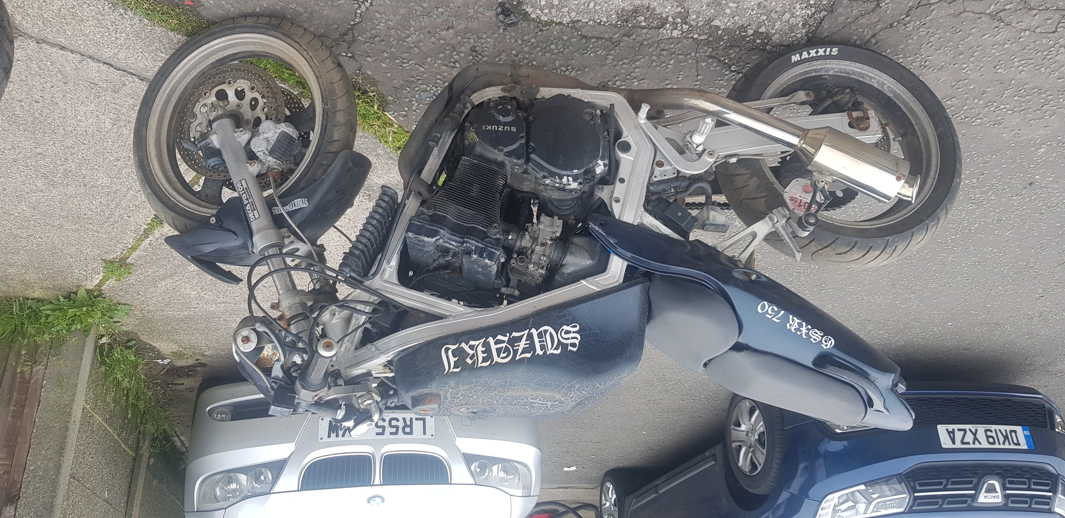

#6 PostAuthor: Swirl » Mon Jun 24, 2019 2:09 pm
Usually they come out sideways not upside down :D

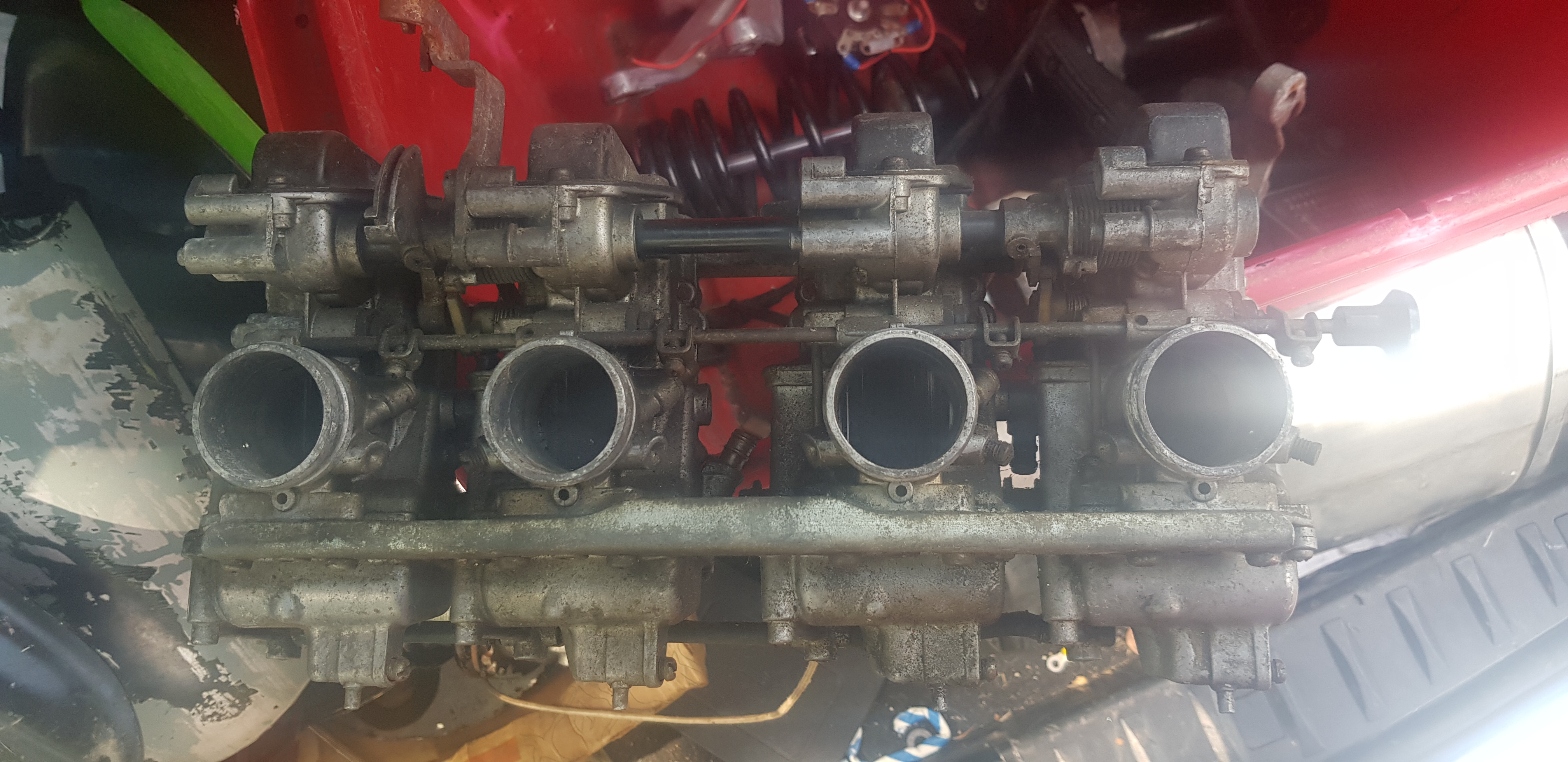

The other set

Swirl wrote:The other set
I think that pipe across the bottom between the float bowls is the accelerator pump feed pipe.

Swirl wrote:I've 3 people interested in 2 sets of carbs at the moment, so they should go
There are TM29s and TM33s, and judging by the wall thickness of that set in the picture they could be TM33s, make sure you get good money for those.
Cheers,
Mark.

They look like the standard GSXR VM29SS carbs, they're 29mm on one side of the slide and 33mm on the other, I can't remember which way round.

Julian_Boolean wrote:They look like the standard GSXR VM29SS carbs, they're 29mm on one side of the slide and 33mm on the other, I can't remember which way round.
They sit in the same rubbers as standard 34mm so I was thinking it was the engine side, but you are right, they narrow a lot at the slide and that's where the 29mm comes from.
Cheers,
Mark.
