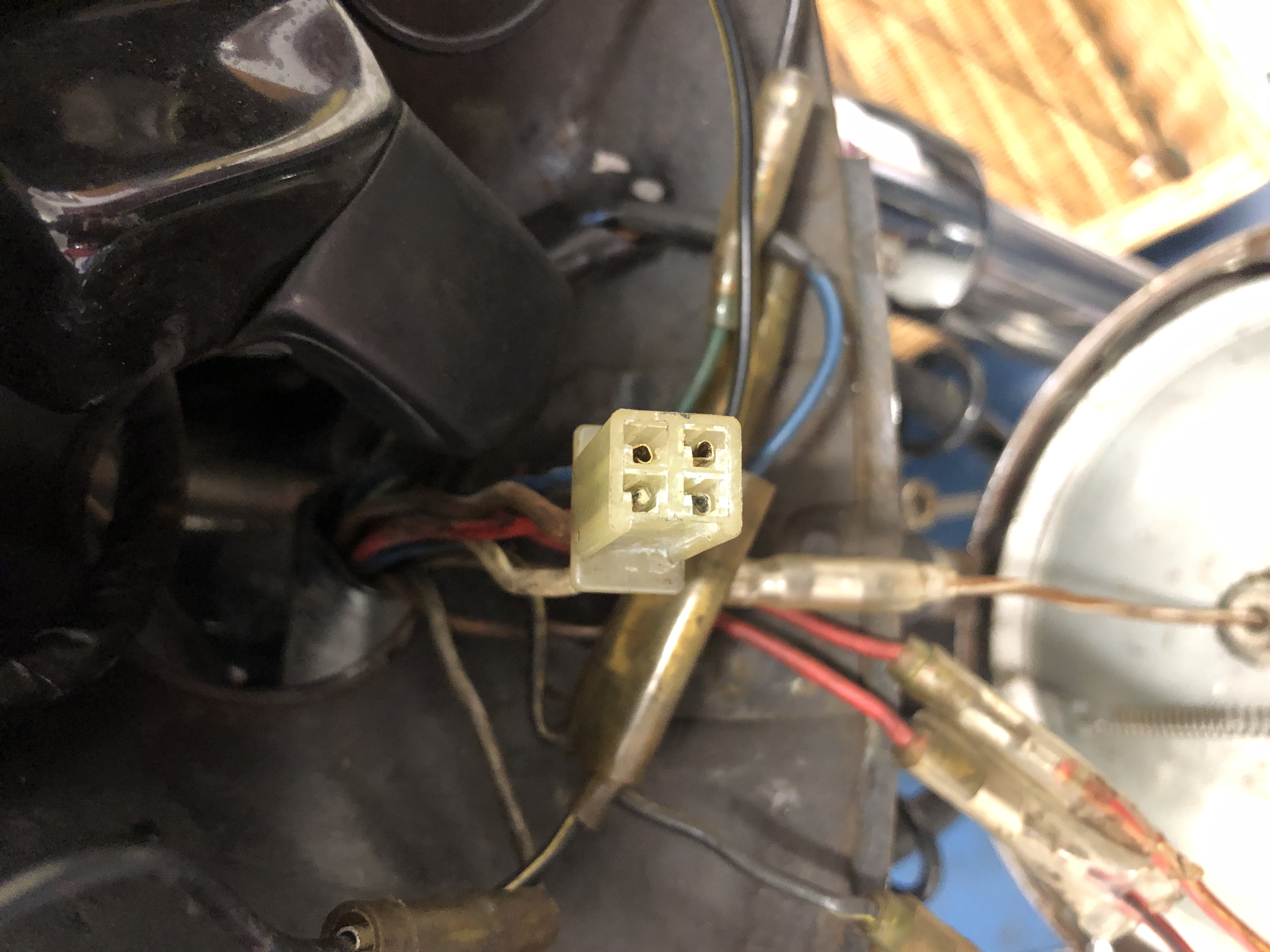

Tell me about problems in the headlight area.

Tell me about problems in the headlight area. EA295E1D-9A8A-4898-B5B6-369181F7874E.jpeg
Ouch! :shock:
