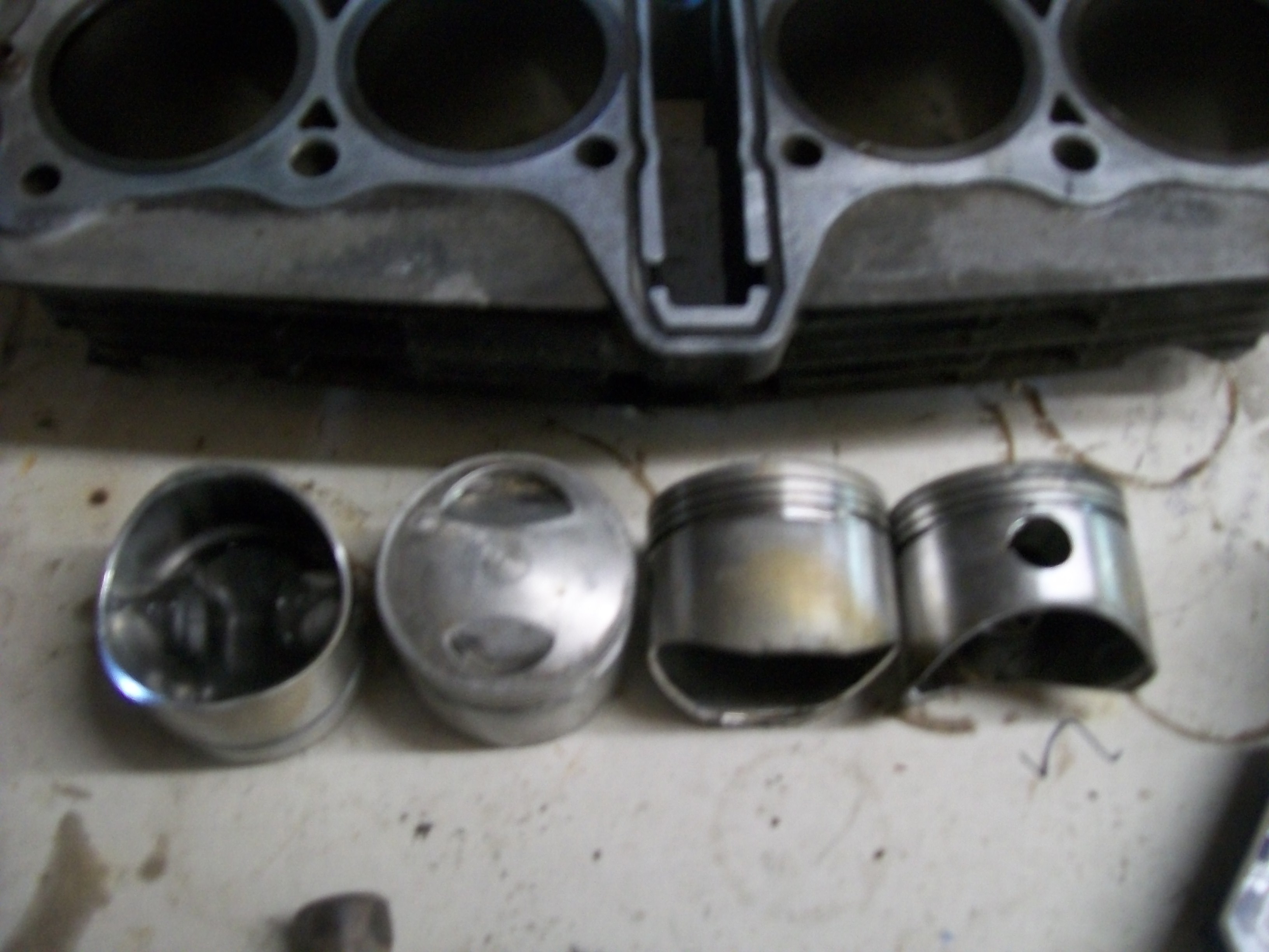

Minor update, had a look at the spare barrels, they are 1170, 75mm. Anyone know the maker of the pistons? There's a 'C' stamped in the crown. Crap photo, sorry.

If they are Wiseco, there should be W on the casting inside of the piston on the small end.
Rob
Rob
Re: GPZ11 Injection
No marks on the inside at all, just a 'C' and the arrow on the crown. There seems to be a reinforcement on the inner crown that's peened into the holes for the oil scraper ring. Slightly better photo but not great.

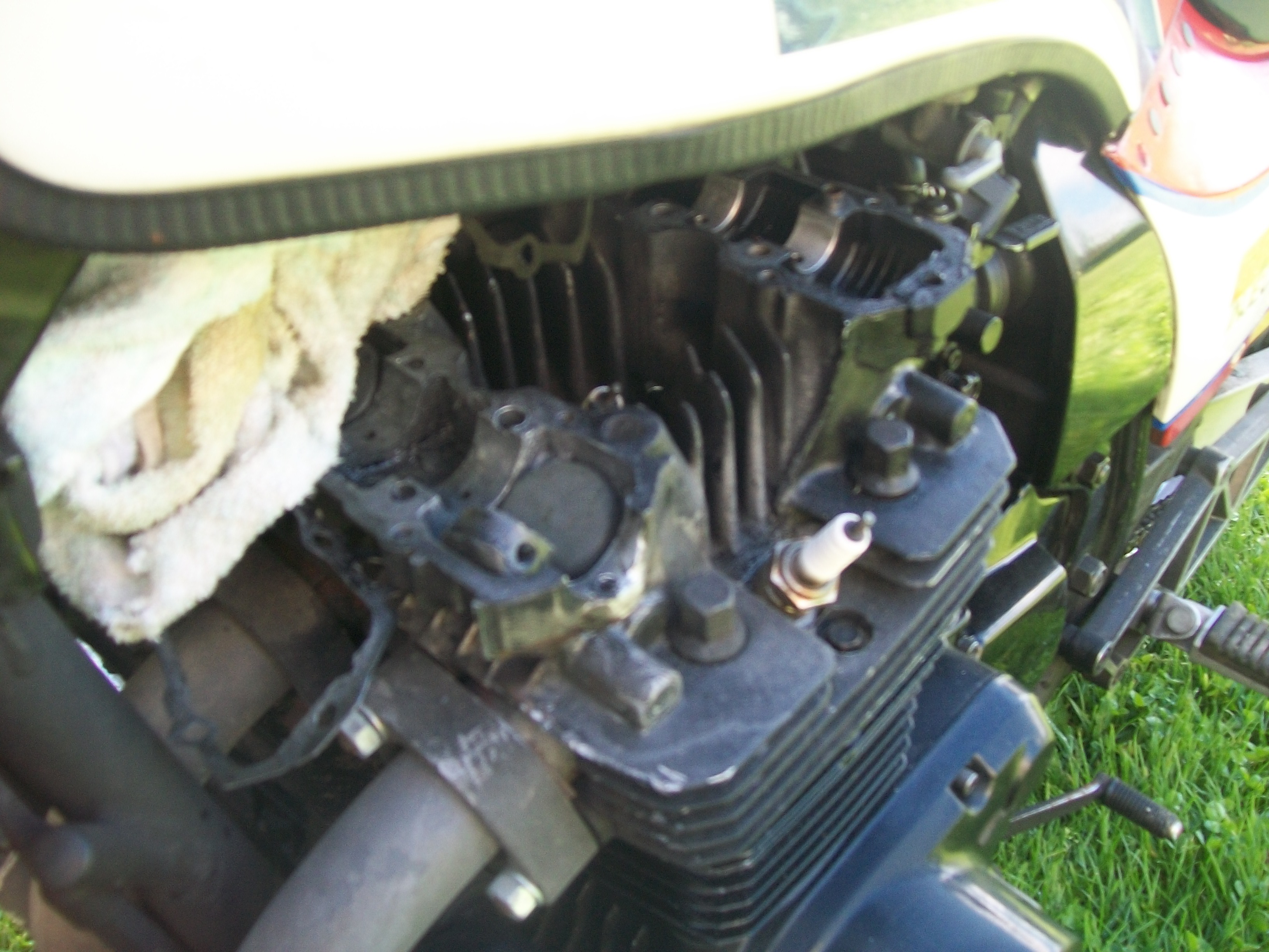

Update, the top end is off.
Whilst pulling various bits off to allow me to get the engine out easier I noticed that the inlet rubber for no.2 was loose, the LH middle exhaust side cylinder head nut was loose, partially stripped. The air box was very oily on the left hand side. The air filter fell apart when removed. The pre filter looks very gunged up. The LHS 6mm cylinder head bolt was stripped.
Very surprised to find an intact cam chain in the engine, albeit fallen down into the engine. I've got the broken one in a box of bits so someone has replaced it. Will be emailing the previous owner to find out a bit more history. The green base gasket as well as the green pickup cover gasket look quite recent.

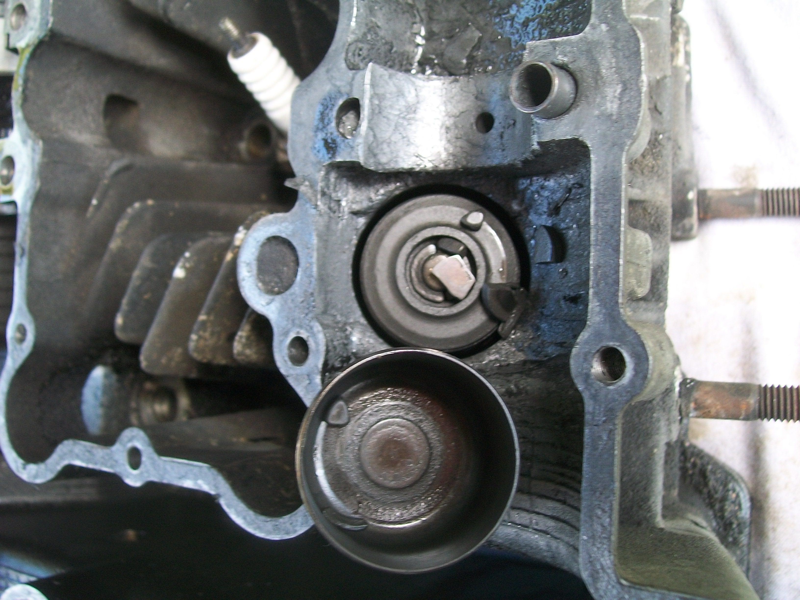

This is the head once removed, no.2 exhaust shim is in bits!.

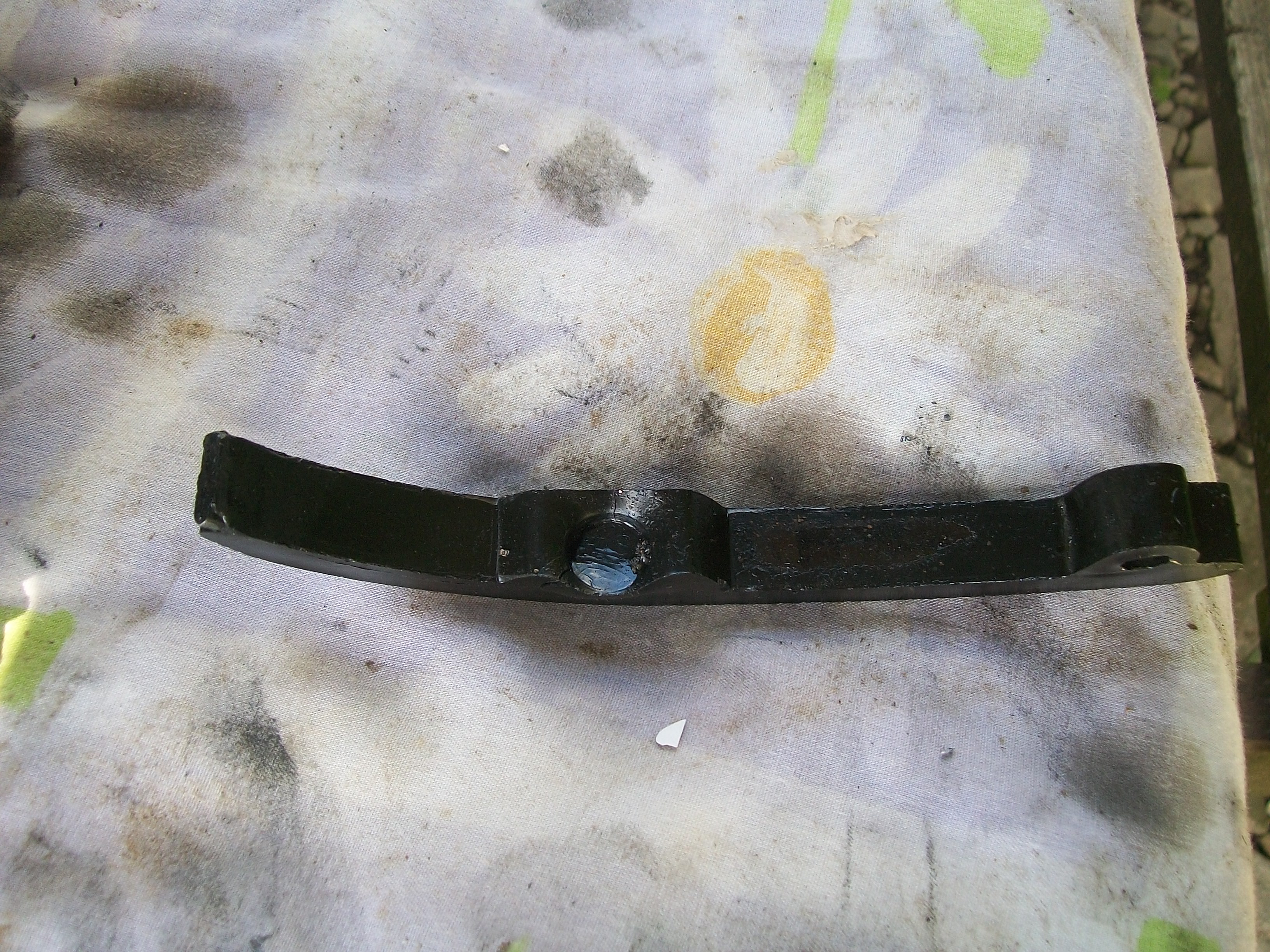

The front and rear cam chain guides are very worn. It looks like tensioner has been overdone looking at the rear
The barrels show quite a few vertical scores that can be just felt with a finger nail, more so at the base of the cylinders.
The pistons fitted are 74mm. Giving the damage to no.2 exhaust shim, there is no marking on the piston!
