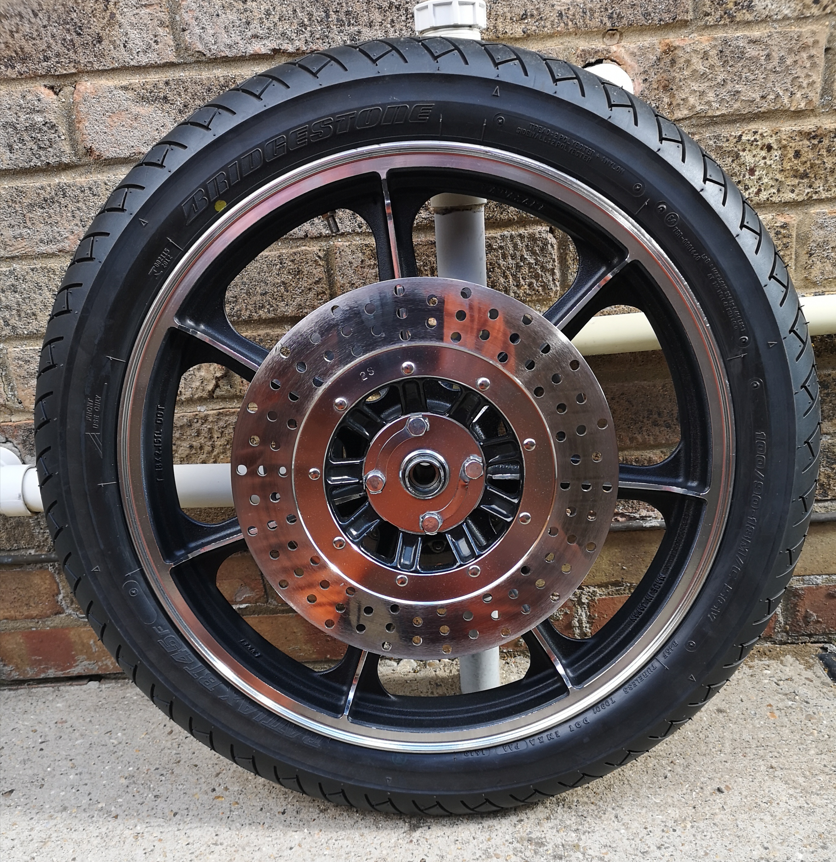

Okay, so four years later and I'm on the home straight with the Z1R but this is the latest drama!

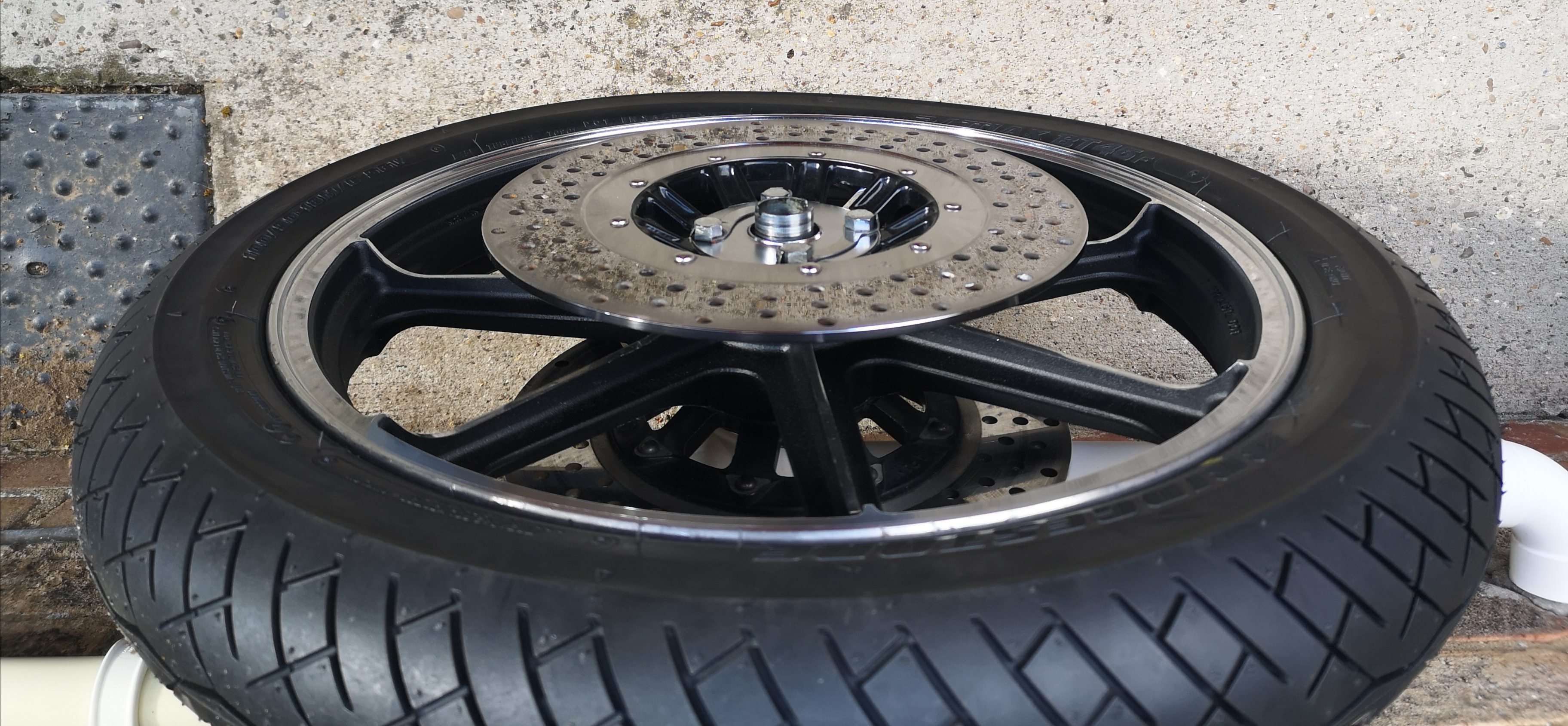

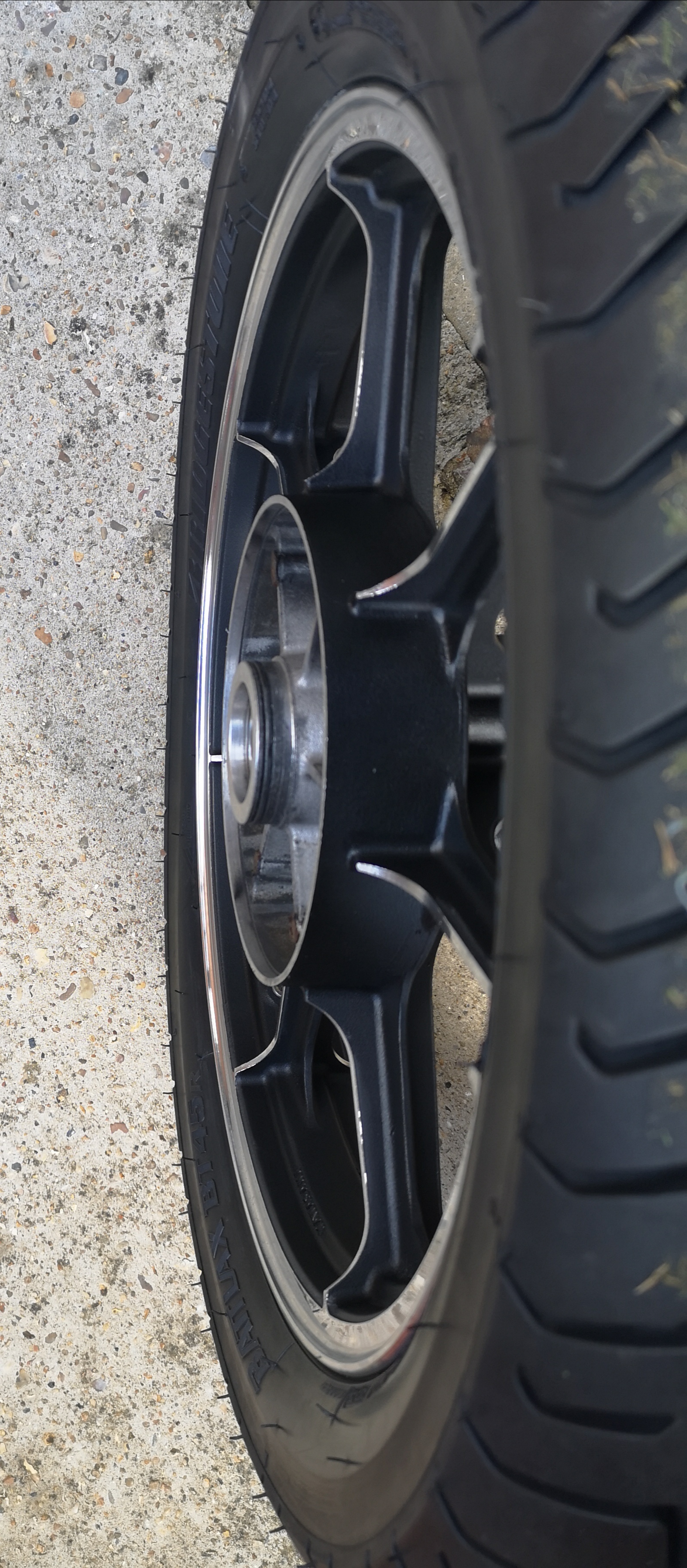

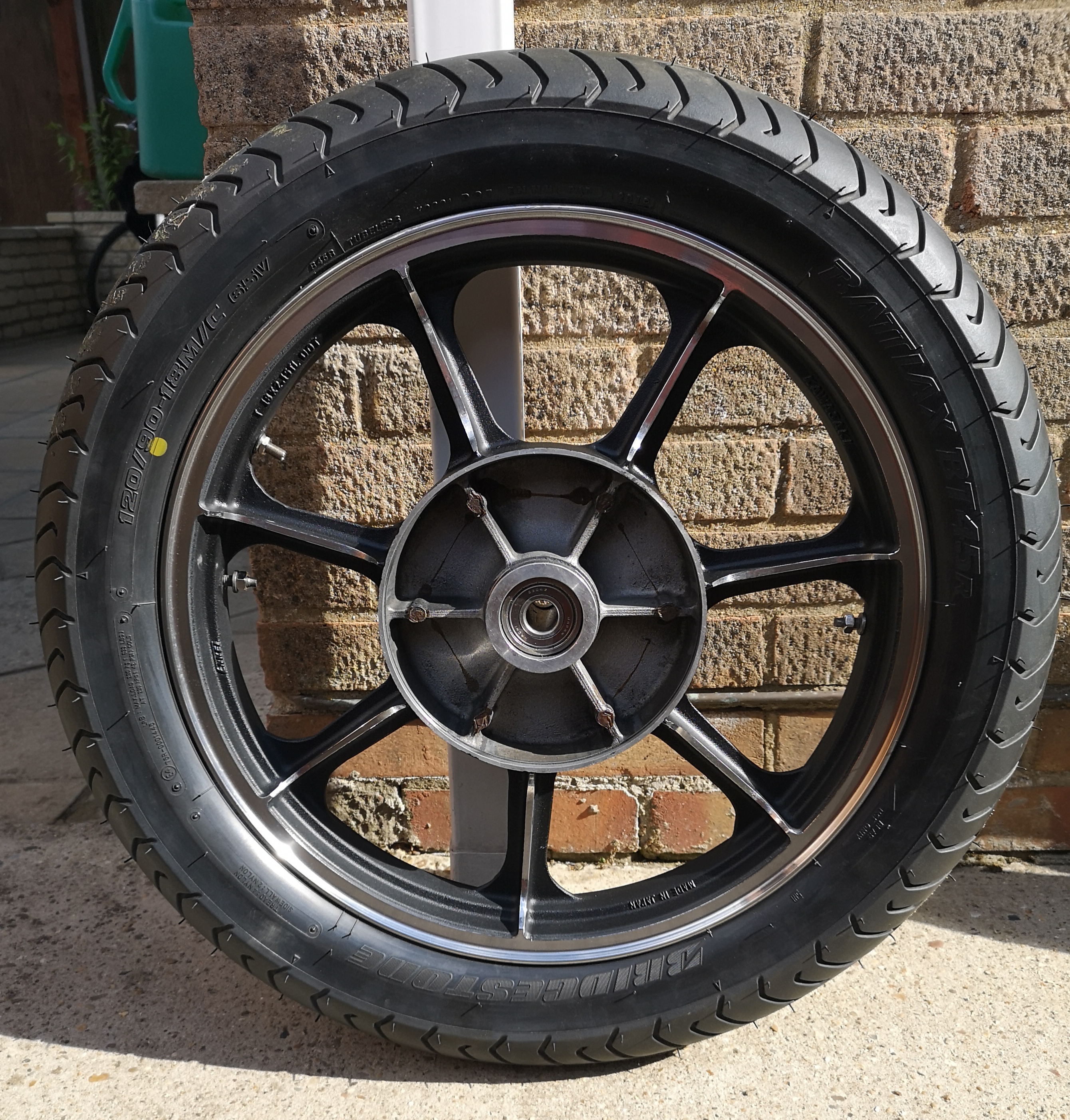

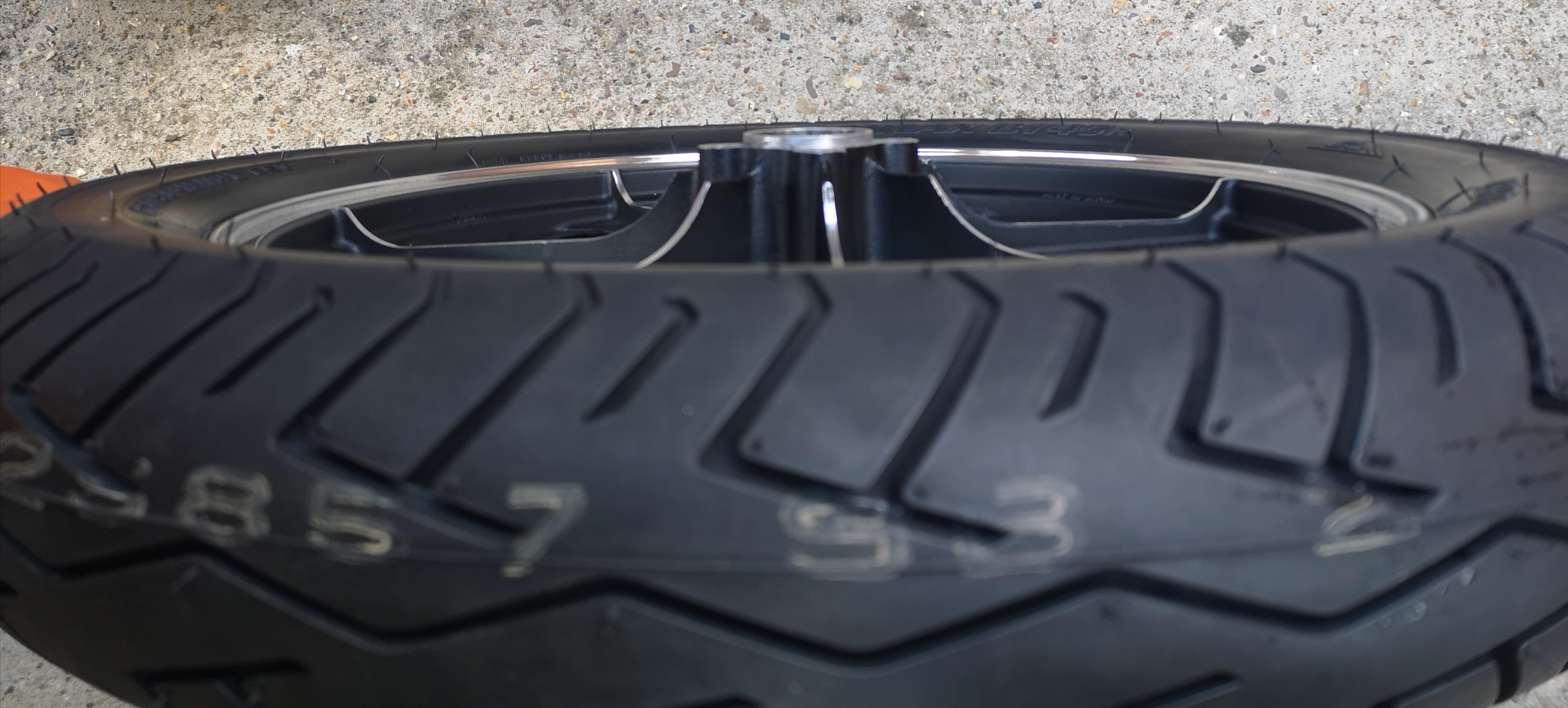

I've painted and polished the wheels and after checking various threads to make sure that I can use tubeless tyres with tubes on '78 cast wheels (not tubeless rims), I've fitted BT45's with tubes. The problem I have now is that both tyres are not sitting centrally on the wheels??!! (The tyres I took off were continental tubeless with tubes fitted)
Pretty difficult to see from the pics but the raised line on the tyres are fine on one side of each wheel but disappear under the rim on the other side??!! (On the back tyre - where it says 'Bridgestone' and on the front where it says 'Battlax BT45') :angry
I've tried deflating them and 'bouncing' the wheels on the tyres while turning them with various tyre pressures but still can't seem to get them any better?
Also, the bead locks/rim locks on the rear tyre are undone at the moment - I'm assuming I tighten these once everything is centralised/sorted?
Any thoughts or help by those more knowledgeable in this area would be greatly appreciated!!

#2 PostAuthor: Pigford » Thu May 14, 2020 9:34 am
Lube (buy some proper tyre soap) and high pressure inflation - take up to 50psi if have to!
Rim is probably corroded & gripping tyre shoulder - emery cloth it smooth!
Good luck

#3 PostAuthor: CAT3 » Thu May 14, 2020 10:19 am
Exactly as Pigford says, you need proper tyre lube on the beads. Don't be tempted to use washing up liquid, (it has salt in).
I've even taken tyres up to around 60p.s.i. before now to get them to seat correctly.
The rear wheel/tyre has the added complication of the bead lockers, which always try to clamp the tyre to the rim as you inflate the tyre. Again the tyre lube will greatly assist getting the tyre to seat correctly as will a quick inflation.

#4 PostAuthor: warren3200gt » Thu May 14, 2020 10:36 am
As the other guys have said, use lube and lots of it. Make sure your rim grips are very loose and a decent amount of psi. I used to work as a fitter during school hols and particularly stubborn ones got a whack or 2 with a rubber mallet by where they were where sticking, that always got them to seat. :mad
