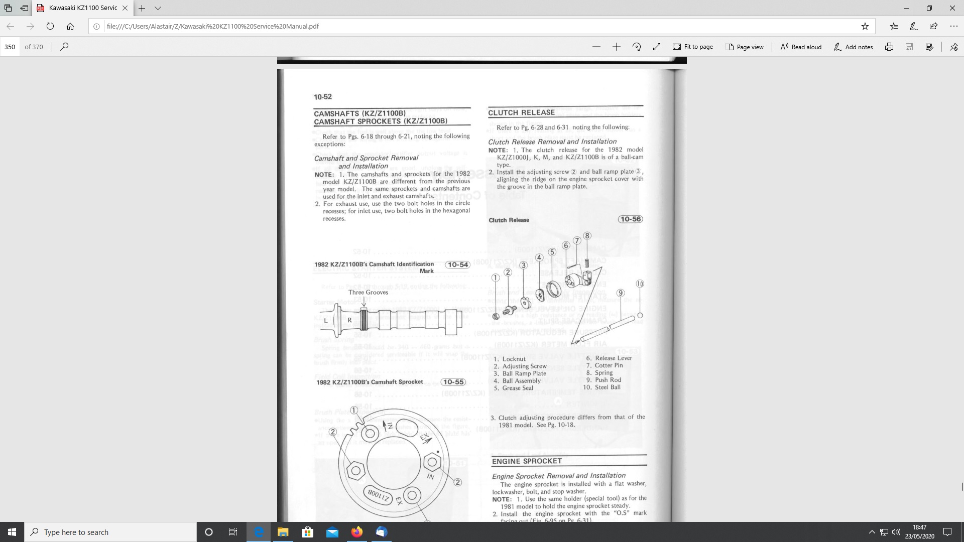

Al, thats the picture i have, but it isnt replicated in any of the parts manuals. The pushrod is 335mm, the number from the parts catalogue has been superceeded but it matches the lawson one. Just have to keep fiddling with it to get it right. Chris Tombleson reckons it doesnt have one unless its an early model. Confusing or what.
Rob
