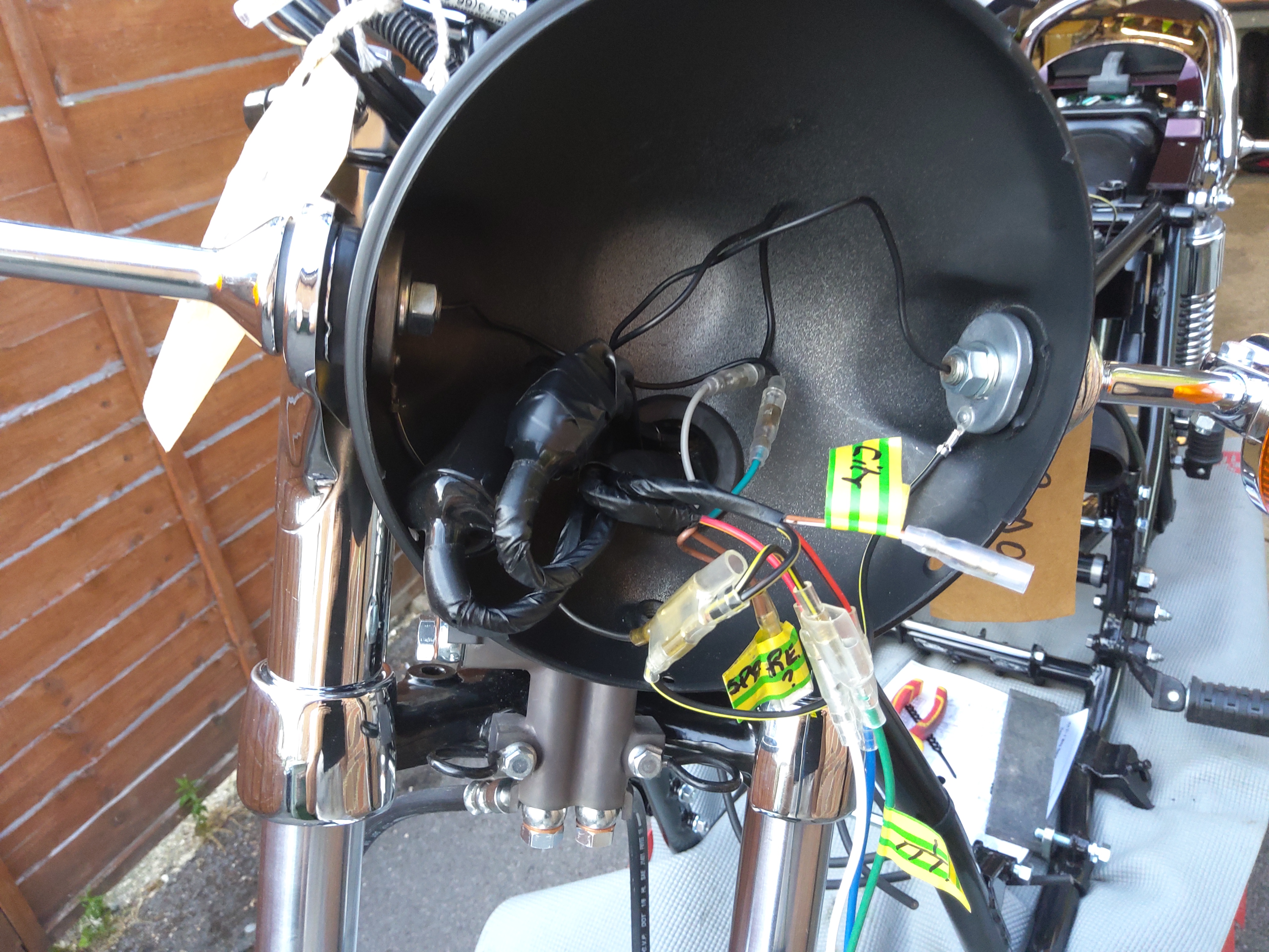

Many thanks to all. As you can now see from pic I managed to get the whole shenanigan together (technical term there). I can't for the life of me remember whether the front harness block connectors join to the main loom connectors inside the headlamp shell so I've done it anyway. Will find out when the wiring I've ordered arrived so I can make up the tails for the City light. Time will tell
