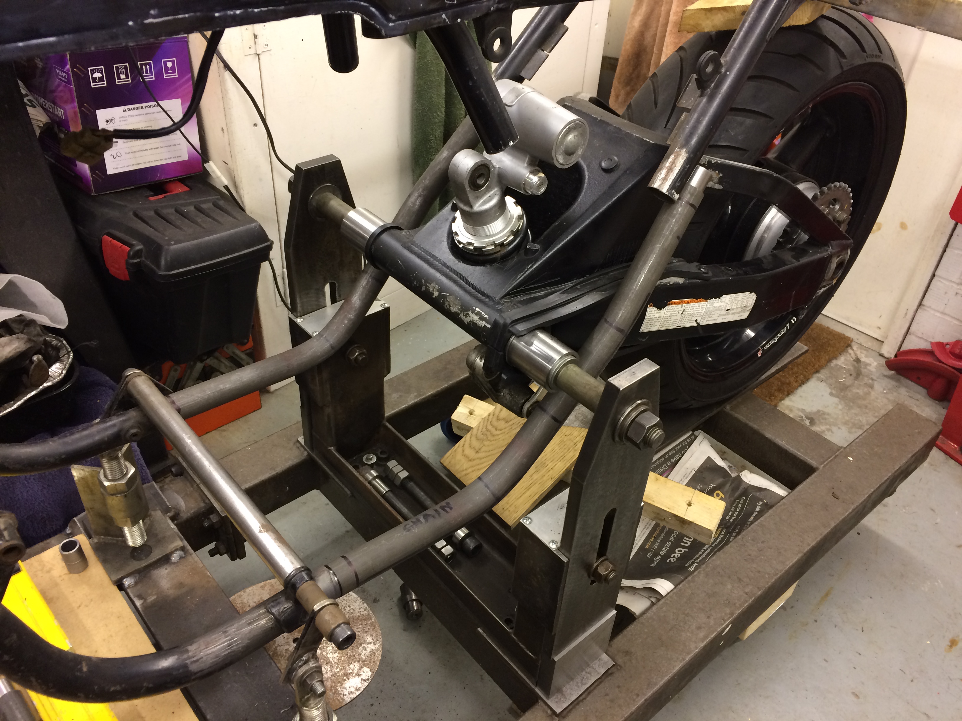

Re: Z1R Resurrection
I used seamless tube I got from Steel Express in Wolverhampton. It was the right diameter too.
And bent it with a Clarke "Strong Arm" 12 ton pipe bender.

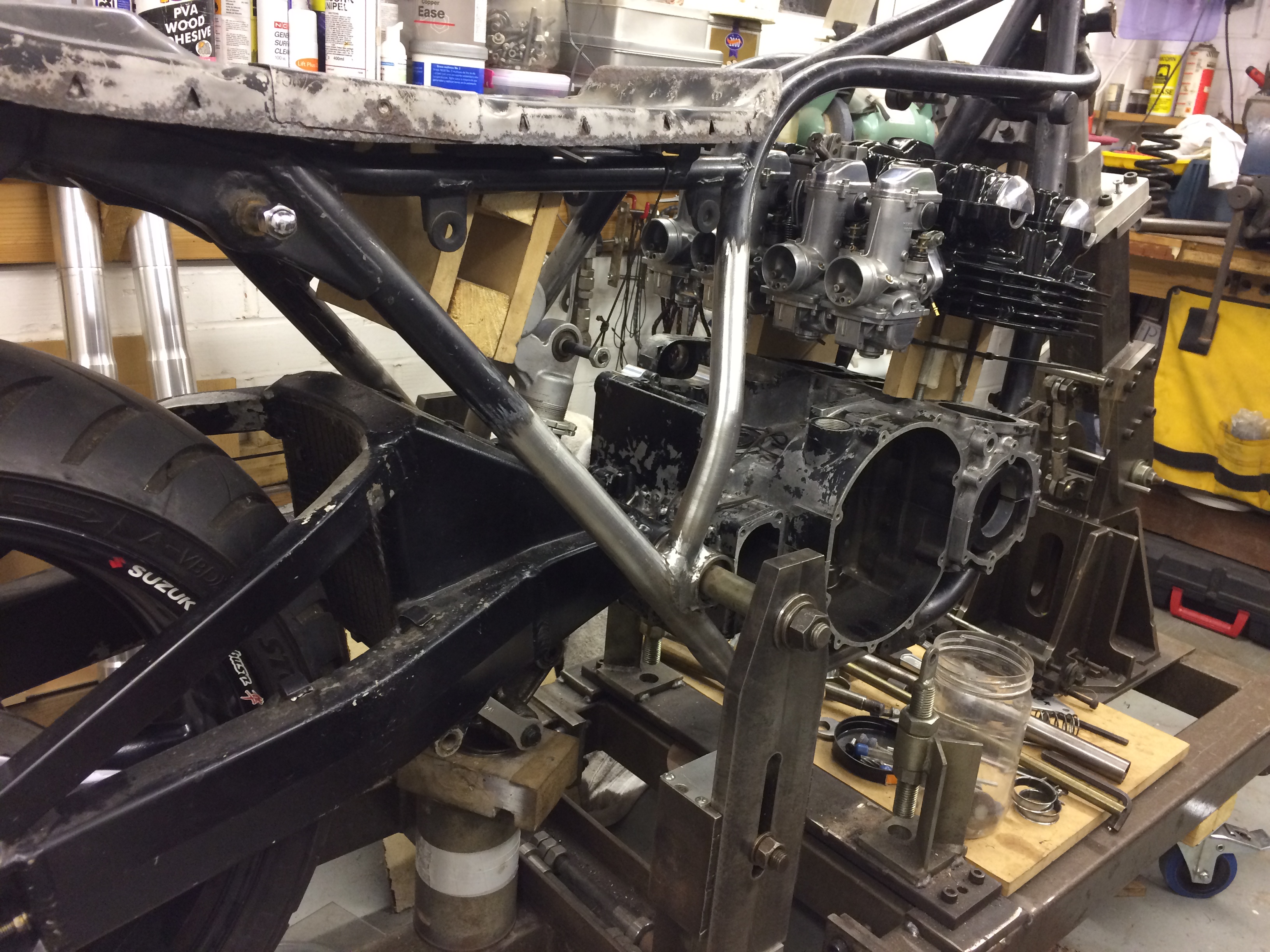

Tacked, welded and dressed.
The wooden block represents the battery box to figure out where it's gonna go along with the shock.
I put the head and carbs on too just to be sure nothing was going to interfere. I'm thinking engine and shocker mountings need to go on there.

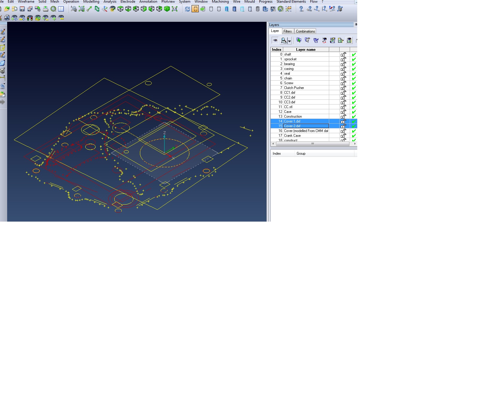

The CMM was a small manual machine and you can "didge" (touch a surface) loads of points very quickly.
All the points are recorded and then exported as a DXF. The DXF is loaded into the CAD application and the object is drawn from the data collected.
This is a screen shot of the DXF loaded into the CAD app for the Shift Linkage cover. It doesn't make much sense.
As you're doing it you usually make some notes of what's didged and if you load it into the CAD while it's still fresh in your head plus you've got the object as reference
it makes sense.
it makes sense.

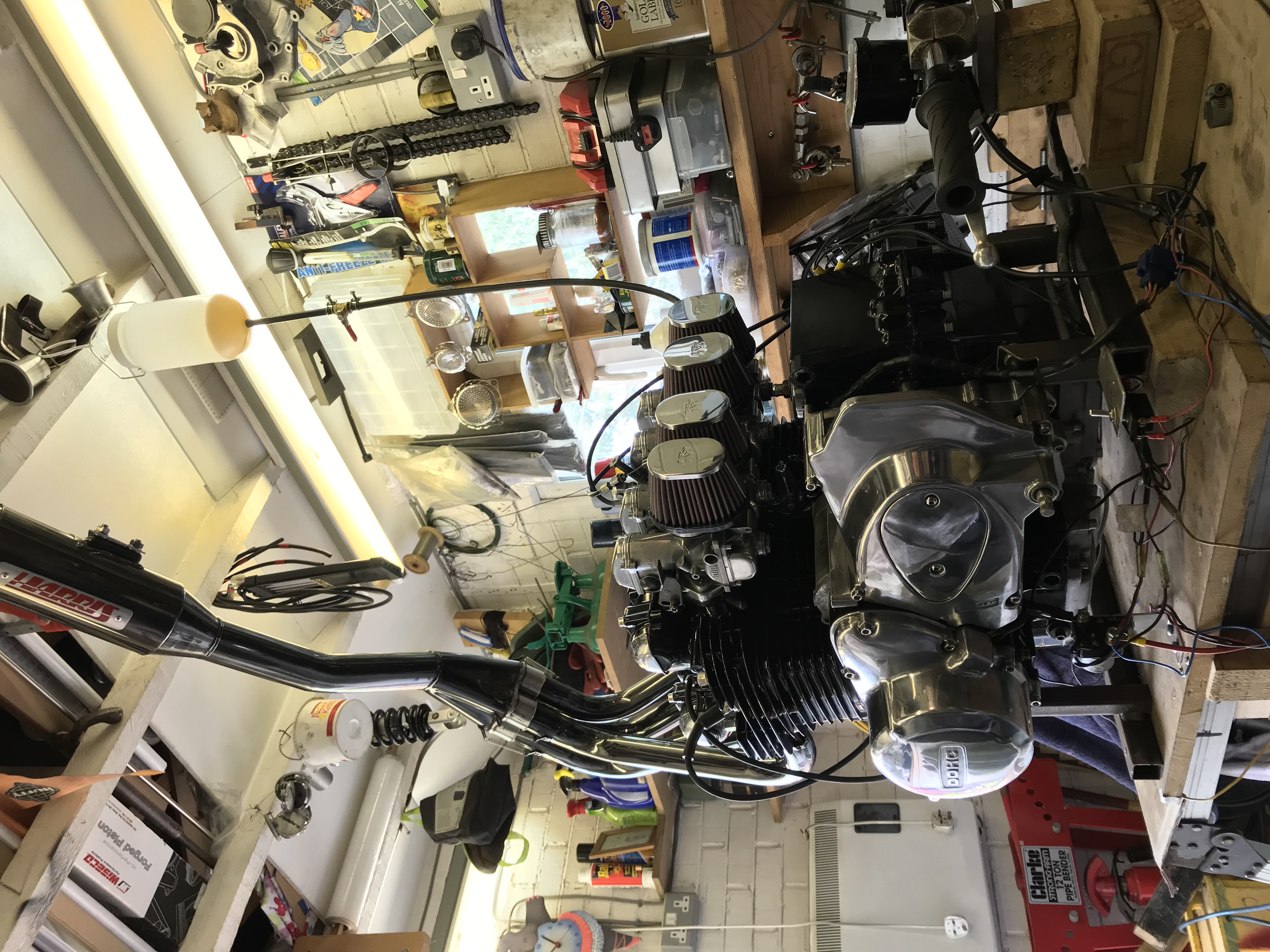

At this point I started thinking about how it would look. A fancy CNC machined billet of aluminium holding an outer bearing would look tasty, but then there’s the gear selector shaft and clutch mechanism that depend on the outer chain cover casing plus the starter motor cover. I wondered if the chain cover would fit over the outer bearing housing and that’s why I scanned it. Fortunately there’s plenty of room in behind the chain cover, so now the Shift linkage cover that I was designing was not only an adaptor, but a spacer as well. This was good because it meant I could use all the screws and dowels for the cover and casing to make the assembly stronger. Also the 27mm extension of the sprocket, which is the thickness of the spacer part of the adaptor/shift linkage cover doesn’t push the chain cover casing out too far. See how it tucks in nicely just behind the alternator casing. Just got to modify to suit the starter motor cover.

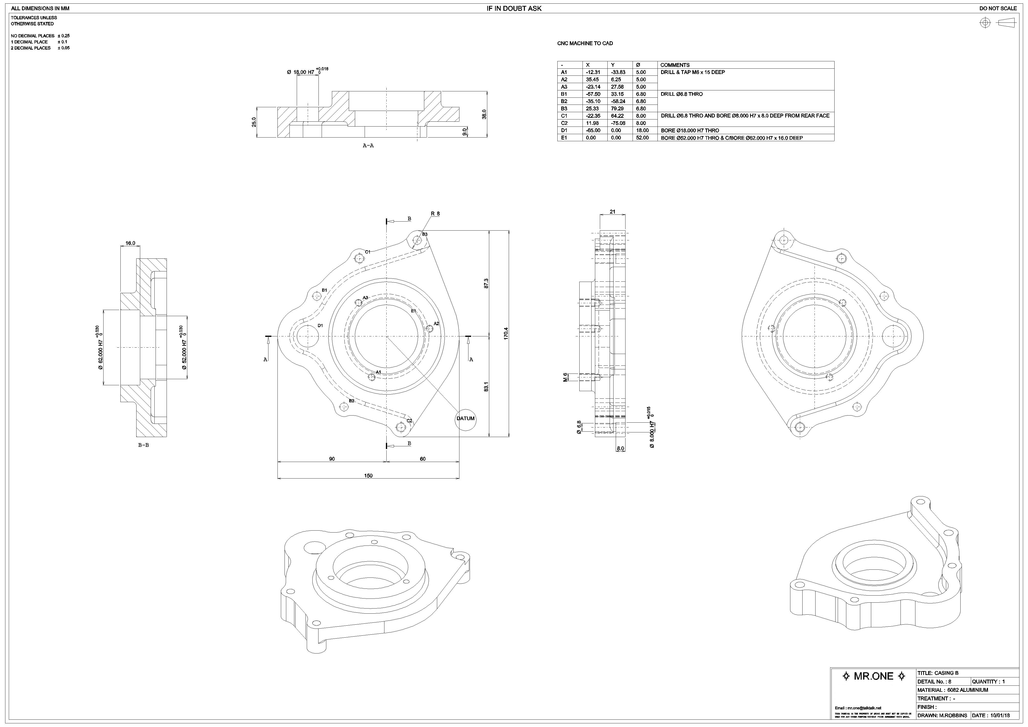

Jumping the gun a bit there with that last picture.
Anyway - The CAD application I use has two areas. The main area is 3D solid modelling where everything is created and then the created objects are selected into the other area which is for 2D draughting.
From the digitized data I captured from the Shift Linkage cover shown above, I drew up its replacement which I’m calling the Main Case:
