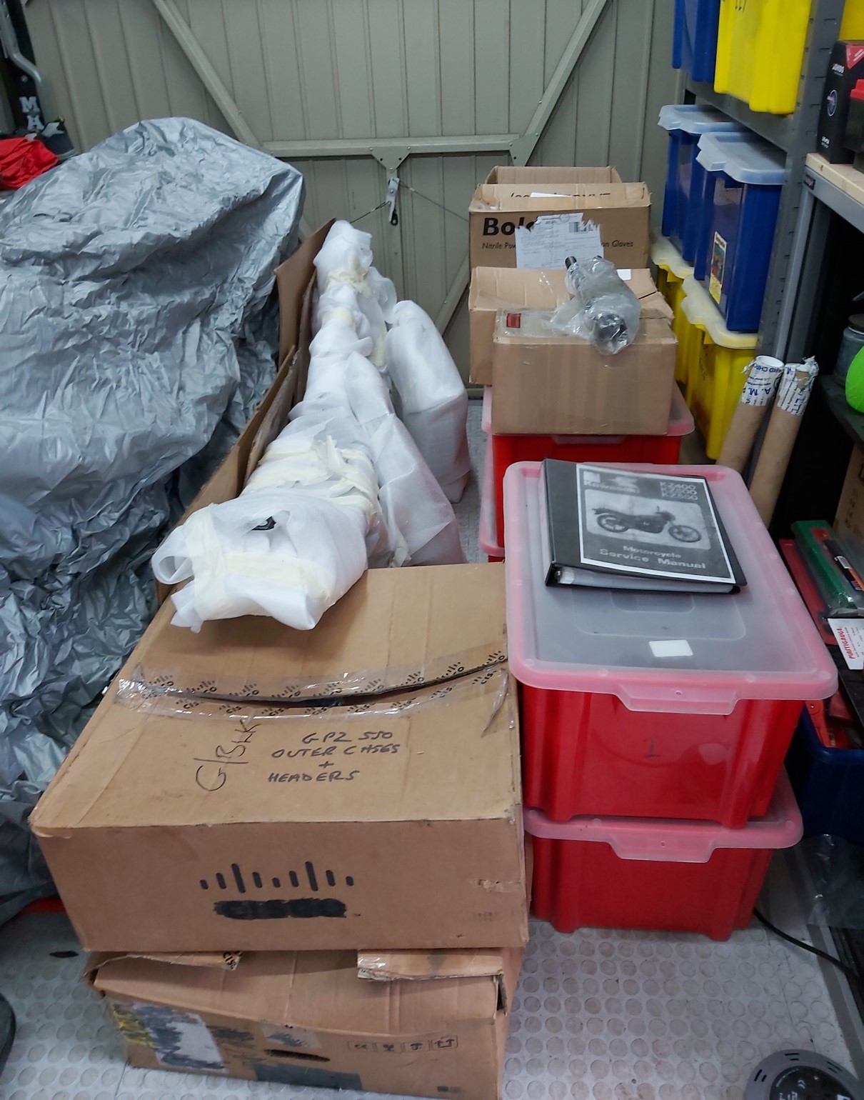

Today was the first day back in the garage since the Xmas break and the pile of bits "to do" appears to have almost disappeared, whilst the pile of boxes containing refurbished parts has almost taken over the garage :shock:
So, after countless months of disassembly, cleaning, checking, repairing & refinishing I am finally at the stage where it is time to start putting this jigsaw back together and get my old 550 back on the road.

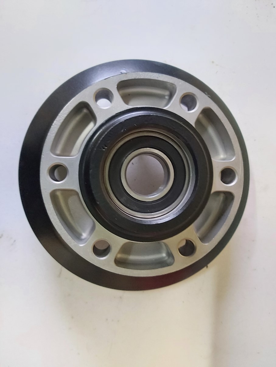

My plan is to get a rolling chassis first, which will make it easier to move the GPz around my garage (or out of it !) and then build the bottom half of the engine and drop that in the frame, before building the top half of the engine in the bike. I know some people drop the frame over the completed engine, but I've done other bikes this way and it works for me :wink:
Wheels first and here's the a momentous moment in this project - the very first part I put in place to start the rebuild.
All the bearings went in OK using the old trick of freezing the bearings and heating the hub with a heat gun. Then new discs and the re-zinced original disc bolts.
Then new tyres fitted & balanced and here they are :D
