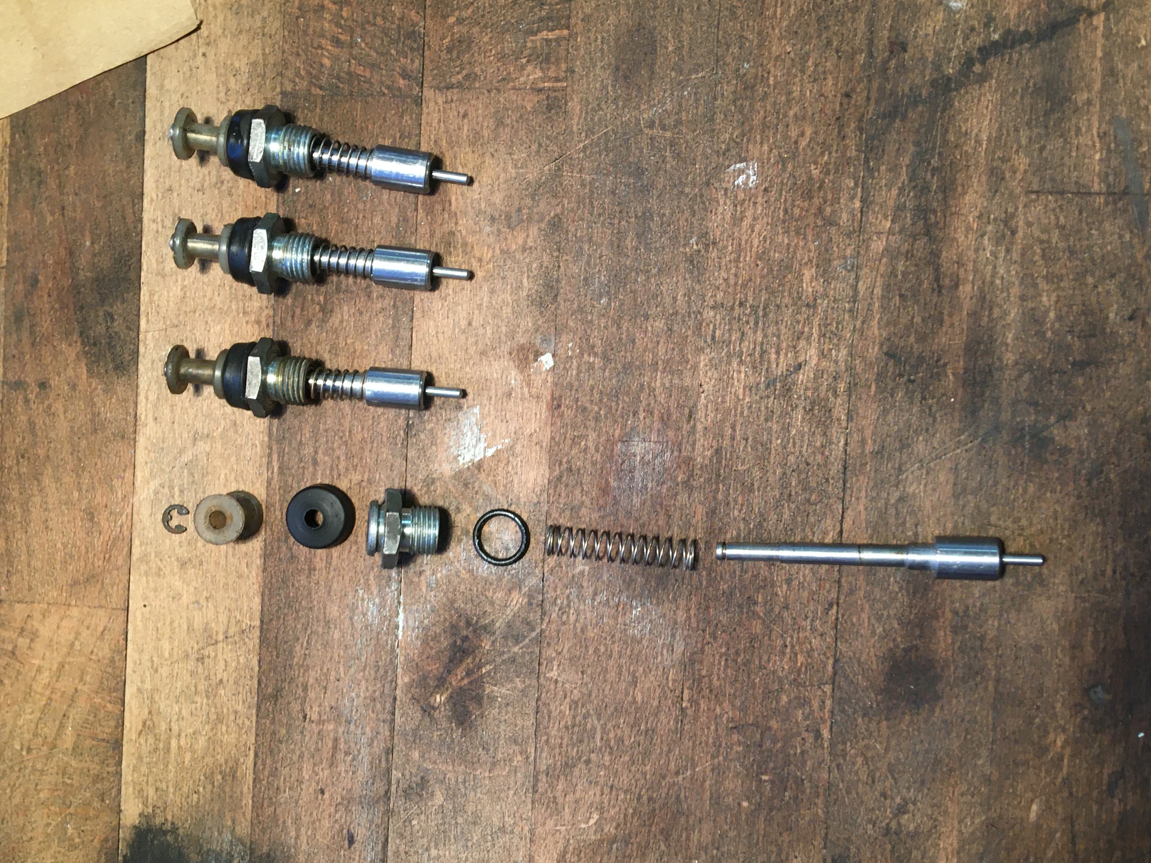

Your picture shows you have 3 o rings missing and the one showing looks knackered. Definitely replace those whilst apart. Those o rings are critical to seal and stop air sucking in from the thread and greatly aids easy cold starting.

#10 PostAuthor: KwakaRascal » Sat Mar 27, 2021 10:34 am
Hi Warren3200gt,
Thanks for your observation, I will be replacing the o rings.
