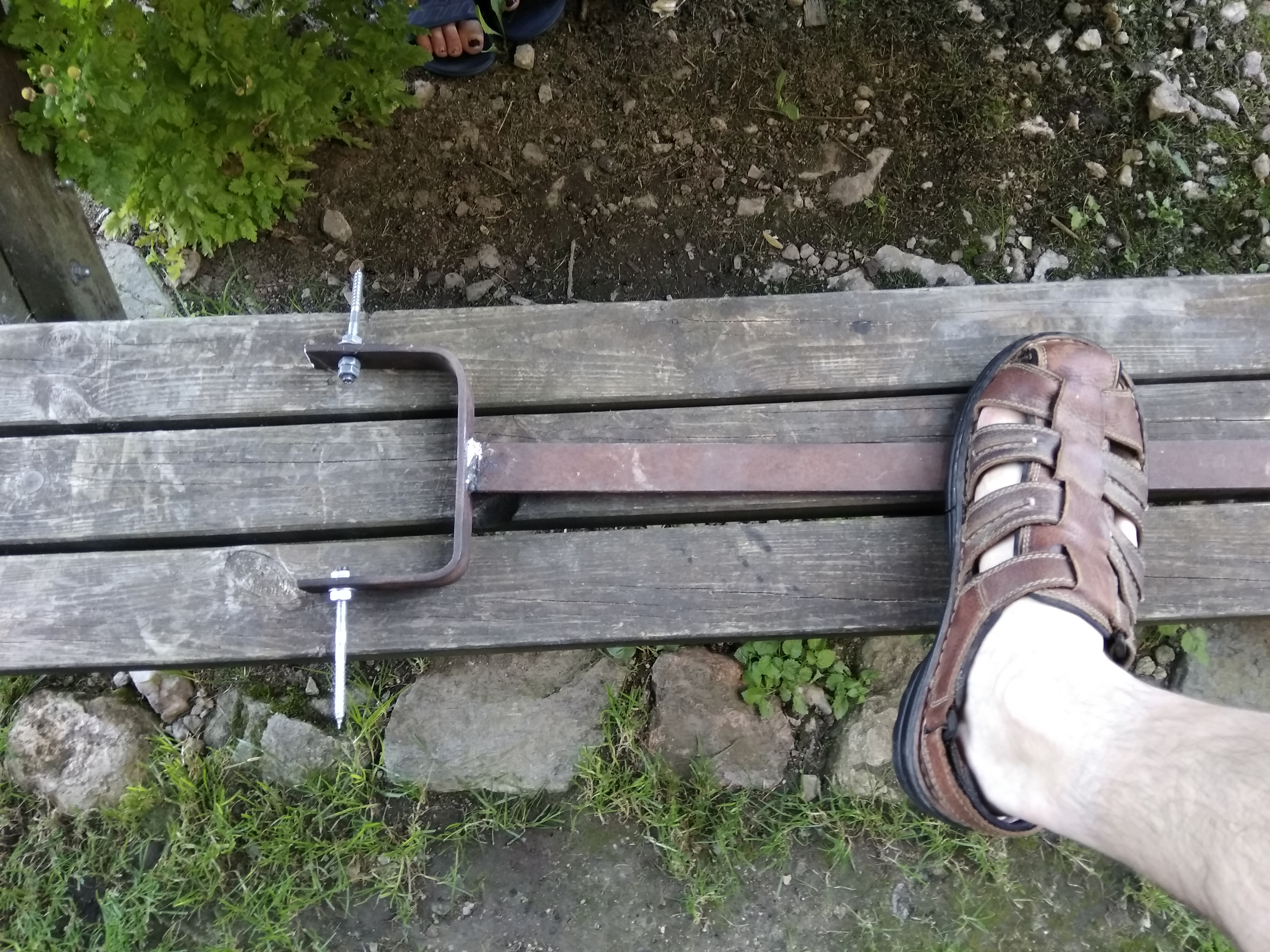

I made one for My GPZ11, just got to be careful not to break the magnets when setting the depth.

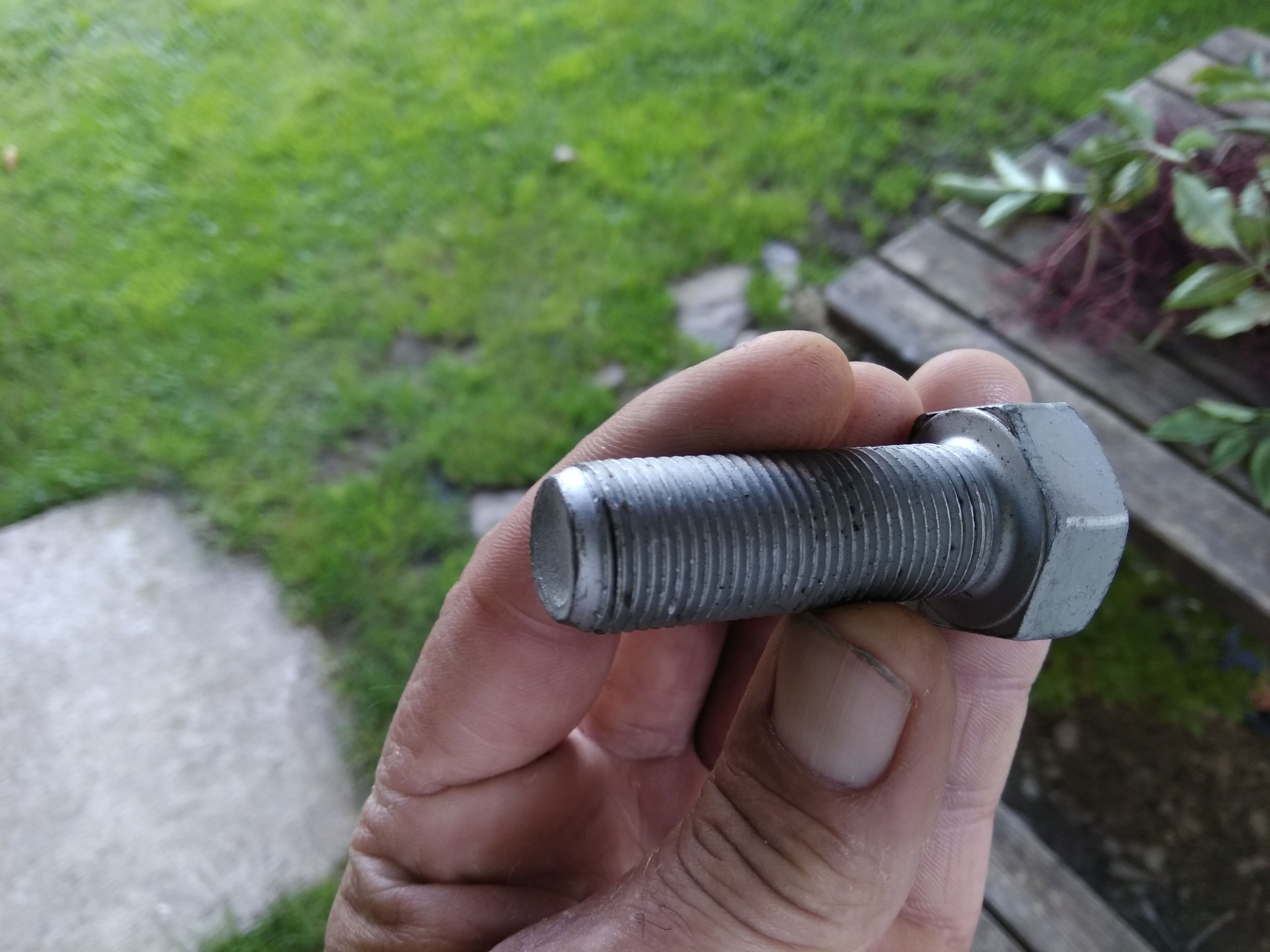

Alternatively you could use an impact wrench. You still need to get the rotor off, so there is a special tool, or, with the tool pictured above along with an (I think for the GPZ anyway) 18x1.25 bolt and add a ball bearing if you're feeling flash, that will draw the rotor off.

I should have explained better, I have the old rotor cup off, I removed it with a puller, although after Ollys point, I could have used the rear axal , still good to know that method, the reason for placing the post was to see if I could get my hand on the rotor tool so as to install a new roror cup, when I stripped all this side of the engine which is still in the bike but will be comeing out soon, the magnets where damaged so I placed a small diamamter bar through one hole and then tightened up the puller bolt and off it poped , mine you it did get quite a beating with a electric impact driver, I would not normally use this sledge hammer to crack a wallnut approch but the fact that the magnets where damaged did not really make much difference.
I will be looking into seeing if I can obtain the magnets from somewhere, who knows at this stage , in order to overhaul and balance the old rotor cup, we will see on that idea, when it comes to replace the new one I will either see if I can make a holding tool based on yours Adrian or may be the strap idea will be used, I will check the torque figures.
