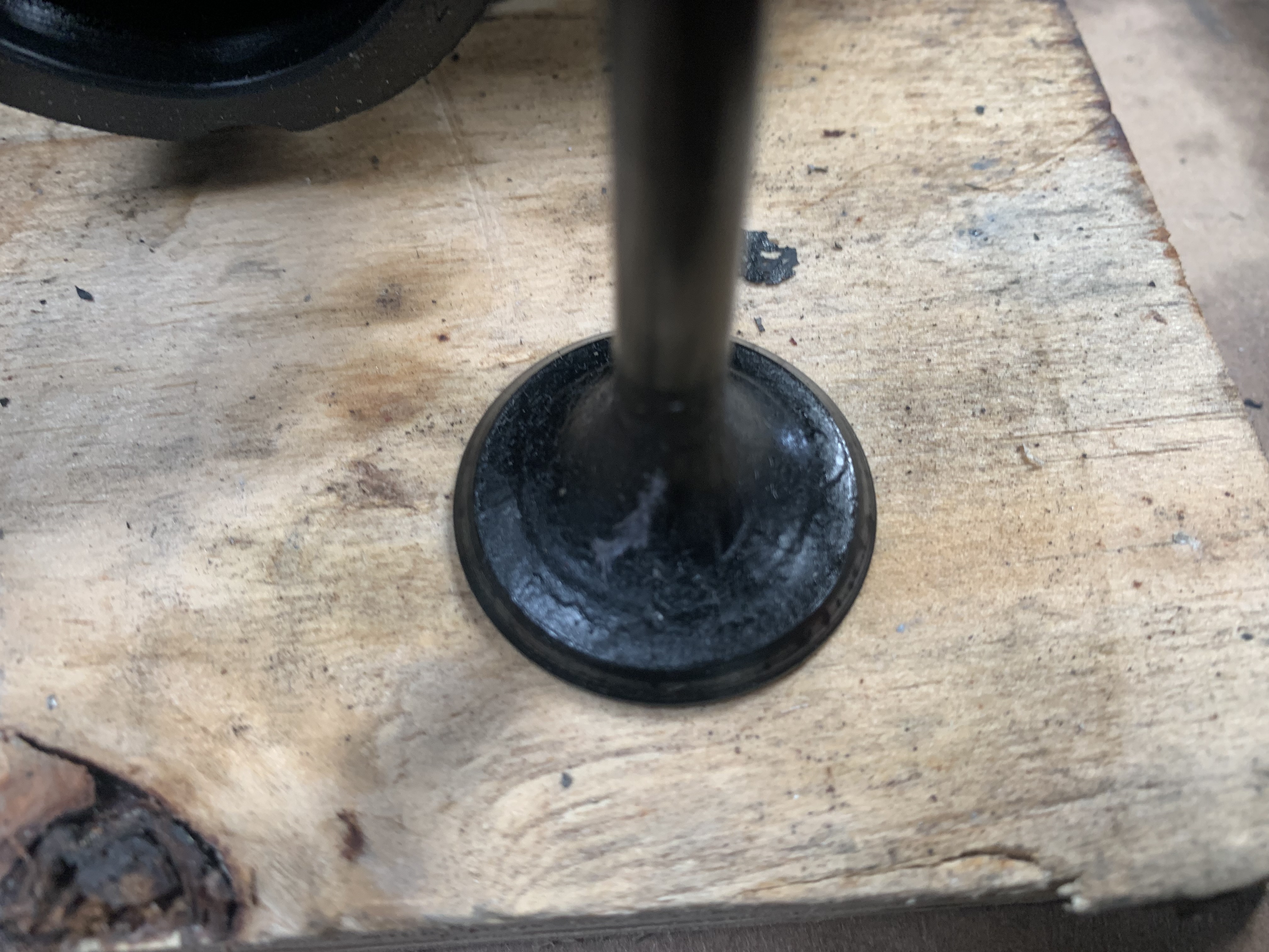

I've just took the valves of no. 3 cyl. out of the head. The seals seem fine. The valves don't fall out when the head is lifted with the collets removed.
The back of the exhaust valve is now coated in sticky tar. I presume this is part of the oil issue? does this indicate oil seeping down the stem and being burnt/baked onto the bottom portion?
I took off the barrels when I was this far. The bottom oil ring was at 7O'C, the expander was at 11O'C and the top oil ring was at 5O'C. and no obvious damage. Is the position of the oil rings to the expander as in the book critical? It says the oil rings should be slipped 30deg each side of the expander. I though I had followed the book fitting them but somewhere they have moved but I cant see what diffrence it would make unless they move closer. Could this effect the cyl. to burn oil?? I don't know what else to look at. I'm tempted to swop out the seal on the no.3 exhaust valve with the one from the vesrah gasket kit and try it.
I also looked at the guides as Al suggested, I was prepared to find a major issue, but nothing! I have picture below of the guides and the tarred valve. I am stumped.

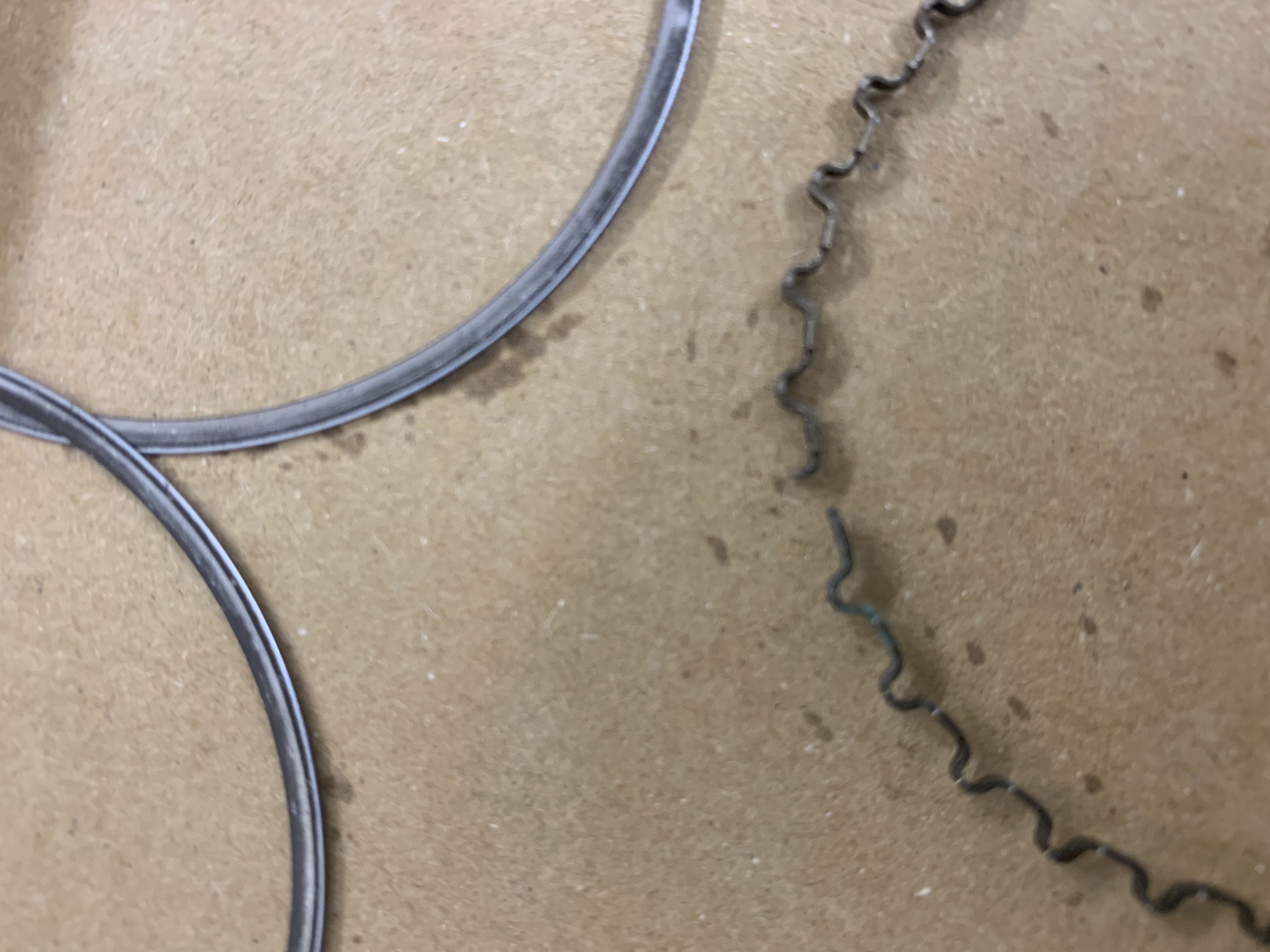

make sure the expander ring is not overlapped & that the ends of the expander have not broken

Are all the valve guides sticking out of the top side of the head by the same amount if measured?
Guessing the second pic above is the number 3 exhaust guide in the port.
It looks a little short!
Maybe give them a gentle tap with a soft drift and hammer as if you were trying to take them out but with not enough force. Any that maybe loose will sound different!
Had one come loose on mine very recently and had to have an oversize one made and fitted. Thanks Buzzard.

Al wrote:Are all the valve guides sticking out of the top side of the head by the same amount if measured?
ZIB man, you might be on to something! I was struggling to find the end of the expander but was pretty sure I did, eye sight not being what it was. When you posted the sketch it dawned on me that it didn't look quite like it should. I had to take the piston off to get a proper look at it and sure enough the little tab on one end of the expander is missing. Good call, but is it enough to cause all that smoke? The seal looks ok, and oil can only come from the valve guides or the piston ring?

yes if the tag is missing that is your problem kawasaki back in the day recalled some gpz1100s that where burning oil they modified the pistons & the rings for this same reason bikes where using up to a pint of oil every 700 miles.its best to paint the tab with a bit of white paint to make sure you do not get them overlapped

z1bman wrote:yes if the tag is missing that is your problem kawasaki back in the day recalled some gpz1100s that where burning oil they modified the pistons & the rings for this same reason bikes where using up to a pint of oil every 700 miles.its best to paint the tab with a bit of white paint to make sure you do not get them overlapped
If this is the cause I will be so relieved! Good tip painting the tab especially with my eyesight!

the broken tab will 100% be the cause. be extra careful when sliding the cylinders over the oil control rings don't even think about reusing. i would clean out the exhaust down pipe before you put the exhaust system back on
