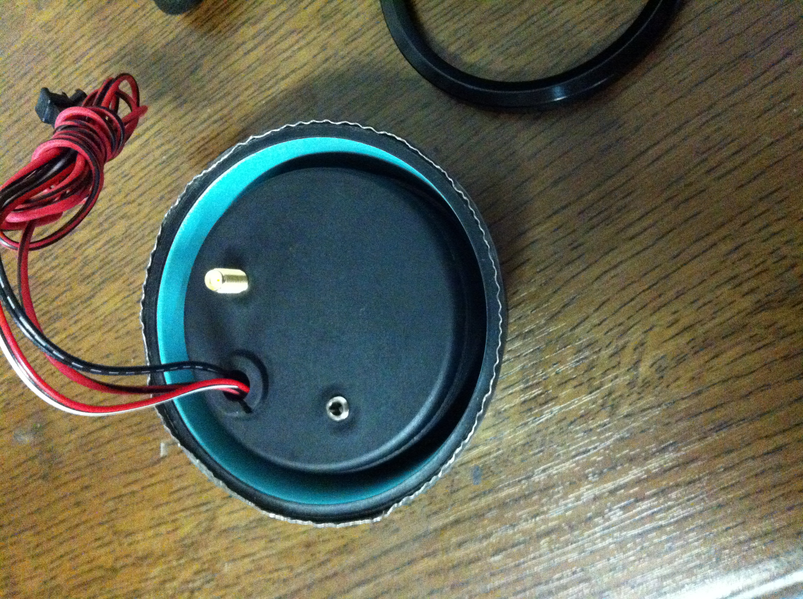

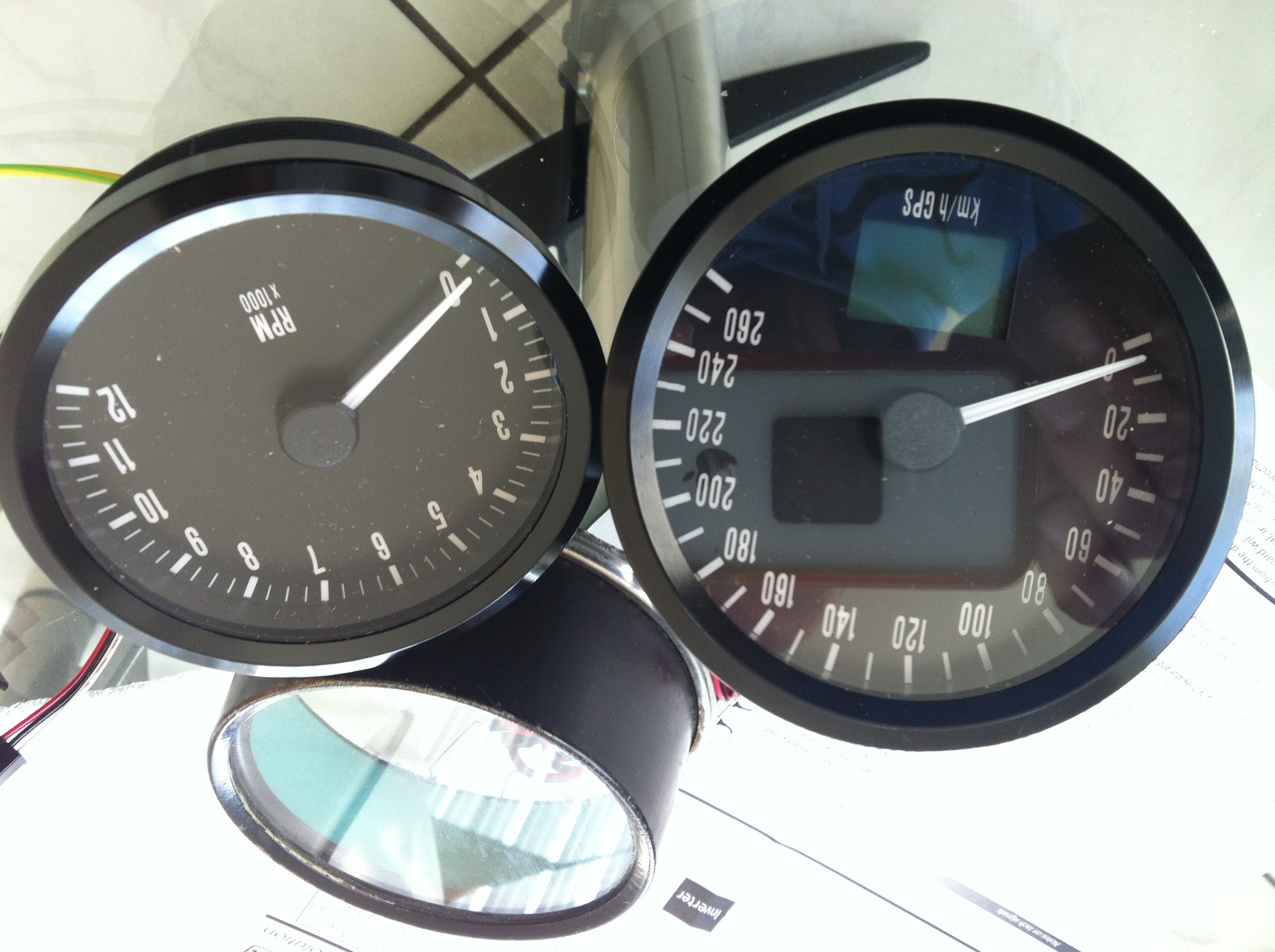

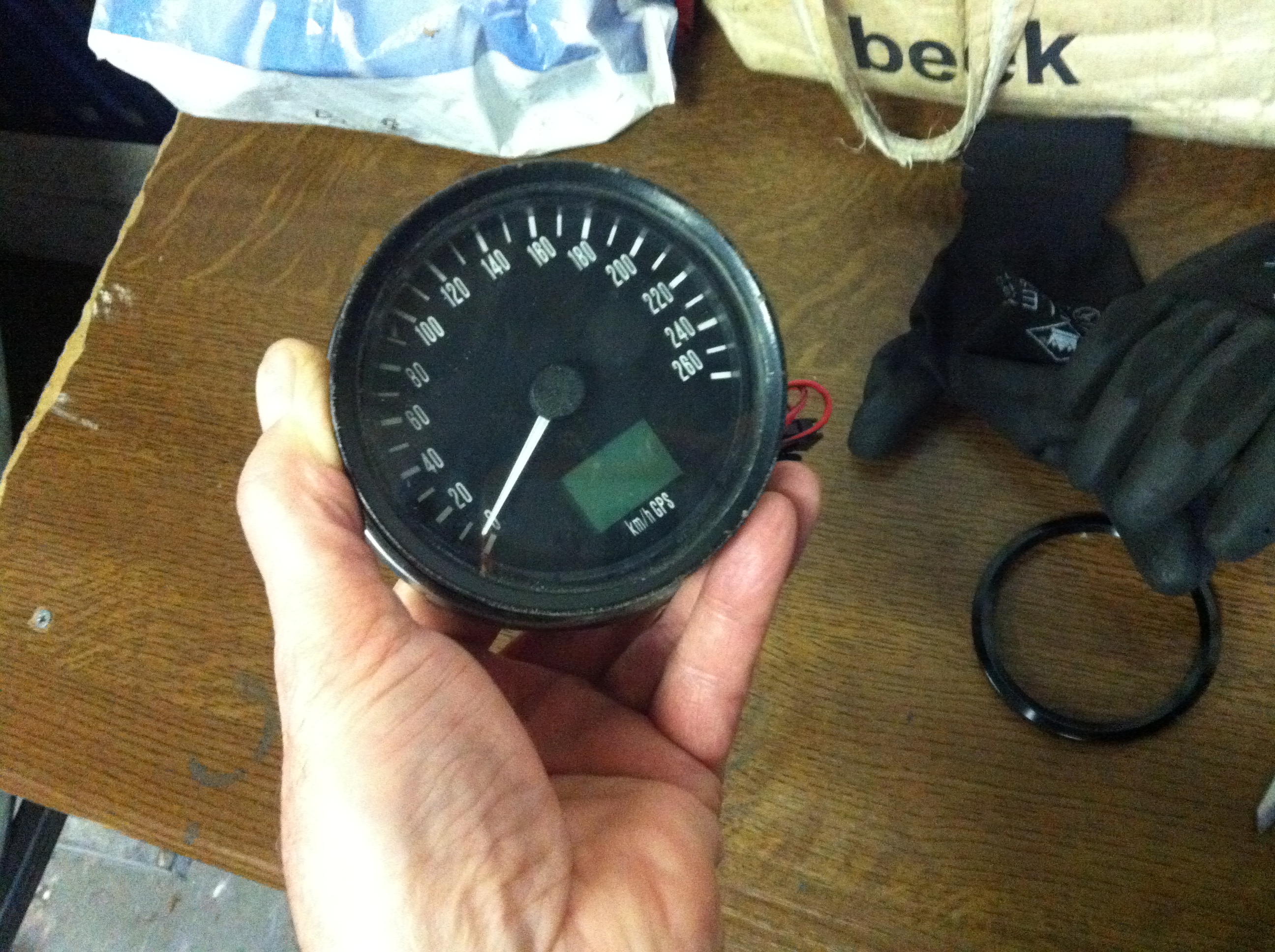

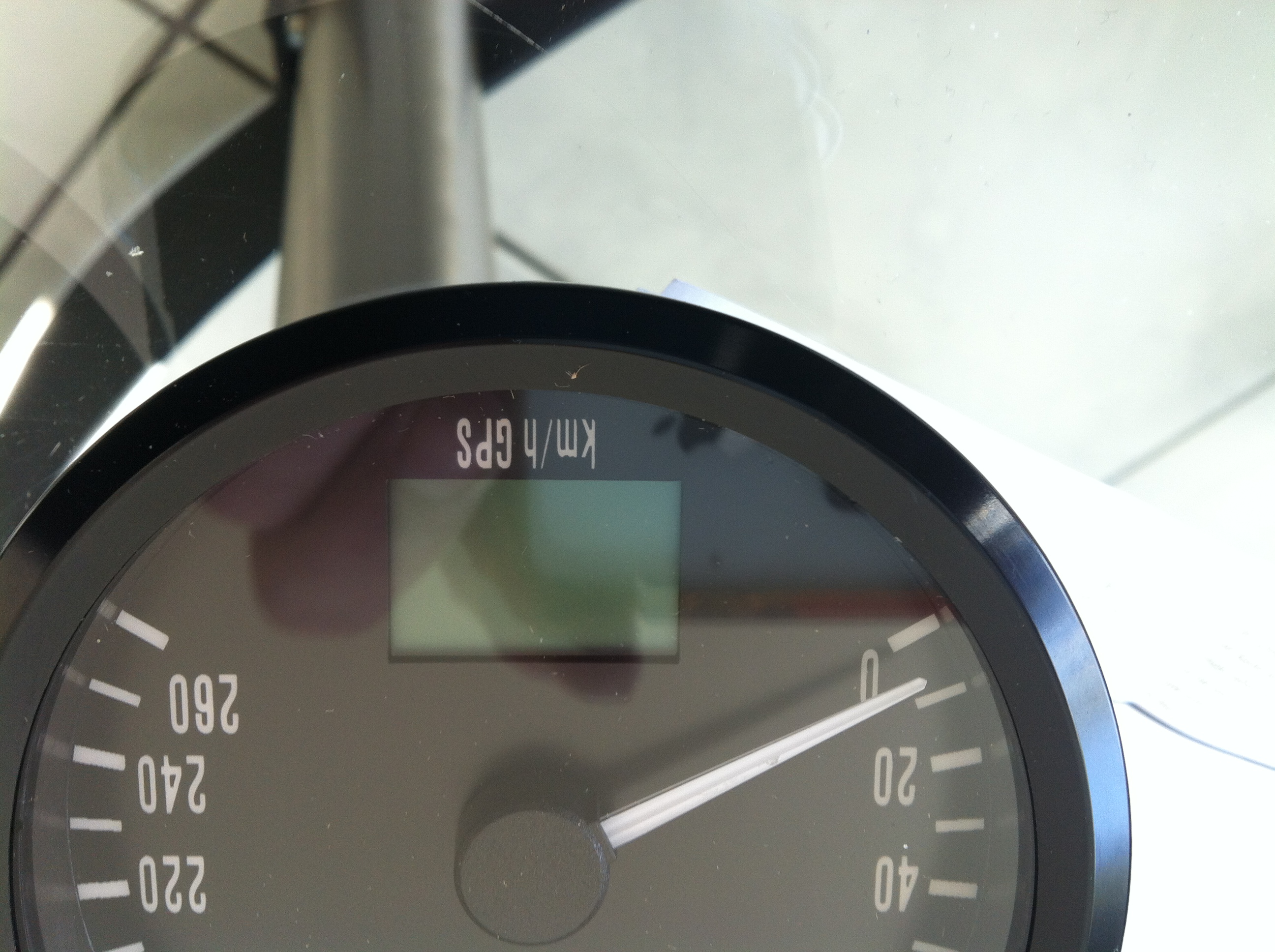

I bought a set of electronic Speedhut tacho and speedo's from the States to fit inside the stock housing. The speedo uses a GPS antenna to calculate speed. The tacho gets a signa from the coils. Fittin however is not plug and play .. I had to make some teflon cylinders to fill up the gaps inside the housing ( a rather precise job) and glued them together before fitting the rvs ring again.
Here some pictures before closing the housings. If you want I can post some pictures from the finished products.
