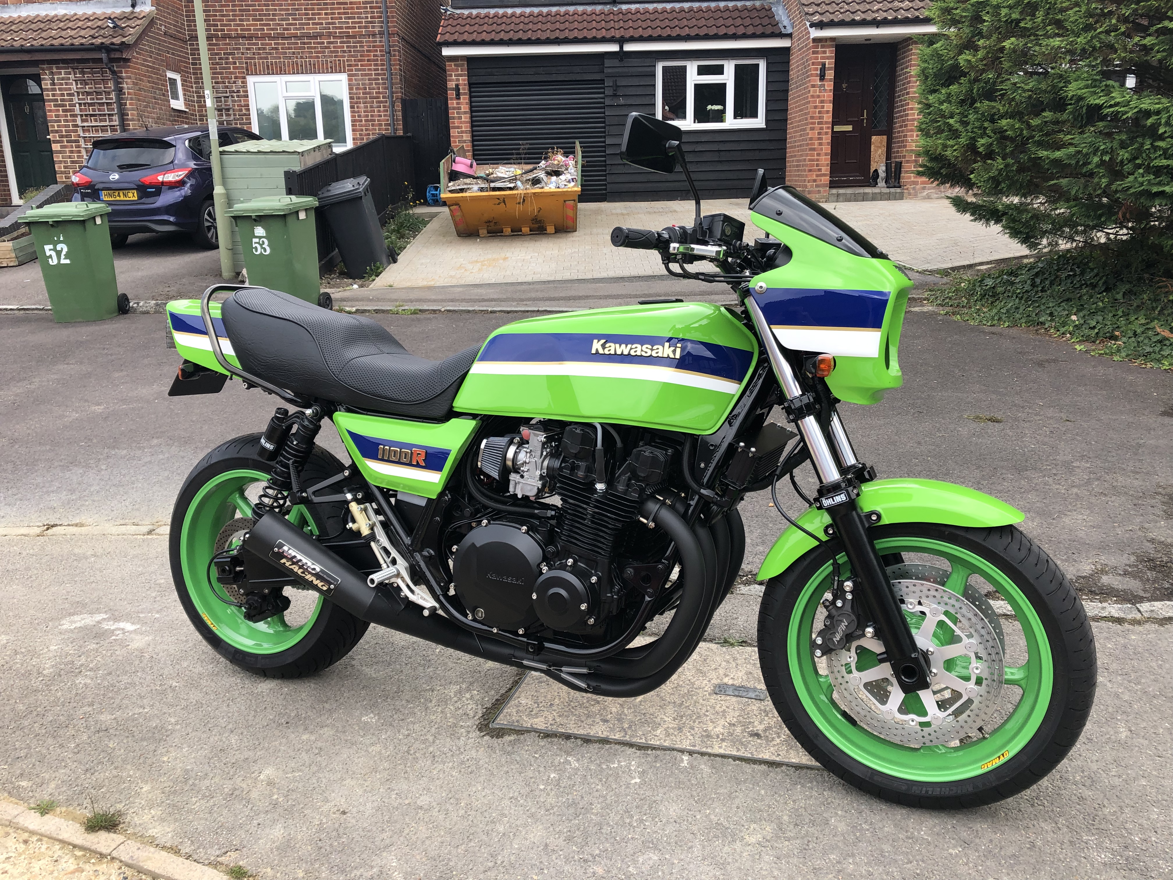

Hi Dave, the offset sprocket will be machined to take the lock washer.
Yes, big tyres. It’s a 180 rear and 120 front. It only fits on the rear due to machining work. The wheels are magnesium from Dymag. The hubs are removable and can be machined by Dymag or remade to suit. I had a new hub made and a new sprocket carrier made. This enabled perfect wheel alignment and also perfect chain alignment. It did have a Pirelli Diablo Super Corsa on it. That tyre is 185mm……to big, it actually clears the frame etc but touched the rivets on the chain. Fitted a Michelin PR4 and got 6mm chain clearance. The Michelin actually measured 179. It’s stated to be a 180.
This is the reason why so many builds have clearance issues.
A. The tyre is to wide. Not all 180’s are actually 180. I tried numerous tyres and only the PR4 was exactly as it should be.
B. Most wheels have fixed hubs/sprocket carriers and are not removable to machine. You are stuck with what you get when using OEM wheels.

Hi Scott, your bike looks absolutely brilliant !
Putting modern/wider radial wheels and tyres on old Zed's can bring many challenges to catch out the unwary. It sounds like you've got it all covered though!! Wheels with removable hubs are a big help, though that means aftermarket / race wheels and +££££'s but as you know, its worth it.

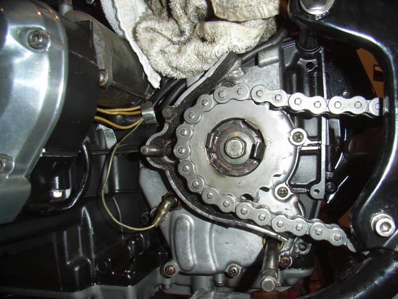

Dave, i have changed to the later type output shaft with the nut but a couple of years back i was doing this with non drilled sprockets.
The ZZR sprocket; 'inner flat', wasnt wide enough to take the 'retainer kit tab washer' so i made a simple copy which is a little narrower and cut down the outer edges of the 'bolt head capture plate' to suit.
I didnt use loctite on the thread and loctite, or other thread lock liquids dont appear on the original methodology or on the later revised methodology and i suspect the reason for this is because if you lock the thread to the shaft and the head end of the bolt rocks back and forth every time you change gear the bolt will eventually fatigue. This may take ten years though
Picture of ugly looking approach to not having to drill or tap a bastard hard front sprocket at the very bottom of the page!!!
viewtopic.php?f=7&t=45977&start=120

Ha Ha ! Get the welder on it ....
Al, thanks for re-posting the old thread - I knew I'd read something about this before ! I too had also thought about making a "modified tab washer..... your pictures are proof it works - if it'll cope with the 5/8 offset sprocket it'll handle anything !
You've mentioned the shorter length of spline on the newer sprockets and I've also wondered if I could use the later tab washer from the J3 and modify /devise a new retaining bolt to allow the splined washer to sit on the end of the output spline and use it to lock the bolt.... or am I just going crazy !
Meantime I'm using the standard tab washer assembly and a narrower wheel....
J3 onward "nut on end of shaft" has got to be the best solution though.... like what you've done.... and put the welder away !

Maybe not as mad as you think. The 'nut' fixed, later version has a large hollow recess on the back face of the nut. This is to clear, in part, any excess protruding shaft length.
The ZZR sprocket came with two large (spline to the inside) locking washers. These would be the way the ZZR locks that nut in place.
I used them both behind the sprocket so there was no excess shaft protruding beyond the sprocket face.
So all you need to do is make a bolt with a nut sized head with a recess on the back face and youre in business.
Or take my lazy way out and blow some sparks at it for ten seconds.
This was the final incarnation in the saga of lazyness where i had a recessed sprocket with parallel sides so i dispensed with the base part of the tabbed washer locking system and just welded four stubby tabs to the sprocket.

Al, the last picture doesn't display at my end but I think think I understand from your description ! It's probably the simplest way to achieve whats needed if I understand it right.
