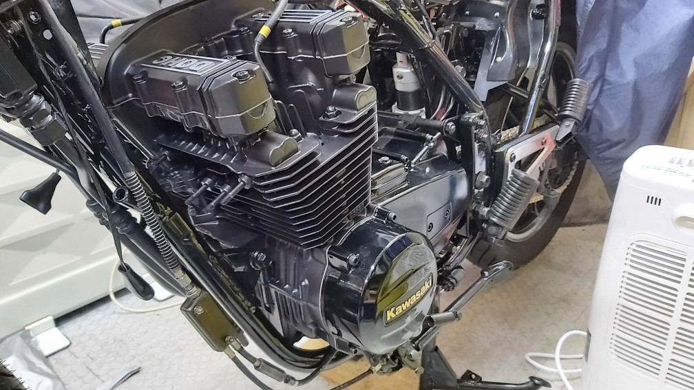

Last weekend was a good weekend in the garage and some major progress has been made on the 550 :D There was, of course, the obligatory last minute issue to overcome but even that had a positive outcome !
The plan was to get the engine completely oil tight and all the ancillary components & covers fitted, which would be a major milestone in the rebuild. During last week, I spent an evening in the garage getting everything ready in preparation for the weekend. However, when giving a last minute checkover of the alternator rotor, I found 2 sections of the magnets had cracks and one had a small piece missing :( I went on the internet thinking I might find a better secondhand replacement but actually found a brand new NOS one for £60 :shock: No thinking needed there and 3 days later it was in my garage !

With the rotor issue resolved it was time to crack on and work through fitting all the bits & pieces ! The cam cover went on first (after copiously oiling the cams & valve buckets), followed by the NOS alternator cover and ignition cover with their badges. Next on was the clutch cable, which also retracts the side stand if you leave it down, followed by the clutch cover, the starter cover and suddenly there were no more bits in my box. It all sounds simple put like that, but there was much fitting/removing/fettling to get everything to sit "right", especially the clutch cable & cover, but it was all worth it !
I'm know I'm biased, but I love the all black finish of the GPz :luv

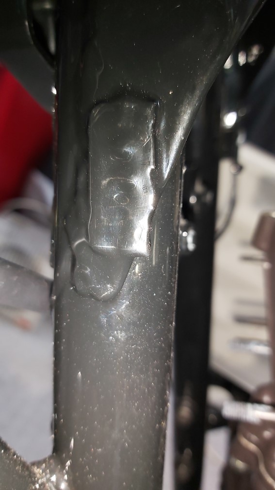

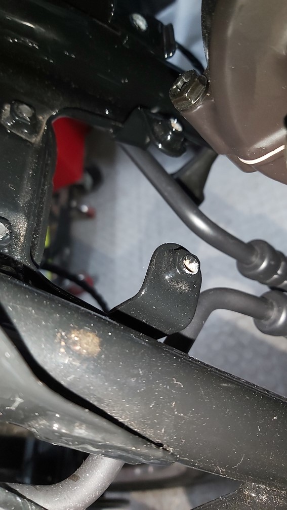

More serious happened a few days later when the GPz unfortunately fell over :( I'm actually too embarrassed to admit to what happened on here - no-one to blame but myself and my own stupidity :oops: Thankfully, it seems the garage gods were with me as the handlebar fell against a cabinet and the frame got wedged on the dehumidifier thus preventing the bike going completely on its side. The only damage I found was the rear indicator bent up at 90 degrees after hitting some storage boxes and some small chips in the paint on the lower c/cases, but it's out of view when the bikes upright ! The indicator bracket can be straightened and re-painted, the bracket on the frame will also need straightening, but it's a bit inaccessible, so will take a bit of thinking about.
As everything comes in threes, the last problem was I found a broken & missing bracket on the frame. It's for one of the dual horns to mount on and it obviously broke years ago, but I just didn't see it was missing before getting the frame powder coated right back at the start of the project. Now looking at it, I have 3 options -
1. Run with just a single horn
2. Fabricate a bracket and find a good TIG welder to weld it back on the frame. I say TIG as I think it would cause less damage to the powder coat than MIG ?
3. See if I can find an alternate way to mount the second horn. There are a couple of spare brackets I might be able to use but the bracket would be fairly long and convoluted
I'll have a think about which will be the best, but the perfectionist in me wants to re-instate the original bracket - we shall see.
This is the exisiting bracket on the R/H frame downtube
This is whats left of the L/H bracket - only a small piece still attached to the downtube
The two brackets in the middle between the frame tubes are used in the USA for "Reserve lighting device" - i.e daytime running lights. I thought I might be able to fabricate a bracket to attach on these and then bend it to position where the original should be. The only problem is I think it will be quite convoluted and therefore prone to fracture. You can see whats left of the original bracket in the bottom of the picture on the frame tube.

Regarding the missing bracket, could you make up a bracket and if you've got any engineering places near you see if they've got a single sided spot welder or mig a puddle weld. The puddle weld method is used to repair poor spot welds in production. Remember to disconnect all electrickery.

First up was a slight issue with the oil cooler pipes, when I noticed one of them was touching the no3 header pipe :-( A lot of head scratching followed trying to work out why and I thought I'd have to drop the exhaust off (again) and put a slight bend in the oil pipe to clear it. But first I thought I would try loosening off the oil cooler bolts to see if I could get enough movement to get clearance. Once I tried that, it became apparent the top holes in the 2 small brackets I made up to bridge the top cooler mounting points, were slightly out of line - only a couple of mm, but enough to put the oil line slightly off line. Elongating the holes slightly brought it all back into line and problem solved :-) I will look at making those brackets again at some point in the future, but for now they'll do !
I was having a coffee and a chat with a mate whilst showing him progress on the GPz. As he's an aircraft engineer, I was picking his brain on the best way to replace the missing bracket - possibly welding as I'd already discussed or some other way of getting the horn mounted on that side of the frame. After looking at the problem he suggested making up a single bracket the spanned the width of the frame - use the good mounting point on one end and make up a tie bracket from the spare lug I'd already identified to support the other end - genius :D So that's what I've done - I've fabricated a bracket for the horns and a tie bracket, using the redundant mounting point on the frame for the USA spec "Reserve lighting device".
