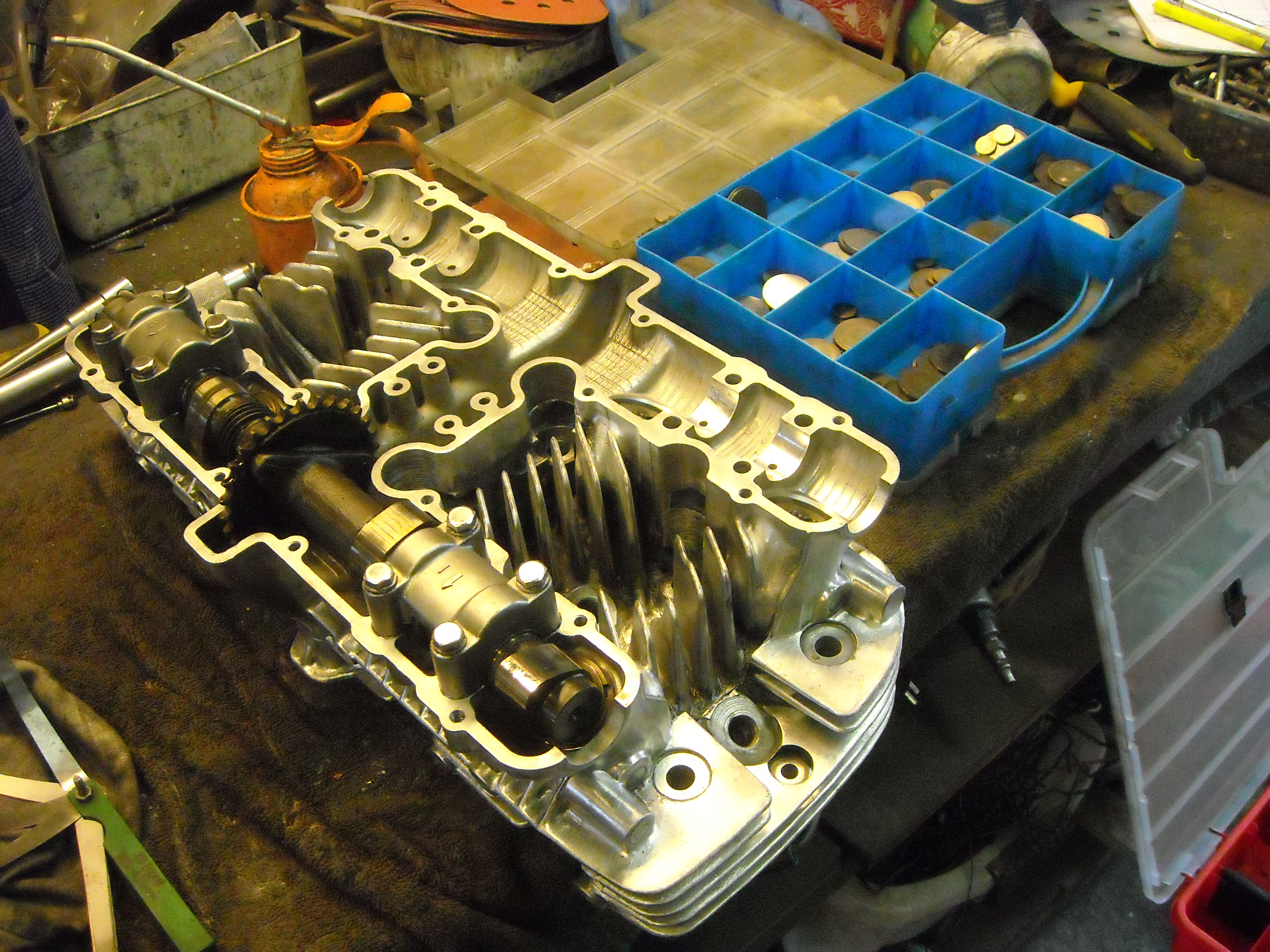

I also spent a lot of time on cleaning the cylinder head.
After about 2 days the results were good enough for me so I started to assemble it.
The valves were all lapped and then the assembly commenced.
Just an advice for people who do this for the first time:
don't forget to put the spring dishes in the head BEFORE you put the valve stem guide caps on!
If you don't do it that way, you can't put the spring dishes in after the guide caps are in place and you'll have to remove the caps and thereby causing damage.
When I put the valves in the guides, I always use a bit of special grease on the valve stems.
After all the valves are installed in the cylinder head it's time to shim them up.
Keep in mind that when lapping the valves, you can have a difference in the thickness of the valves and that you have to adjust the shims to get the correct amount of play.
When doing that with the head off the engine, always install one camshaft at the time, never the two at the same time.
If the two camshafts are installed at the same time, there's a big chance that an exhaust and an intake valve can be opened at the same time and that they damage each other because there's no timing between the two camshafts.

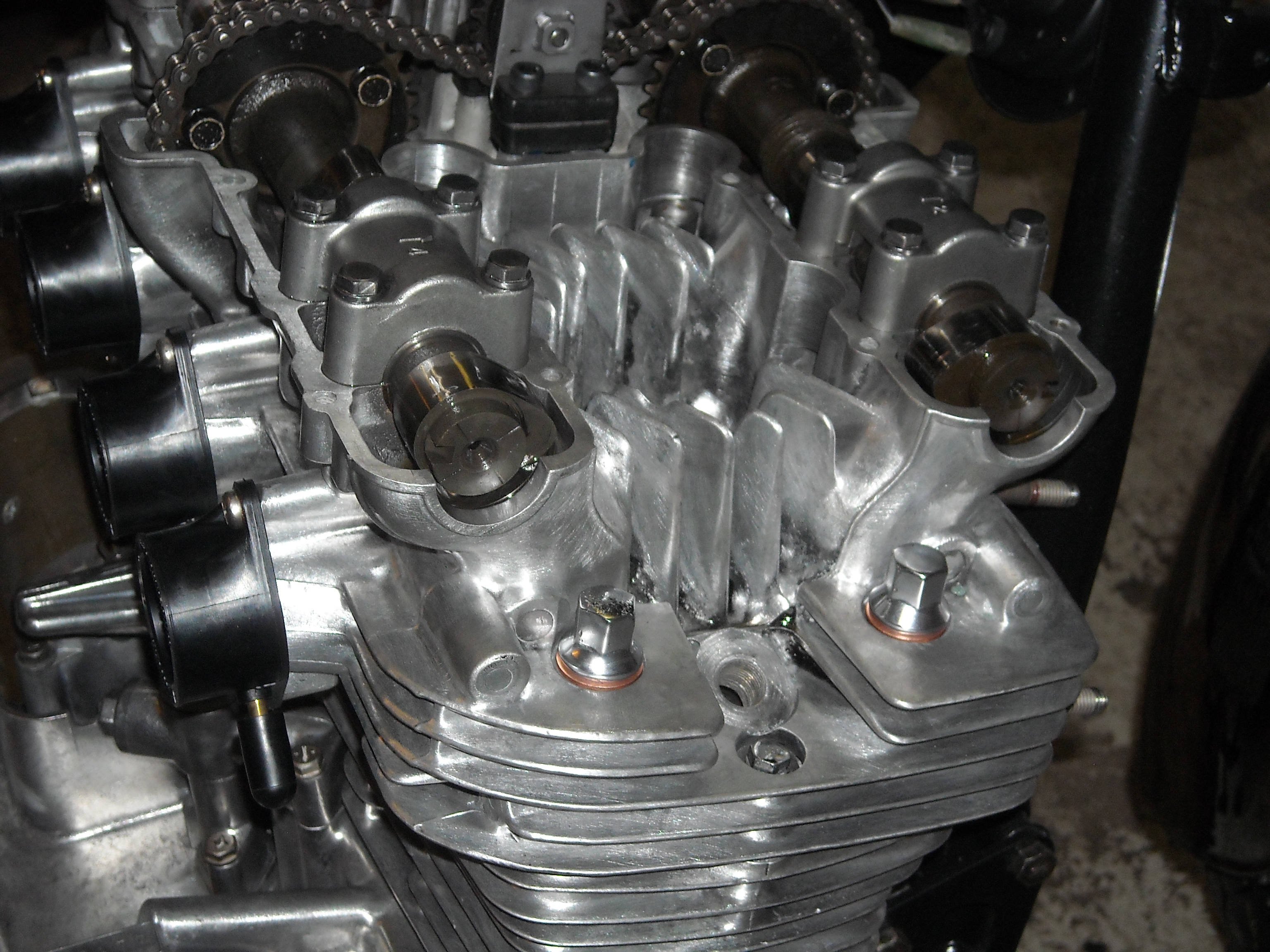

After all the adjusting the cylinder head was prepared for instalment.
The exhaust studs were mounted and the intake rubbers were also mounted.
It's easier to do it at this stage, you have all the room you need to secure them tightly.
The other camchain parts were installed, the gaskets put in place and the head was mounted.
The timing was set and this is the result of a days work.

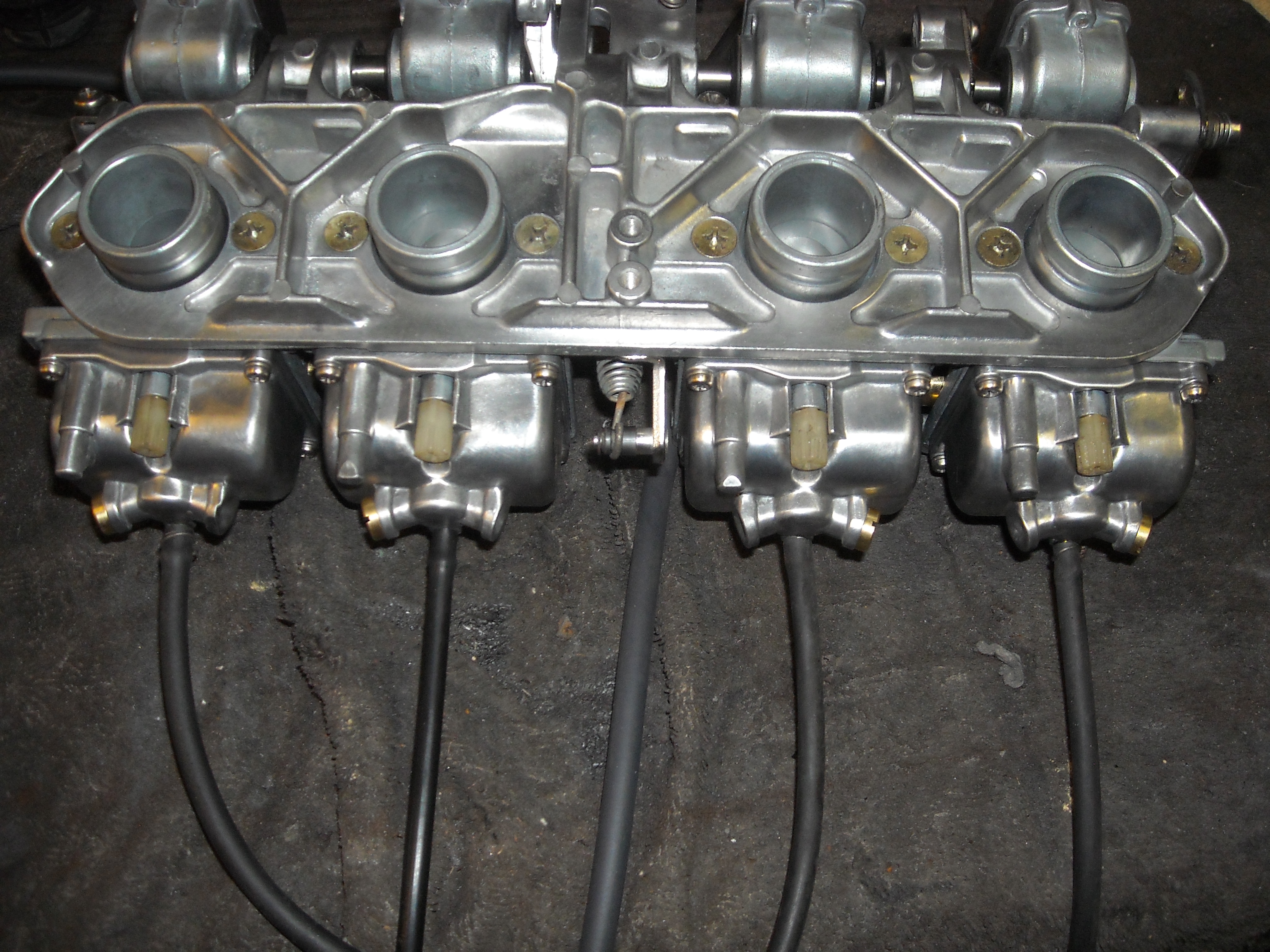

Yesterday morning I assembled the carbs, after the assembly the stationary synchronisation was performed, the float level hight adjusted and they are ready to be mounted .
Even the plastic caps over the needles are in place! Most of the time these are gone but they were still present when I bought the bike.
In the afternoon the engine covers received the last treatment before the clear coat was applied.
I have to wait to mount the carburettors until the engine covers are baked to harden the alloy varnish.

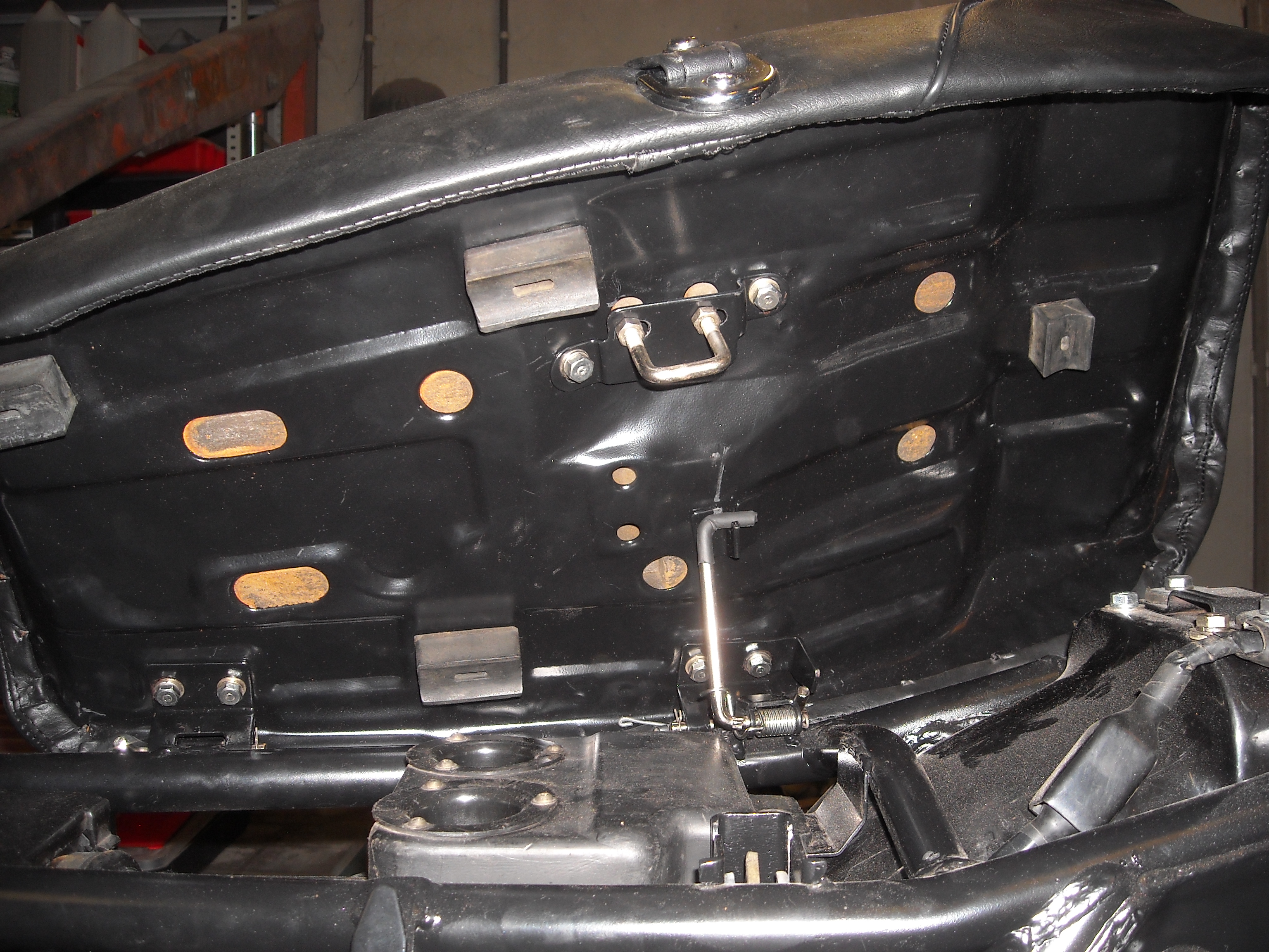

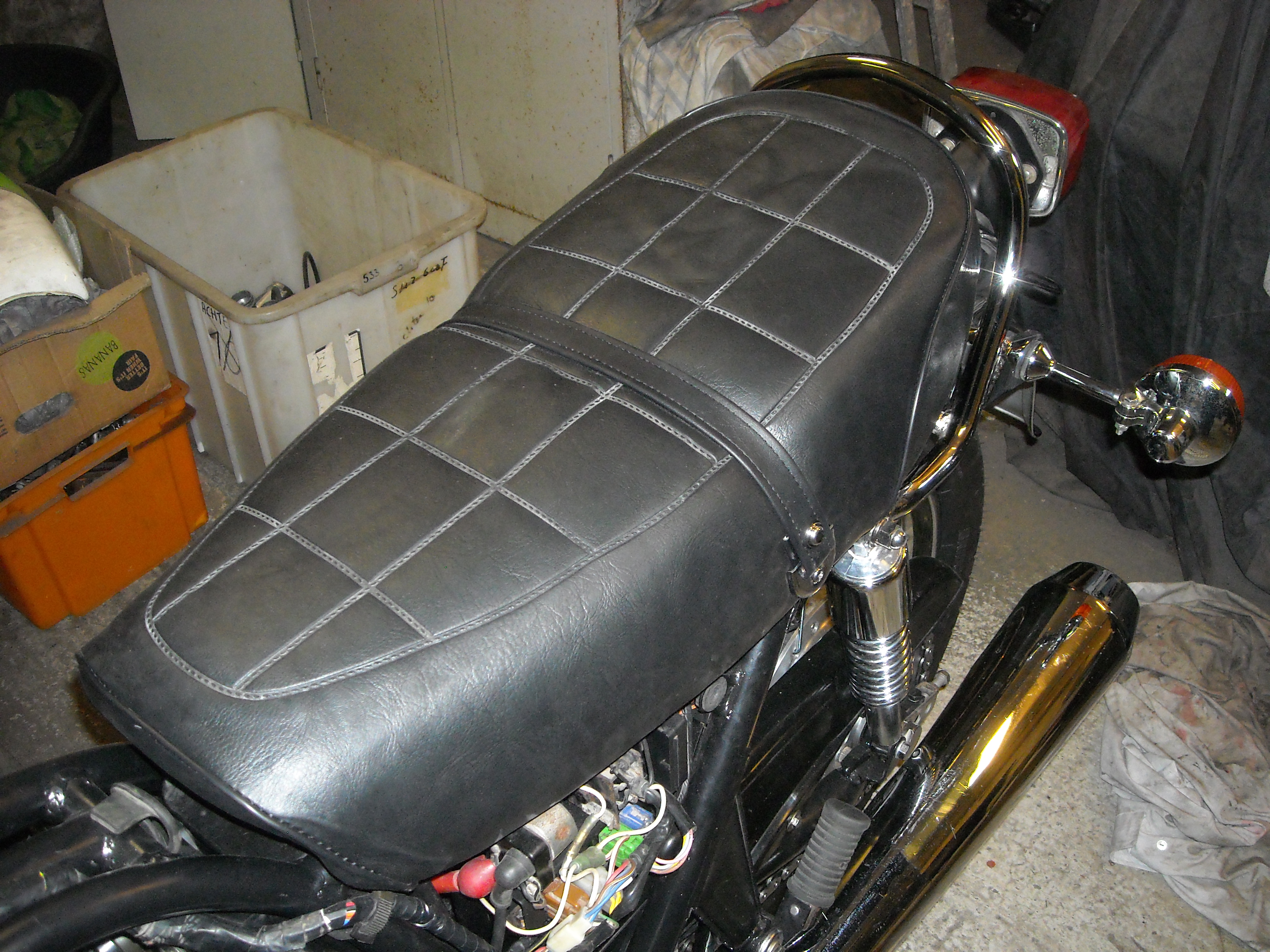

Today I started with the seat.
A new seat cover and strap were installed
The hinges, the lock loop and the dampers found their place and the seat was mounted on the frame.
After that I mounted the exhaust.
It's not a new one and it has some scratches but it's an original!
As you can see I got some help of Thorben, my partner in crime, he kept the blanket warm that I had spred on the ground in order to prevent the silencers get more scratches...
