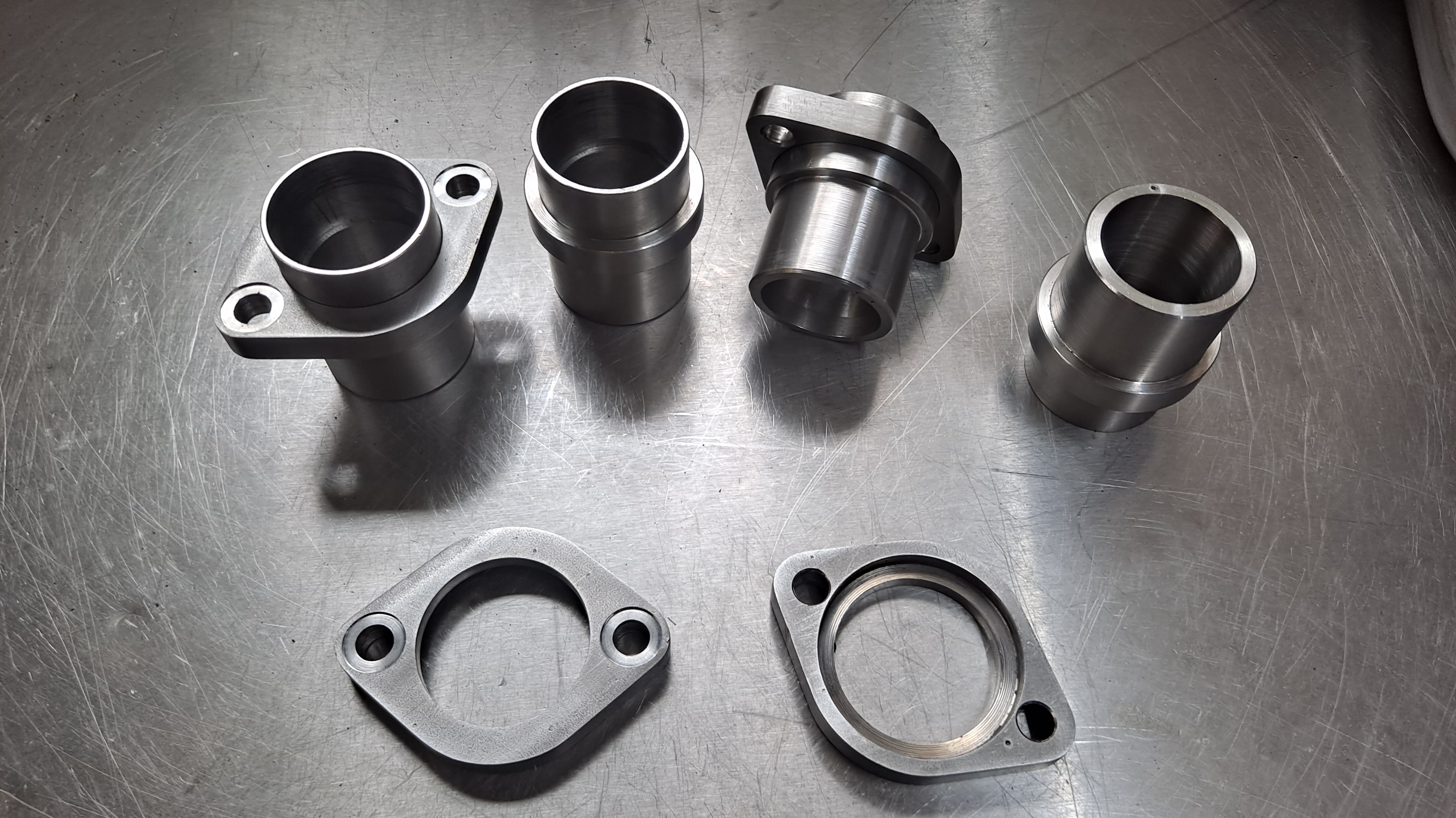

First job was to order in some 304 stainless 38mm 180 degree bends, 2 inch round bar and 10mm flat plate for the raw material.
The 10mm plate for the exhaust clamps was cut into four, bored out on the lathe for the spigots and then became the first proper job for the restored Harrison mill to machine the angles on them
The 2 inch solid bar was divided up the same and treated to a day in the lathe until i had the spigots and basic flanges..
Then pretty up the flanges with some rounded corners and spot face the surfaces truly flat for the mounting nuts and washers.
Each spigot was individually matched to it's gasket recess in the head for snug fit and numbered along with the flanges..
I did the same on the ally cafe and no gaskets were needed so i hope this turns out the same..
Pipes are tight slip fit in the spigots which will be welded on once completed .

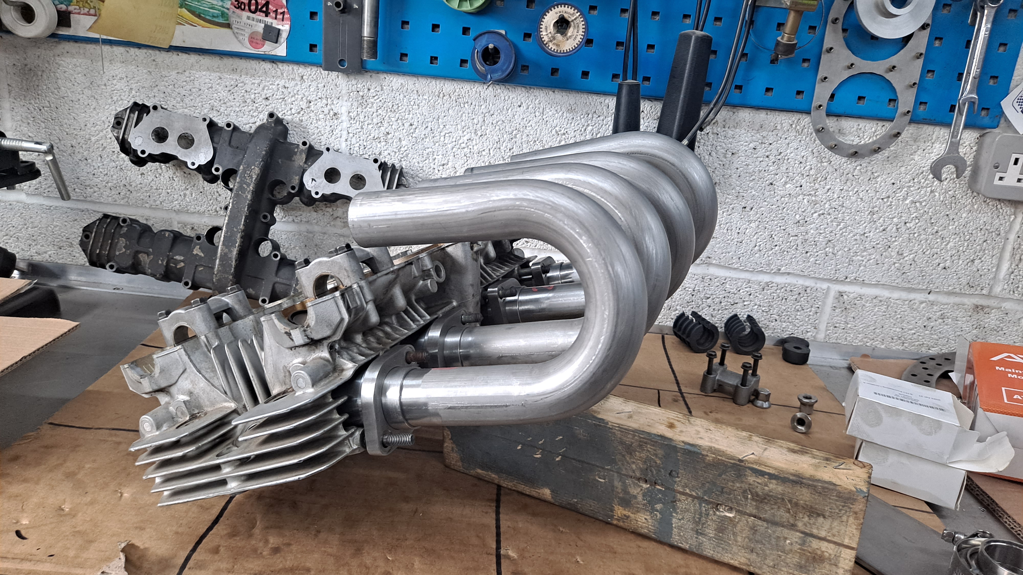

Slotted the head back on today and shortened pipes 2 and 3 .
Took off just enough to clear the mudguard on full bump and 5mm extra in case i'm forced to fit some exhaust gaskets.
Turned out better than expected, not as tight for space as first appeared and a decent leg length of 100mm before the bend out of the head and these two can go straight to a collector in one sweep .
Was prepared to have to remove the sheet steel gusset which i'd already opened up but it looks like i've got away with it.
Plenty of room to snake 1 and 4 around the down tubes and up behind the midpipes and i think i've got half a chance of getting them close to equal length with the middle ones.
