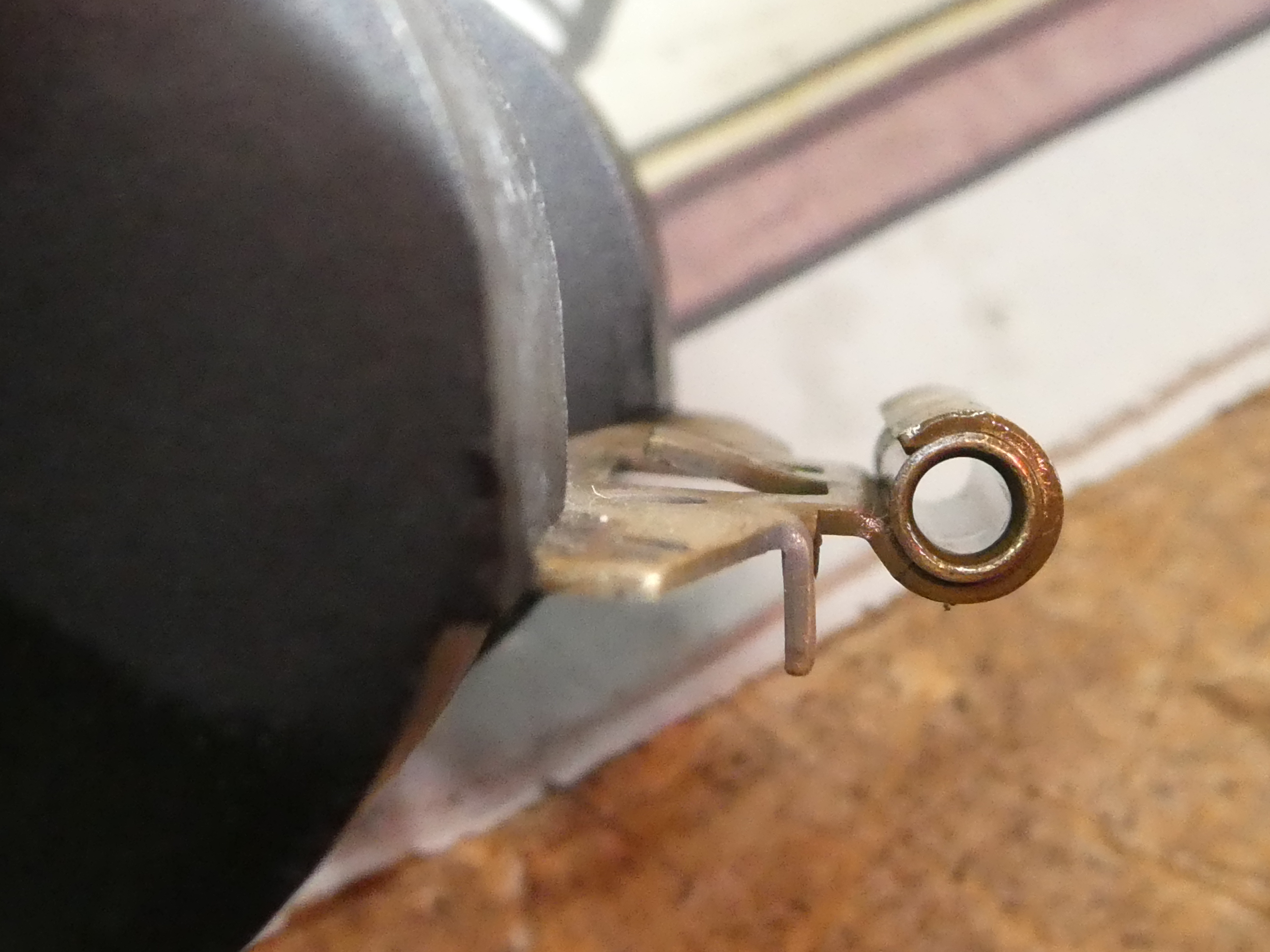

Attached is photo of needle valve tang.

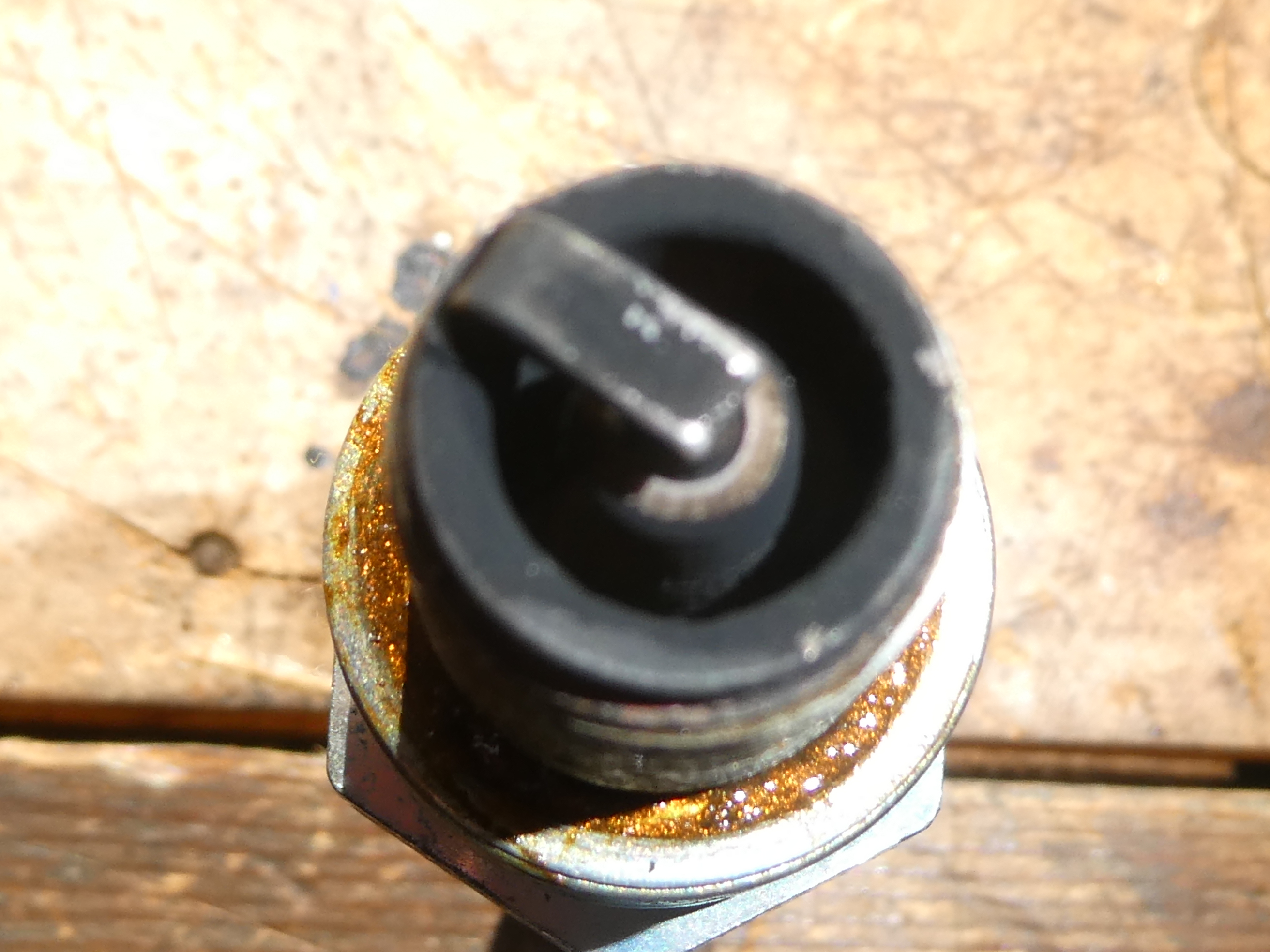

Did a plug check when I got home only to find No 3 black and sooty, see attached. All the rest had a brown core which I am happy with, but with No 3 sooty I'm back where I was a week ago, though at that time it was missing and backfiring on No 3, but I had not gone very far today so that may be the same outcome with more miles?
So I checked the wet float levels, No 1 and No 4 OK No 2 was now low but No 3 was now back at it's high level and so the most likely cause for the plug being black and sooty.
Well pissed off!
Raised the tang on No 3 so the valve barley moved, still high.
Swapped the floats and valves between No's 1 and 3, to see if it's the float yet No 3 remains high. Still got to sort out why No 2 is now low?
How on earth can they have all been OK with the carbs off, checked several times, for them to now move when fitted to the bike and after some use?
I'm at a total loss of what to do!
