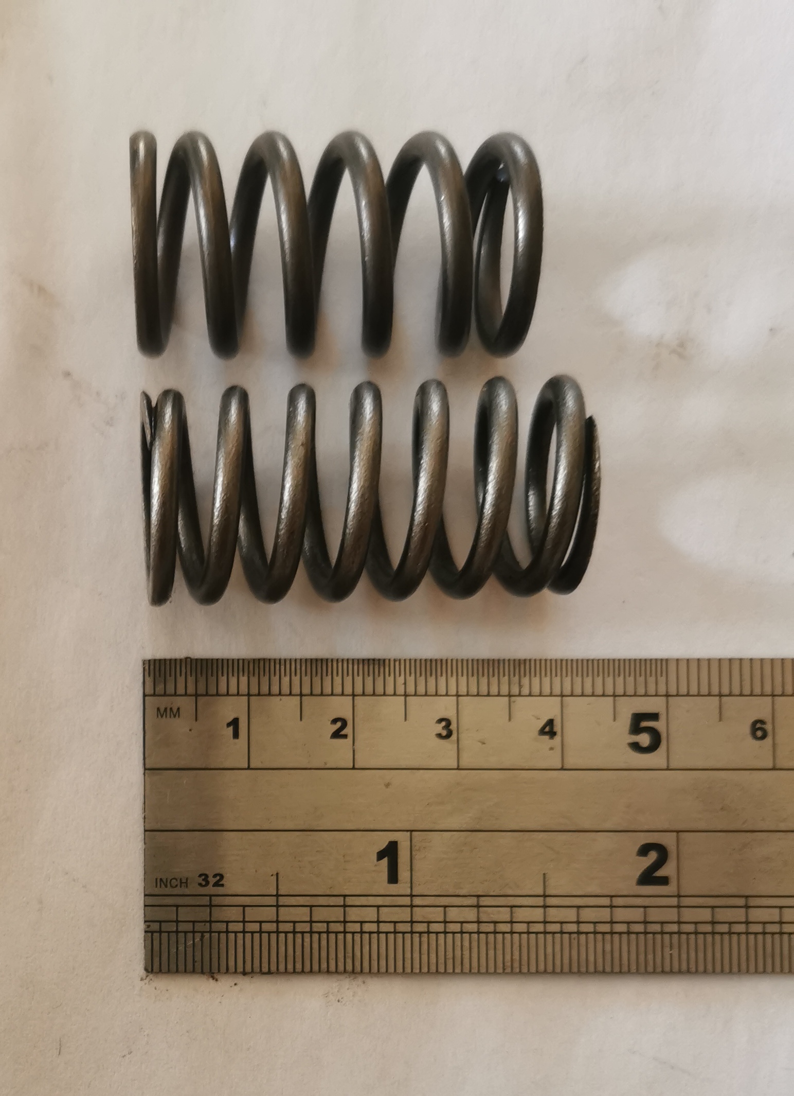

Update on this for anyone having similar issues?
Stripped the clutch to check the springs and friction plates. Not too bad at all but bought new EBC replacements anyway. Then found that the EBC springs were shorter than the ones I took out with a different number of coils - after putting everything back together (plates soaked overnight) and getting the engine oil up to temperature, the clutch is now spot on. Can only assume that wrong springs were fitted by the previous owner but well chuffed it's sorted!
