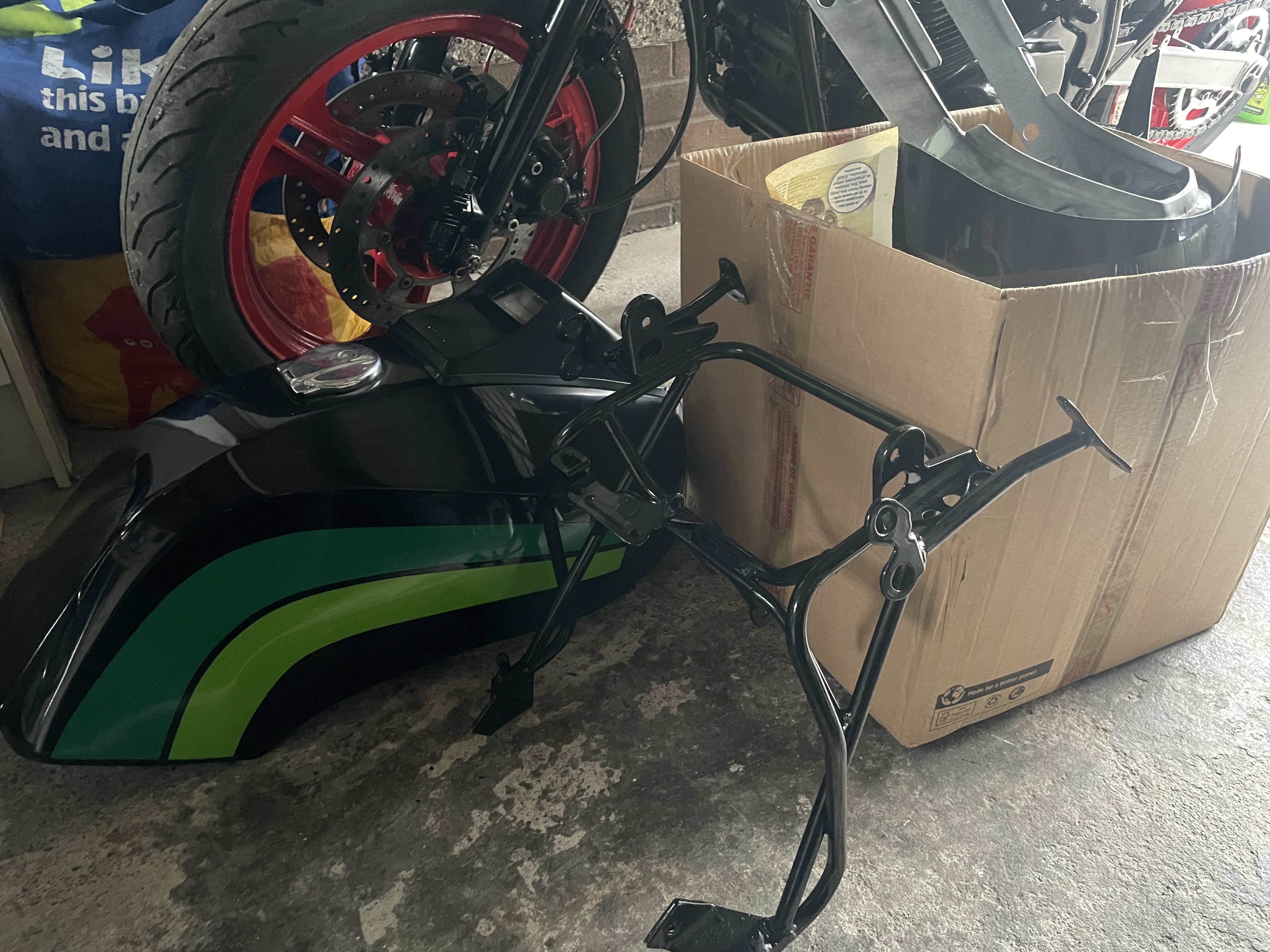

Bought this bike in October last year as a half finished project from a bloke that had got fed up with it. He had got as far as painting the frame and wheels. The rest of the bike was in boxes.
My intention was to get the bike running then return the paintwork to firecracker red. I pieced the bike together and got it running but it was a bit rough. It was leaking oil from the cylinder head gasket and blowing from exhaust number 2 so it was beginning to appear like a head off job :shock:
