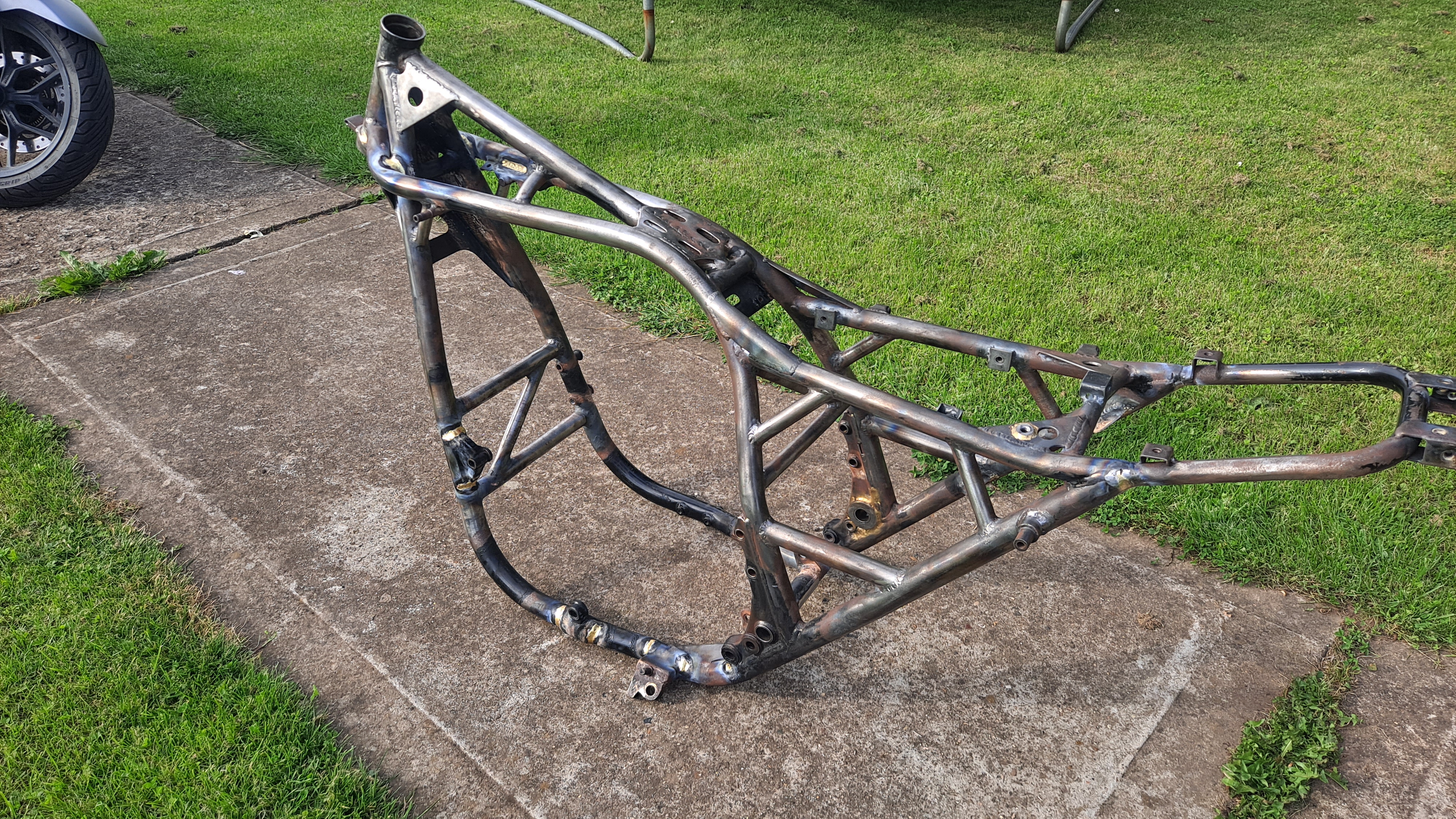

#168 PostAuthor: zed1015 » Tue Aug 15, 2023 6:18 pm
Racecrafters dry build is complete and i've now found a local custom trimmer who says they can re-upholster and cover the seat how i want once the pan is ready so went ahead and pulled it all apart on Sunday.
As well as getting the seat base fit for service i decided i may as well get the rest of the parts done too that needed it so took the wheels ,rear mudguard, clock mount and a few other odds and ends over to the powder coaters yesterday for a coat of satin black.
When i dropped them off i was told they are very busy and the job will take 10 to 14 days so not wanting a further delay i got up and out early this morning and pushed to finish the frame, sweating any rust traps with fillets of bronze and gave it a final going over ready for another trip to the coaters in the morning along with the side stand and rear motor mount to be done in Gloss black..

#169 PostAuthor: Z1streetfighter71 » Tue Aug 15, 2023 7:21 pm
That is one solid frame :twisted:
