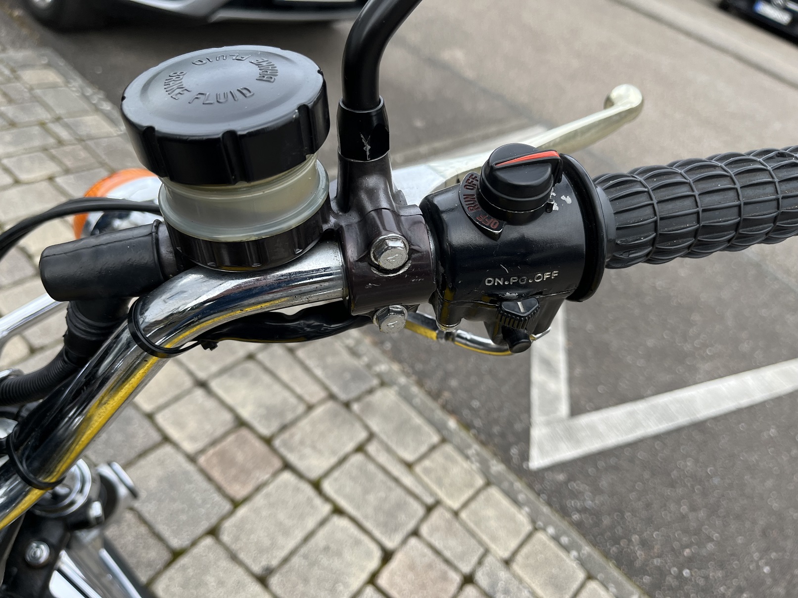

#13 PostAuthor: wilsonsjw11 » Mon Feb 26, 2024 8:41 am
The brake master cylinder could be from a later model, a close up photo would confirm.
Regards
Steve
Sgt.Pinback
Posts: 304
Joined: 16th Feb 2019
Location: Leonberg
Re: Z1 1973
#14 PostAuthor: Sgt.Pinback » Mon Feb 26, 2024 9:30 am
Close up
Cheers, Uli
wilsonsjw11
Posts: 1359
Joined: 18th Jul 2008
Location: Derbyshire/London
Re: Z1 1973
#15 PostAuthor: wilsonsjw11 » Mon Feb 26, 2024 9:47 am
Can you please take a pic from the front of the unit.
I'm just comparing it to Bedlow's in his photo.
Regards
Steve
