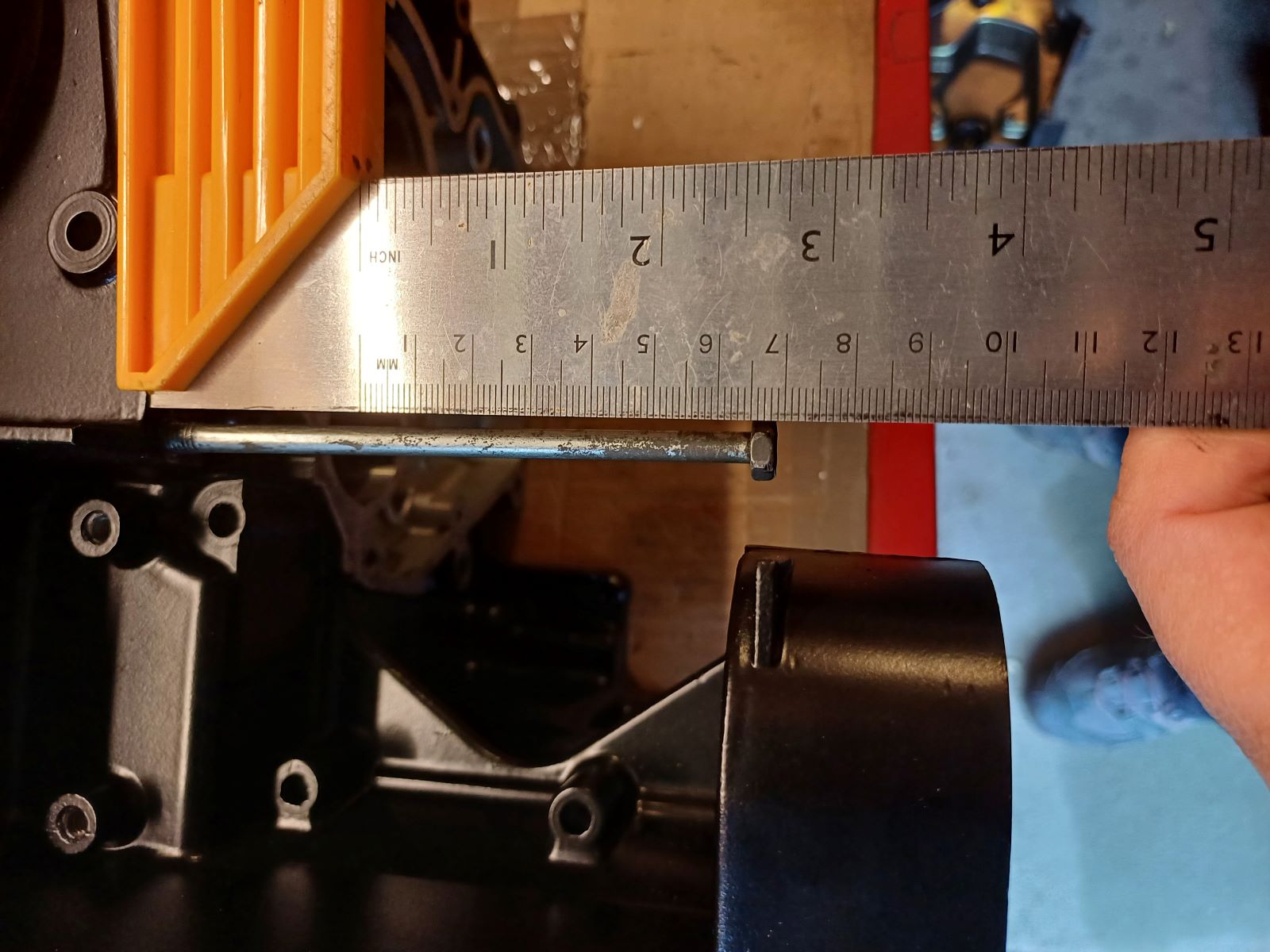

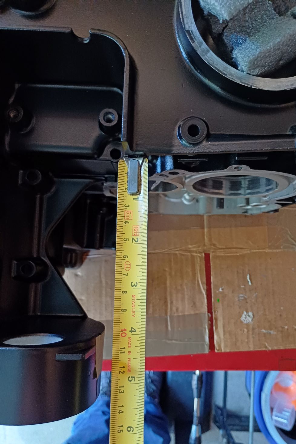

Working on the rear caliper and wheel spacings. Caliper spacing sorted, wheel centralisation still a few mm out, looks like I'll need to do some work on the sprocket carrier to get things lined up.

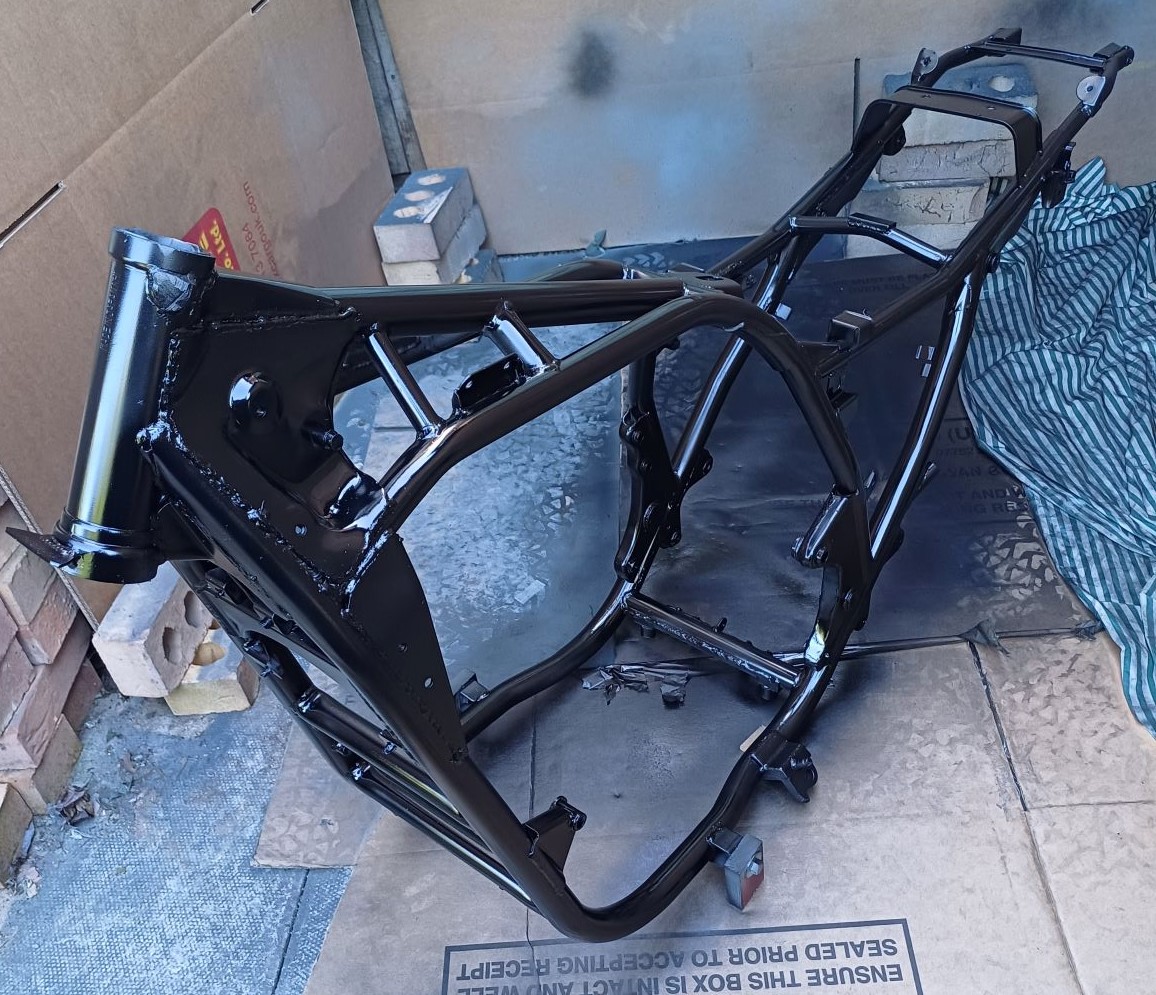

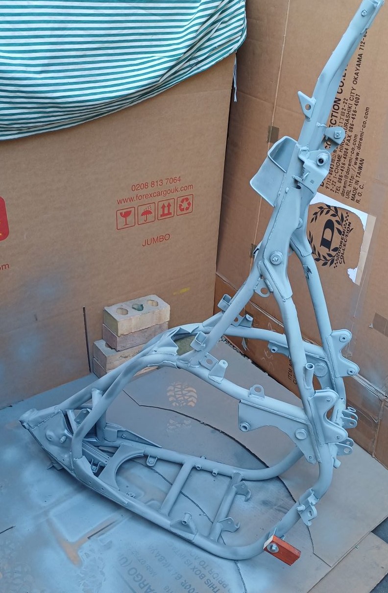

I took the frame to the paint strippers and was more than happy with their work. I've previously used blasting for the frame, but the chemical bath method seems to do a pretty good job, especially in the difficult to get to areas of the frame. I picked the frame up on Friday and with the weather looking set warm for Sunday & Monday decided this was the window of opportunity to get the painting done. Before starting I removed the old steering bearing outer races and installed new ones. I also cut back as much as possible of the inside of the footpeg mounting so that I increased the clearance between the wider swing arm & frame.
First painted with zinc primer, them acrylic black gloss and top coat clear gloss. The results are OK and I concentrated on getting the seen parts of the frame as good as possible since most of the frame is never seen.
Photos of the progress on the frame.
Before
After Stripping
After Zinc primer
Done!

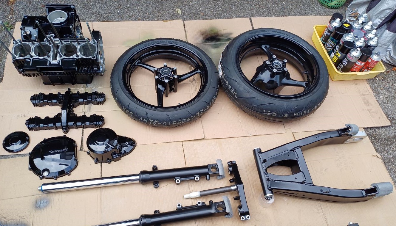

Finally the weather has been warm and dry for the past week or so. I've put in some effort to get all the main items of a black colour painted with a range of different products.
1. Wheels painted with Techniq speed gloss black and clear lacquer.
2. Swing arm, steering stem and forks painted with Hammerite satin black.
3. Outer engine cases painted with Simoniz tough gloss black.
4. Crankcase halves painted with Simoniz tough satin black.
The only problem paint was PJ1 fast black gloss, meant to be used for outer engine cases, however the paint only came out in large gooey lumps, so had to purchase the Simoniz tough gloss black and bin two new cans of PJ1.

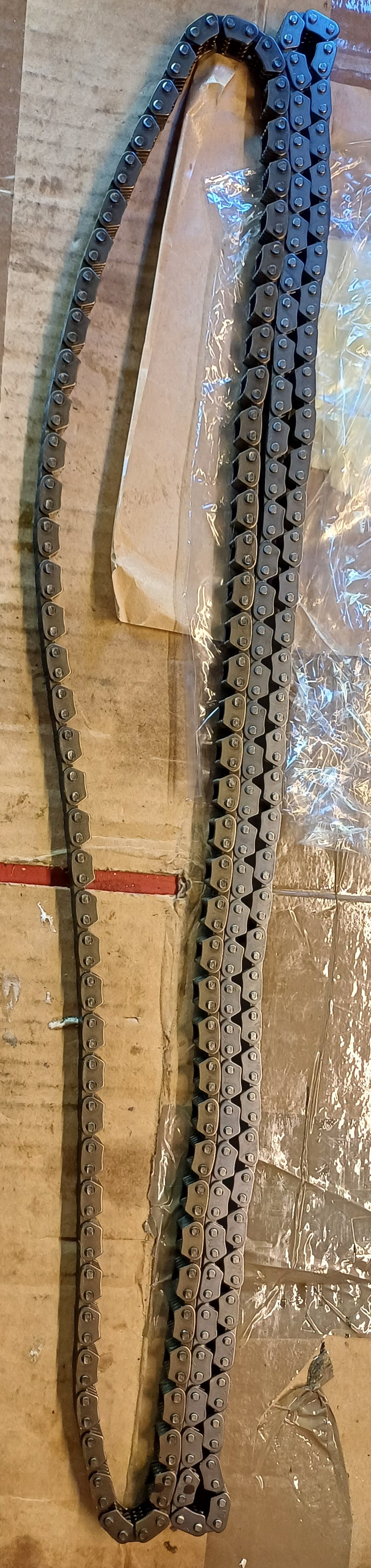

Replaced the cam chain, old one was quite stretched. Played around with gearbox selection, putting it in second then worked it up to 5th and then back down to 1st and ending in neutral. All seemed to be working as expected. After the gearbox check sealed the crankcases up and fitted the bottom end into the frame after fitting new engine rubber mounts.

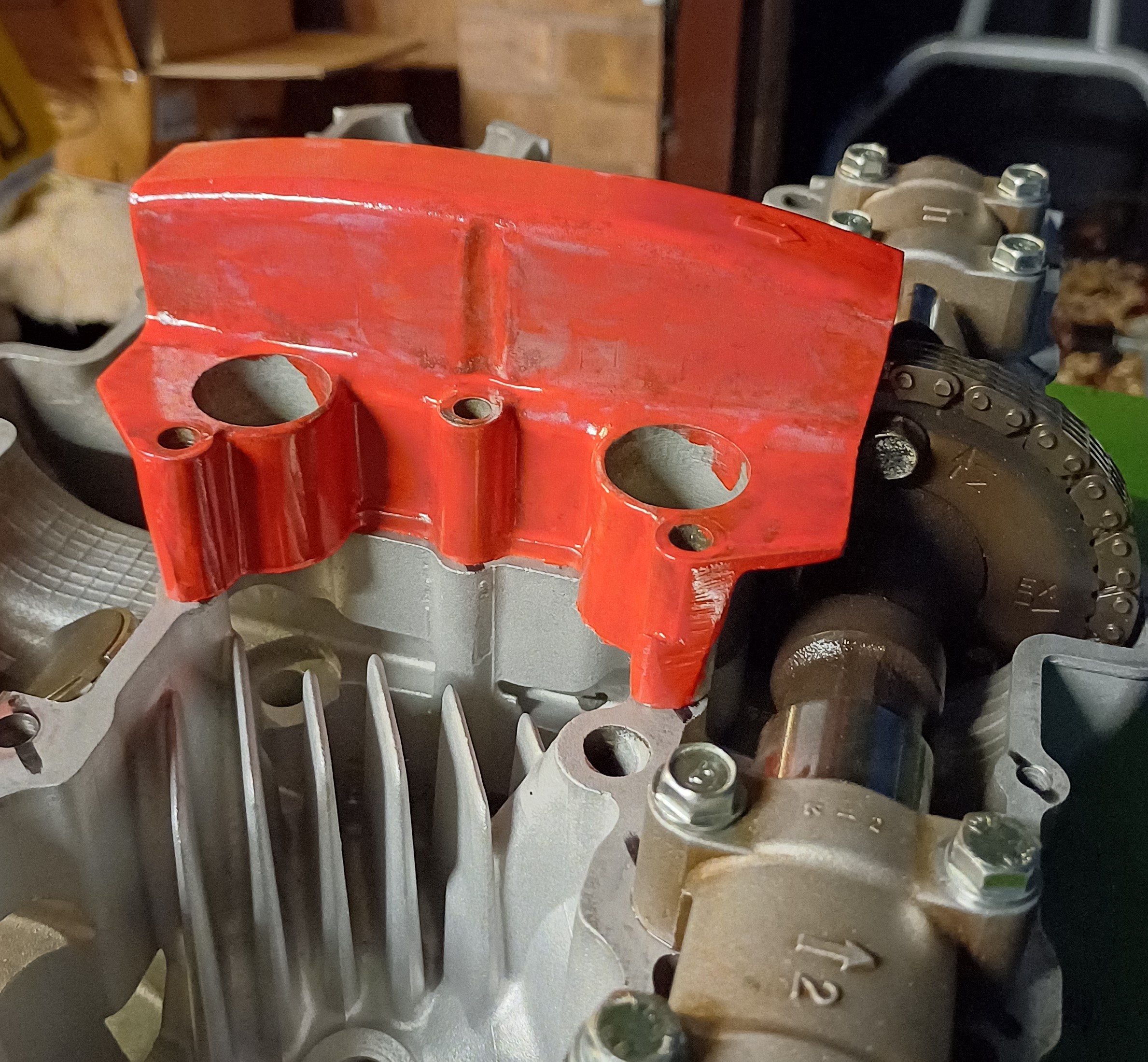

I've read so much on this forum about J engines and cam chain tensioners and jumping cam chains that I took the plunge and made my own cut out cover that should prevent these problems when checking valve clearances in the future. I'm sure some people will be unhappy that I have sacrificed a cam cover to do this, however it was from a US model with the air suction system so probably not really any value over here.

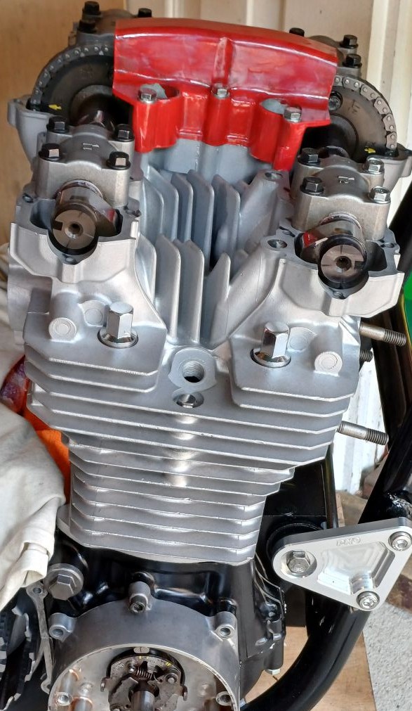

I have finally managed to get back in the garage and I've made some progress on the engine assembly over the past 4 weeks. I'm adding some pictures showing the progress. The only tricky part was getting the camshafts correctly positioned. The crank tended to want to rotate slightly as the cam chain was pulled tight to remove any slack. First attempt was 1 tooth out when cam timing set to the marks and crankshaft at TDC. Second attempt went smoothly and I followed all the valuable advice with regards to rotating engine and also putting cam cover back on. Whilst I was at it I replaced both springs in the cam chain tensioner since the price for original parts from Zpower was very reasonable.
