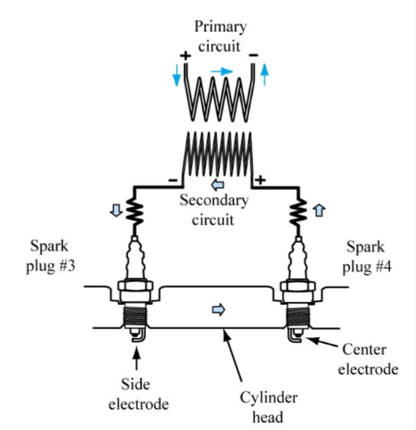

This explains it clearly Al. Follow the arrow directions although in our case it would be plug 1 & 4 and 2 & 3. I've had this conversation with Graham previously.
Re: Z900 A4 fuel leak any ideas please?
Thats a great drawing Warren and shows the circuit clearly the only thing is as both leads are unmarked and same length how do you know which is which, ie 1 will be the + side the other the - side, guess try both or flip the pickup. To answer Als question yes the strobe has a pickup.

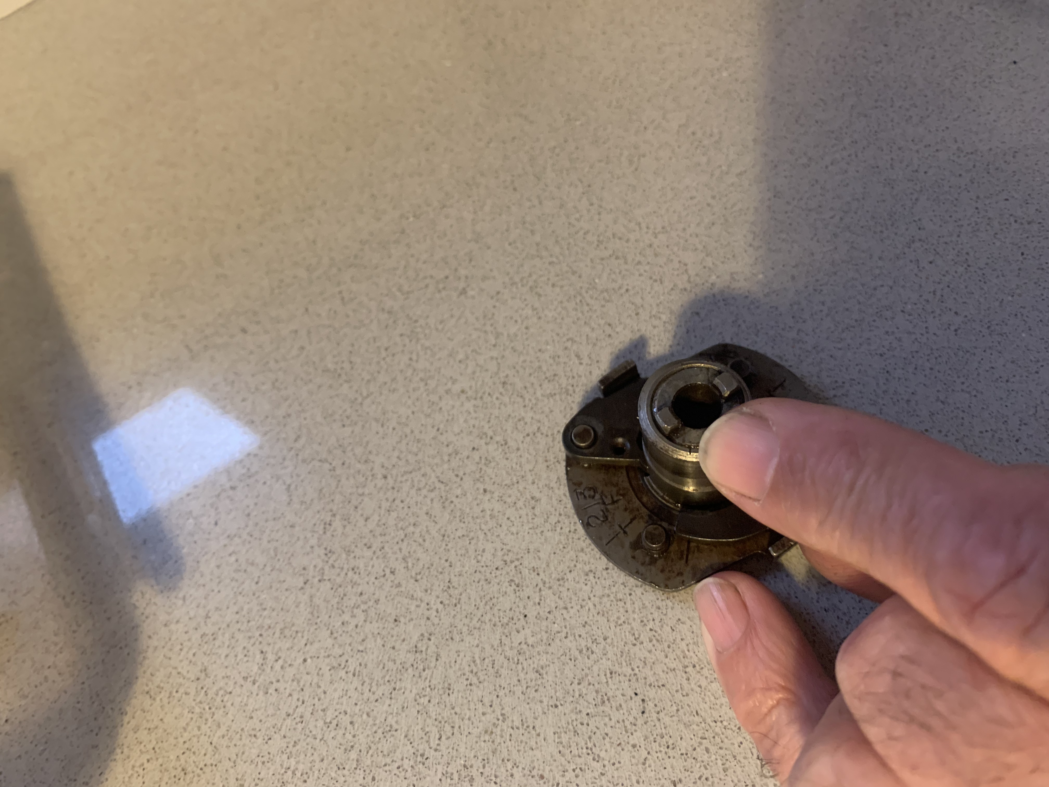

I've just has a thought. Looking back in this thread , you said you had stripped the auto advancer unit and reassembled it , but noted ' the cam could fit either way" ( page 9 of this thread)
I think it can make a difference, otherwise why would Kawasaki put marks on it to facilitate reassembly in the " correct " position?
As we were discussing optimising things, and getting small things right before embarking on the big costly things, might be worth checking that its not assembled 180 degrees out. ( tho superficially it would appear not to matter)
there is a score in the inner face of the cam ( my index finger) and a single line on the timing marks backplate ( my pinkie) that is separate from the pairs of the timing marks for the points.

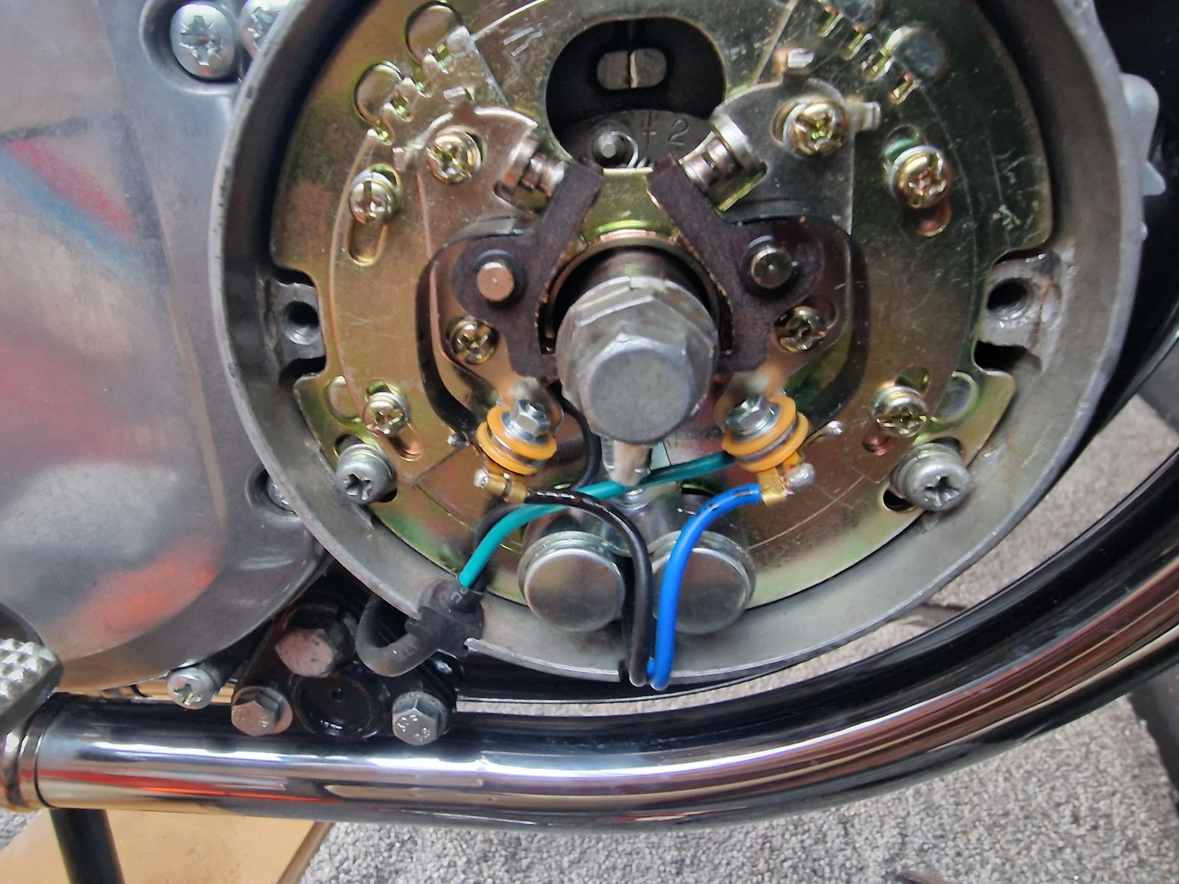

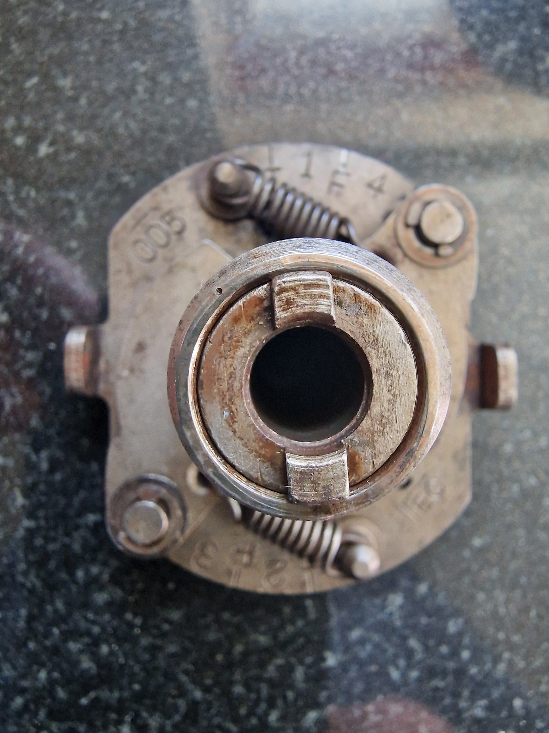

Hi Guys well removed timing cam plate as Gray suggested checked
For marks as per photo (Is this advancer the correct part for Z900 A4?), nothing on mine at all there is a dot but nothing to line it with on cam, the cam is free to fit in either position which is strange, however as i have no idea if any parts have been prev replaced no way to know (see photo), anyway re assembled back again, 1 thing i did notice the long shouldered bolt which holds the cam in place is very slightly out of true, checked it by spinning slowly in a drill, however when in place and tightened up doesnt allow any movement of the cam itself so may well be another red herring, also noticed new cam plate can move slightly on the 3 fixing screws not when tightened but you can move up and down 1/2 a mm or so on the screws, therefore may not be perfectly central?,clutching at straws really. My friend came down yesterday and told him still having probs, started bike up, he said straight away its running too rich you can smell it and its choking itself, mmm thats interesting as everyone seems to think its running weak, removed plugs yet again sure enough black and wet so def running rich, however it only wants to rev at low revs on choke, back choke off it refuses to rev which is the reverse of what you would expect.
Going to replace cam and re try to static time again. Didnt have much success yesterday at all.
UPDATE TODAY
Been at it all day trying to time up statically, tried it with a meter, a bulb and even a buzzer, it just point blank refuses to time. Its almost as though you can see the points open but the other points set seems to keep bulb or buzzer on, could it be the capacitors at fault?
I have made sure none of the wires are shorting to ground, theres def 12v on the points and the neg is connected to earth, if i flick the points you get a small spark and plugs spark what am i doing wrong?
Please help before i commit suicide!!!!
FURTHER UPDATE
Thanks to Warren managed to determine what i was doing wrong i was clamping bulb/buzzer to point where wires are attached to points , for some reason this was causing a short, Warren suggested clamping to the points spring metal which worked, however it still refuses to align with the marks at point of opening, its almost as though its too far retarded, no matter which way i move the plates with the slots fully forward or backward it still wont line up, even tried moving the backung plate on the 3 screws fully forward then backward but still not in line. The points gap has been set to 0.4mm on both sets. The bike will start and if i run it with the strobe it advances at 2k revs, however with it ticking over the alunement mark is passed the no.4 mark nearer to the advancer pivot then the correct mark between the 1 and 4.
I did notice when i stripped the advancer down it was sticking slightly socleaned everything and re lubed with bit of oil, all nice and smooth now, but still not lining up. This is the same with both the original points plate and the brand new Zpower one also. Hence why i asked is the photo of my advancer correct for my A4 model or has it been replaced with wrong part? Theres something def wrong, 1 suggestion was to elongate the plate holes longer but looking how far its out id need to file half the plate away. Also if i file or drill it on the wrong arc the points plate will move and not be central. Theres got to be something wrong somewhere, perhaps with my assembly or possibly wrong advancer assembly fitted at some point in its past?
Also if i start it up let it warm off choke then try revving and holding at 4k you can hear it missing every so often and you get smoke from exhausts but not black more like rich smoke. When i rode it there was no smoke behind or when on overun or changing down. Its already had new exhaust valves, guides and all new stem seals too
Suggestions welcome please as im running out of ideas.

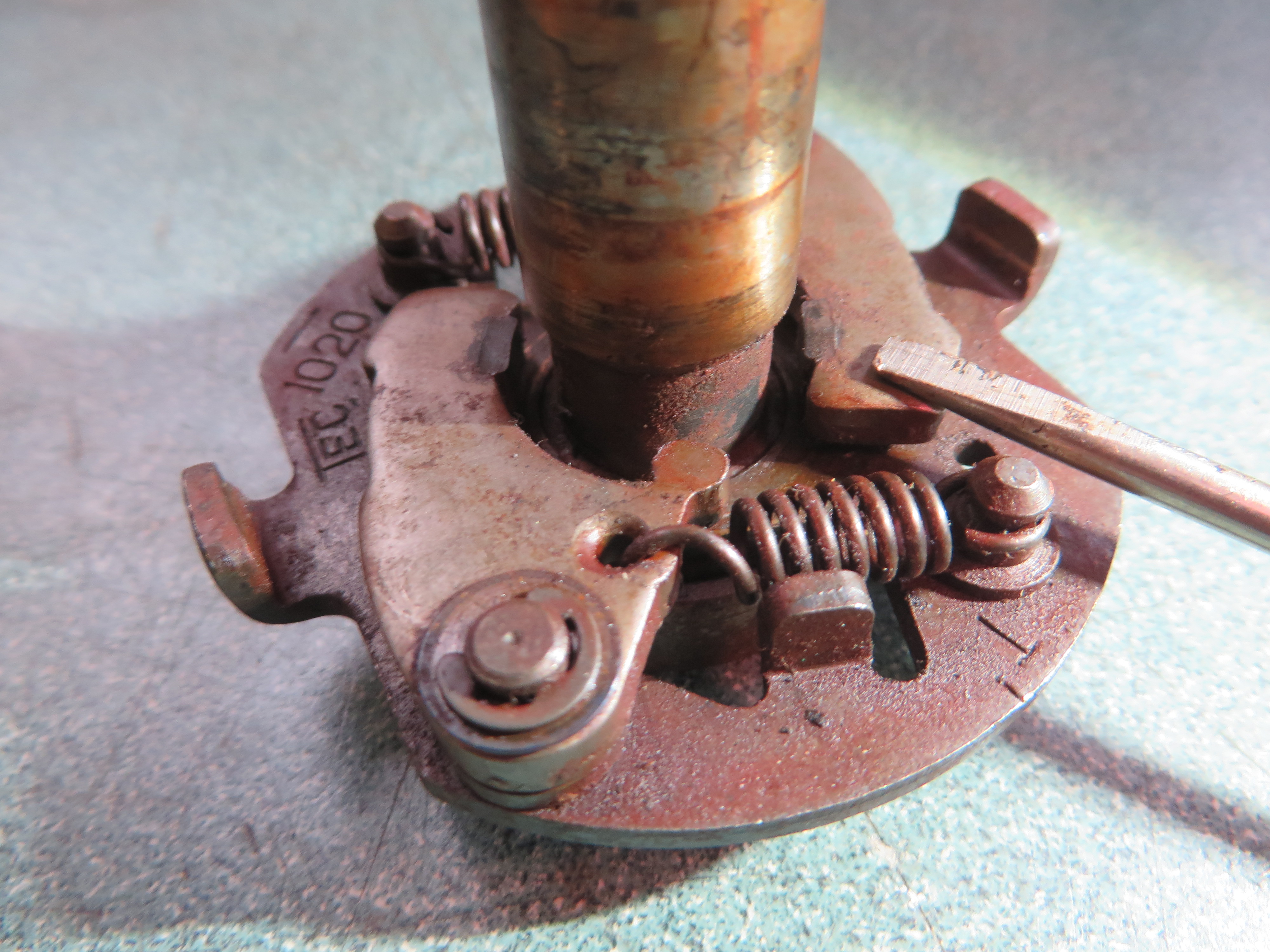

Do you have the two 'soft dampers' on the bob weights of the advance unit as shown below. They are prone to falling off and this makes the retarded position for static timing incorrect!
When you run it and view from the side is the bolt or more particularly the cam, spinning eccentrically? A felt tip dot on the end of the bolt may help to see if it is.
Does it have the standard solid / hardened peg in the end of the crank that drives the advance unit? If not has it been replaced with something else?

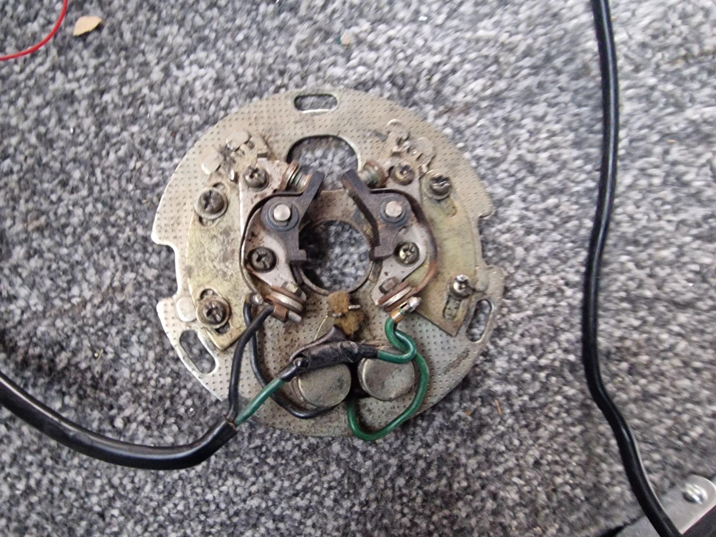

Just forgetting the timing issue for a moment, check on the new points plate and check that the very small nuts holding the wires to the points are tight. I brought one of those zpower plates and the nut on the right was loose causing dodgy running.
Once tightened all was well but in fact, in my case a condenser soon failed as well and I had to swap them for the ones on my original plate - has run perfect since then.

Thanks thats a valid point, but not in my case they were both tight, wish it had been that would have been an easy fix!
