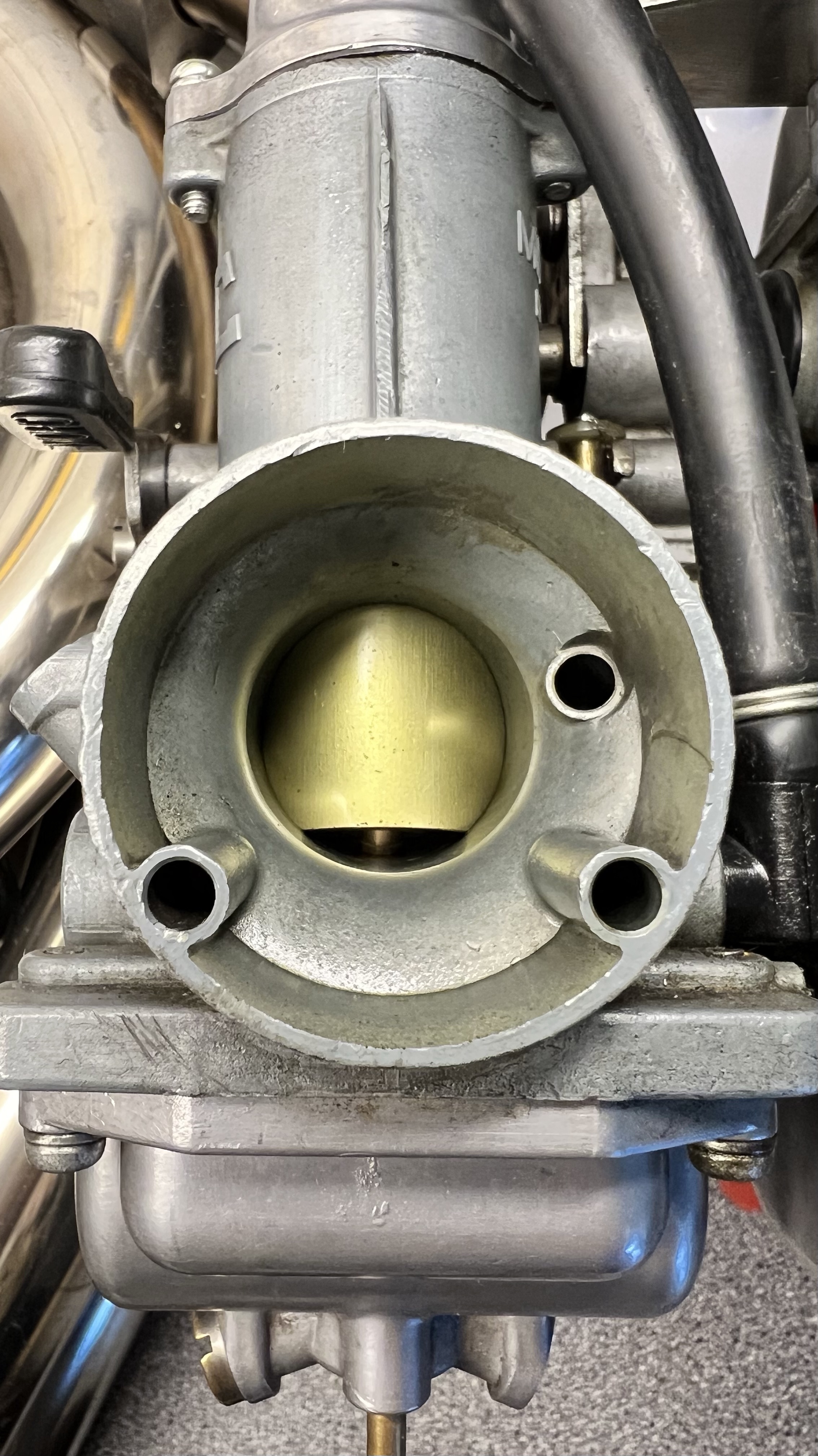

The carbs had to come off again anyways, as I have new carb to head rubbers coming and I also need to set the float levels to get the correct fuel levels.
Just popped out to snap a picture, and doesn’t look like anything brass fitted to any of the apertures air box side.
There's no air correctors fitted in those carbs and there never has been.

Hello mate;
As zed1015 says, no air correctors. For ref, mine's a Z1R so 1015cc, Delkevic 4-1 and K&Ns (so not a million miles from yours), and had correctors fitted since forever with various different 4-1 exhausts with good results. If you can get hold of some (there seem to be options in the usual places but can't vouch for quality - mine are the original Ledar supplied ones) then it might be worth a go. They won't break the bank and are easy enough to install as I recall.

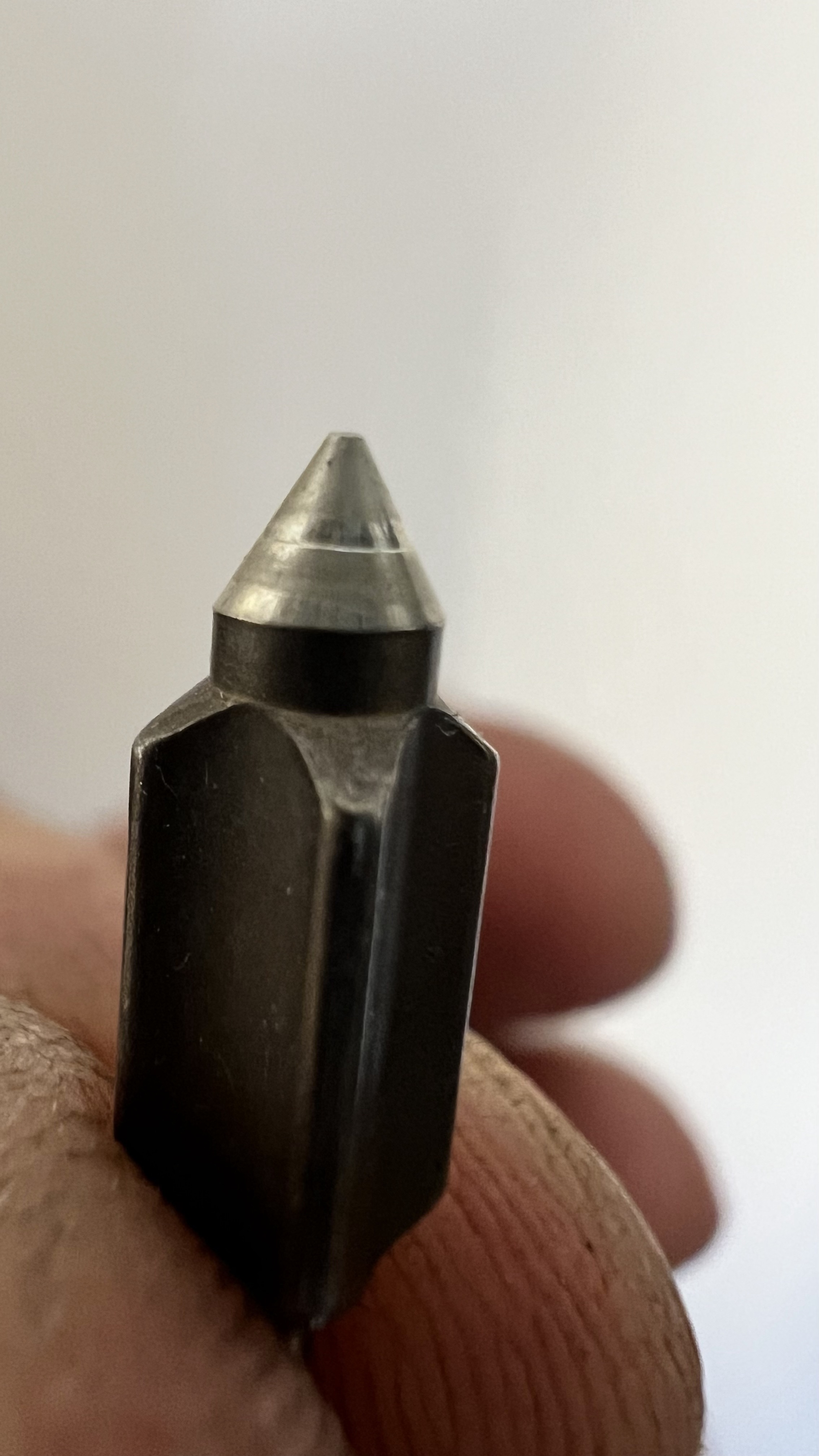

After 2 1/2 unsuccessful hours, and no small amount of cussing, I’ve abandoned trying to set the fuel levels.
The first one was fine but the second one wouldn’t play nice and on closer inspection it looks like the needle is toast. No sense in wasting more time on it till this is sorted I guess.

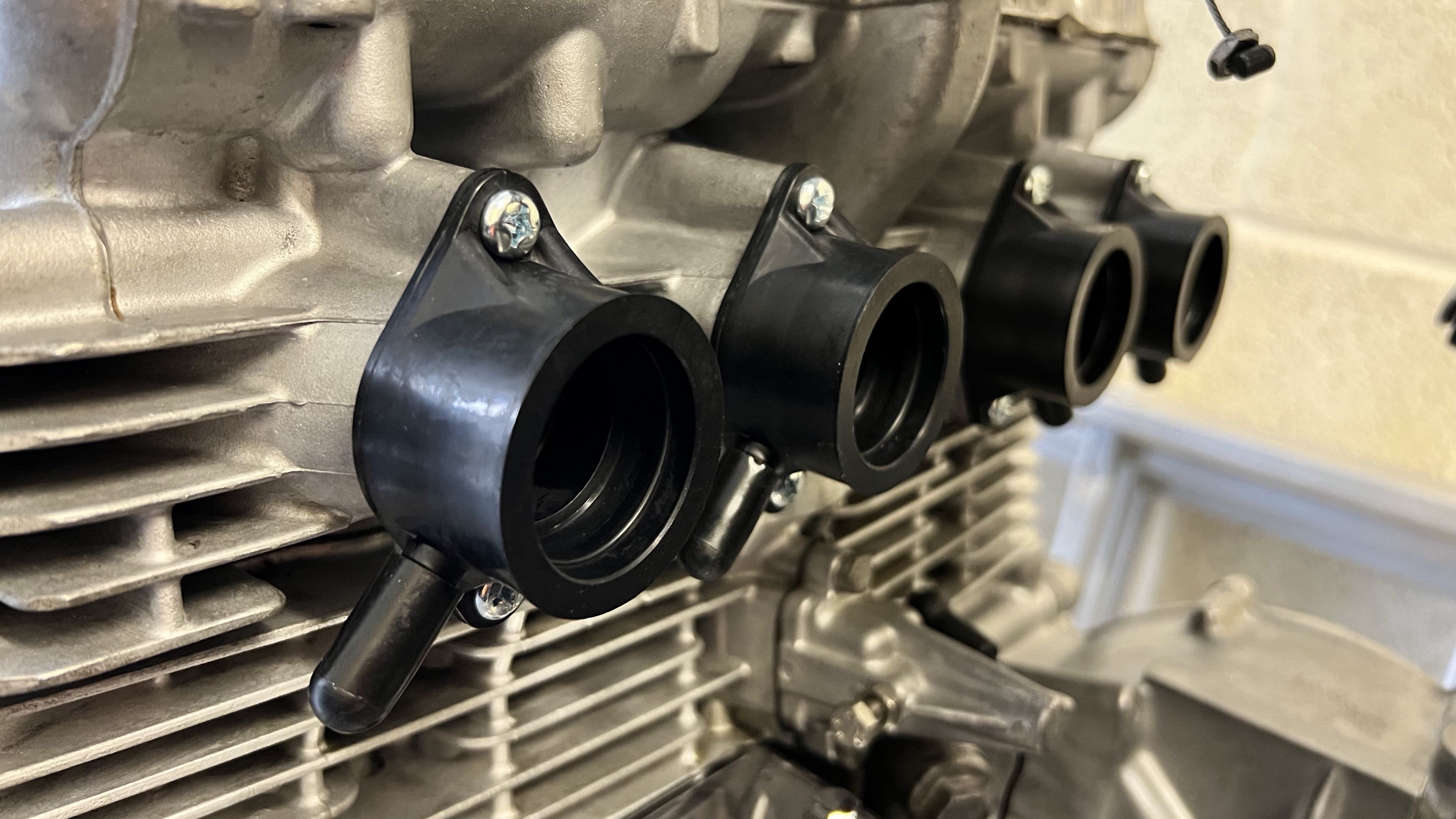

Todays progress:
New carb to head rubbers fitted. The ones that were on the bike were rock hard and by the looks of it, not making a particularly satisfactory seal against the head. The offtake blanks were also hard and cracked, so definitely needed replacing.
I’m hoping it won’t mean an engine strip. Too early to panic yet anyways. From what I’ve seen so far the bike was long overdue some attention anyways.
On the plus side, the compression readings all look really good.
I’ll continue to report progress as I work through the issues if it helps others.
Todays progress:

The new carb rubbers look good, ot was one of the things i was advised to check too, mine were fairly supple so didnt replace them, but did remove them and use the silver bond on the surface to head to ensure an airtight seal just in case. However like yours my take off rubbers were perished, not even sure they were the correct ones, but these have now been replaced so thats another box ticked.
