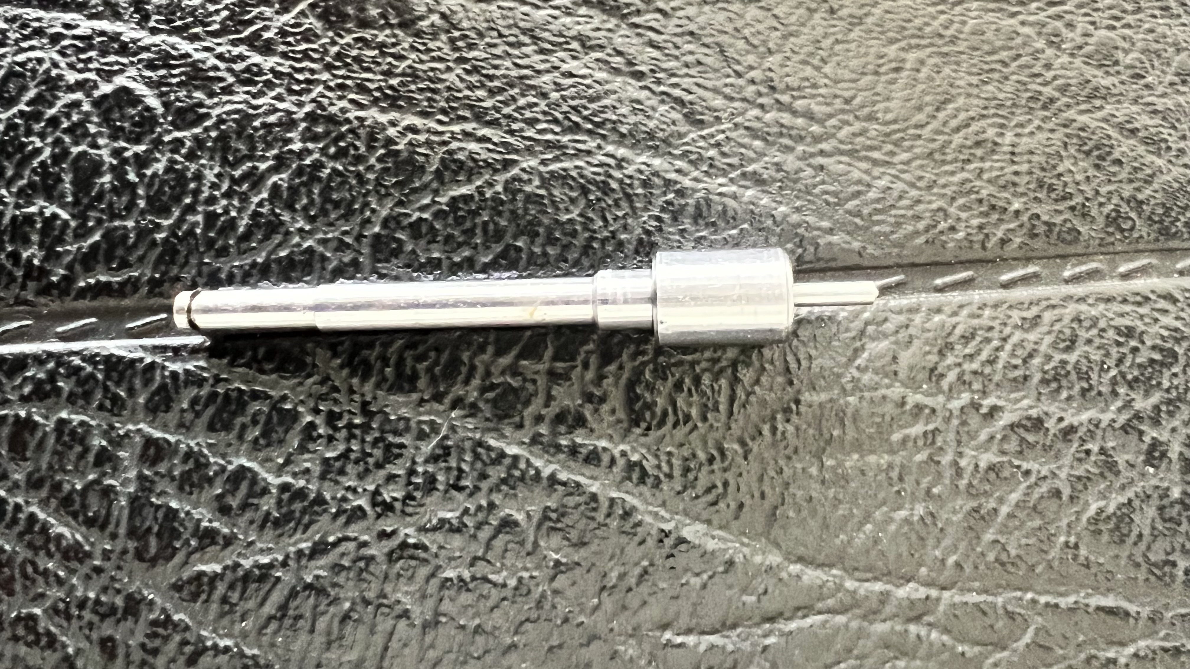

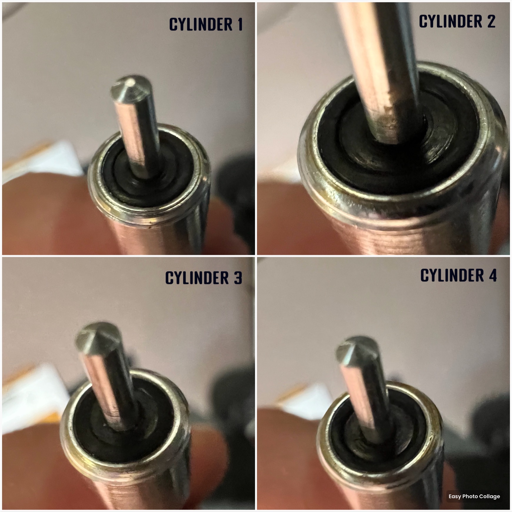

The choke plungers went off to Rob for new viton seals. I don’t know how bad these look (4 picture cluster) to those with more experience. At least they have now been ruled out, both now and for some time to come. As you can see they came back from Rob looking all shiny and new.
For the sake of folks following this thread I’ll post what I find, along with my dim questions !
A brief recap.

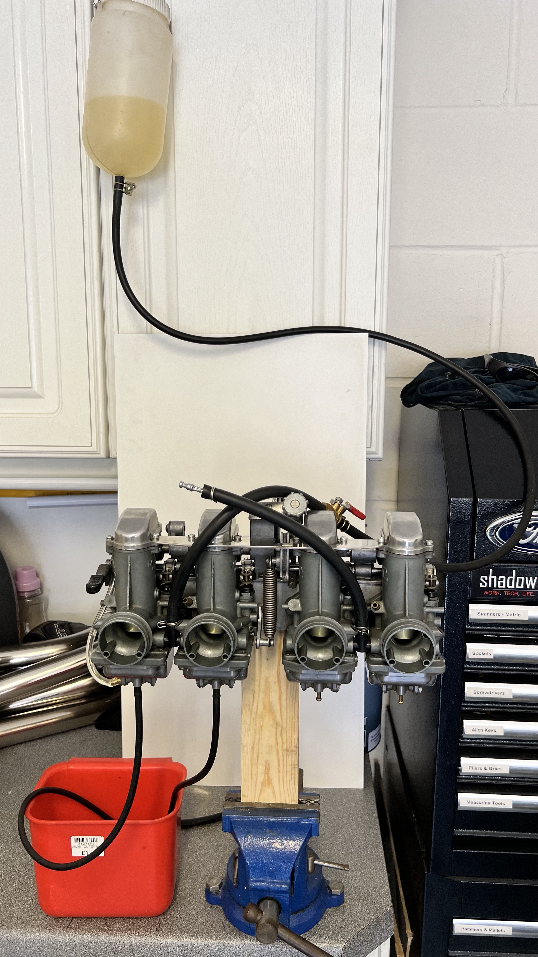

I didn’t get the chance to actually attempt to set the fuel levels, but I did manage to get myself all set up ready with the carbs bolted to a spare piece of lumber and clamped upright in the vice, and being fed from an auxiliary tank as you’d expect.

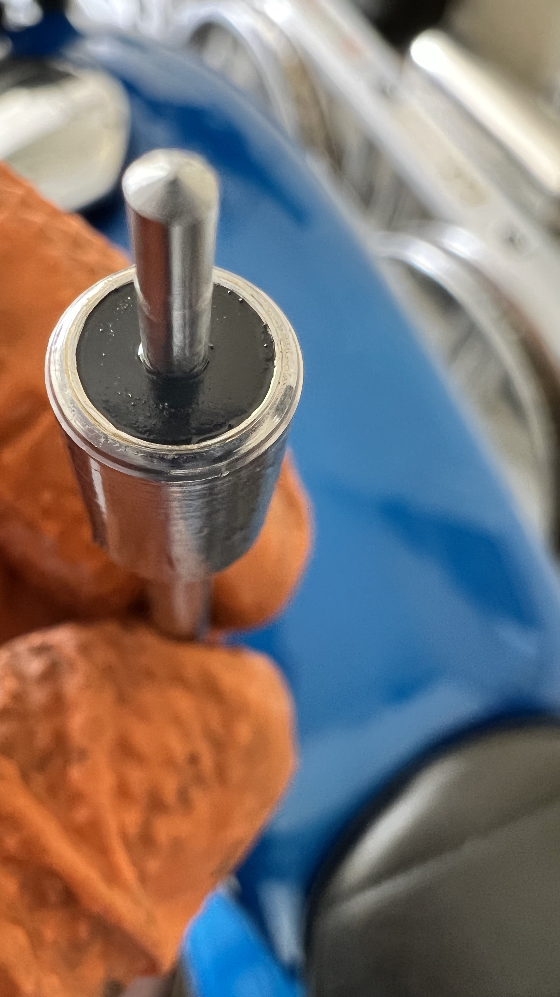

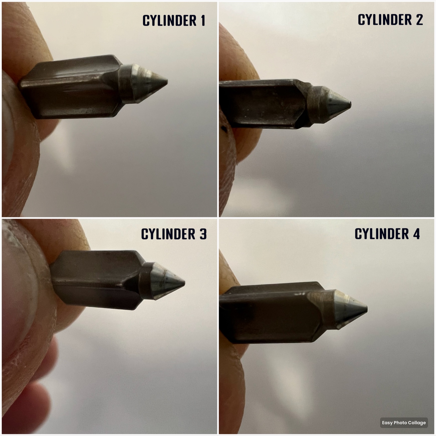

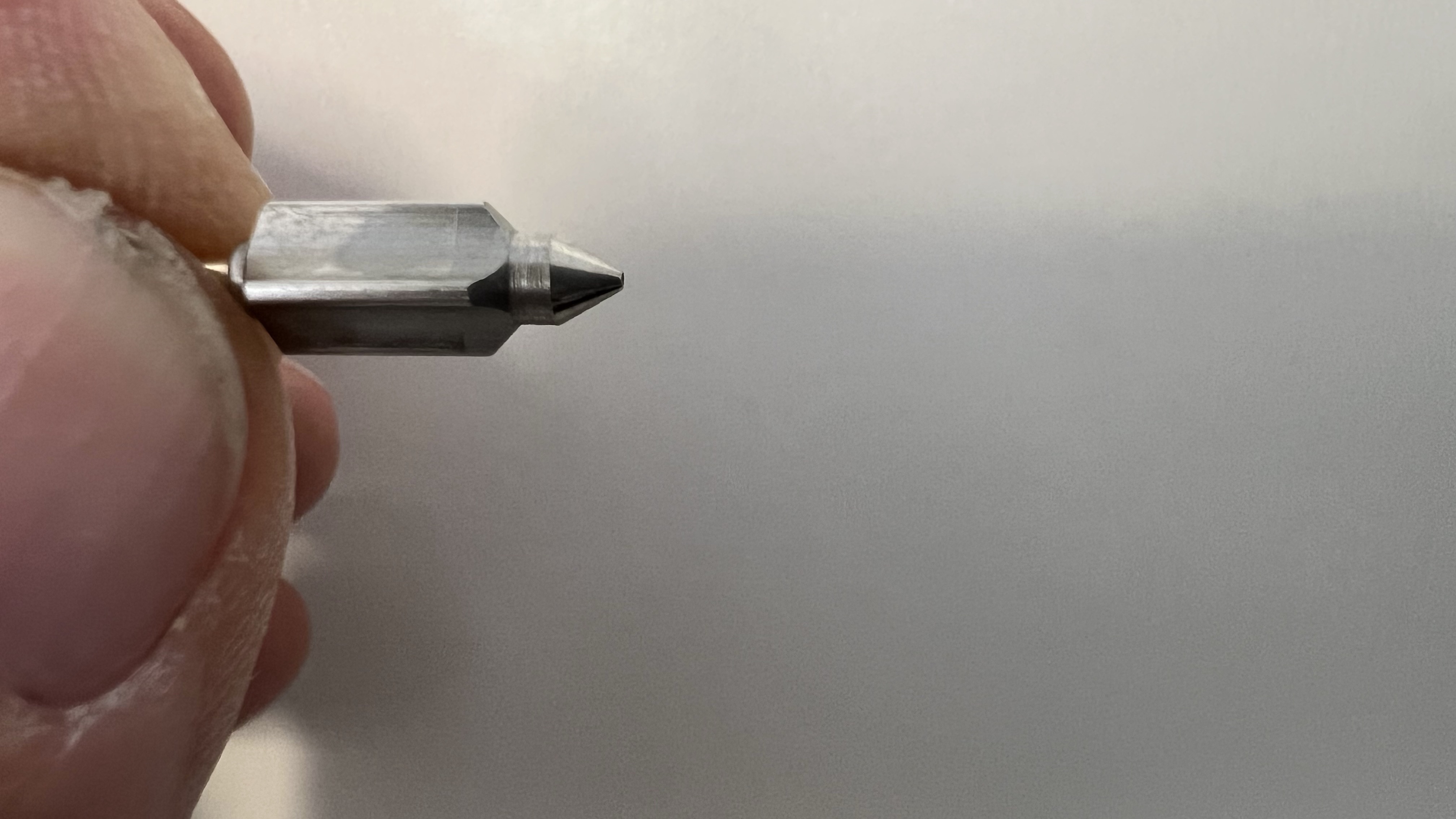

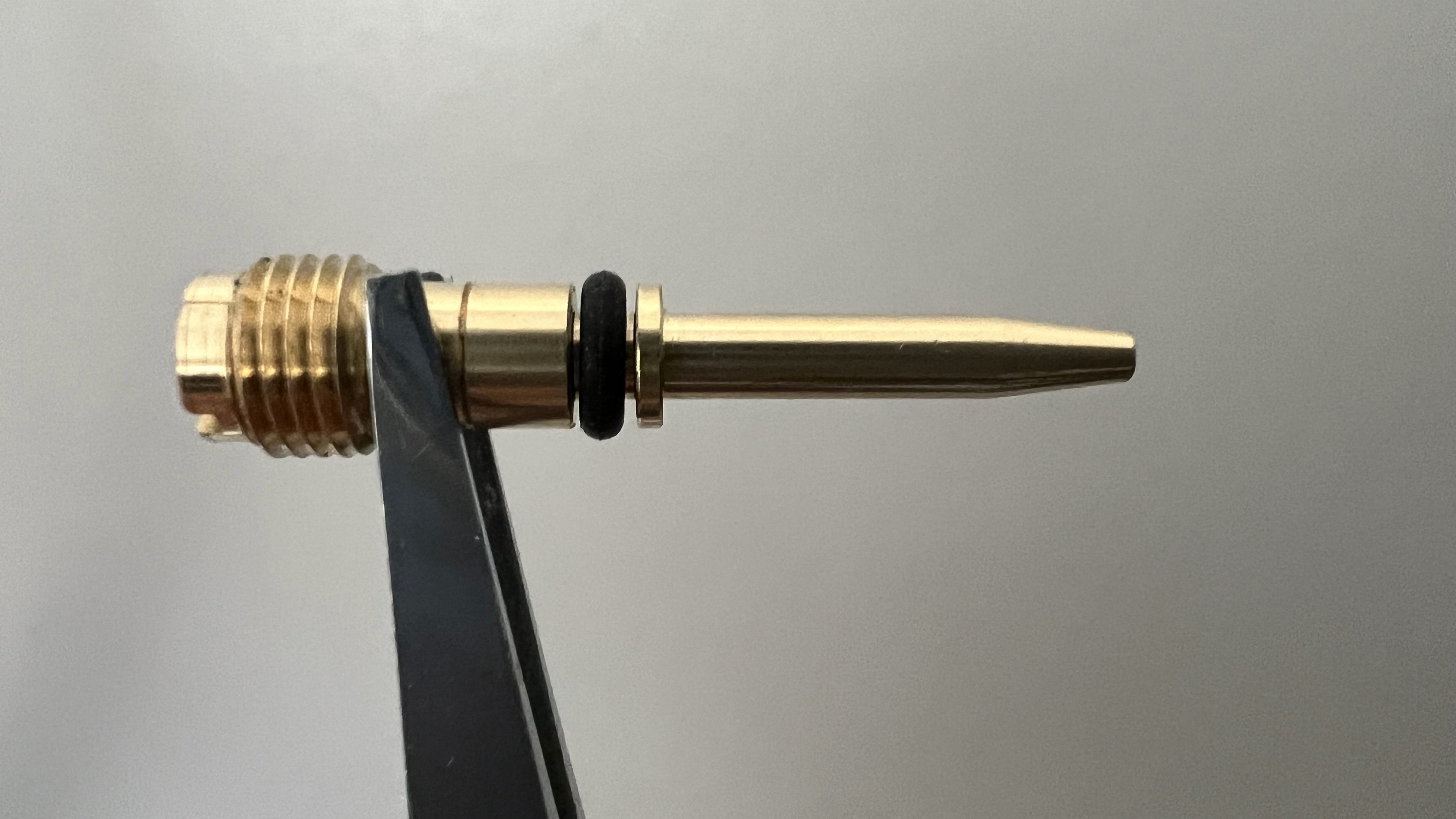

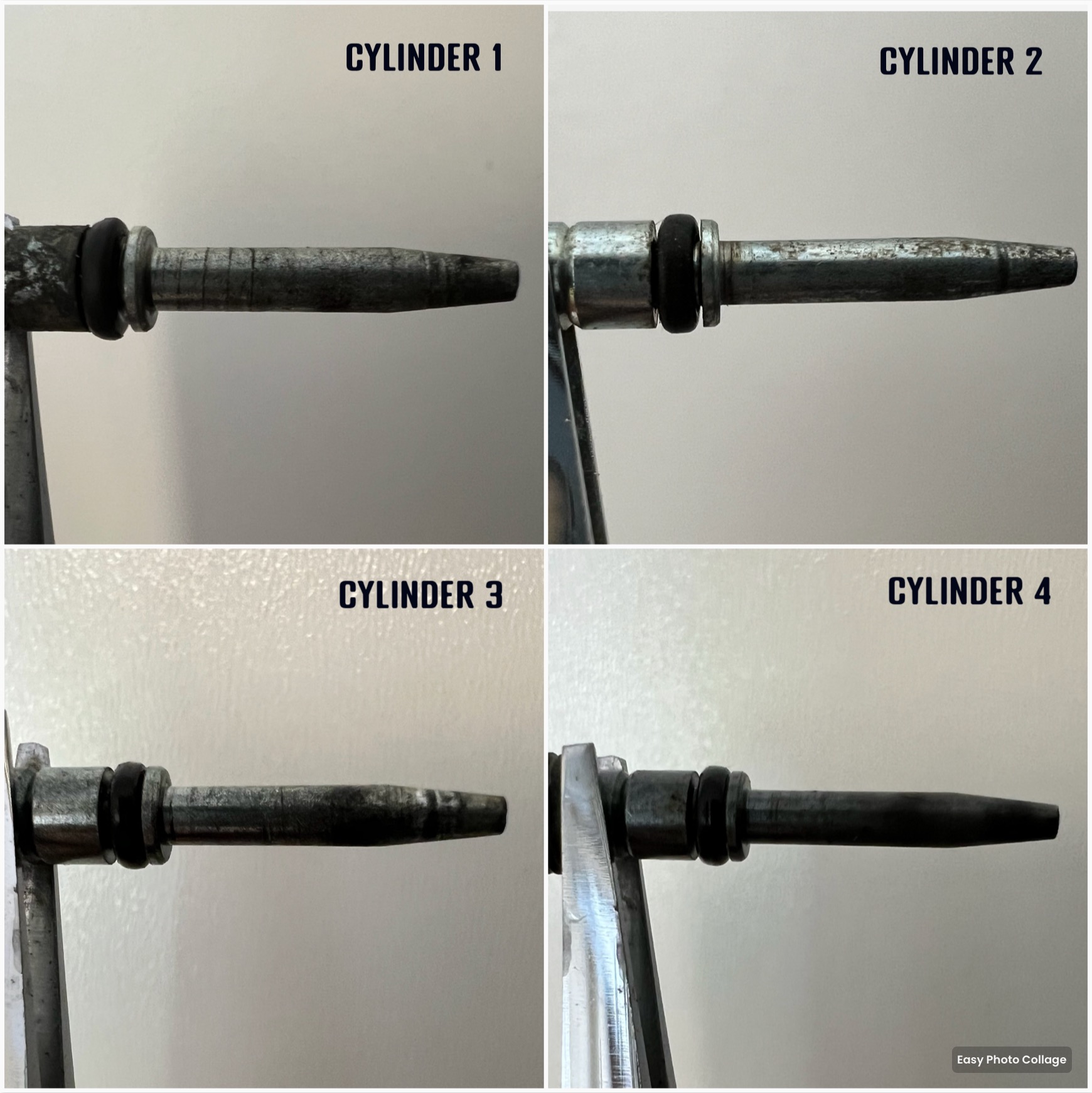

I am planning to only use the Air Screws (with new O rings and springs) and the fuel inlet needles and seats from the carb kits. I’m interested what people think about potentially using the other bits (main and pilot jets in particular) from the kits versus retaining the original ones ?
Anyways, I changed out all of the Air screws and needles and seats in readiness for the fuel level work to start tomorrow. Got to say, the Air Screws (4 picture clusters) in particular looked pretty ropey compared to the new ones from the carb kit pictured below. The Air Screws seals are shot, they are worn away and / or compressed to a flat profile instead of round profile so probably not making a great seal. Also the needle areas of both the air screws and fuel inlet needles are pretty bad.

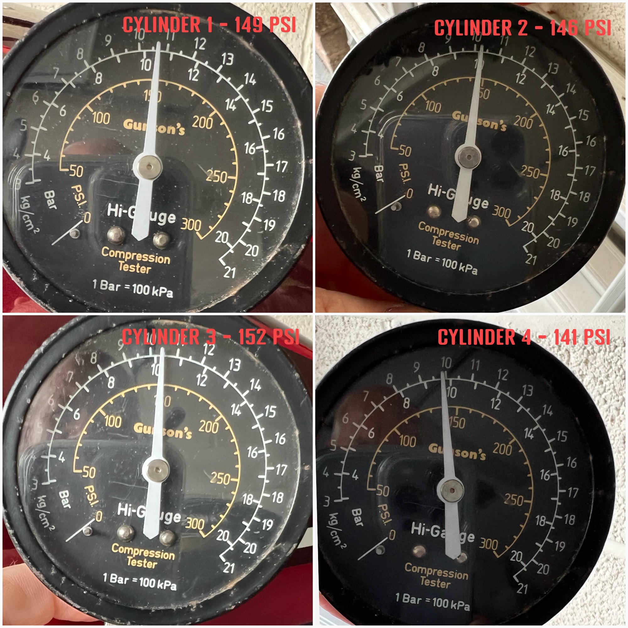

For completeness, these were the compression readings I got with a cold engine, full open throttle and about 6 kicks on the kickstarter
Re: KZ900 carb help
1975-S1C wrote:For completeness, these were the compression readings I got with a cold engine, full open throttle and about 6 kicks on the kickstarter
Plenty good enough and the variations between cylinders are all within limits.

Ok chaps, a little more help please.
Tried setting the fuel levels this afternoon. After 2 hours of fiddling about I’ve got precisely nowhere !
At first I tried just bending the tang a tiny amount at a time, without any real science behind it. That was so hit and miss that it was driving me bonkers. Too much, then too little. Aaaaaargh
I then decided to gradually move the tang using my feeler gauges so that they just went under the tang, and used them to open the gap a measurable amount at a time. This proved to be better, but still the damn thing refuses to play ball.
How long should it take for the correct level to be reached ?
I was expecting a bit like a toilet cistern after it’s flushed, I.e. it fills quickly then shuts off fairly quickly at the correct level.
If I set the tang so that it shuts off abruptly it gets nowhere near the correct level (way too low). However the difference between that and it overfilling is tiny, albeit that it takes several minutes to gradually creep up to being overfilled.
I thought with new fuel inlet valves and seats that this would be a fairly easy task, albeit a bit iterative., but it has proved rather frustrating so far.

How high have you mounted your auxiliary fuel tank? Too much head could give you odd readings.
Re: KZ900 carb help
r3sc wrote:How high have you mounted your auxiliary fuel tank? Too much head could give you odd readings.
Hi r3sc. There’s a picture a few posts back. Does that look ok ?

I always try to mount it so that it’s approximately the same height as the tank would be in normal use. When balancing I hang the tank on the bar end or mirror.
Re: KZ900 carb help
r3sc wrote:I always try to mount it so that it’s approximately the same height as the tank would be in normal use. When balancing I hang the tank on the bar end or mirror.
Totally agree, if it's too high can cause the float valve not to close, and you get overflow
Re: KZ900 carb help
I hadn’t even considered the height of the auxiliary tank, but in reality it’s actually about 5 or 6 times higher than the tank would be in normal use.
I will rectify this tomorrow and give it another go.
