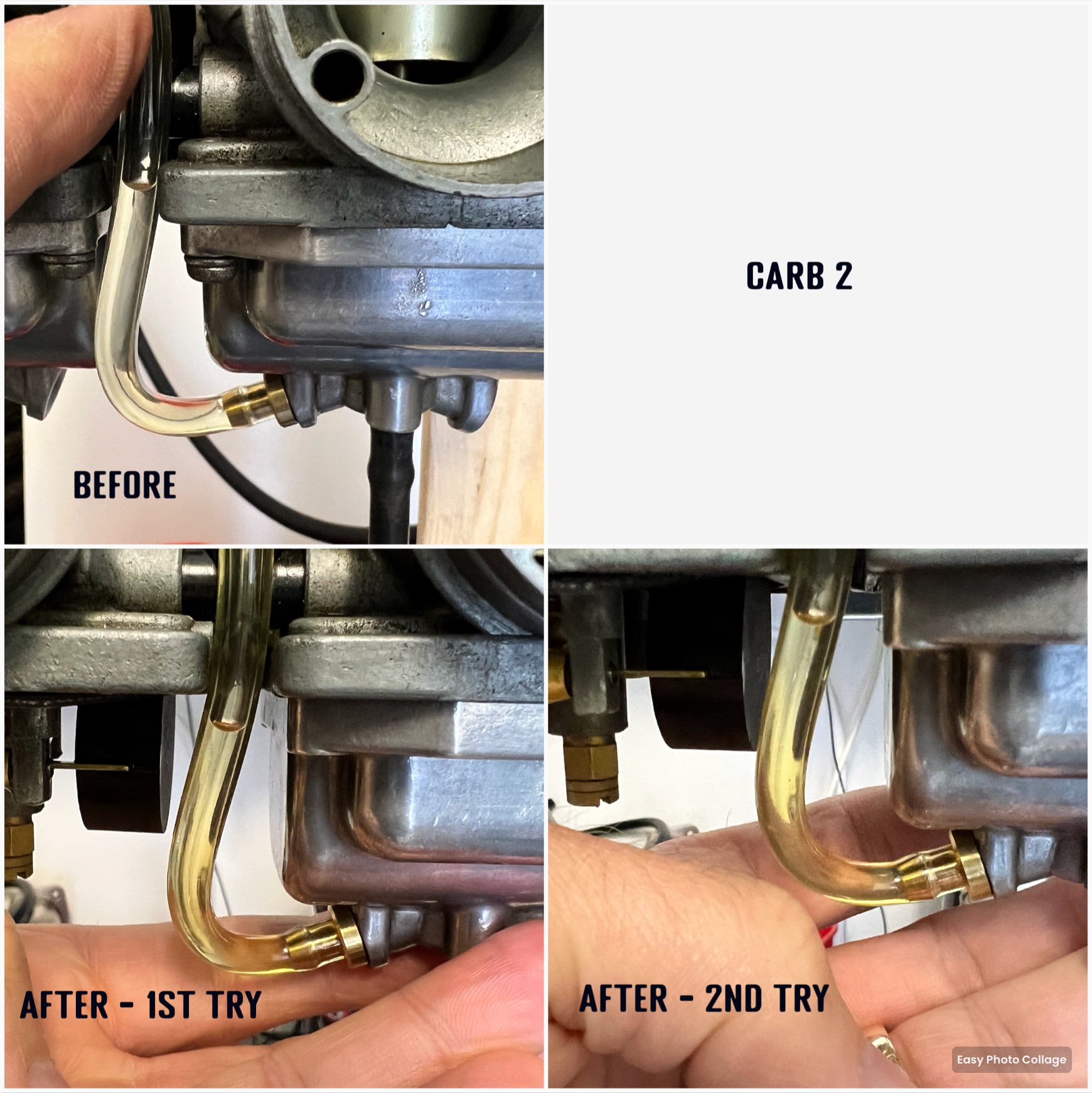

Re: KZ900 carb help
Carb 2 done.
Perhaps a little higher than the level I was shooting for, but after the amount of faffing involved to get it like this I’m gonna call that for the win !
Just the other two carbs to do, possibly this evening as Summer seems to have come to an end (not that it ever really got started anyway).
Re: KZ900 carb help
I see you have a lot on your plate but if you happen to have a measuring stick in your hand as you move through the bank of four i would be very curious to know what the float level of one of the 'set' floats is. Its just curiosity for me but this comes up a lot here and never an answer as to how near the mythical '26mm float height',... a perfectly adjusted one is. I am sure there would be plenty who want / need to know for their A4's and for the range of VM carbs generally.
Re: KZ900 carb help
Good point Al.
I will put my vernier on the 3rd and 4th carbs and see what they measure. Was hoping to have done these this afternoon but didn’t get chance. Will have a little look later on.

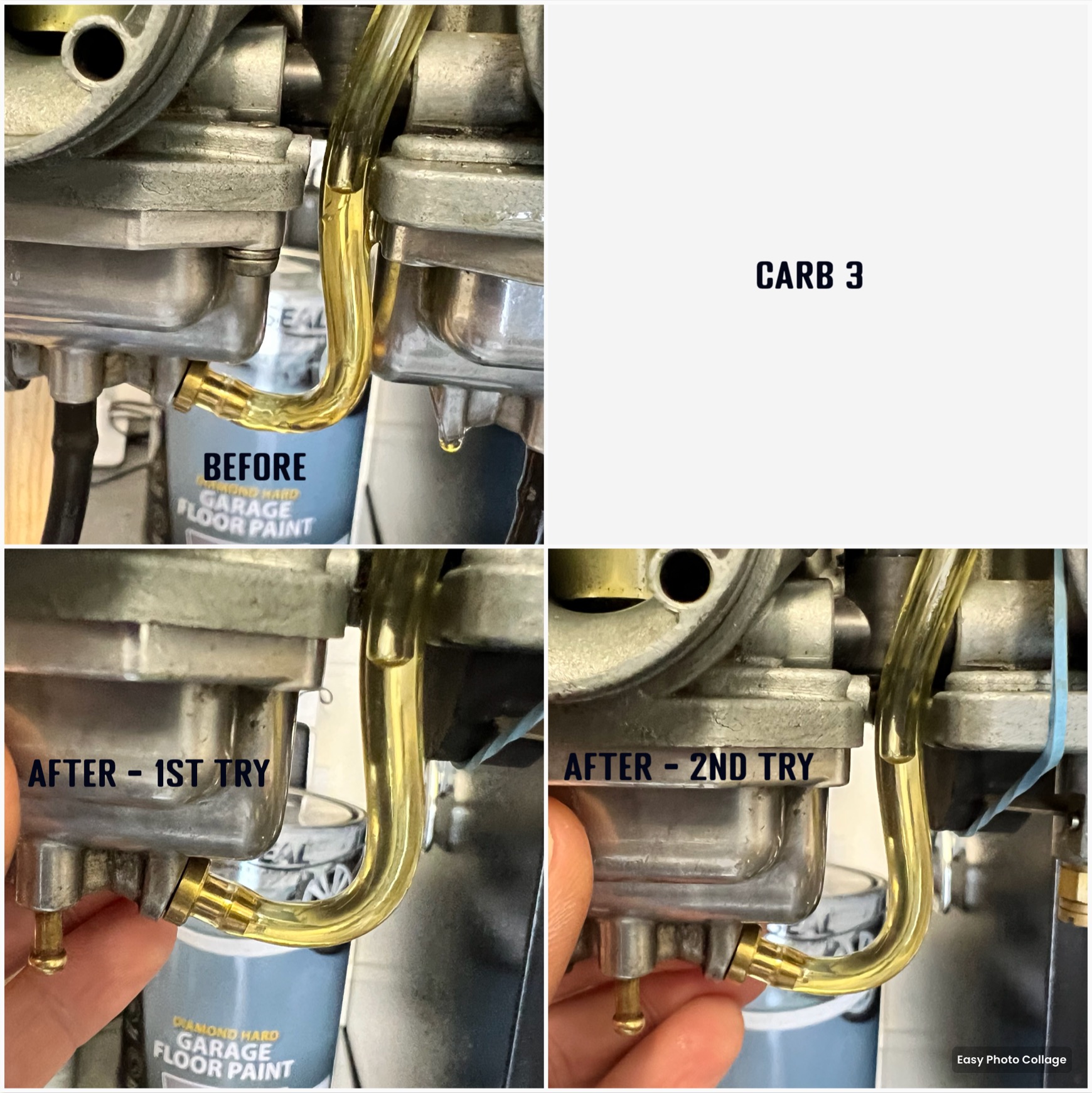

Re: KZ900 carb help
These levels look a bit more like it.
I dare say number 3 could benefit from being just a smidge lower, but I think we are pretty much there.
I didn’t open up 1 and 2 again to measure the actual float heights, but on 3 and 4 they were both at 28mm.

Re: KZ900 carb help
You can bench sync two ways, the regular is using a drill bit in the carb throats making sure they are all the same height, I take the tops off the carbs, and raise the slides via the idle screw, I then use a vernier and measure the height of the slides then adjust as needed, it's also advised to set the adjustment screws at mid travel first., this will put you somewhere near to where you need to be.
Re: KZ900 carb help
Thankyou.
I did a bit of reading today and looked up the float heights and fuel levels for the VM26ss used on suzuki's; 750 / 850 / 1000.
To keep it simple the GS1000's use a float level height of 24mm and a fuel level of (averagely) 4mm, so not really a great deal of difference there.
Naturally some of the jets / settings / and needles are different to the Z12 00 Kawasaki carbs and so i guess this means that applying 900A4 parts or settings may be a problem if these carbs are used.
The only issue i could forsee (small chance) with the floats coming out at 28mm is that the 'limiting stops' may come into play a little early and prevent the float needles opening far enough. Recharge may be a little slowed perhaps. It may be that someone previously found it easier to bend the floats at the brass hinge than adjust them at the tangs!
I only mention it because a couple of years ago, after replacing some float needles (not in VM carbs) i ended up in the ridiculous situation where the floats would neither open correctly nor shut off properly. That was caused by me but also a pecularity of RS carbs that have a 'cast in' stop in the bottom of the float bowls.
Thanks again. I may be usefull for anyone; base setting the float heights and then thinking they have gone mad when they read the actual fuel heights.
