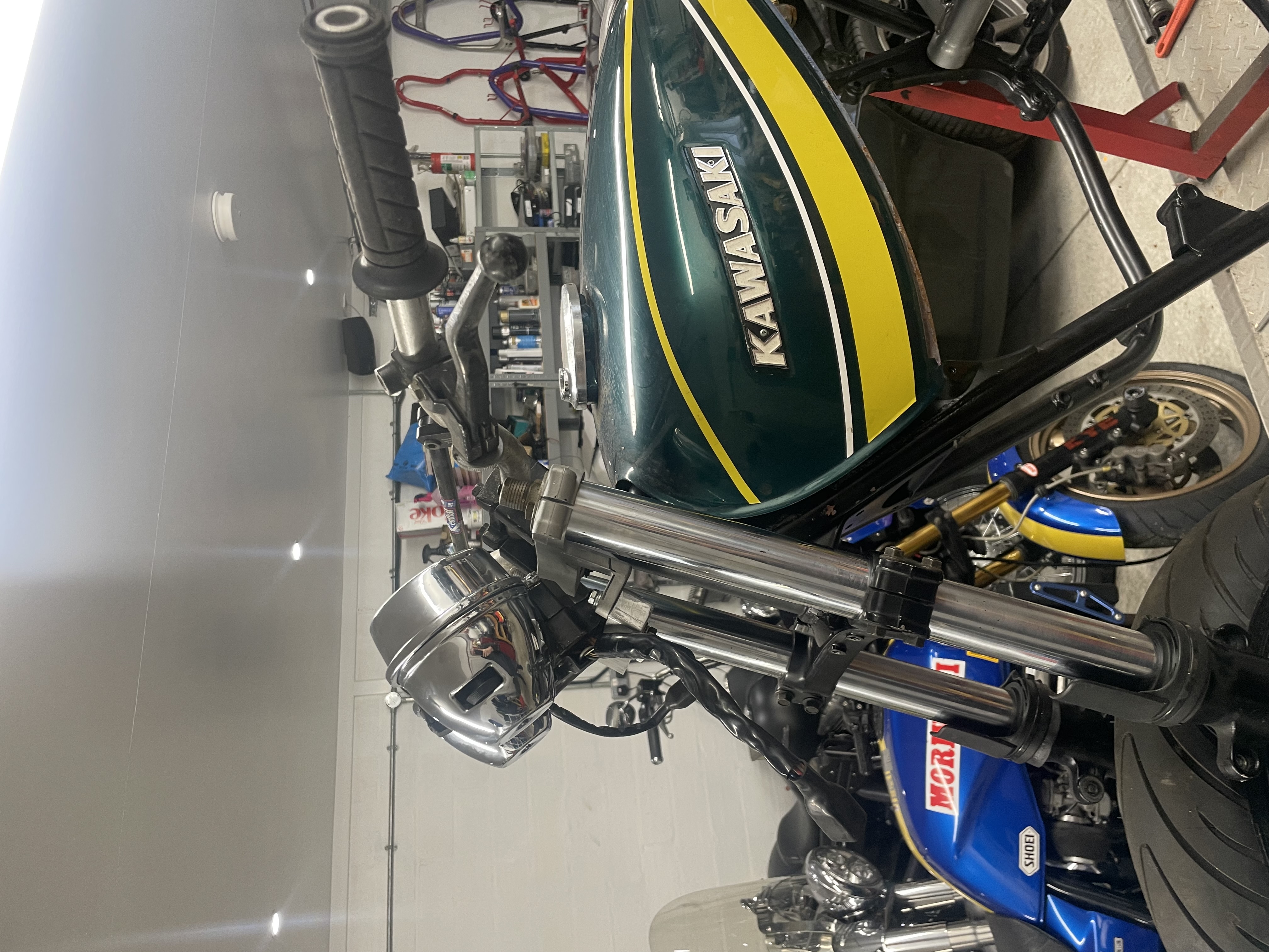

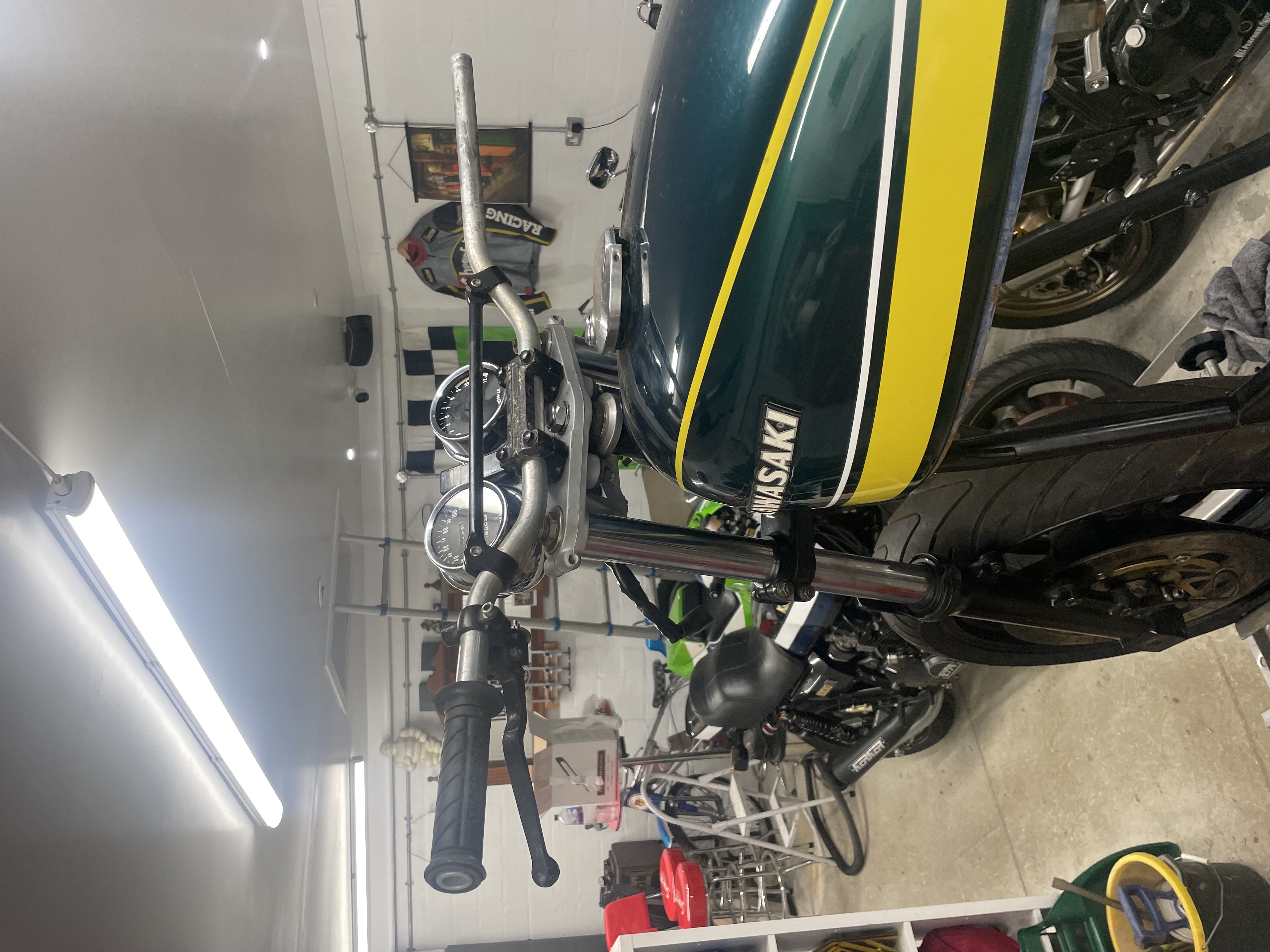

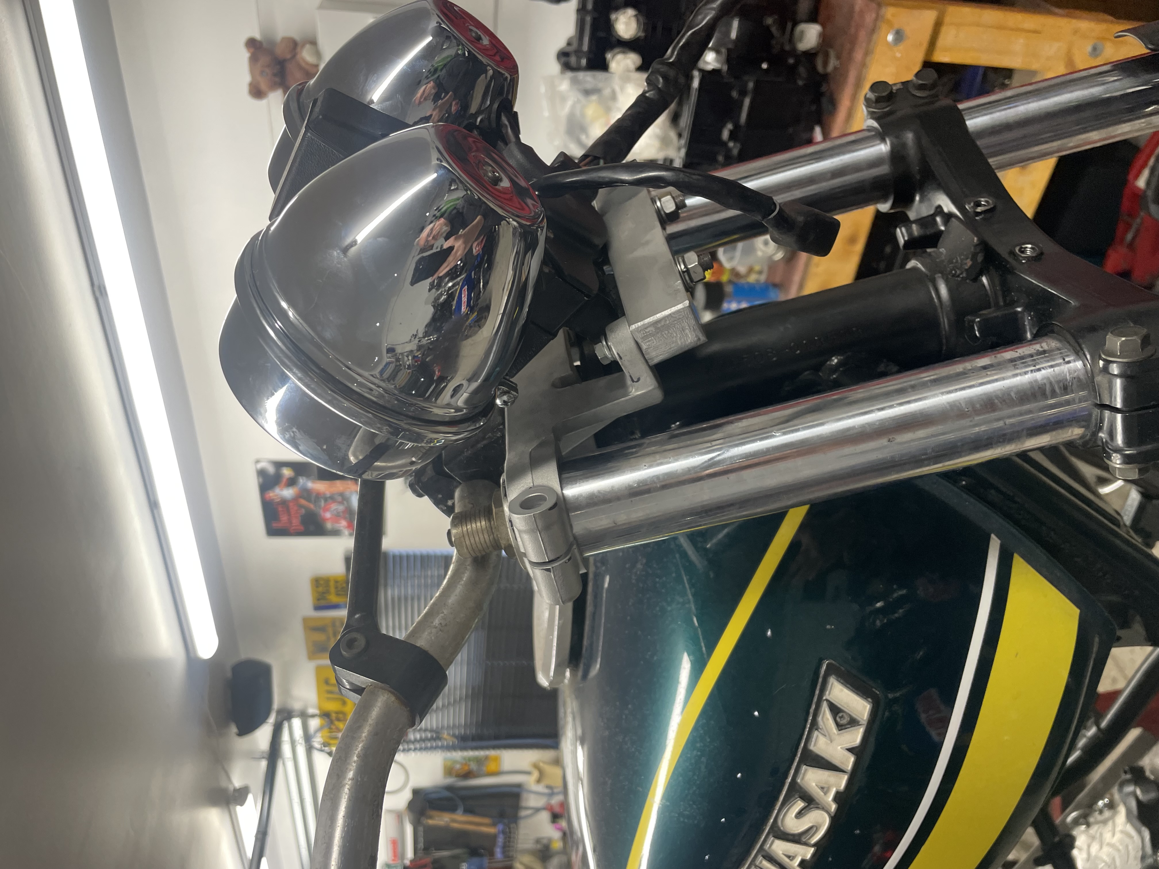

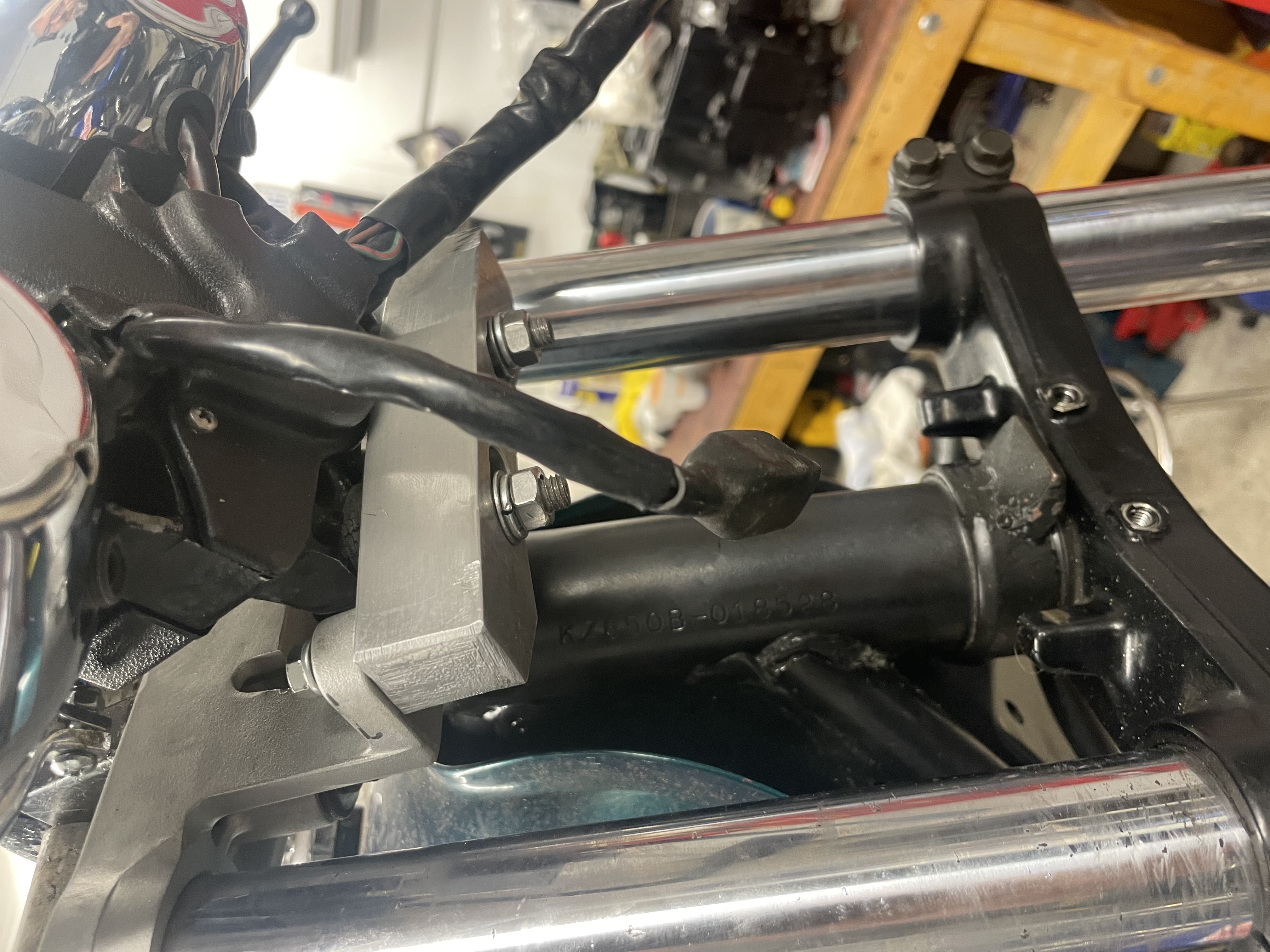

Today not a lot happened but I did make a bracket for the clocks. First pass looks aweful way too high… second is back in line how it should be.

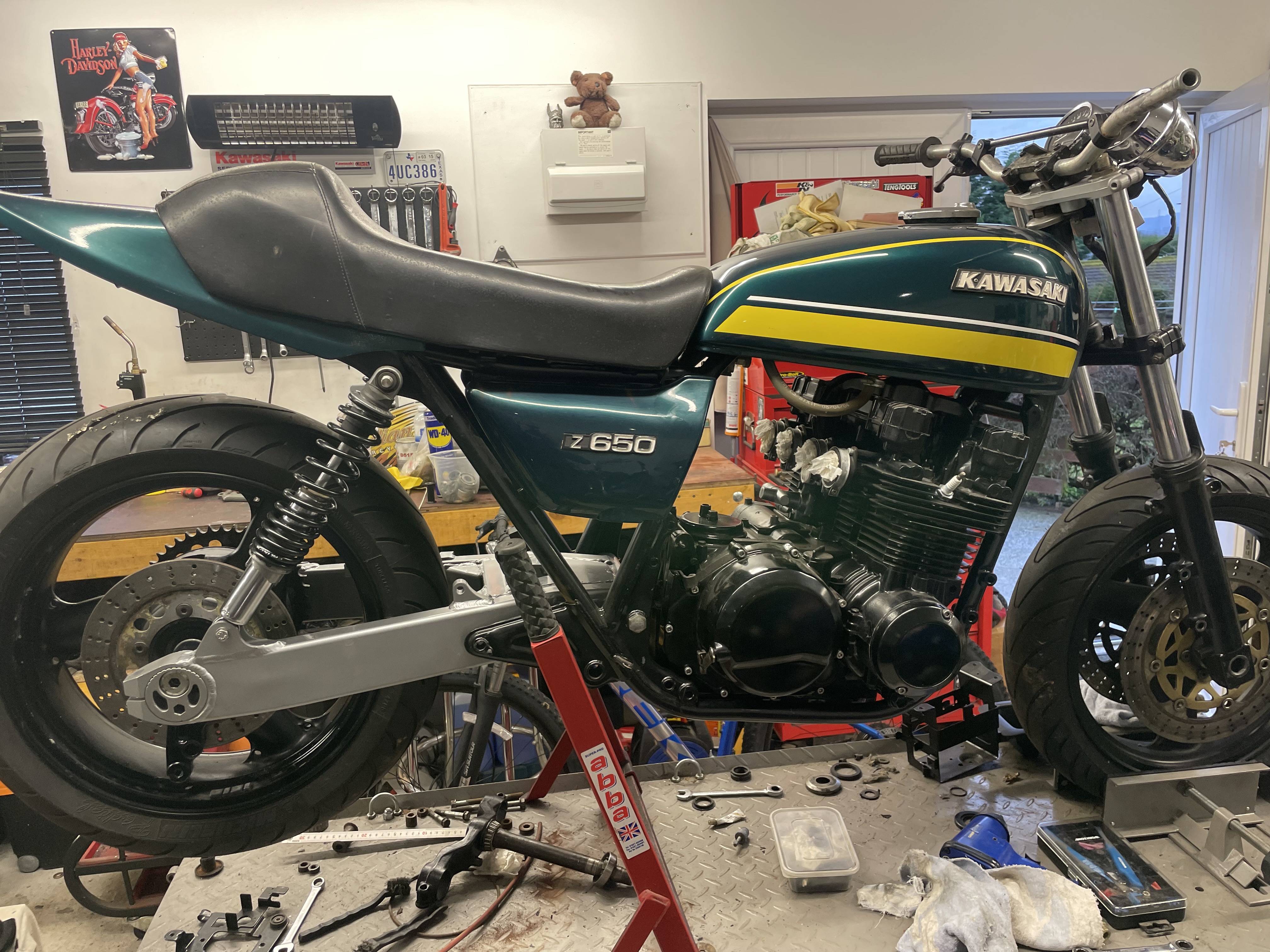

Had a helper today so got the 750 lump in it. Next spacing out chains…

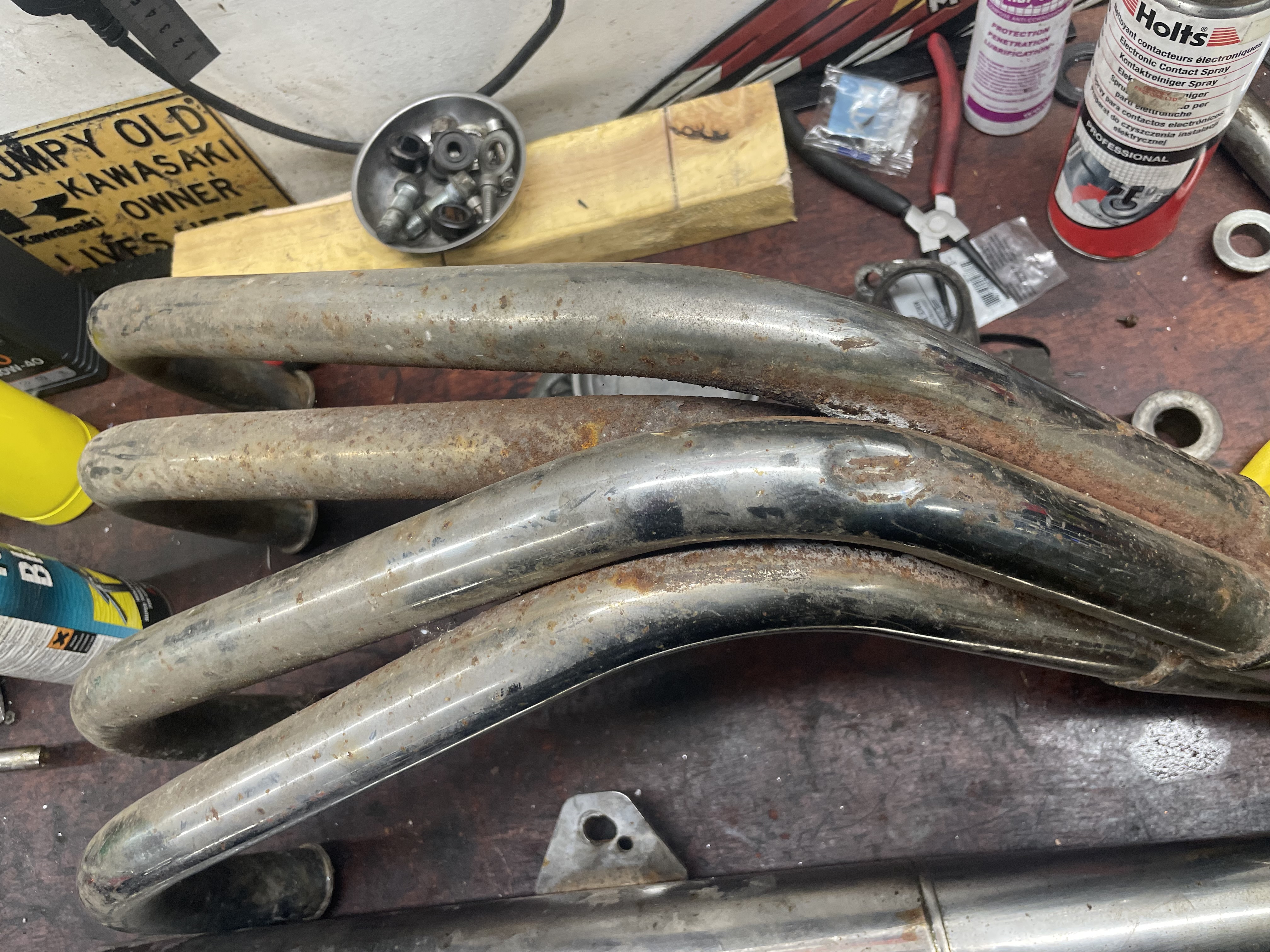

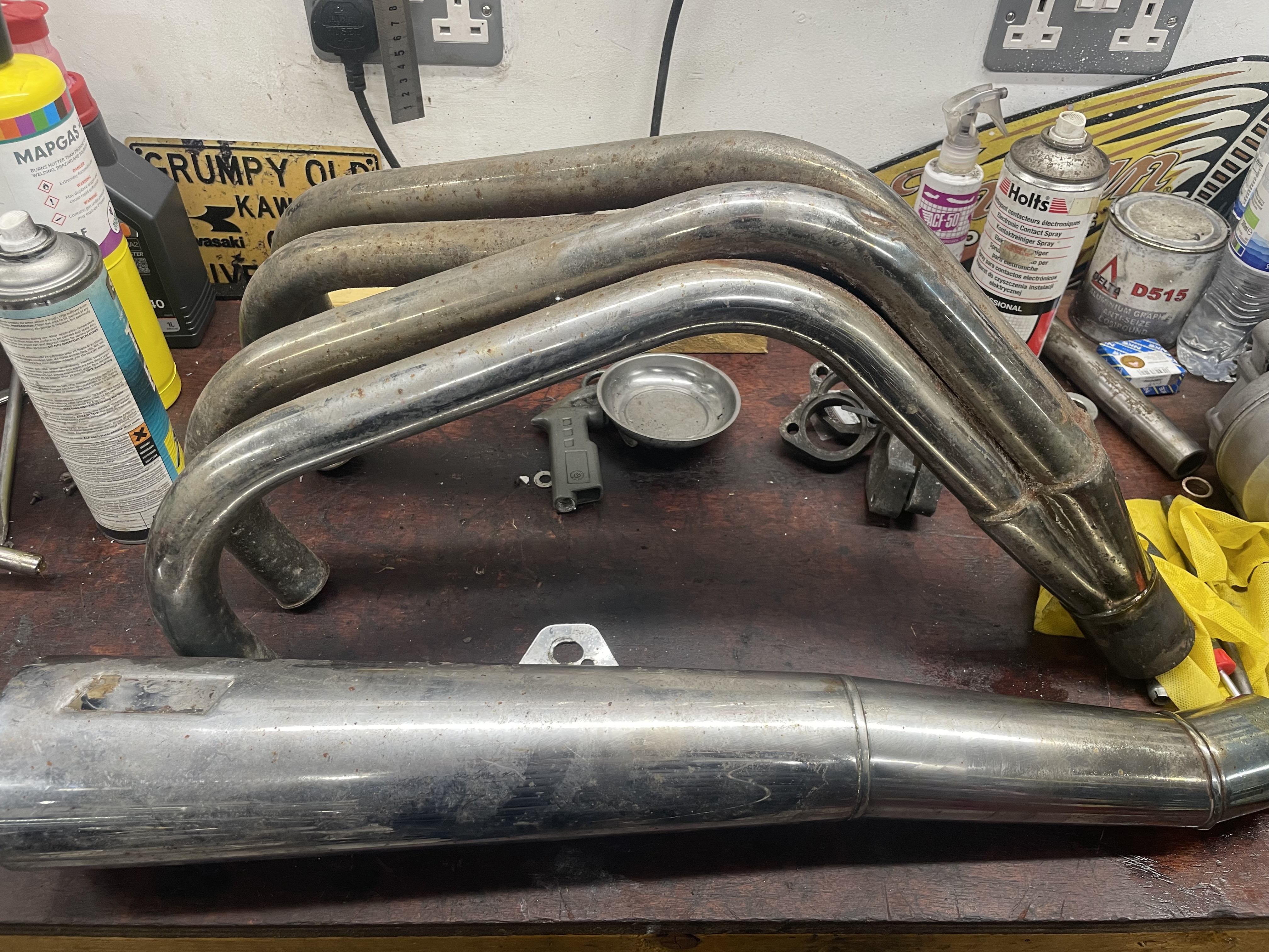

Since I was stuck on the sprocket alignment I thought I’d have a dog in the loft for an Exhaust. Found a sawn off laser 4-1, put it on and looked aweful.. then I found my old V&H megaphone.. now that’s better! Bit rusty but I’m sure it will polish up a good bit.
This one I’m going to give to my mate who loves polishing, he’s just given up drinking too so good time to get him as he’s always needing to keep busy :lol:

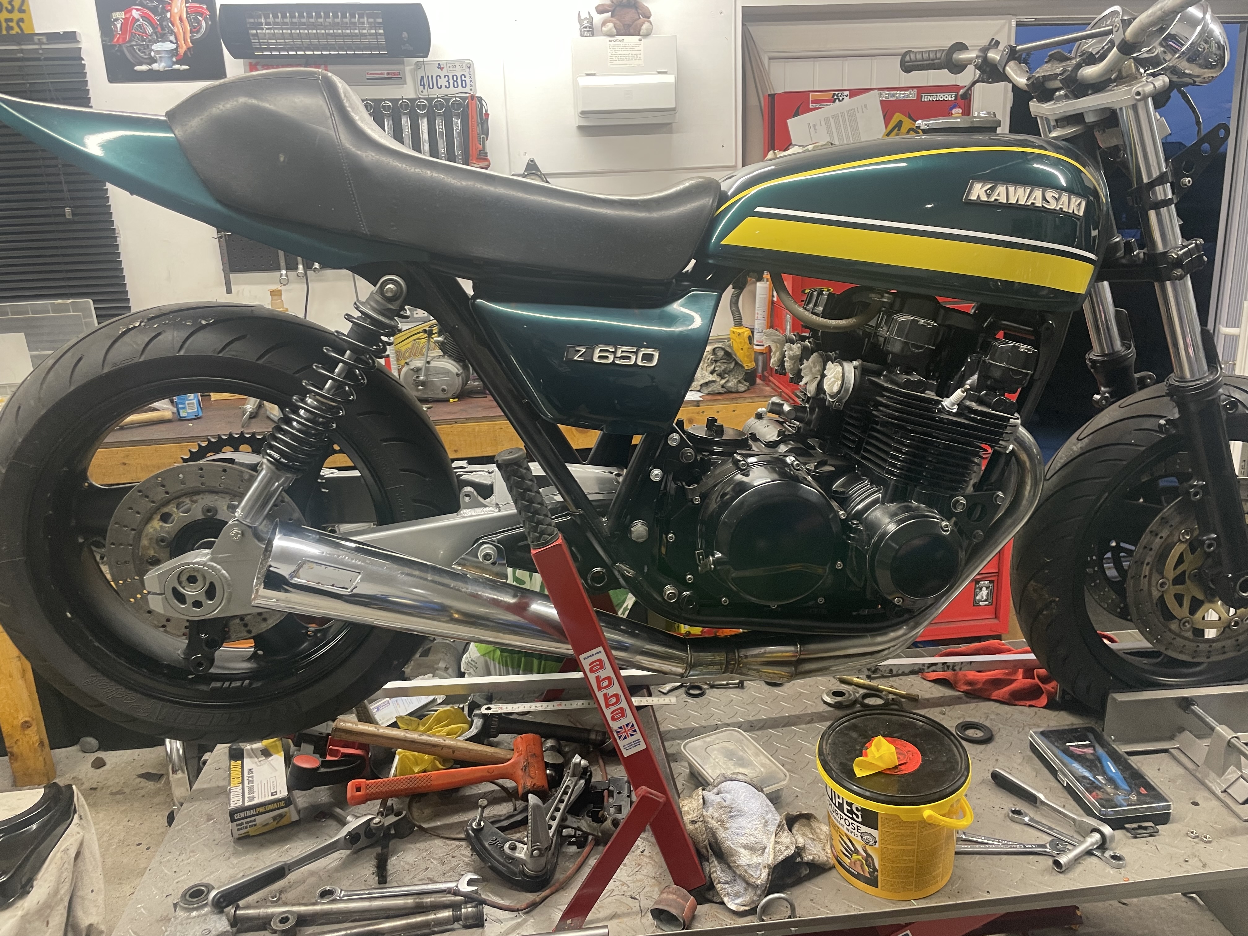

#27 PostAuthor: LeeJackson » Sat Mar 08, 2025 7:38 pm

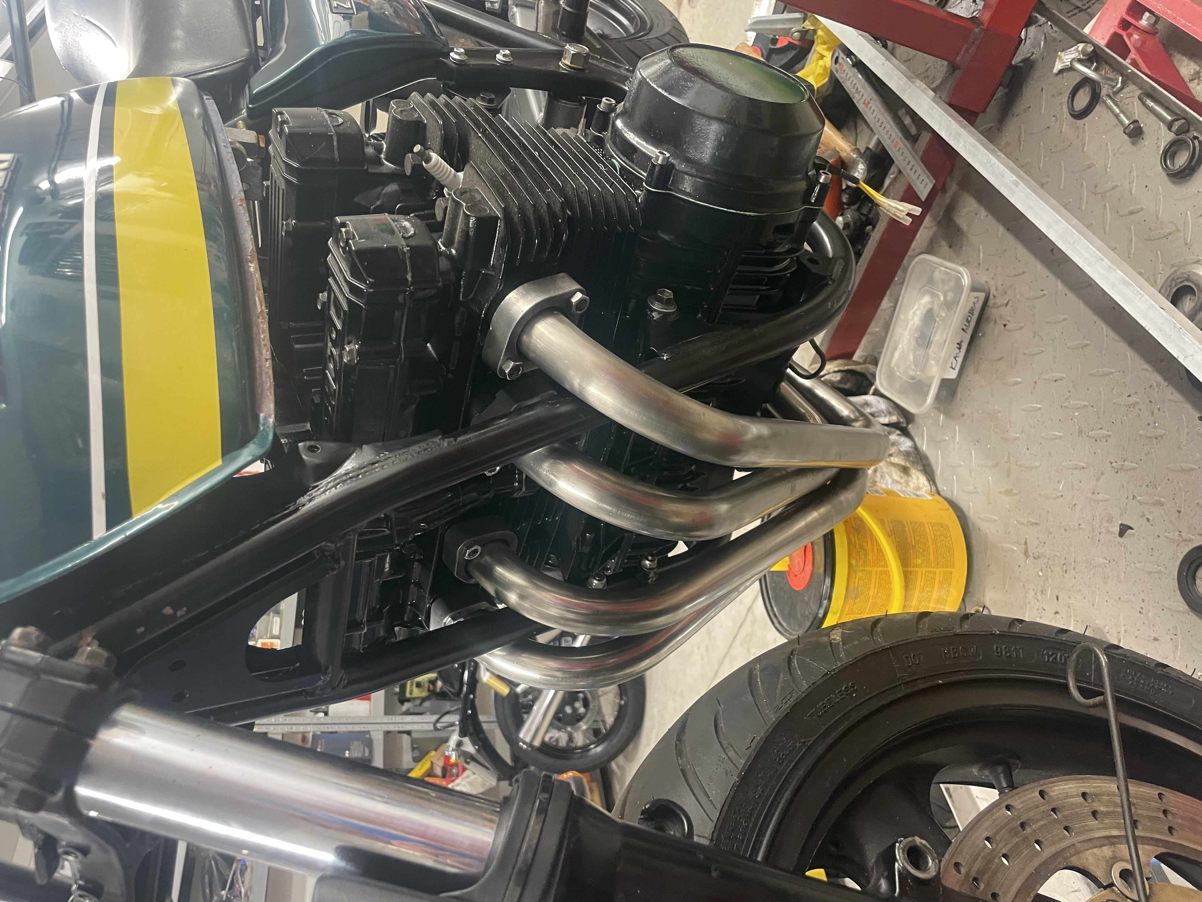

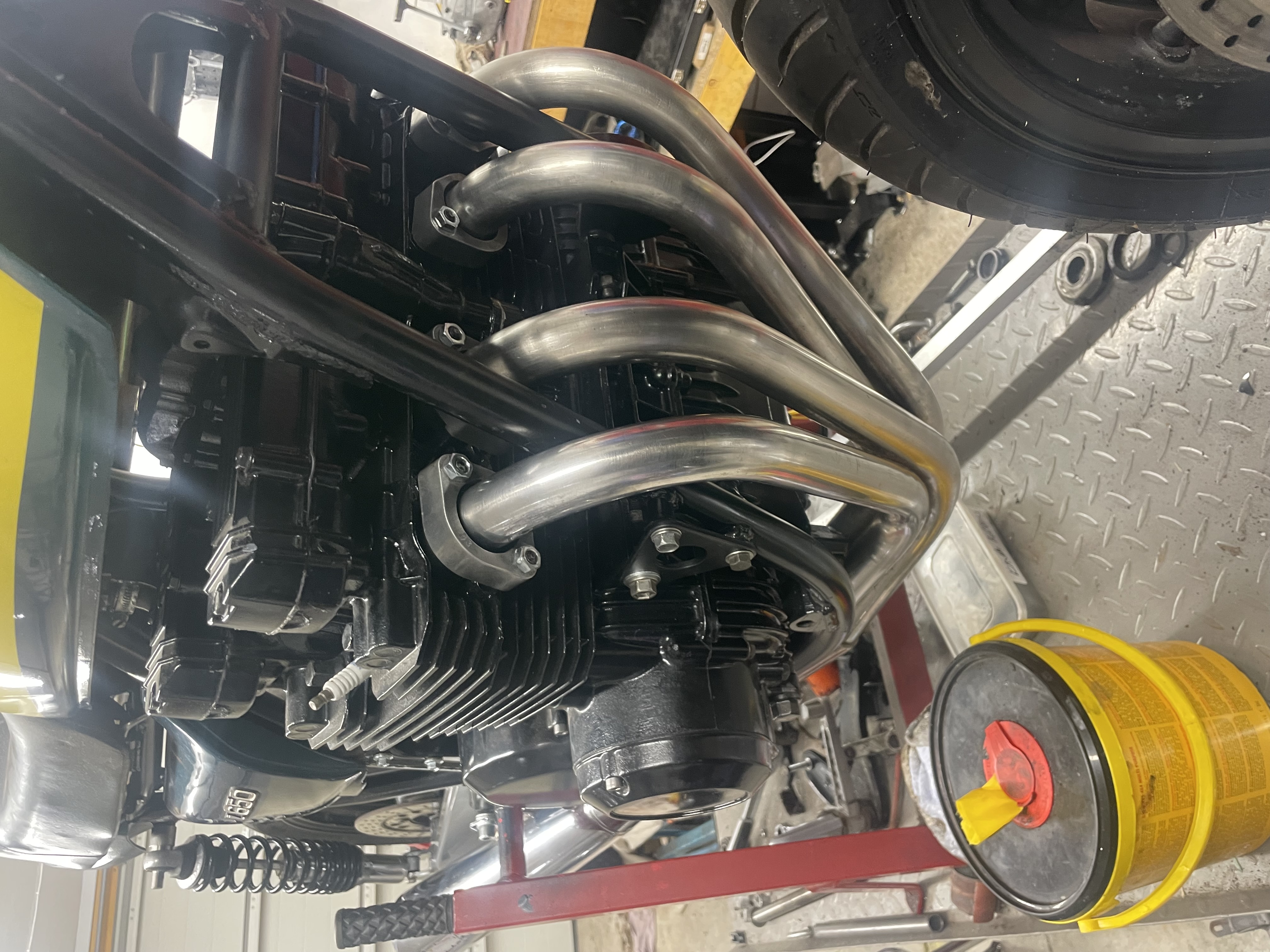

My mate did a grand job for me on the pipes. Looking totally presentable which was all I need on this build. Got my front sprocket on too with the 5/8” offset which should just clear the frame. Now a bit of measuring and a few mil in at the back and we’re good.
