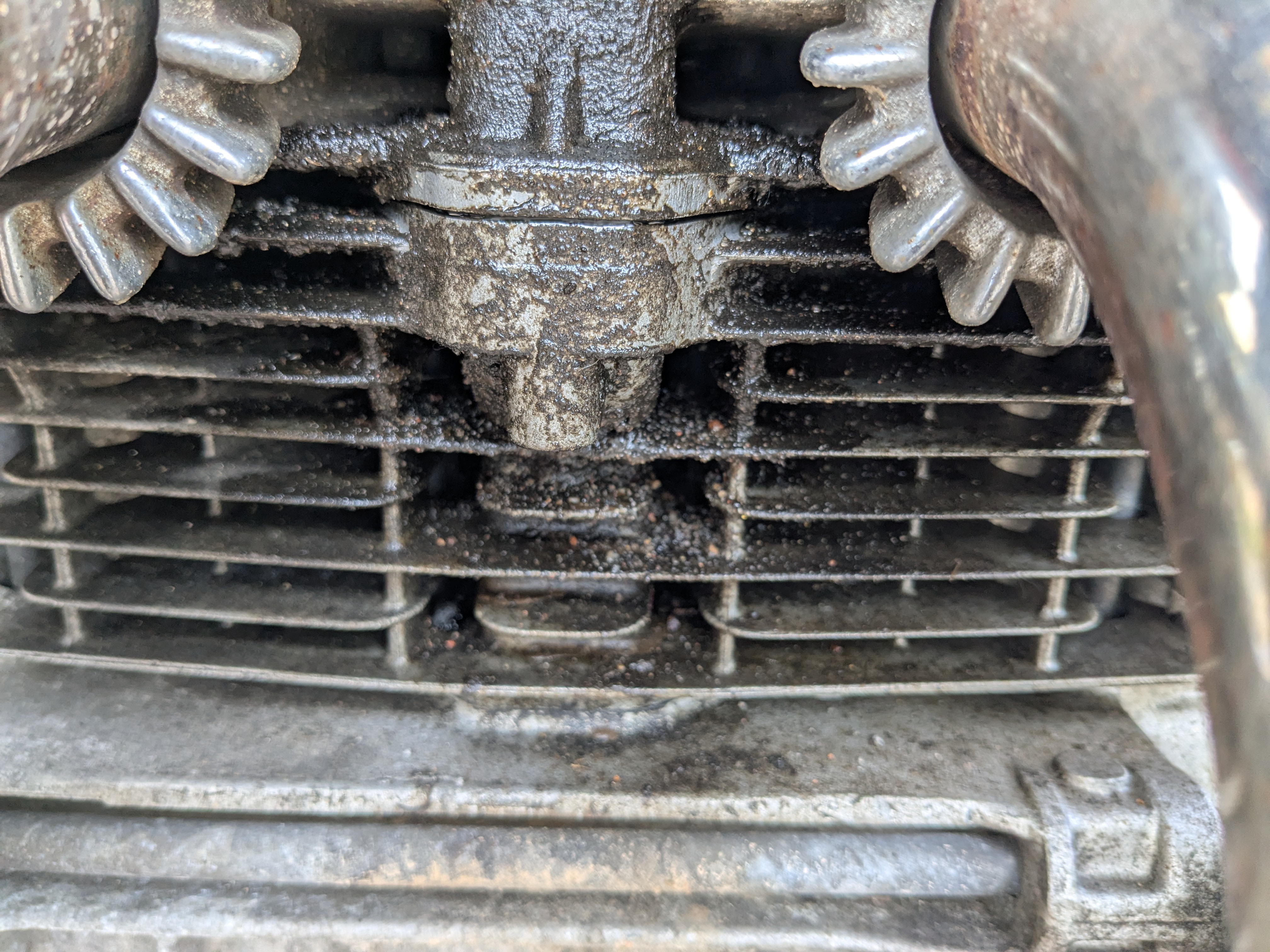

I've recently bought a KZ1000A2 with 31k on the clock. I haven't ridden it in earnest yet but it starts well, and runs and revs freely, no nasty knocks. I noticed some oil residue around the front of the cam-chain casing (see photo) so decided to carry out a compression test, the results of which are

These seem very low to me, I'd expect upwards of 150 psi in a standard set-up. At this stage I'm ruling out a blown cylinder head gasket as I'd expect this to affect probably 1 cylinder only, not all 4. I'm therefore thinking that stuck piston rings is a more likely culprit so will try soaking them with Sea-foam for a couple of weeks. I've recently changed the oil so will drain the engine first before adding the the Sea-foam. I'll also level out the pistons to the same positions in all cylinders beforehand.
I'd be interested to know if anyone else has noticed such low compression on their Zeds and how they tackled it. If it needs a top end strip down so be it, I'll tackle that later. I figure that I've nothing to lose trying the Sea-foam first as this may solve the problem.
