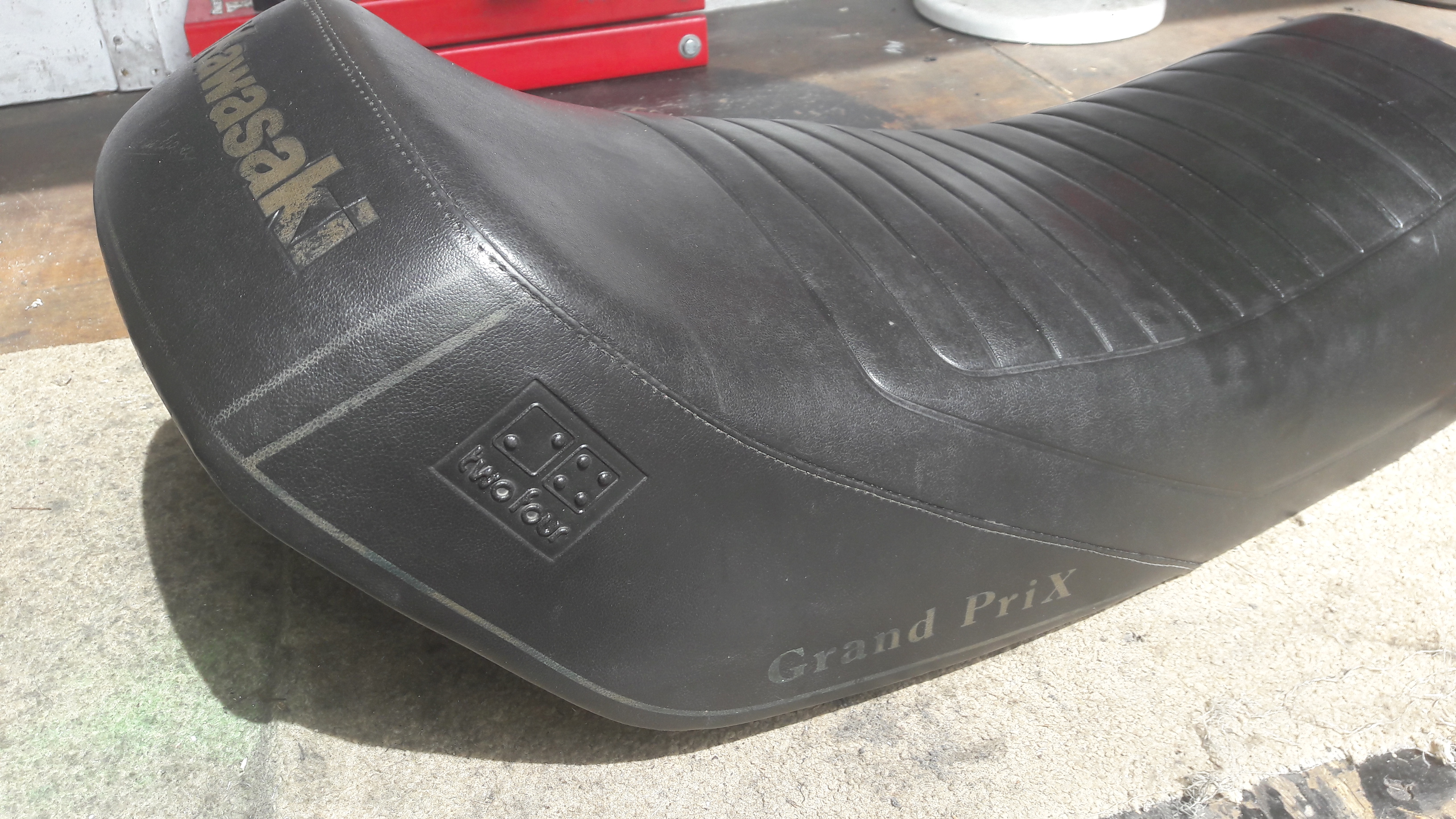

If you are ever thinking of selling your seat please give me a prod. Cheers mate

Simonic wrote: If you are ever thinking of selling your seat please give me a prod. Cheers mate
Original 2:4 Not for sale.
