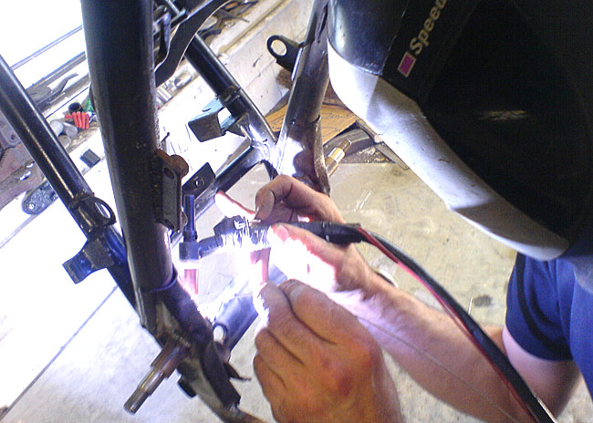

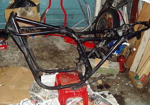

Frame's cosmetically quite horrible - like my garage.. It's going off for a bit of welding, new shock mounts, and a powder coat within the next week. Hopefully my brother will pick it up from my garage while I'm at Donno - he's got a powder coater near him plus he's ging to weld the new pins in for me before he takes it there. If the pins bloody come - they should have been here weeks ago...

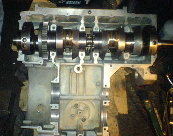

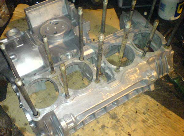

Much elbow grease and swearing they're still not Steve Smethurst crankcases but that's as good as I'm realistically going to get - plus this isn't going to be a coffee table Zed - so we'll move on...

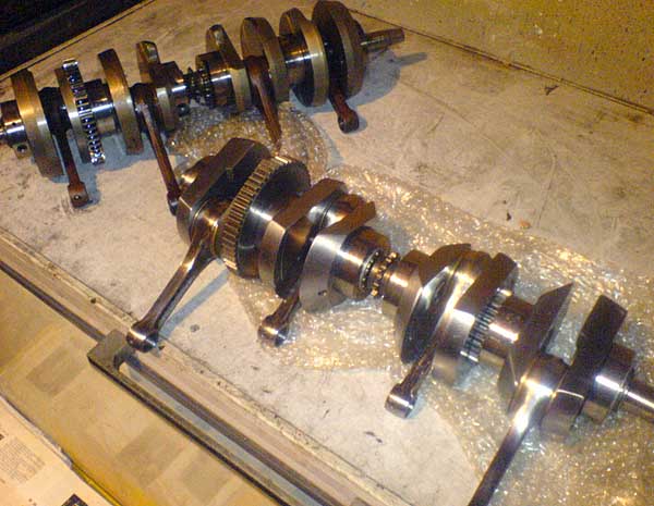

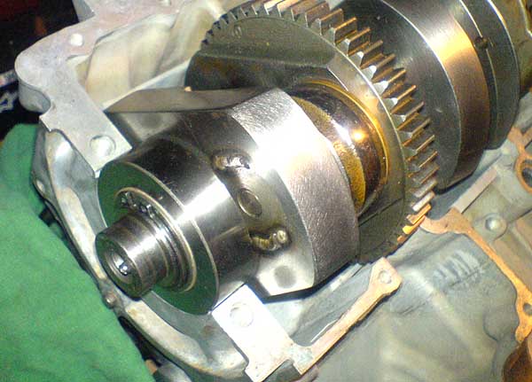

New crank - old crank:
I was lucky to get this crank from Martin Newberry at Psycleworkz for less than it would have cost to rebuild mine and it's welded and lightened - it's aMk2 crank so needs different camshaft sprockets and chain but the rotor off the A1 should still fit. Going to get some of Martin's billet engine plates too when we get that far - shortly I hope. (He gives Z1OC club discount...)

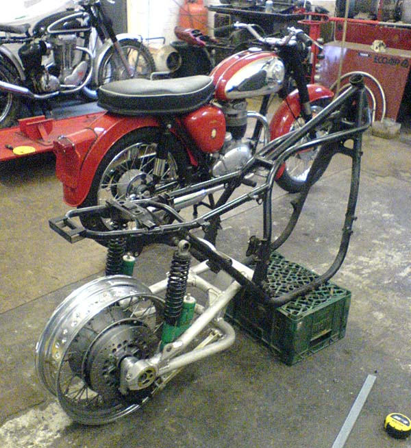

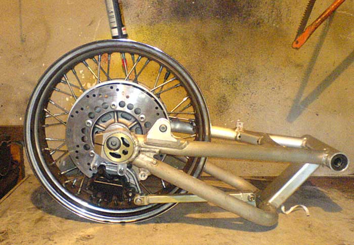

This is the rear end which I got back a few weeks ago

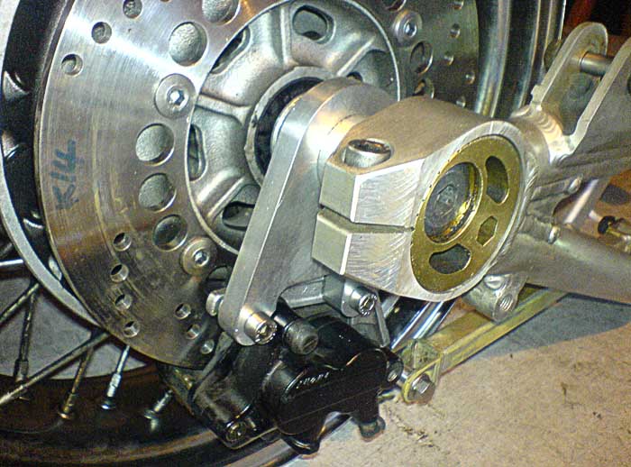

This arm's the same width as the 1000R arm but it's about 5mm wider than the old arm which means it's not quite a straight fit on the earlier frames - but hopefully it'll not be too troublesome. I'll post pics of the solution when it's in.
The arm's going to be powder coated black too - Fer has a black one on his 1000 and Padders recent pics prove my long held theory that the old shape bikes suit a black arm, the lawson/gpz types can carry a shiny arm better - that's just my theory.
Wheels are Zephyr 1100 spokes which I was really lucky to get a few years ago. The bike had spokes on it when it was new but they were replaced with alloys in about 1979 so the new much fatter wheels are kind of going backwards and forwards at the same time.

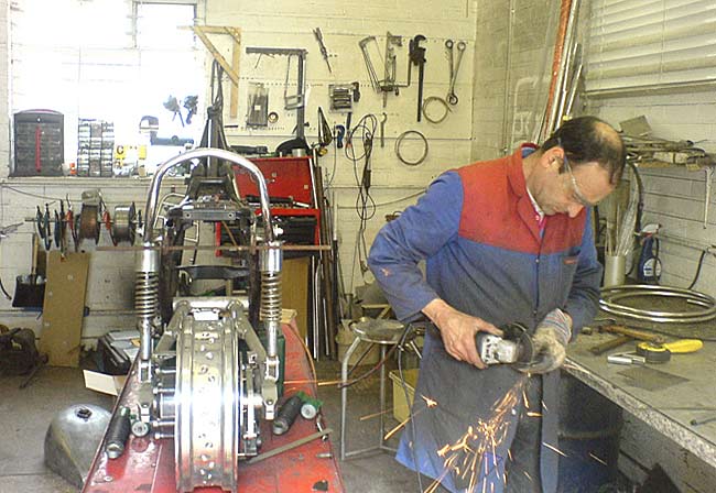

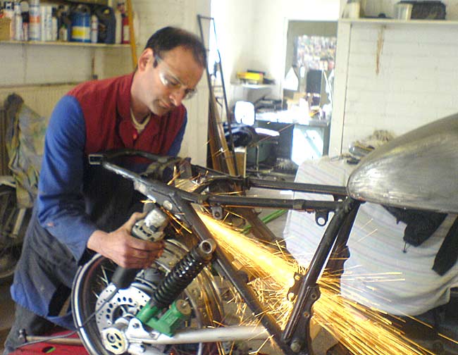

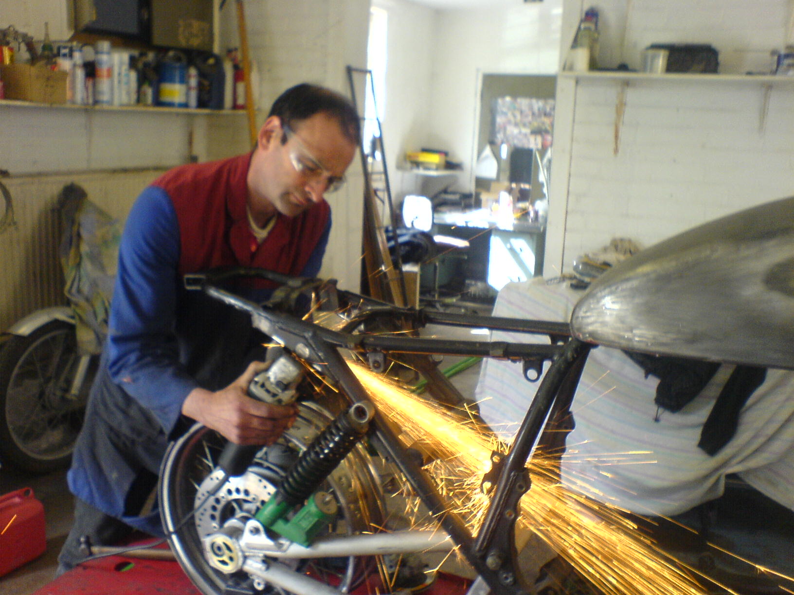

Seeing my garage is such a shit - tip this week I have moved the frame to my brother's slightly tidier workshop to avoid any further criticism from Pigford. :lol: Once again sorry for the dodgy pics still using the phone :oops:

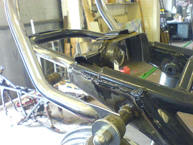

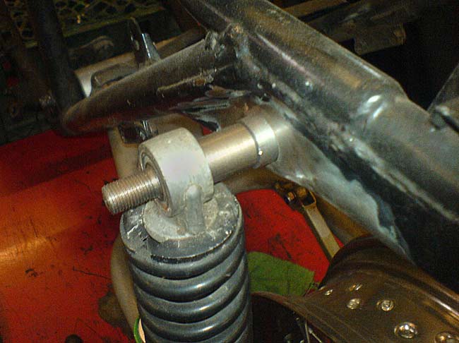

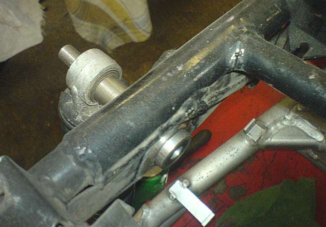

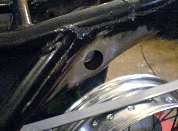

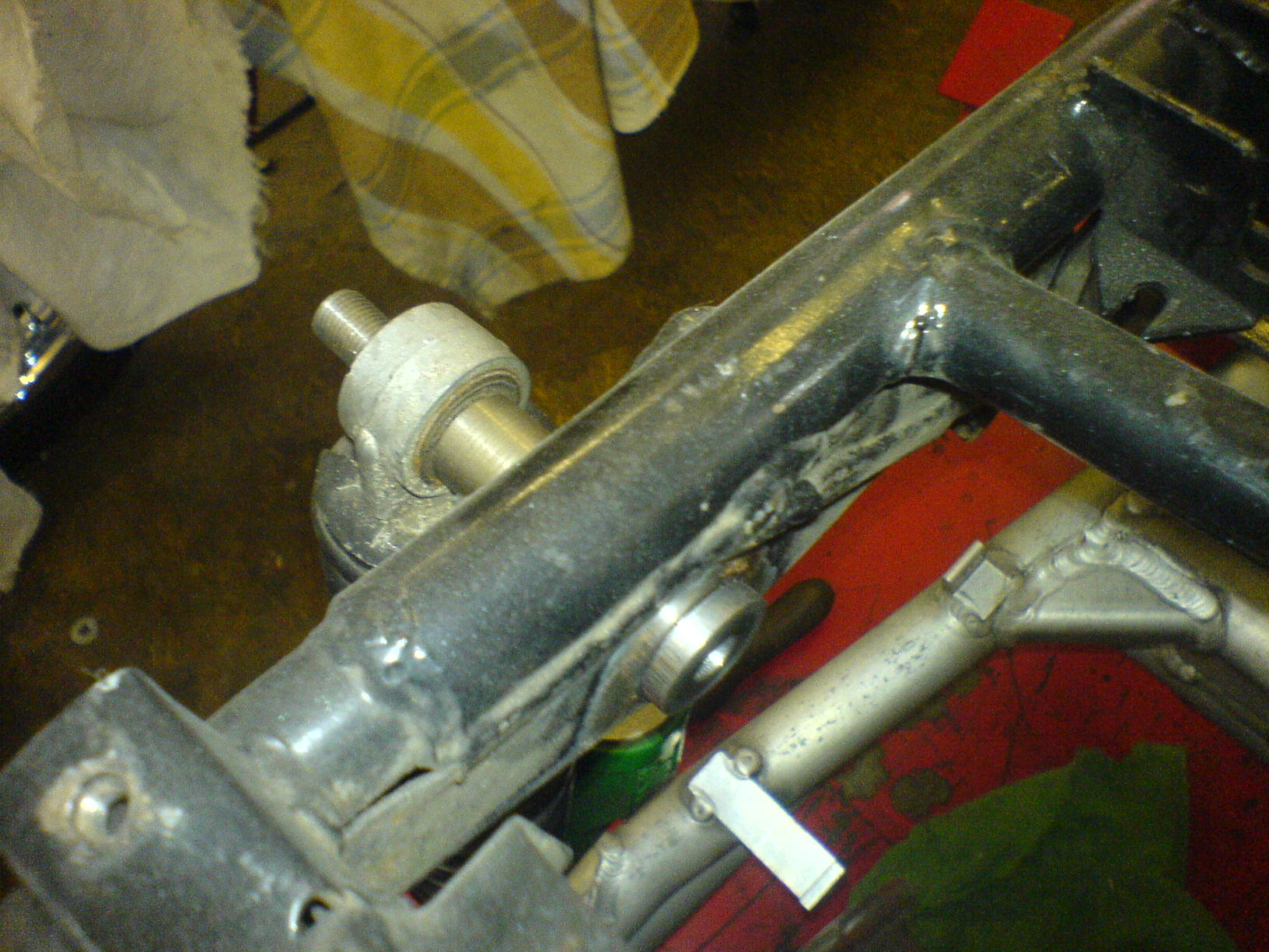

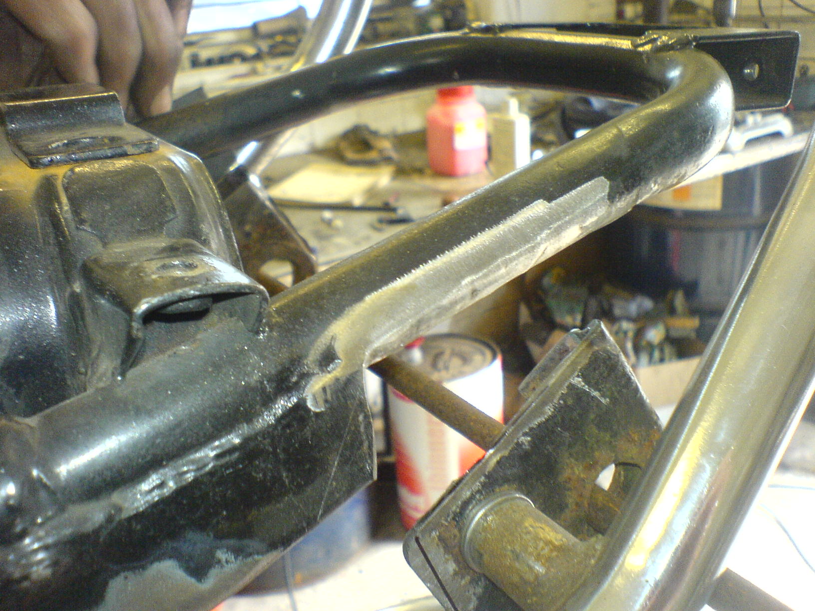

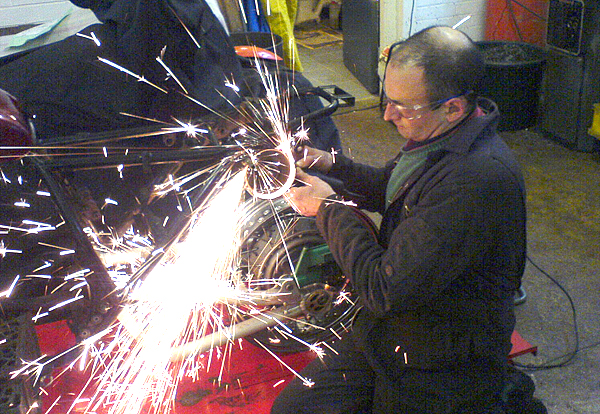

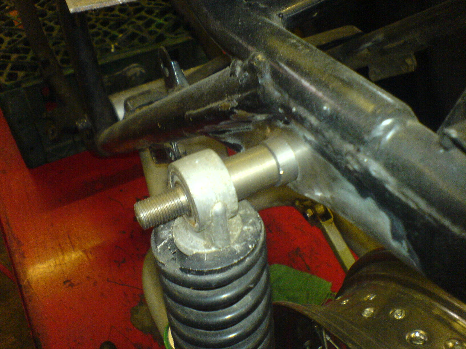

Next step is to cut out the shock mount pins to put in longer ones...

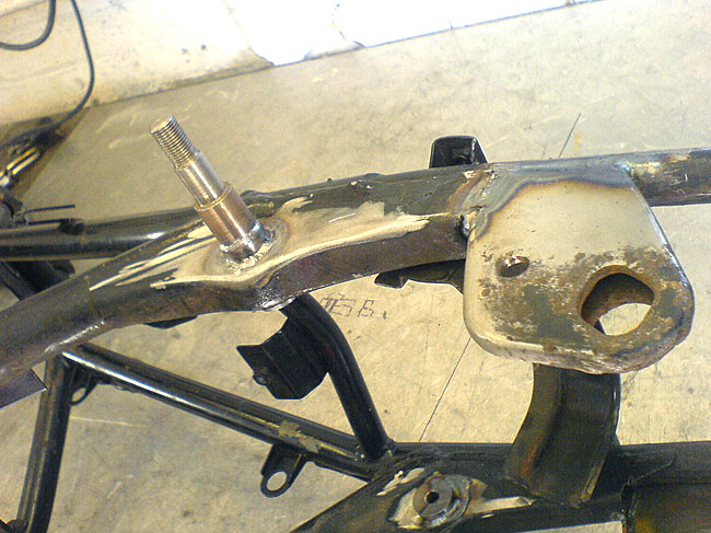

.. and to strengthen this up a bit - the metal these are mounted in seems surprisingly weedy although when it's all welded together it seems reasonably solid. However a bit of beefing up won't do it any harm

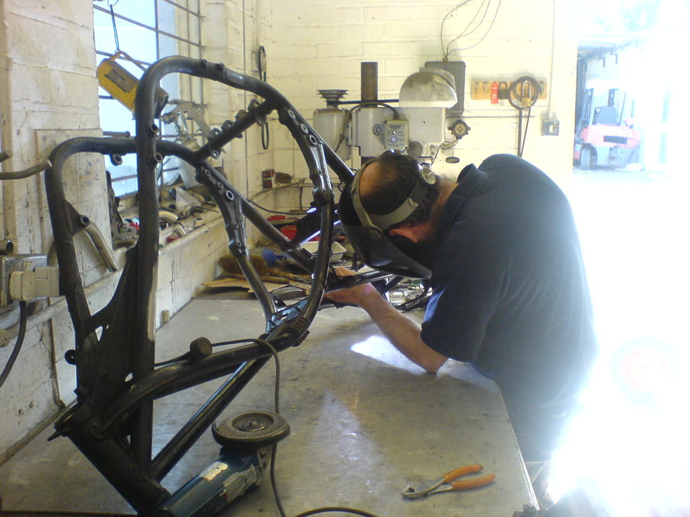

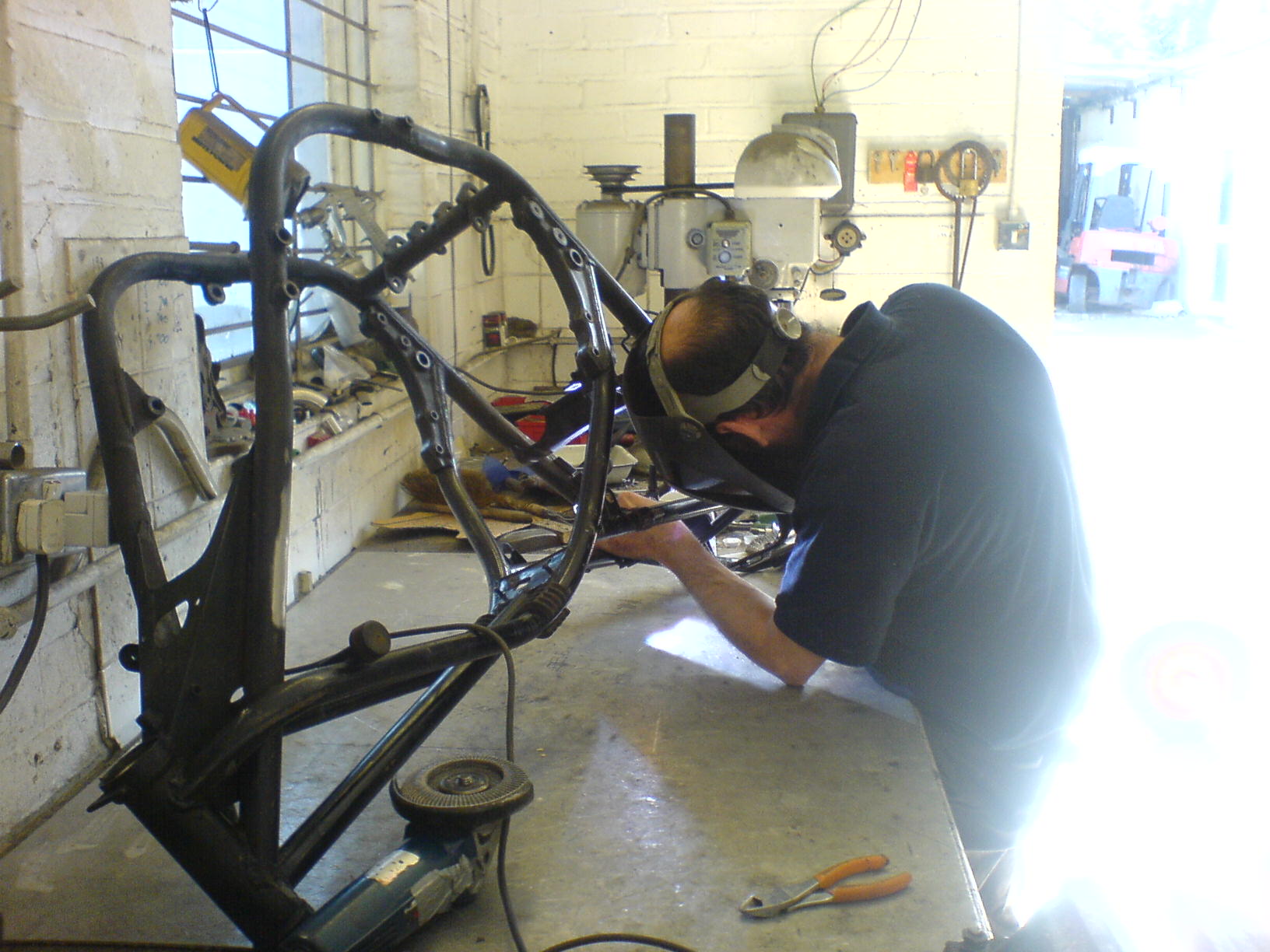

So here's one of these tacked in place it will need welded all round

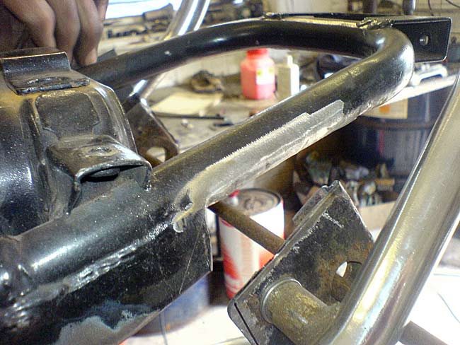

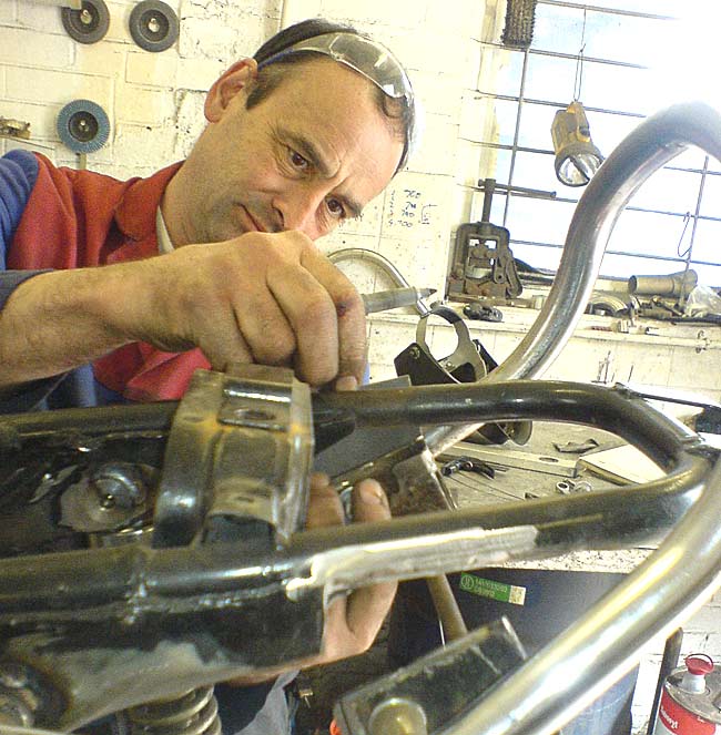

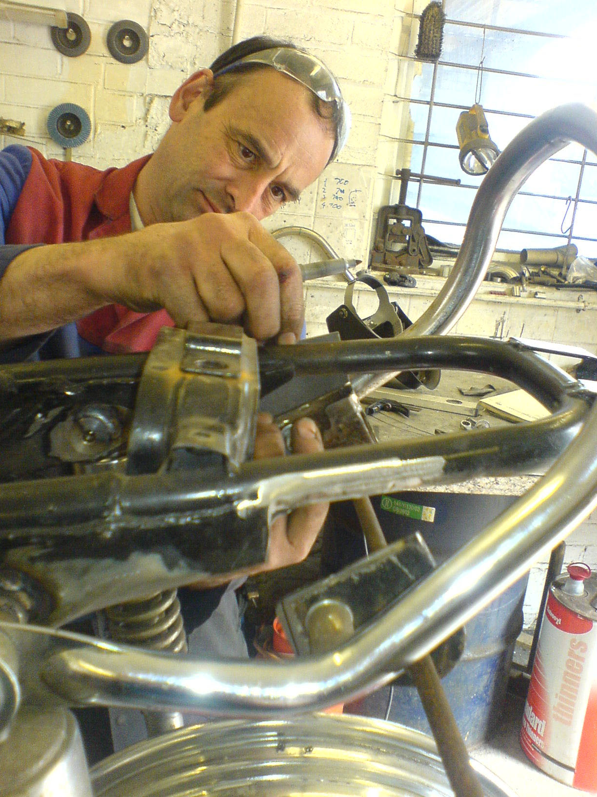

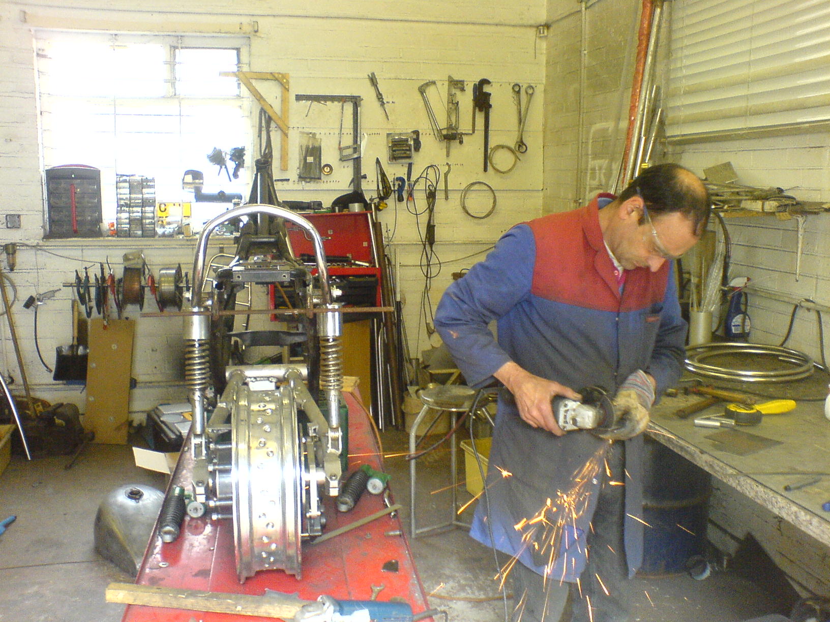

Next step is to cut off the current grabrail brakets and put on something more like the originals which were removed a few years ago in a bit of spring cleaning. I need these because I'm putting on original style indicators again to make up for all the other mods - when the bike was more standard it had mini indicators. Need a grabrail on to line them up - the grabrail is going to go inside the shocks now instead of outside
The grabrail/indicator mounts are being made up from some off an old 250 frame which was conveniently lying on a heap of scrap out the back of Jeremy's workshop. They're the right shape to take the indicators but tthey're a bit smaller so they'll need a bit welded in to get them low enough to be in the right place. I'm angling them forward a bit so they stick down the minimum amount to clear the bodywork and be neat. I always thought the standard ones were a bit agricultural.
Now we're getting places. Soon be off to powdercoat...

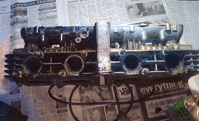

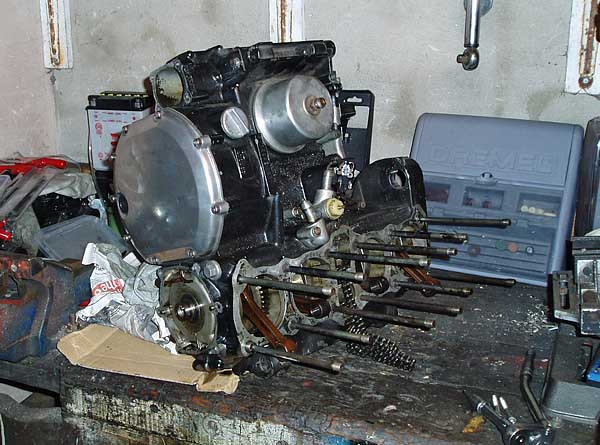

On to the next problem - note: if you paint your engine black it's a right bastard when you decide seven years later you want it silver again...

Looking good, I like the spoke wheel set up too. What section tyre are you going to squeeze in then Chris ?? :D
#13 PostAuthor: Pigford » Sat Feb 24, 2007 3:51 pm
Yeah, that rear spoked wheel & disc set up is interesting! Whats the score with that then Chris :?:
