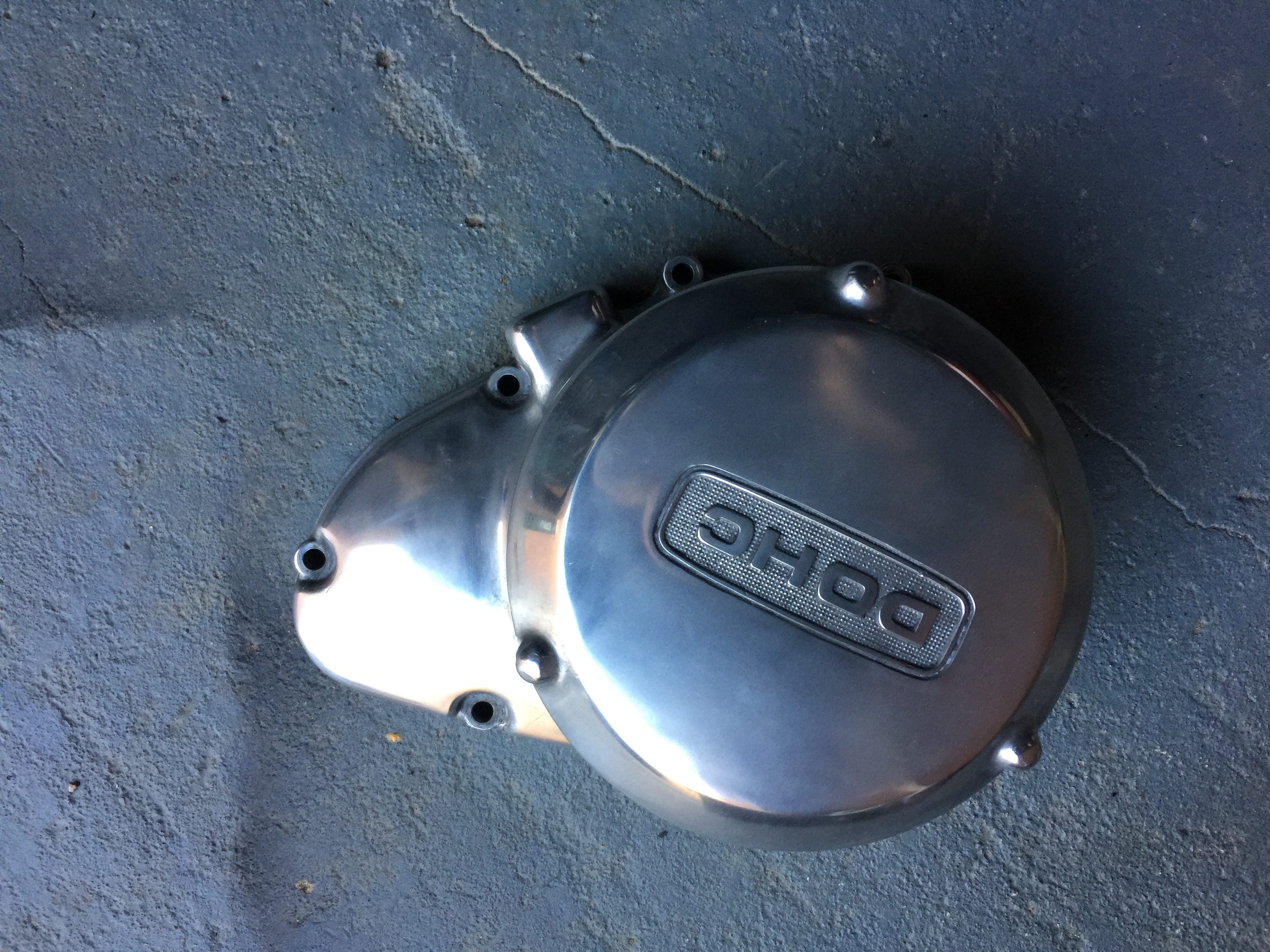

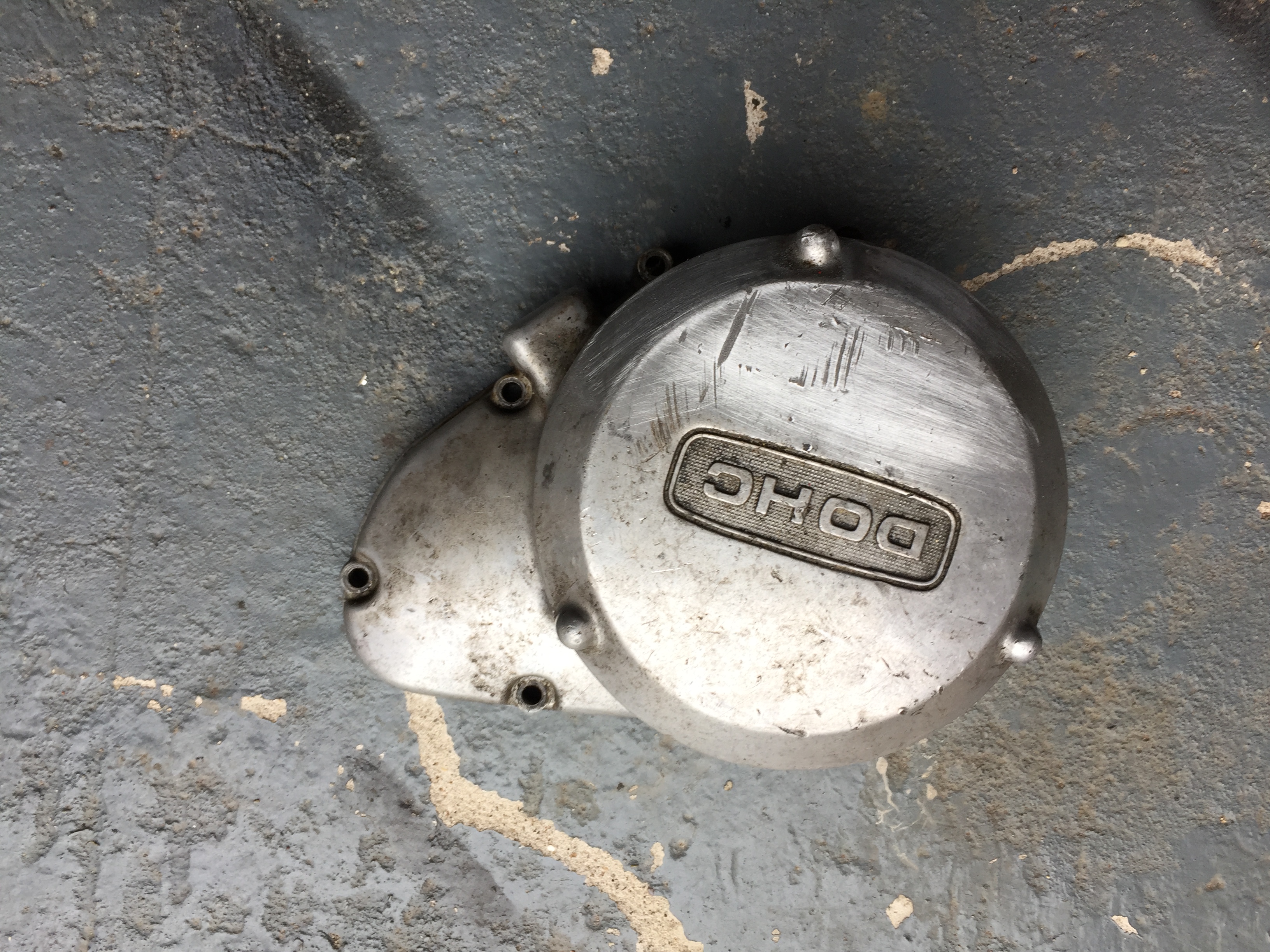

#27 PostAuthor: deka » Mon Dec 03, 2018 9:34 am
Bought a used generator cover due to mine being in a terrible state this is the replacement before work started
After a bit of work this is the stage now Plus others of course
Posts: 2052
Re: KZ900 the beginning
#28 PostAuthor: Philippe » Mon Dec 03, 2018 4:54 pm
Hi Derek
you did a beautyful job! It's like a new one! :brav2 Continue that way and keep us informed with pictures!
Go for it!

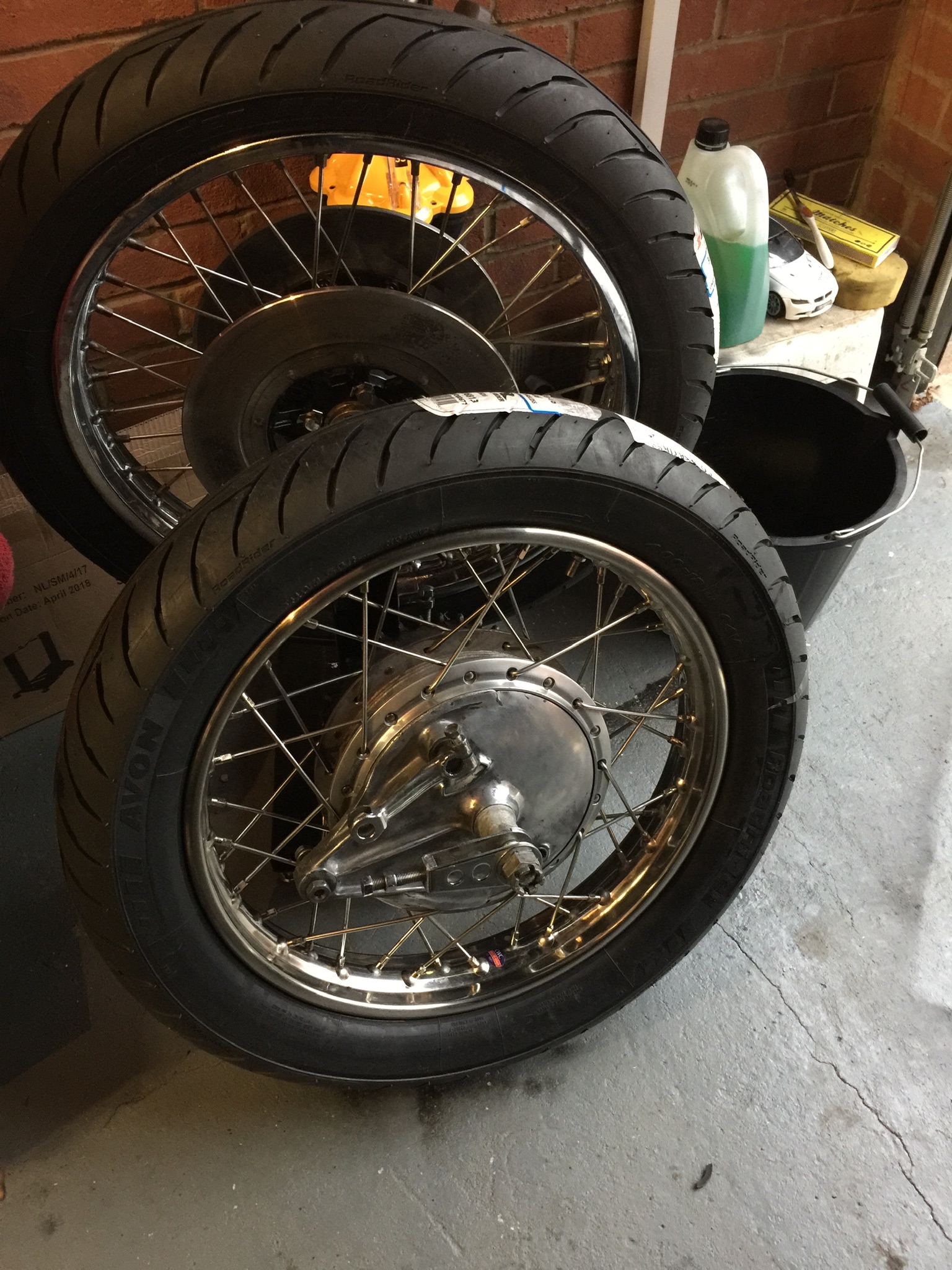

#30 PostAuthor: deka » Sun Mar 03, 2019 7:07 pm
Been a while since I have been on as still collecting missing parts, I have some of the major pieces at the chromes and have been filling in my time cleaning up the cases.
Latest jobs have been to fit a tyres to the re laced rear wheel..
The old check twice came into play. I checked to make sure I had the rotation of the tyre pointing the right way and fought to get it on the rim and then noticed it was the wrong way ahhhh :x ok take of a start again this time checking more than twice. Last part of getting the tyre on and nipped the tube....... off to the shops for a repair set and and finally job done and holing air.... no such problems with the front
