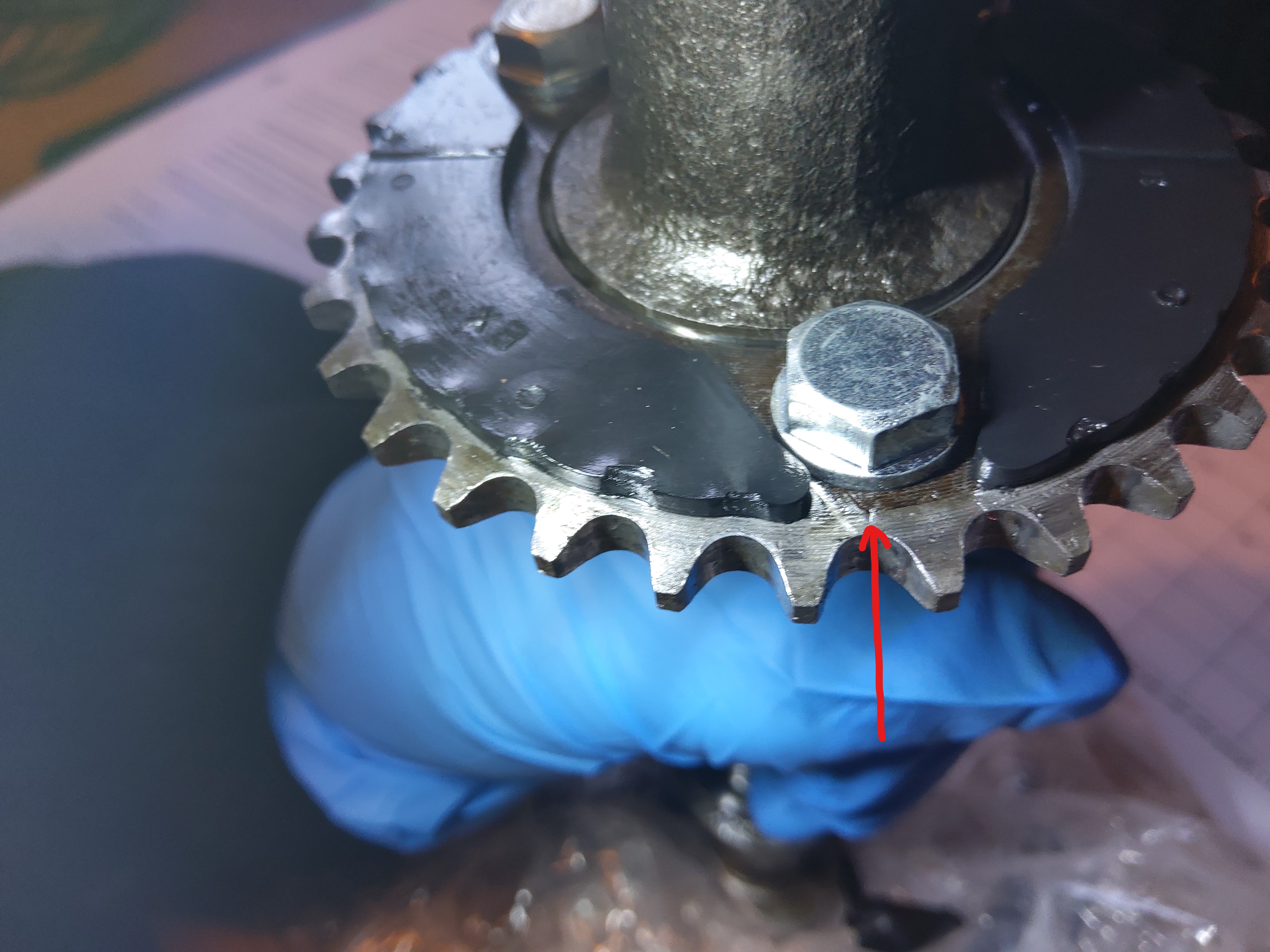

Re: cam timing....
You've probably sorted this by now but just in case the mark you're looking for on the exhaust cam is on the LHS of the sprocket with the cam in situ and is the tiny mark arrowed in the pic. I had the same problem when I came to do my cam timing. IIRC the both the inlet and exhaust lobes on cyl #4 point directly toward each other when the cams are in the correct position.
The lighter straight line just to the left of the mark is my marker so I could check it was lined up.

Well, got back to this after a loooong time....work, more work, z900, work etc etc...
Anyway, everything set up as in previous photos, Tdc on 1&4, cam lobes pointing toward each other, Mark on exhaust sprocket aligned with top of head, 28 pins from the pin above. All seems good.

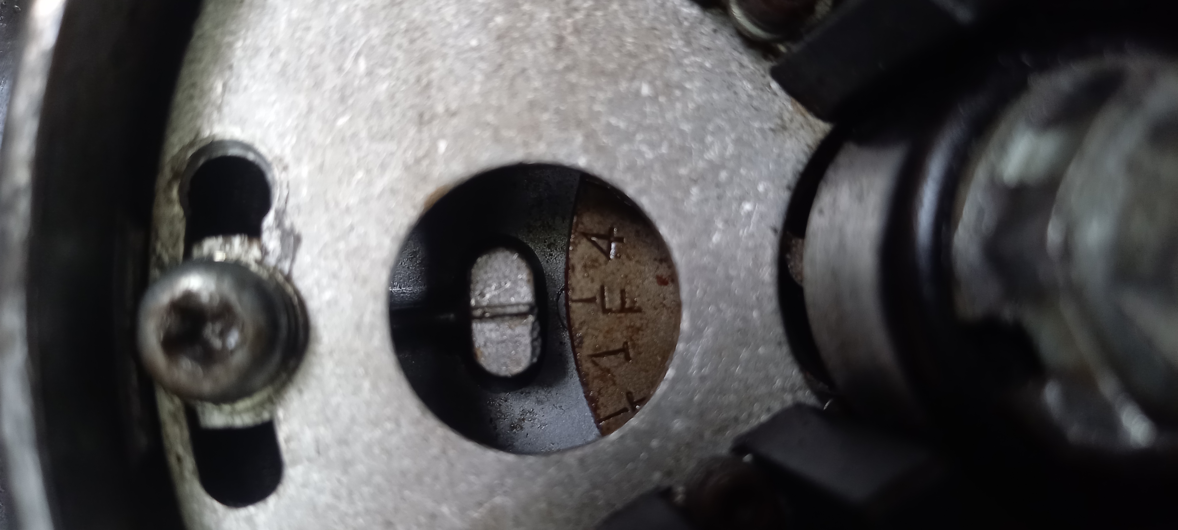

Re: cam timing....
Have you taken the centre rotor out of the DYNA 'S' at any point and if so did it go back in the same orientation?
Plugs out, all laid on head, ignition on, turn over by hand, confirm spark on #4 at,.. or close to the 'F' mark for 1/4

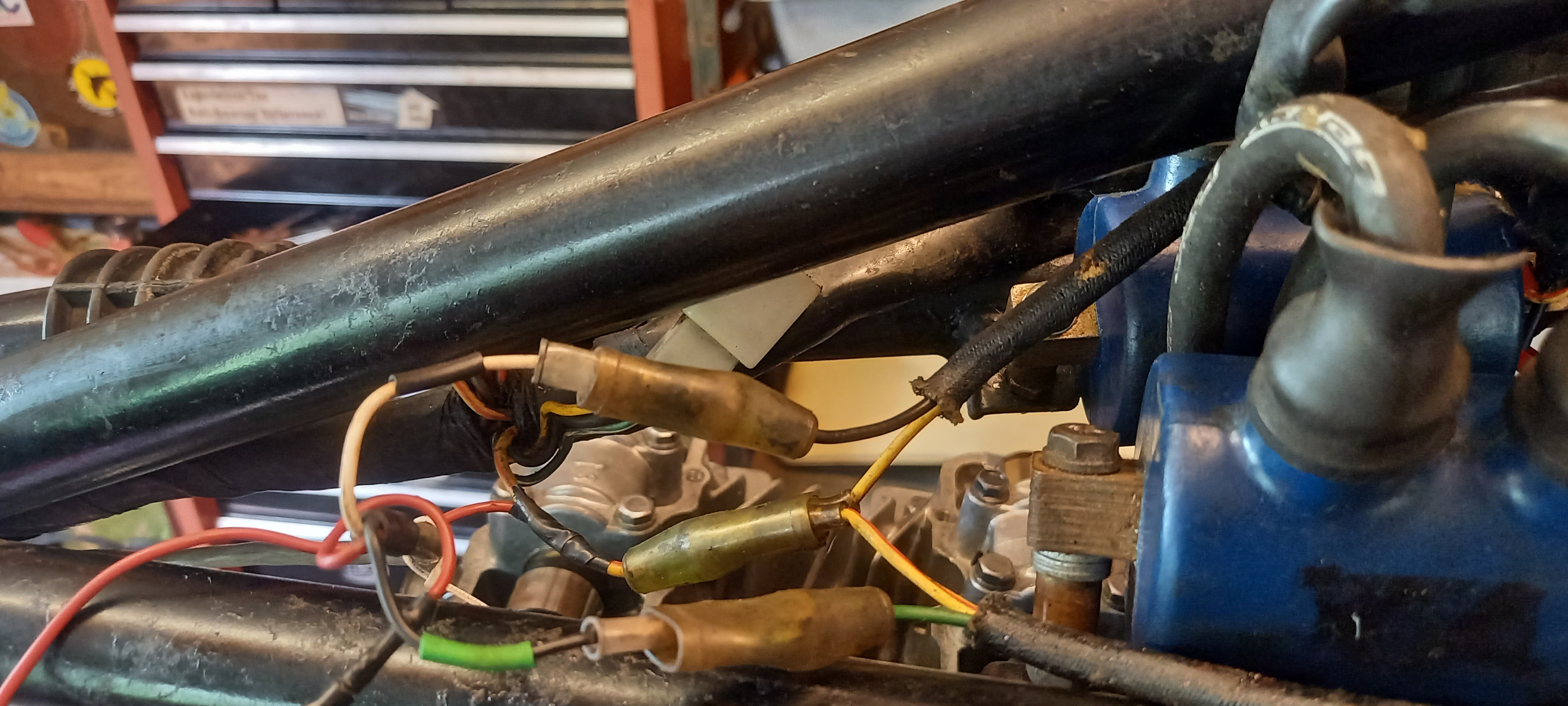

Just to make sure the dyna wiring is correct.......the black wire with a green sleeve from the pickups goes to the Green wire on the right coil. The white wire with the black sleeve goes to the Black wire from the left coil. The red wire then is spliced into the yellow/red common coil wire......?

Re: cam timing....
Ive done what you suggested Al, thank you please ignore my last bit about the wires......was getting a spark on #4 at the firing point of 2&3.......swapped wires around, don't know why they've got the little extra colours on them? And now firing on #1 and #4 almost spot on the firing mark!!
Cheers Al, thanks for that!
Jeez, I feel bloody stupid
Re: cam timing....
Nothing stupid about that. The wires were the right way round, its the rotor that was 180 degrees out.
Might pay you to do the same check for 2 and 3 as there's no guarantee the pickups are diametrically opposite each other. It might also be useful to put a strobe on it as well. With full battery voltage at revs the pickups can fire on the approach of the magnet in the rotor and statically or with low battery voltage the pickups can fire as the magnet passes making the trigger point uncertain. The only way to be sure is to do it at running speed.
