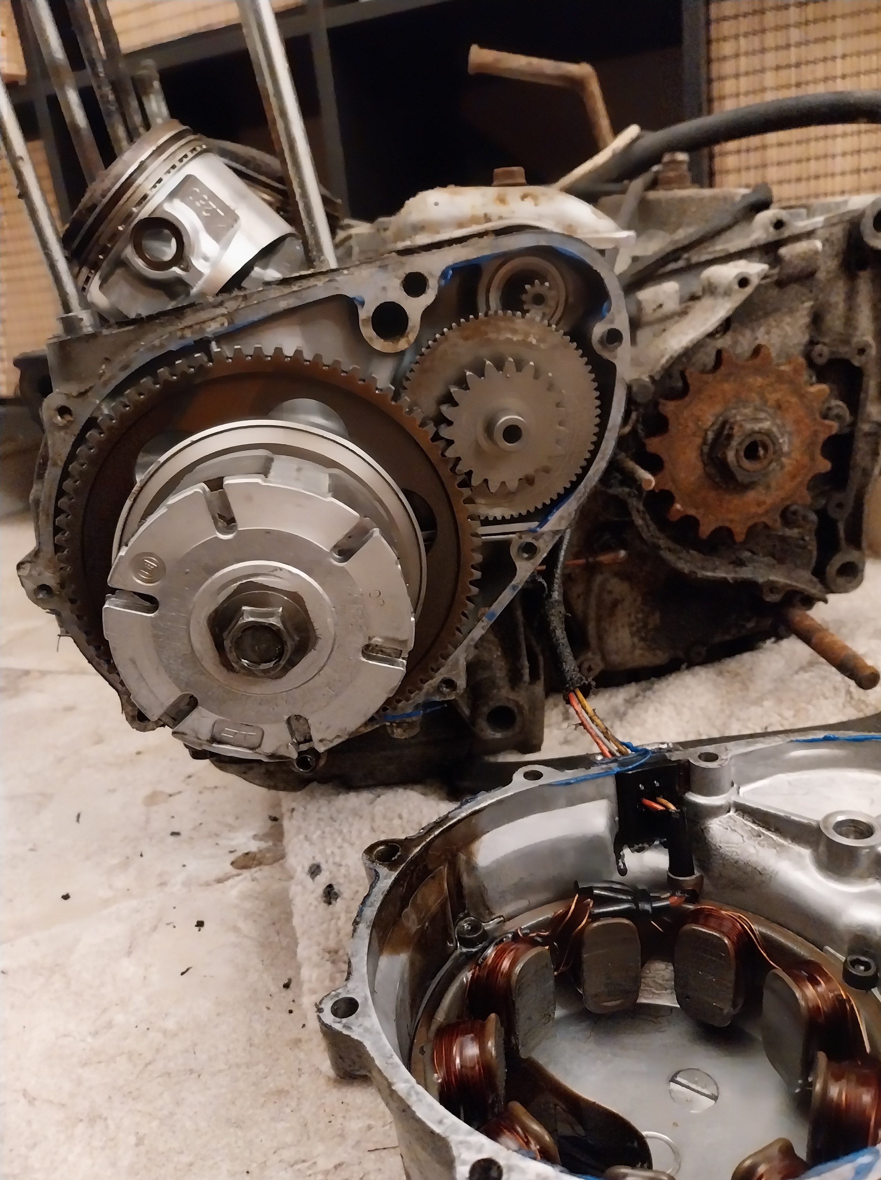

Everyday is a school day and i wouldnt mind but i have both engines on the bench sitting beside each other, i think it stems from a thread where someone was making a a smooth pre 79 cover from a ribbed 79/80 one, now it leaves me wondering why he went to all the trouble other than to run the 79/80 generator.

No need to mess about like that now as there's conversion kits available that fit in the earlier covers.

wow... could buy a whole engine for that... this motor has had the opposite done.

Must have an earlier crank with the smaller taper in it for that to fit.

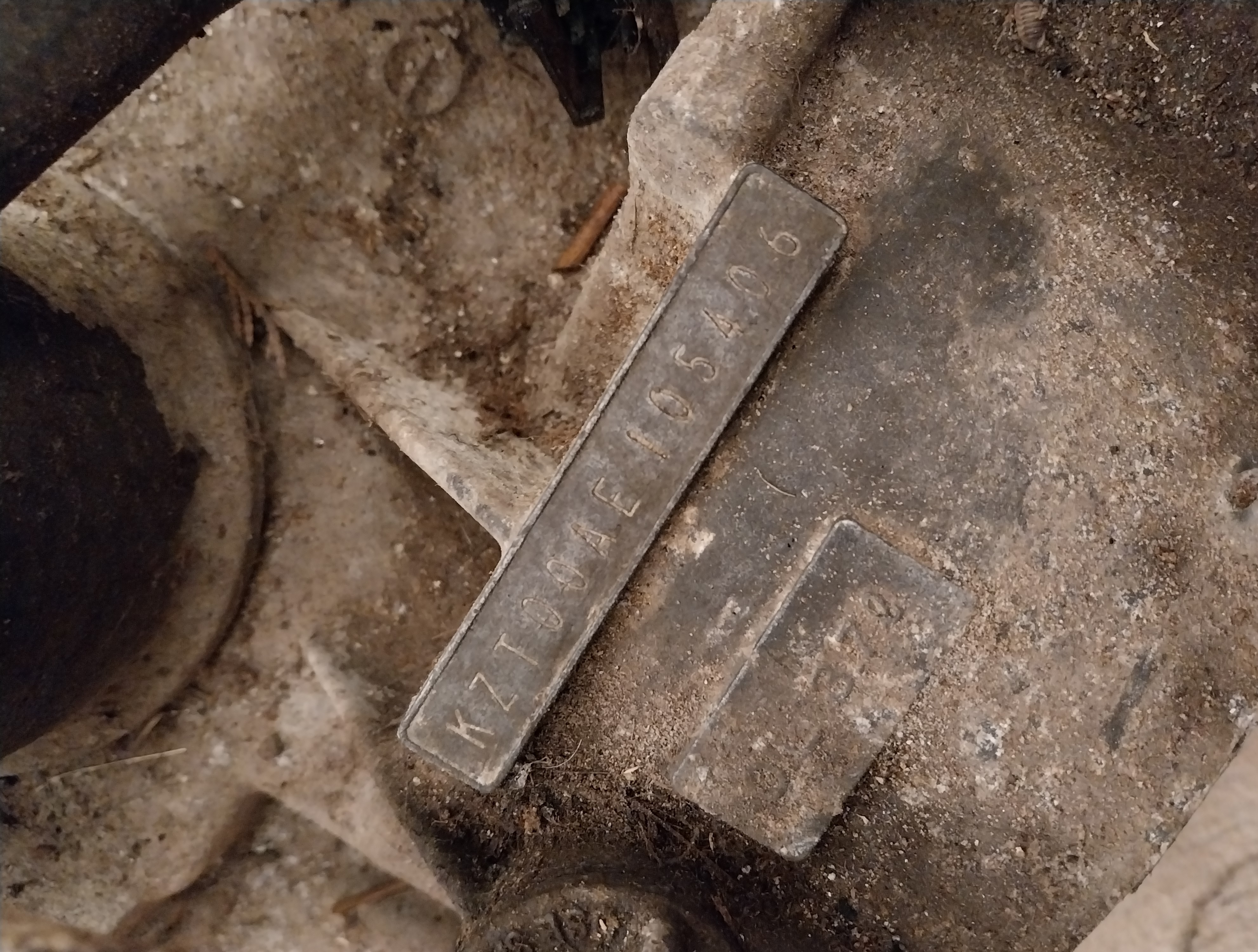

For a 1980 Mk2 engine KZTOOAE093001 -110764 i think thats kinda what you will pay theses days.

Correct, Z1 crank with a Z1 head.
