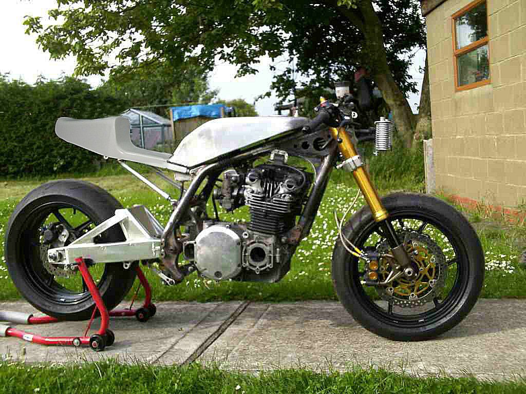

No - not a photoshop job Vic. Pics taken from page one of this build.
Lot of work gone into that seat unit and i think it looks the dogs :!:

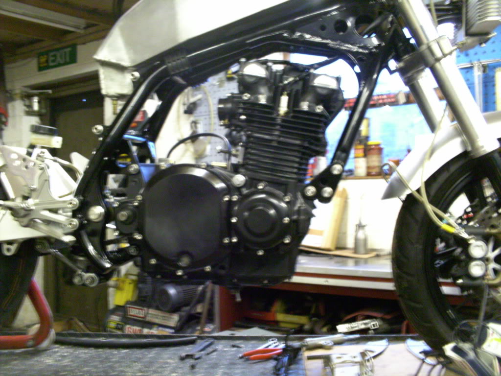

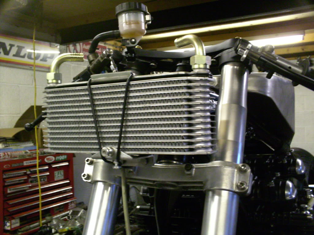

oil pump,sump and clutch cover on so it's now all oil tight.

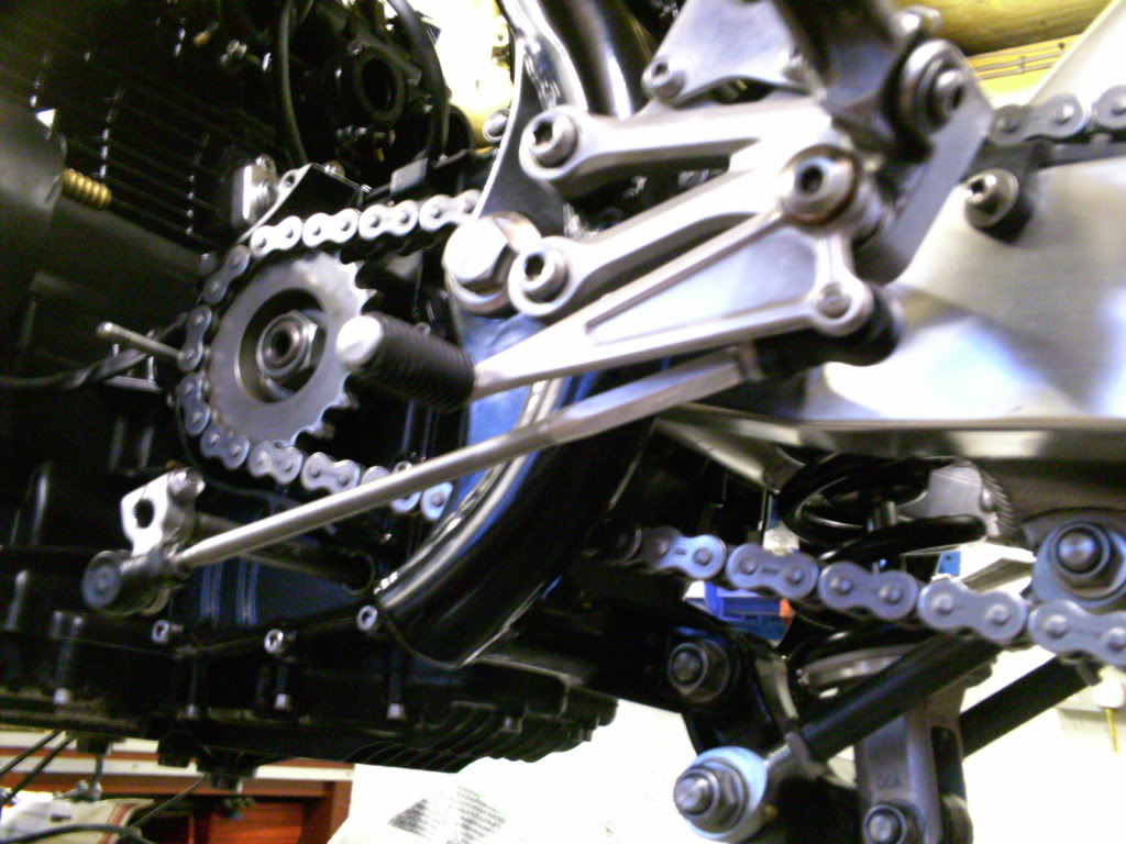

Chain on and gear linkage extended to fit with some 10mm hex ally bar

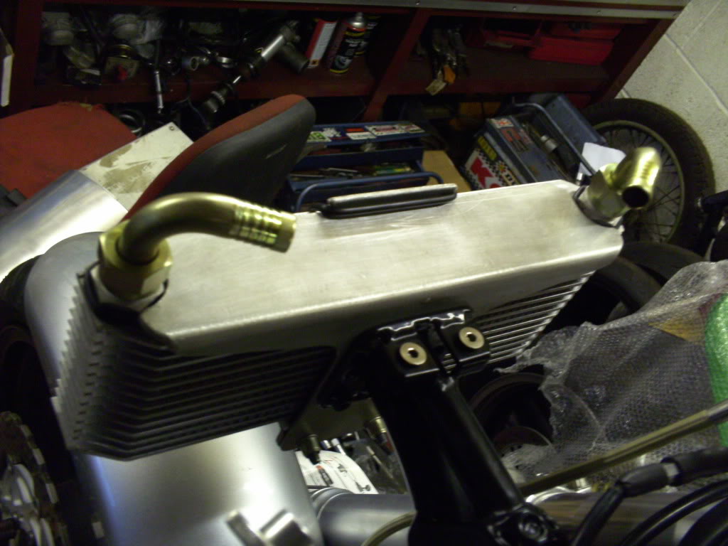

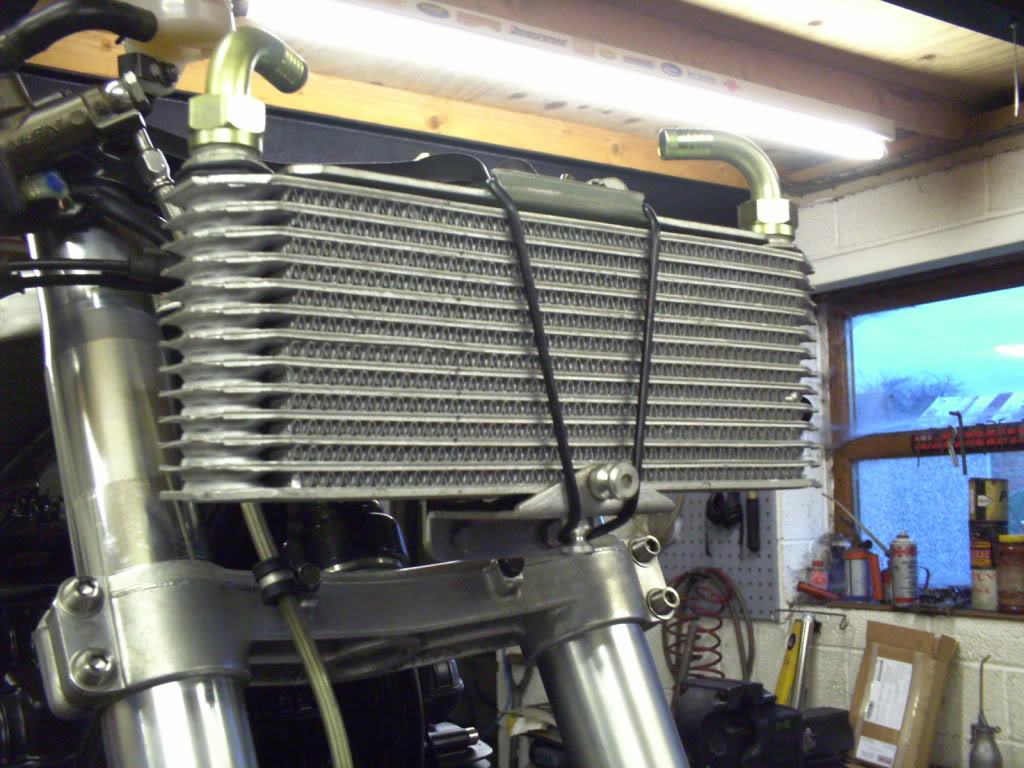

Oil cooler mounting finalised with hooks for retaining strap , just needs a coat of paint to finish

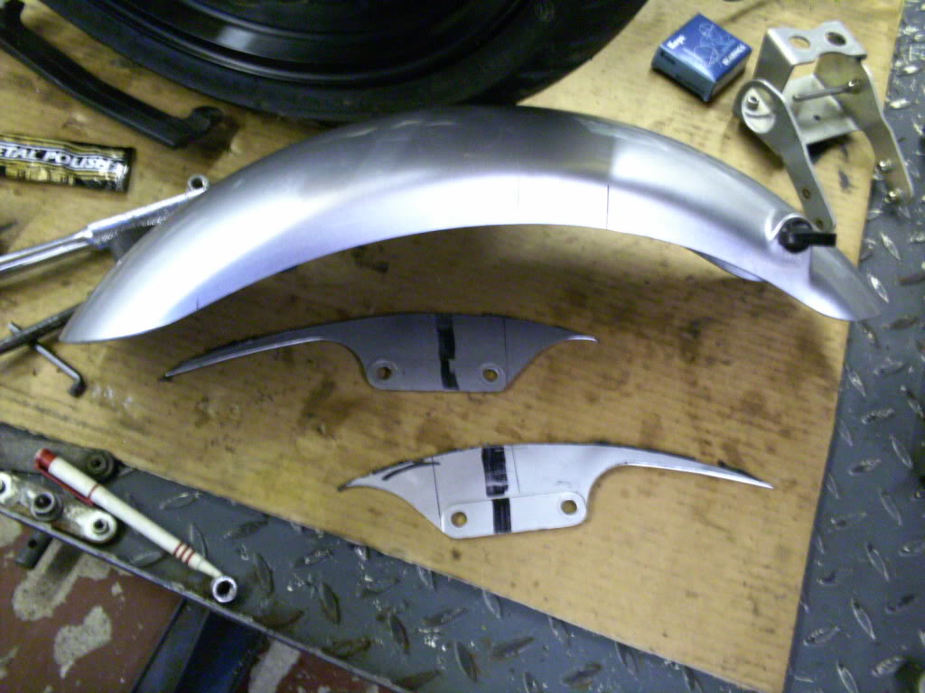

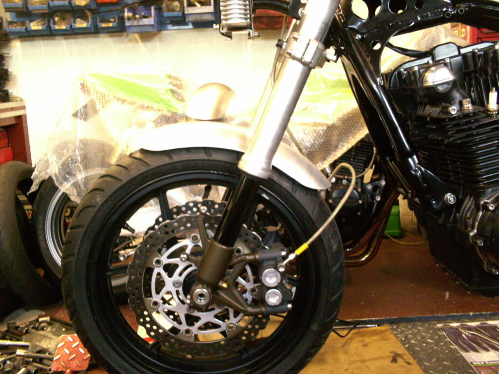

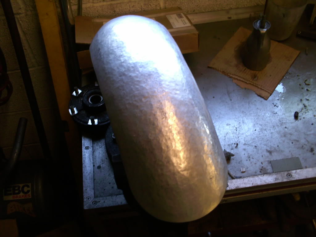

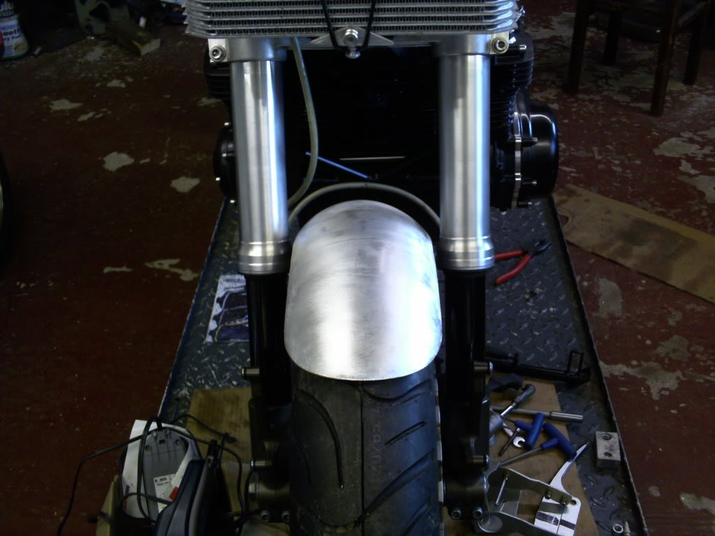

Made a start on trimming the XJR front mudguard.
But for one reason or another i wasn't happy with it

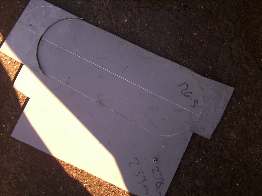

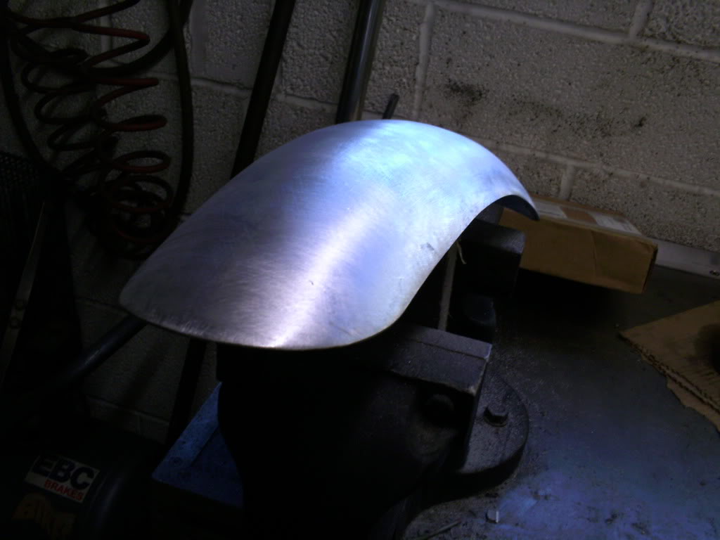

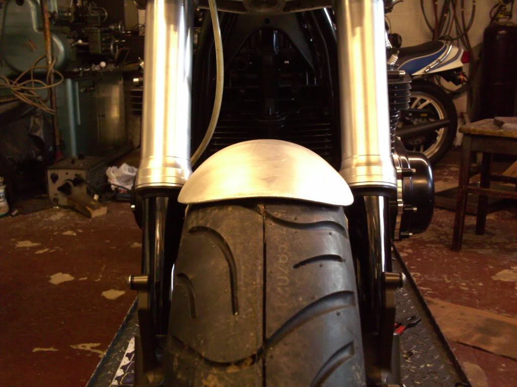

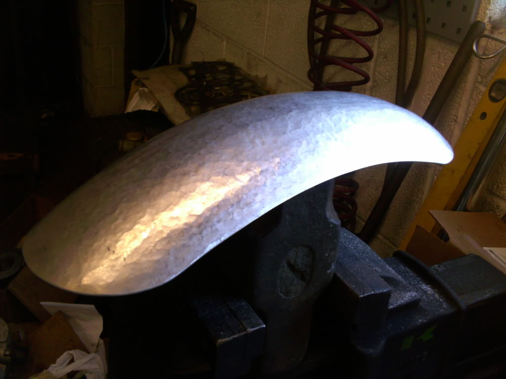

Decided to go back to plan A and have a crack at whittling some of that alloy road sign

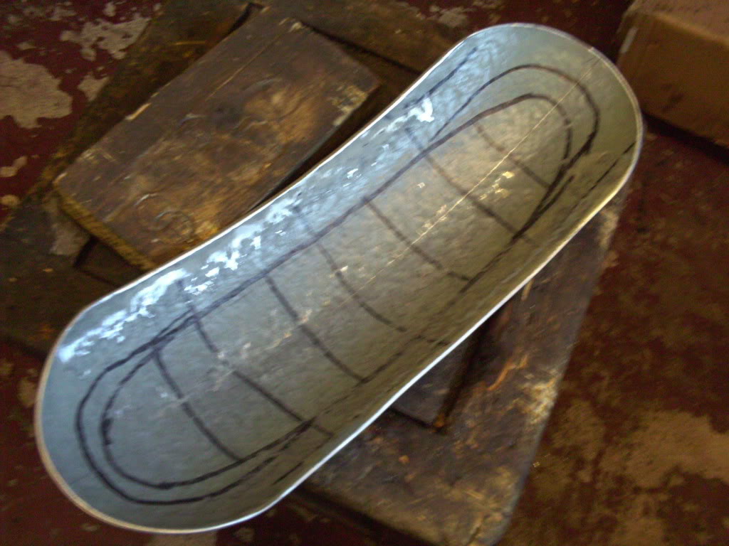

Guesstimated the shape i needed , cut it out and beat the crap out of it for two days until i had ....
....THIS
The last time i did this it produced a copper ash tray in second year metalwork :lol:
Several hours (and blisters :( ) later a very long session with the files and course paper produced a smooth surface ready for the final finish
Not bad eh?

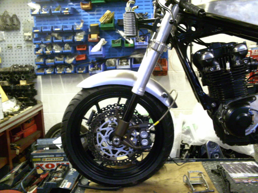

Think this looks much better than the xjr one ?.
Just need to figure out the mounts now.

#195 PostAuthor: Rich » Sun Feb 03, 2013 8:54 am
you need to make an English wheel.
For mudguard clearance I thought the OCC way of running a length of chain over the wheel and using that as a spacer was good.
